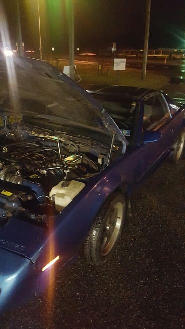

Can you post a pic of your engine bay.
Old Oct 12, 2014 | 05:34 PM
  #57
alex722607's Avatar
Joined: Jan 2012
Posts: 877
From: Clark NJ
Car: 1988 Pontiac Transam GTA Notchback
Engine: 2003 Chevy 5.3 Vortec (325 cu)
Re: 92 TBI to 2005 LQ4 ;)
thanks.
Yours turned out really nice. It looks like GM intended it to be like that.
Well done!

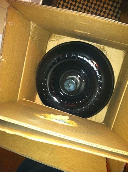

Got my 3200 FTI stall today. Was Recommended to me by a fellow member on here as well as Tick Performace. Looking forward to to putting it in. I took My car to a Local reputable trans shop and let them drive my car. To me the one-two shift was very hard and i initially thought something was wrong when i was just driving my swap for the first time. The shop thinks the trans was modified. The second owner of the donor vehicle has no clue. I may just leave the trans alone for the time being. I will be looking into a bigger trans cooler with a built in fan though.

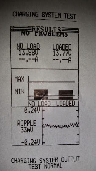

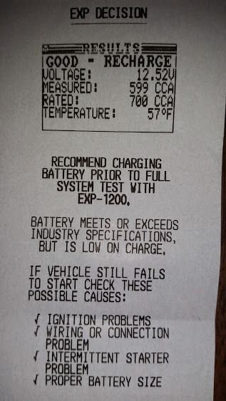

Took my car to advanced to test the electrical system. These were the printed results. Not sure if i should maybe test with a second alt? Battery is brand new as well.
Old Mar 22, 2015 | 07:03 PM
  #75
alex722607's Avatar
Joined: Jan 2012
Posts: 877
From: Clark NJ
Some thoughts: how is power distribution done in the car - is it like the stock third gen - power distribution at the starter or more 4th gen - meaning heavy wires to a fuse block under the hood, then to cabin.
Also what is the size of the battery cable going to the alternator. You might need better battery cables - look at innvoative solutions LLC. You might also need to ground the engine better.

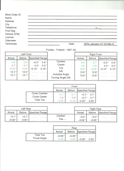

Had new springs and steering installed. had to cut the springs cause i forgot the new motor is lighter -_- . 2nd times the charm lol. I had a hard time finding a shop to do the alignment. they denied me after looking at the car. Its good to go now though. One part is a tiny bit out of spec though.

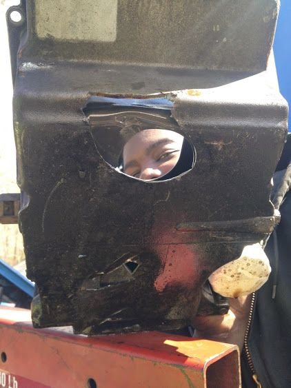

Ran into a snag on the road and was hopefully able to save the motor. Destroyed my oil pan. In the process of replacing it but we pulled the trans and the fluid was burnt so that is a ticking bomb at the moment. I only need it for 2 more weeks and then i go back to work.
Old Mar 30, 2015 | 11:27 PM
  #79
alex722607's Avatar
Joined: Jan 2012
Posts: 877
From: Clark NJ
wow thats pretty banged up, how'd it happen?

I hit something in the road.

Whatever it is that you hit- I would have expected it to bend and mangle the pan as opposed to take chunks out of it.
Hopefully no damage was done and it's just the 200 dollar pan and nothing else.

Cast alum doesnt bend

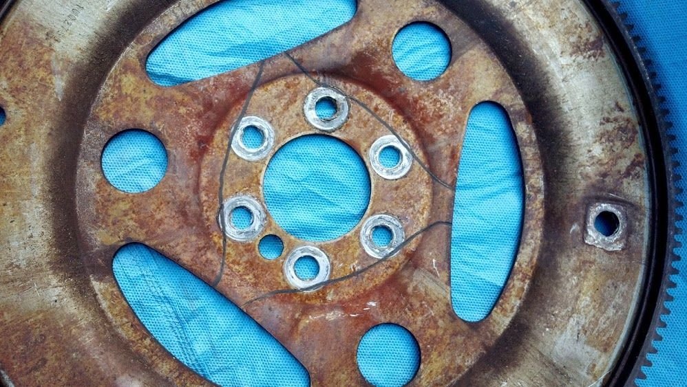

Developed this horrible ticking sound. Thought it was the motor after my oil pan disaster. Thankfully it was just the flexplate. I marked the cracks with a marker so you can see it. Replacing it with a thicker street/strip one
