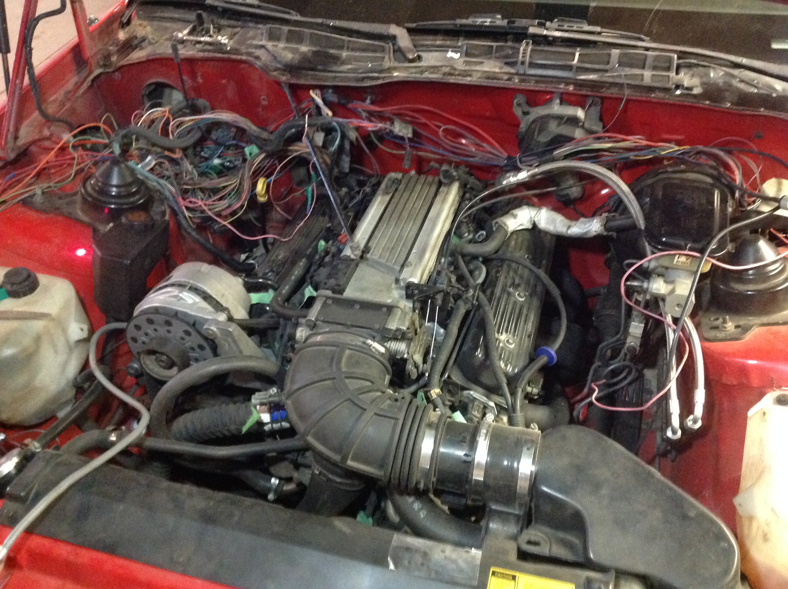

Cleaning up pics on iPad and decided to catch up on my progress. I am completely done my wiring now! It took a lot of hours from start to finish but everything works exactly as I wanted it to. I'm glad I did it my self because I learnt alot about alot of things by doing it and totally understand why premade harnesses are so expensive to buy. So here is the before pic again, it's bad but it worked and that was my goal, to make sure it worked before I put so much time into making it pretty.

[I] I figured out how to post pics properly again..its been a while. Here is the before pic [I]

Some of the differences other than clean up and looming wires from the before to the after include.... Deleted evap and egr stuff, I removed AC blower housing and replaced with a non AC need a new fan as the fan from an AC car is too big to fit in the housing. I tried to remove the fan from the motor so that I still had the more powerful fan and it was so close to fitting but was too deep by an 1/8", so I cleaned up and painted the fan I found with the housing at the wrecker. I rerouted the hoses for the opti vent and in doing so I learnt that I got the motor with the hoses screwed up. I now have it routed properly to the top of the air Intake elbow and the manifold. Also I installed my fuel pump and fan relays down behind the battery. The pic doesn't show them cleaned up and loomed. I let but trust me I did those wires also, haha.
