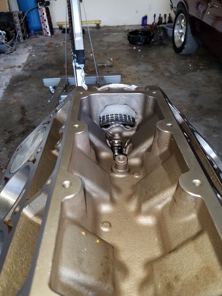

Well a little more progress though not as much as I had hoped. Things went slow sat and sunday. We did manage to get the PTV clearance checked, and the pushrod length measured. I have to order the pushrods tomorrow. Going with Manton 11/32'' units. Measured out that I need stock length 7.4'' pushrods so I installed some of my buddies units and checked the wipe pattern on the valve stem as well. Looks pretty good I think. Got my intake back, I decided not to have it dipped at this time. I think the gloss black looks good. No racing this weekend and my GF is working so the plan is to install the motor and get to plumbing the fuel and coolant lines. I have AN lines now for fuel, the steam lines and trans cooler lines...I'm about to be sick of assembling hoses I know....
Block was drilled for a chain dampener so I picked one up and installed it real quick.
