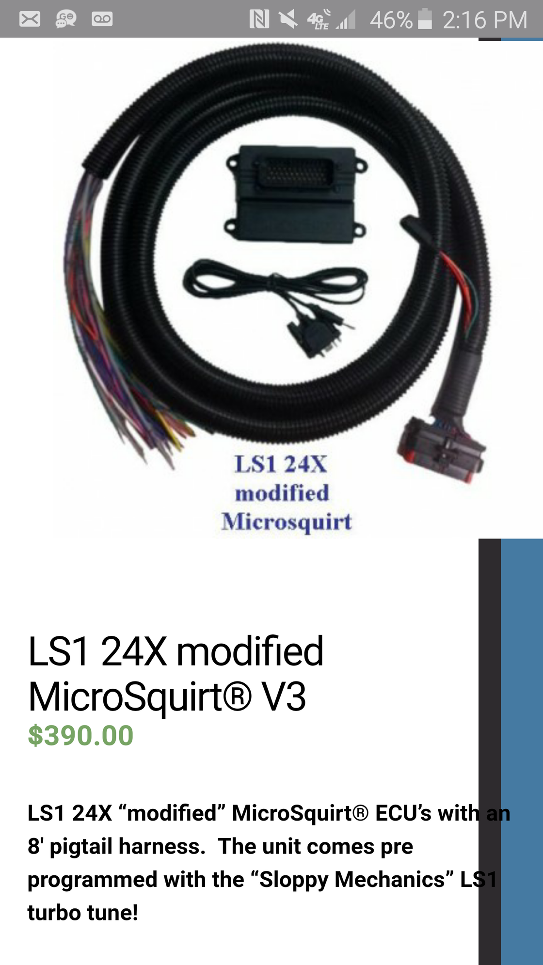

will this work with ls1 swap
Will this work for ls1 swap it a out of a 4th Gen camaro has ls6 intake

Yes, but be aware theres still a ton of work to do to that harness to make it work
Why not run an OEM PCM?

My goal is twin turbos and kinda want something I can tune without having to take it somewhere to do it

Get HPtuners?
If you're goo with electronics and know how to build a harness, then by all means use that. Just dont think its pushing the "easy" button. Dont think for a second that canned tune will apply to your build unless you follow his exact build to the T. You'll still have to tweak it and that requires software and experience
