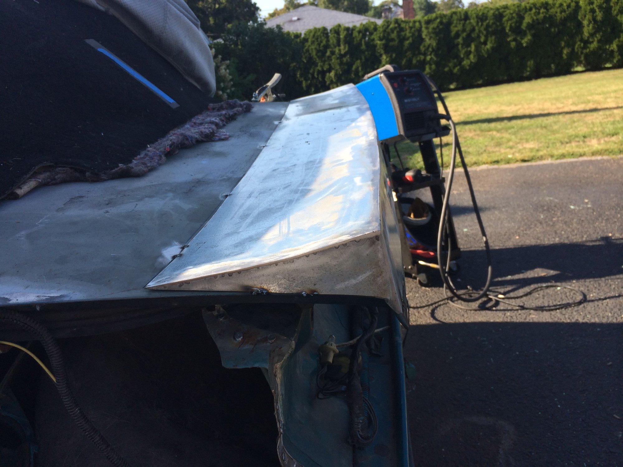

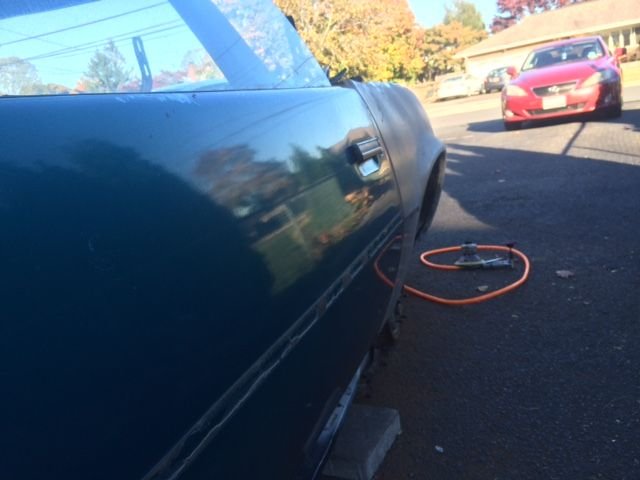

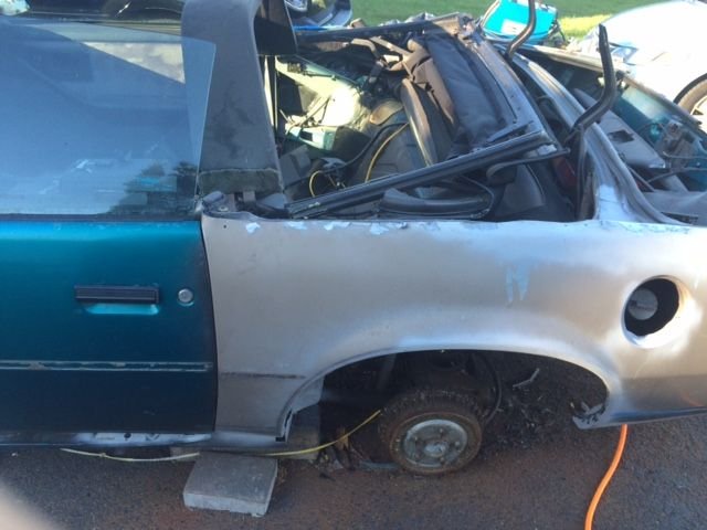

Here are some picks of the work I have done so far. The rear quarter was so badly damaged and dented that I had to remove it and replace it with a donor. I will never do it again, it was such a labor intensive job but overall I am happy with it. I also created a custom sheet metal spoiler because I didn't like the original plastic/urethane one and half the mounting points were cracked or broken.

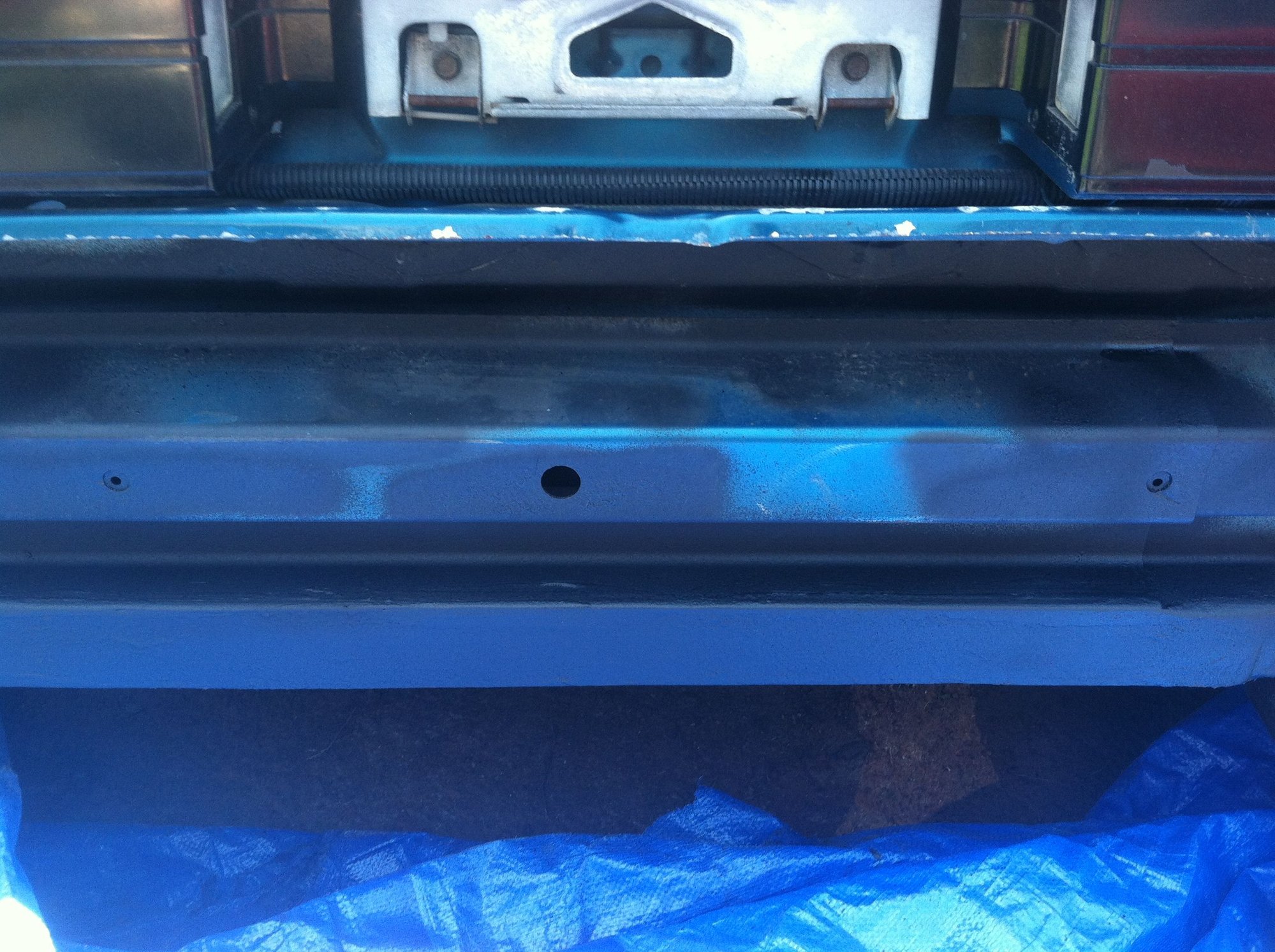

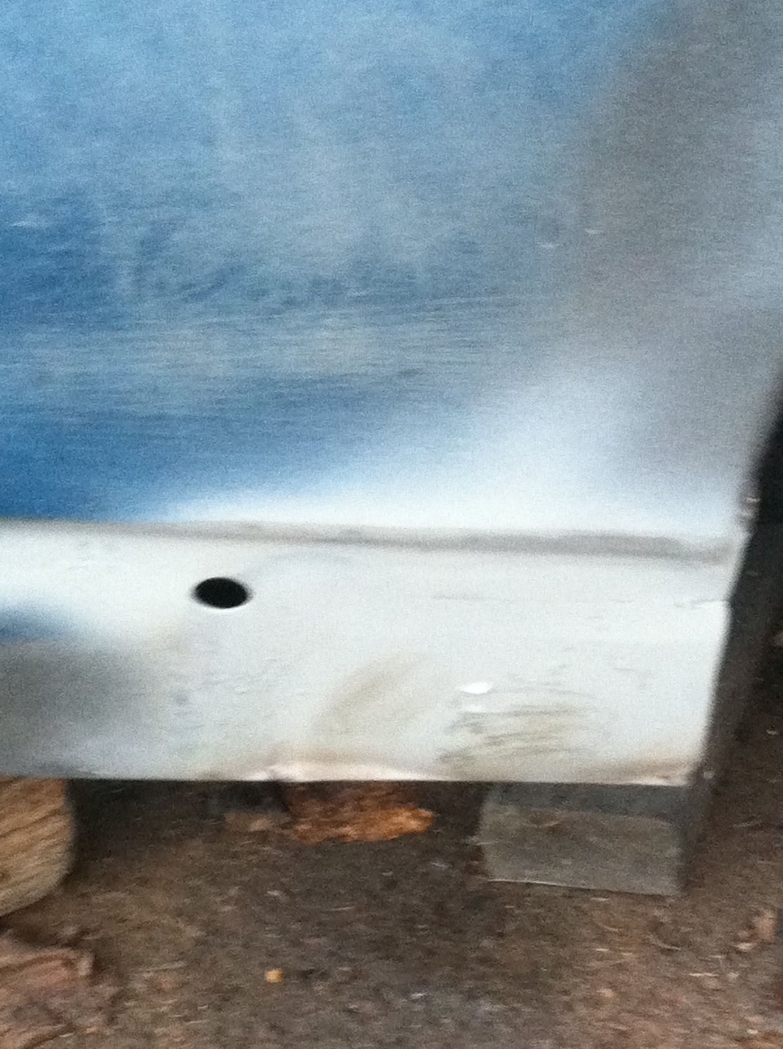

the bottom picture was a rust repair, I had to cut out about 2 feet worth of bad metal and replace it. the top picture is the bottom radiator support that was rusting. I wire wheeled it and primed it then undercoated it.

A couple more pics of the quarter replacement. Still needs finishing work but its tack welded on and lined up at this point.

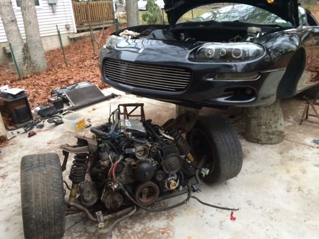

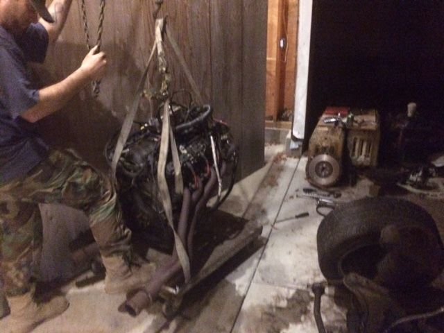

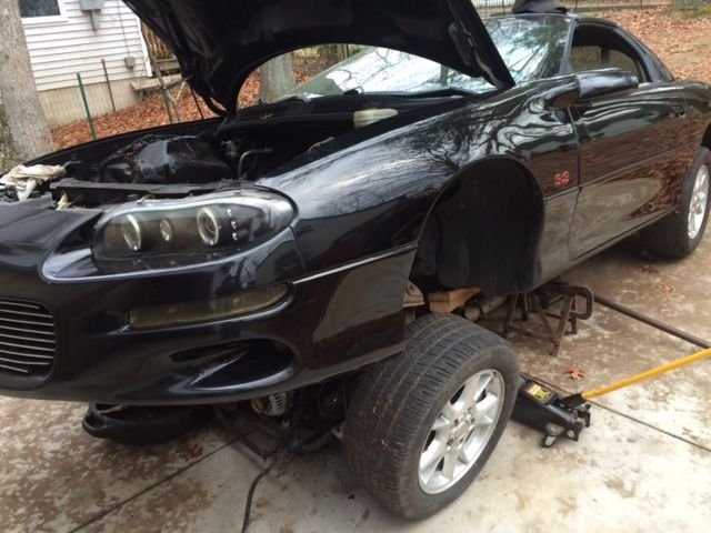

Some pics of the donor ls1 and its extraction.

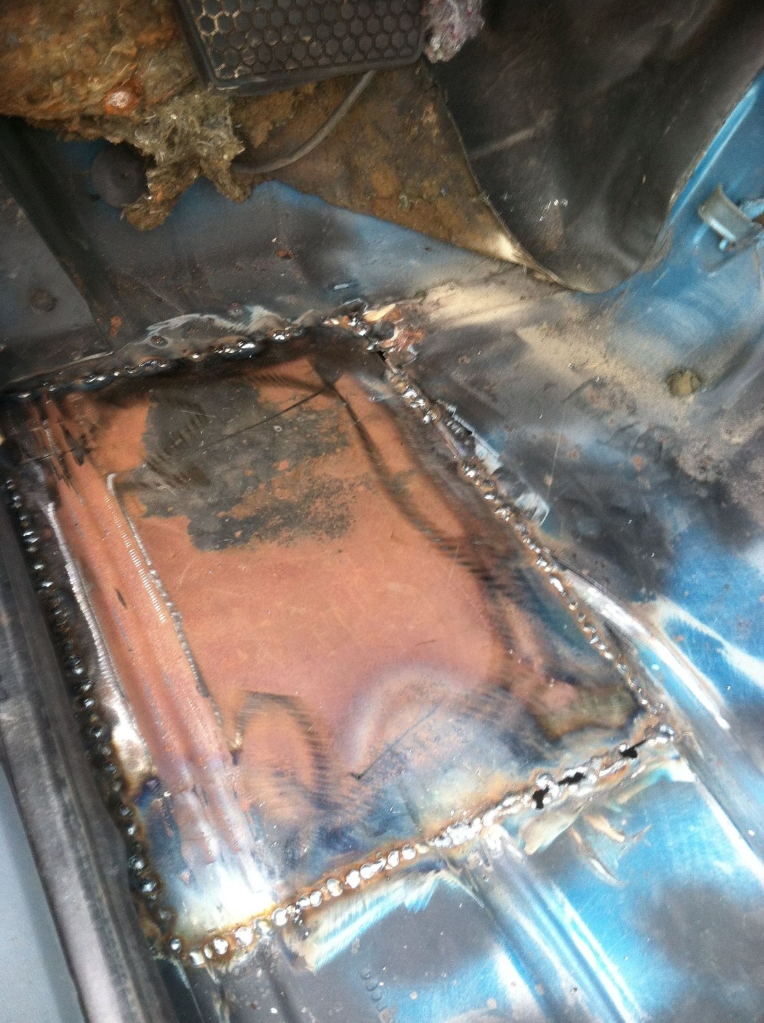

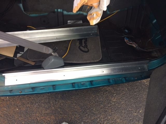

Driver floor pan repair, another time consuming rust repair. If I were to do it again, I would have spent a little more time on the welds and making sure the repair panel fit a little better, but after seam sealing and 3m undercoating the entire interior its held up for the last 2 years without issue.
