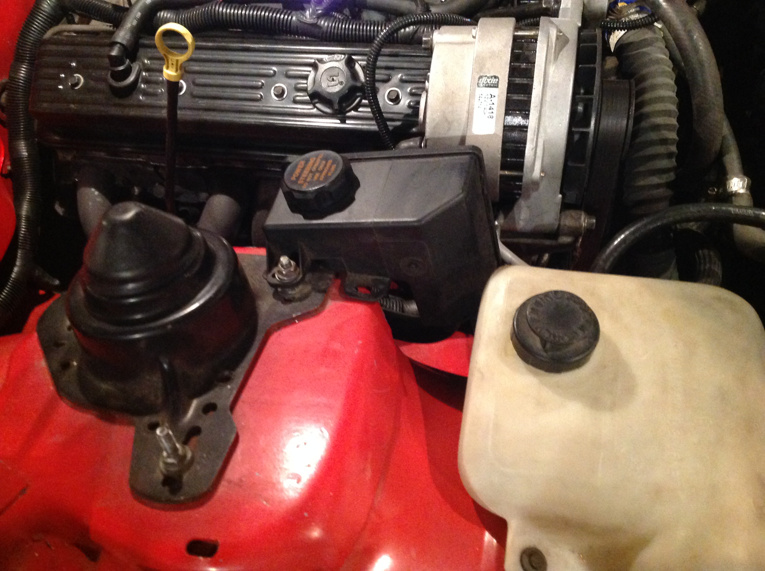

Re: LT1, What about that PS tank?
I used the res from my 95 z28 donor. It got moved when the shop did my alignment, I have not since out the second bolt back in because the hole doesn't line up anymore. I will have to drill a new hole to make it work again, but when both bolts are in it works great.
