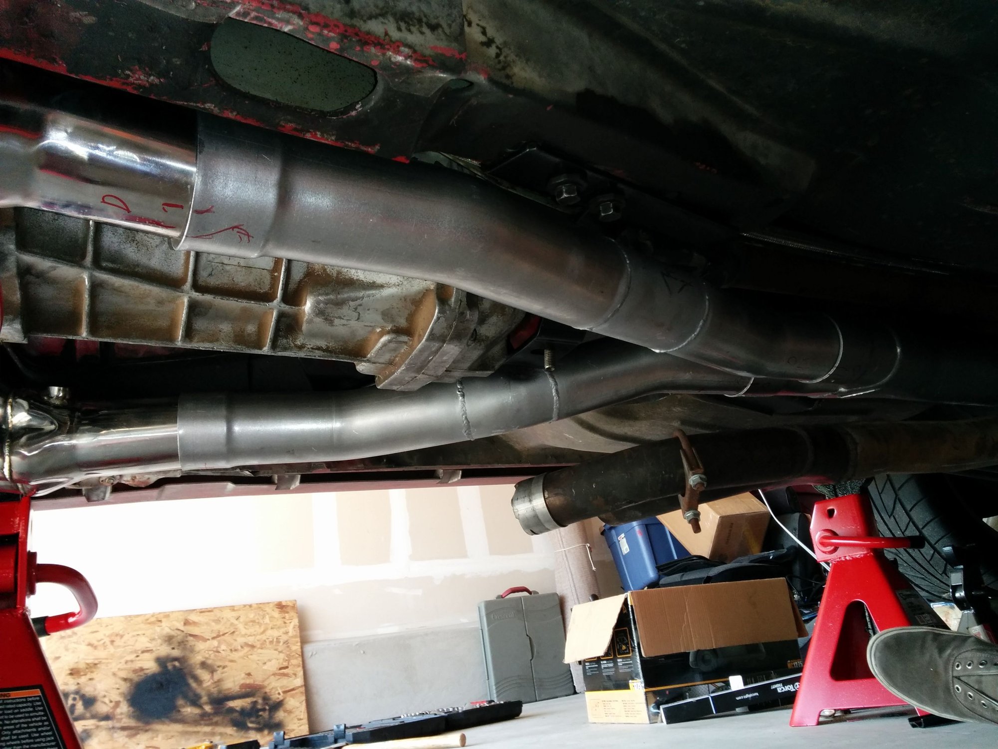

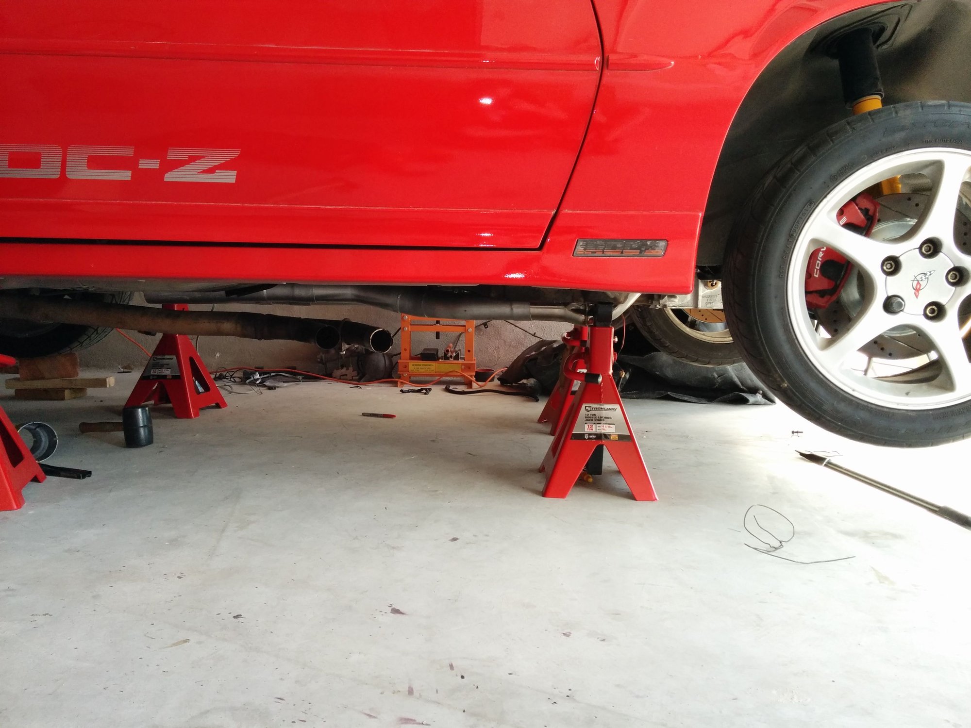

I've seen a few posts about it but nobody had any good answers.
Yes, the racing innovations LSX headers and Hawks LSX Offroad Ypipe fit. I had to massage around the torque arm mount and crossmember, but it was very minor.

nice! i wonder how well the auto y pipe works?

It only gets close around the crossmember, in fact I put a small ding in the passenger side so it wouldnt contact the crossmember. As long as the A4 crossmember is similar in design to the t56 one, id imagine it should fit fine. Theres plenty of room around where the pan would be.

Perfect, well I know what I will be ordering shortly! Thanks for taking the risk and giving it a try.
