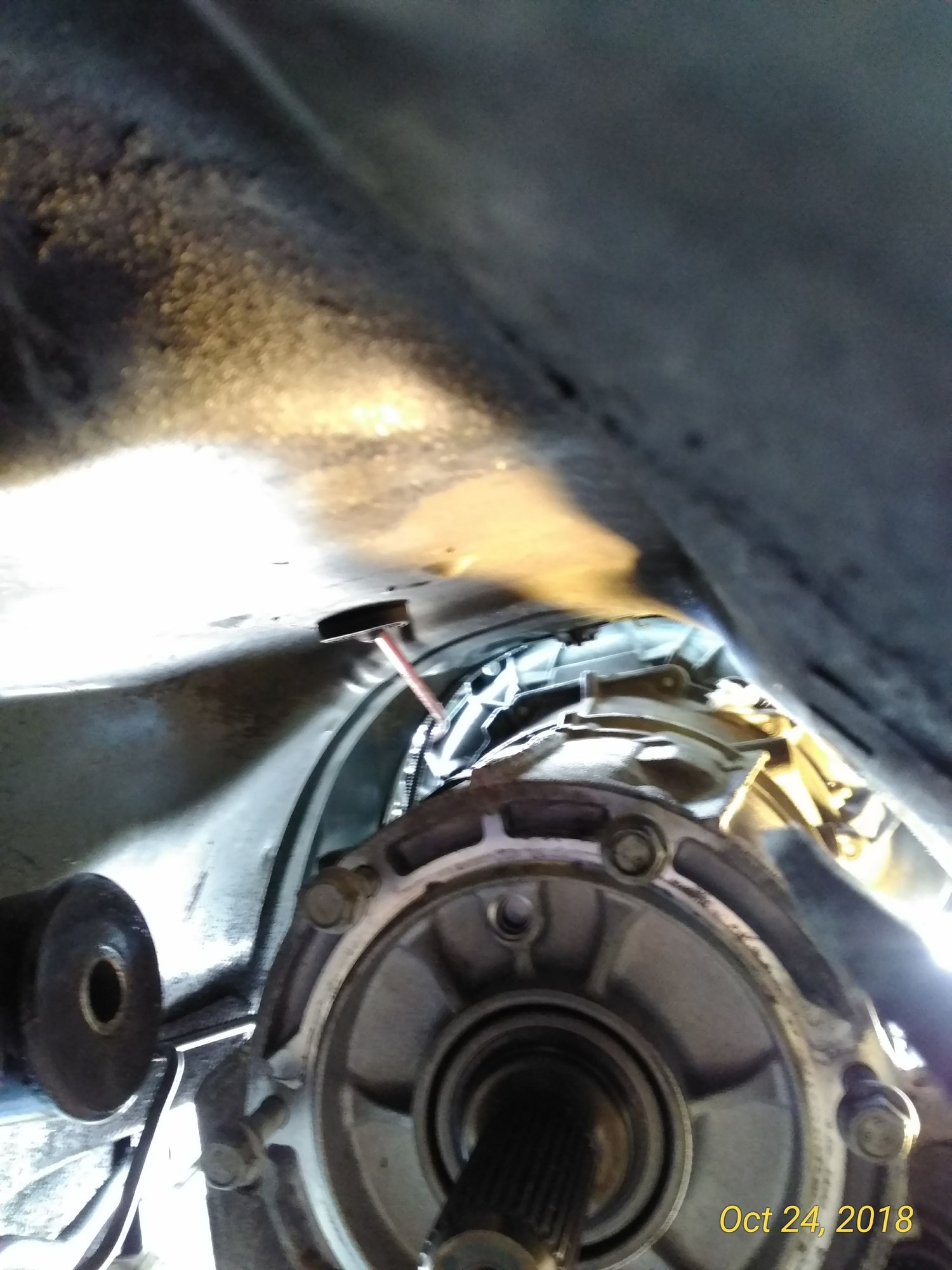

Trial fit the 6L80E today, it will fit, will need some mods on my UMI TQ arm but no problem in the tunnel. I'm planning a UMI tubular K member.
i can't see any reason this will not fit, should just be enough room. All of this done very carefully and jacked each end up a couple inches at a time. Lots of technique to get this test fit done but I'm confident it will work. Someone on our site said no way and if you've got more info or something I'm missing please lmk This trans is the exact length of the 700r4 I took out so I used reference points for alignment.I still need a tail shaft from a 2wd truck. Drive shaft trans yoke swap but I'm thinking the length of my aluminum aftermarket d s will be fine
