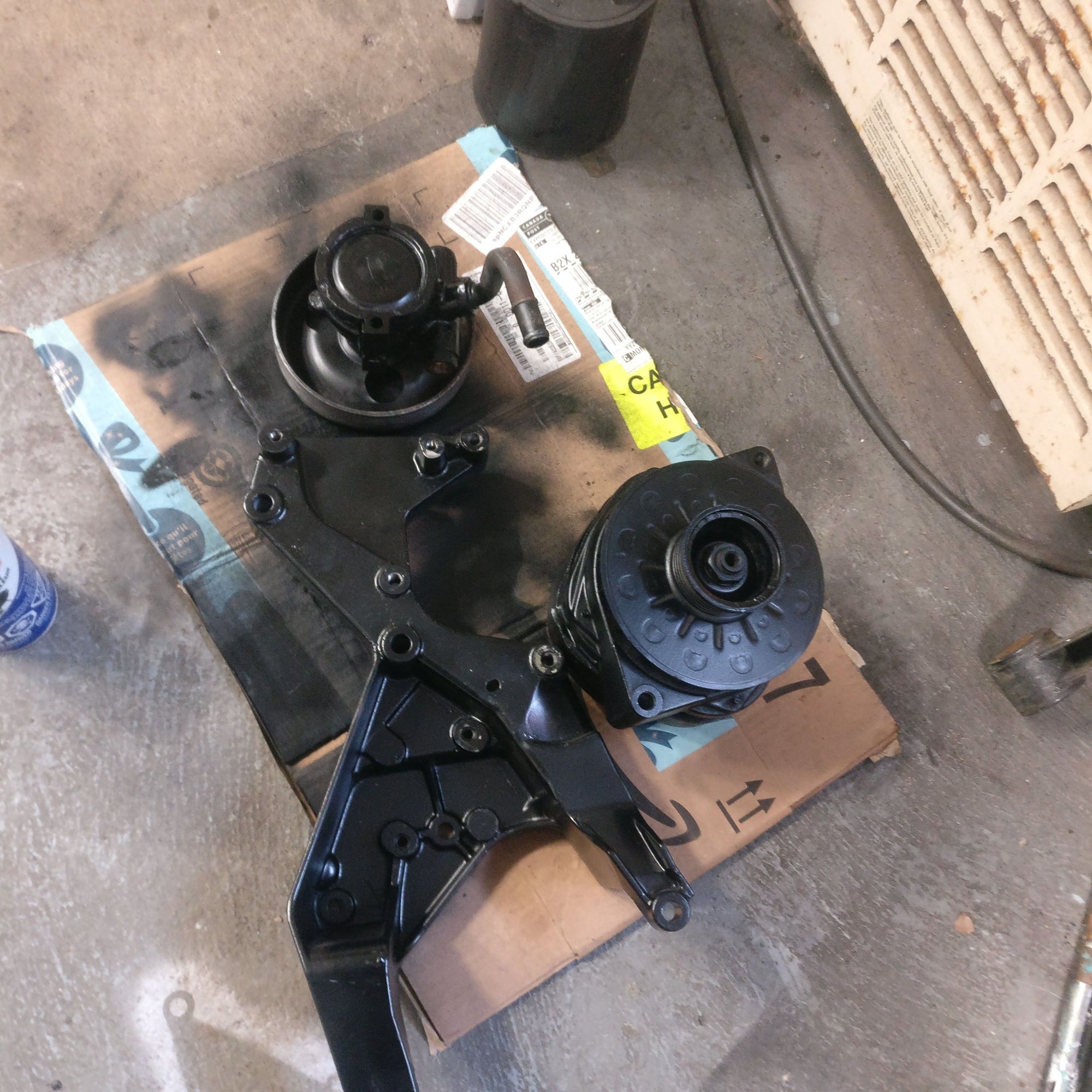

Made some more progress tonight. Cam in, heads on.

Made some more progress today. Painted my intake manifold then polished the top fins and fuel rails. I think it's looking good!!

Only a bit of progress .Got the timing cover and oil pan on .Went to check pushrod length and when I was installing my ticket arms I found out they won't work. (they were comp 1416-16 for pre 88 SBC). Now I'm waiting on some new Harland sharp 1.5 full roller rockers .
Been picking away at the engine bay getting it ready to paint, removed the brake pedal assembly and an getting ready to cut the firewall for clutch/master cylinder.
Sat the intake and valve covers on just to see how it would look.

Distributor and balancer installed. I ended up painting the balancer black.
4th gen rear in. Lowering springs, panhard bar and LCAs also installed
Painted accessories
