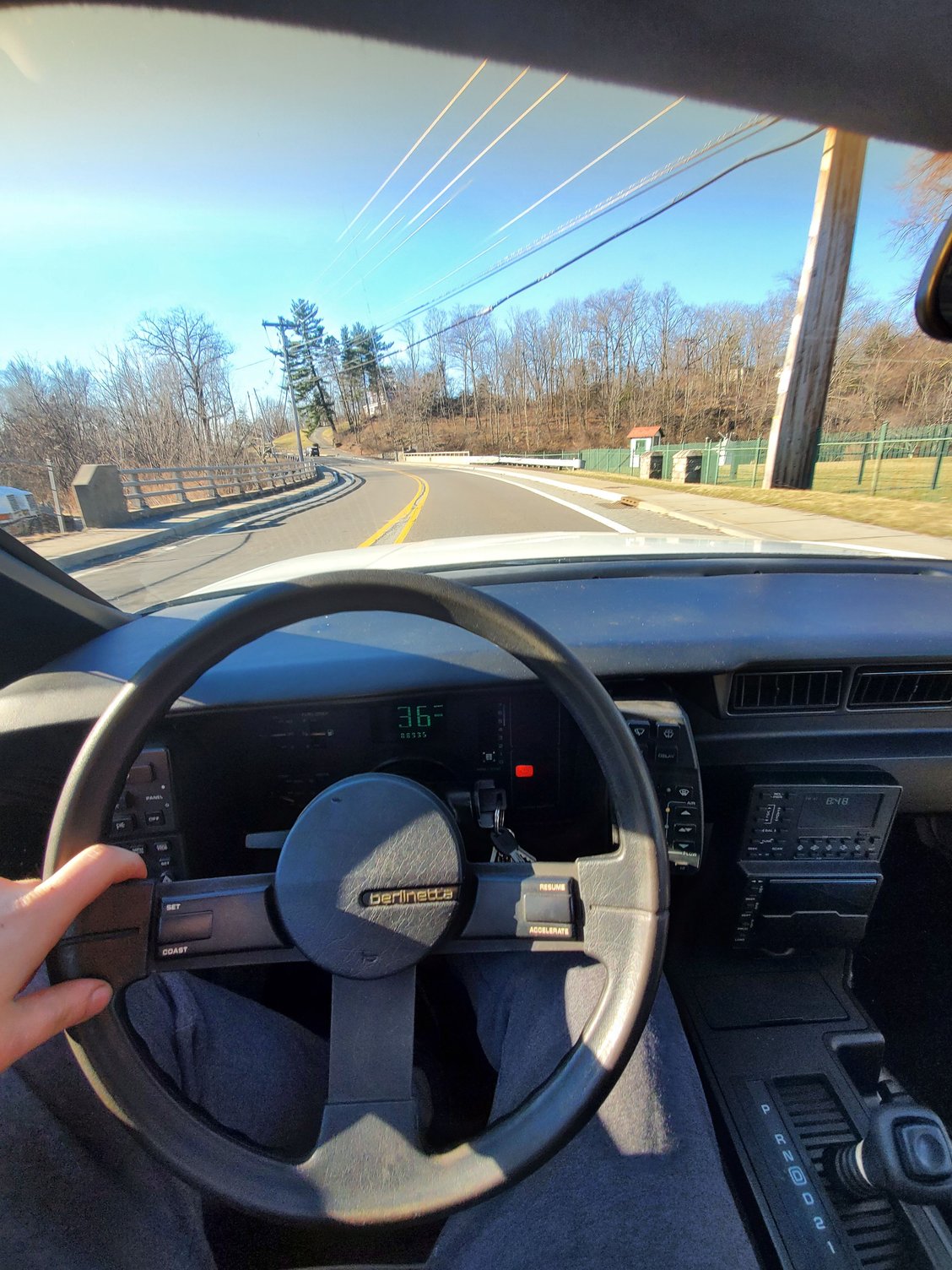

Hello all, im new here and about to start my first ever engine swap . Im going to be swapping in an l59 and 4l60e from an 04 yukon and i have some questions. The yukon is a running driving parts car. Got it for cheap because customer didnt want to replace brake lines on it.
As far as me having the Berlinetta with the electronic cluster, can i get the yukons computer to work with my cluster? If not is there an adaptor i can buy to use my facotry cluster? Or do i have to get a new cluster?
