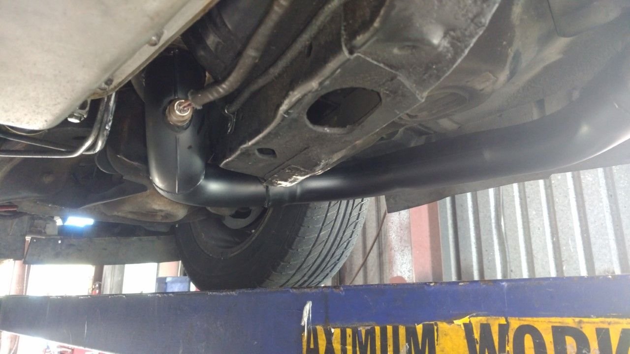

I'm putting an LS1 into my 85 TransAM with auto, currently with a small block 400 and "Clipster" ebay headers to suit. The exhuast shop did some fancy routing to get the exhaust headers to bolt up right at the bottom of the firewall and then loop around to the outside of the frame and down to the back.

Quote: I would doubt they will bolt right up. It is hard to see in the picture but I would assume some fab work will be needed.
Yeah, sorry, not the greatest pic to see the headers, it was more just for the bottom end routing.
I mean if its a bit short or long it's easy enough to fix up, it's more the height of the ls1 exhaust ports and lateral block location in comparison to the SBC I'm chasing.

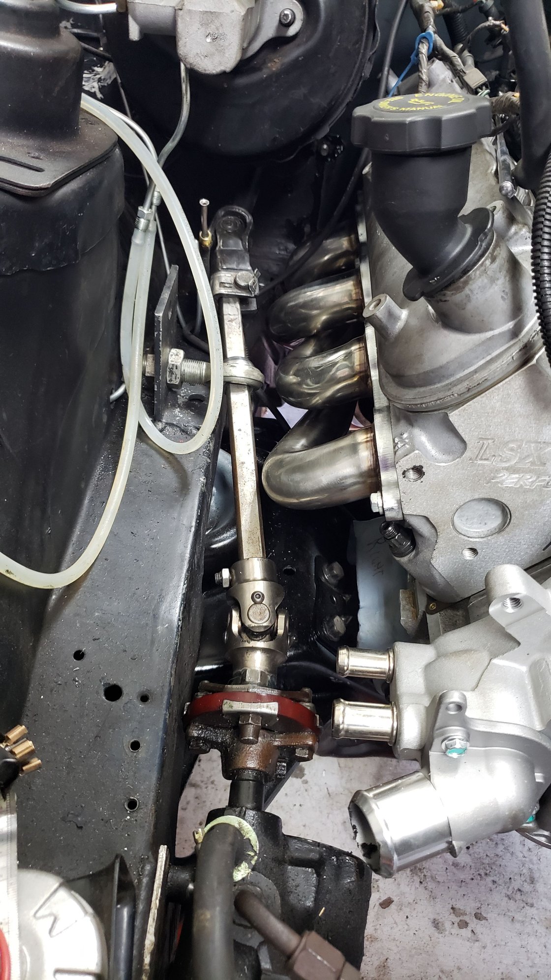

Oct 13, 2021 | 05:34 PM
Re: LS1 Swap - Exhaust location question -Clipster headers related
FYI IF you relocate the steering column / replace with a commodore setup, you can fit the stock "clipster" style LS1 headers in with no worries
