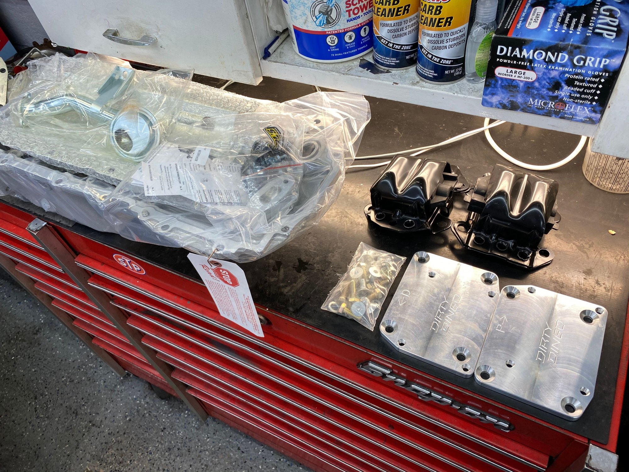

Dirty dingo motor mount plates came in. These will set the gen v in ls motor position. Their adjustable plates wouldn’t work with low mount a/c so I’m hoping everything is just going to fall into place.. If the trans ends up being too far out of wack or the compressor too close to the idler arm/k member, plan B will be to go for a mid mount compressor and the dd adjustable mounts. I also have the Holley pan ready to go on. I have to finish putting together my buddy’s charger’s nag 1 tomorrow, but if I have time left over I’m gonna try to test fit this thing!

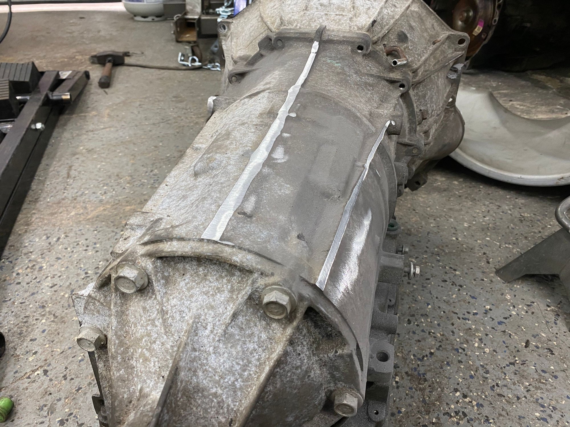

Re: Gen V “LTX” Swap for my 86 Trans Am

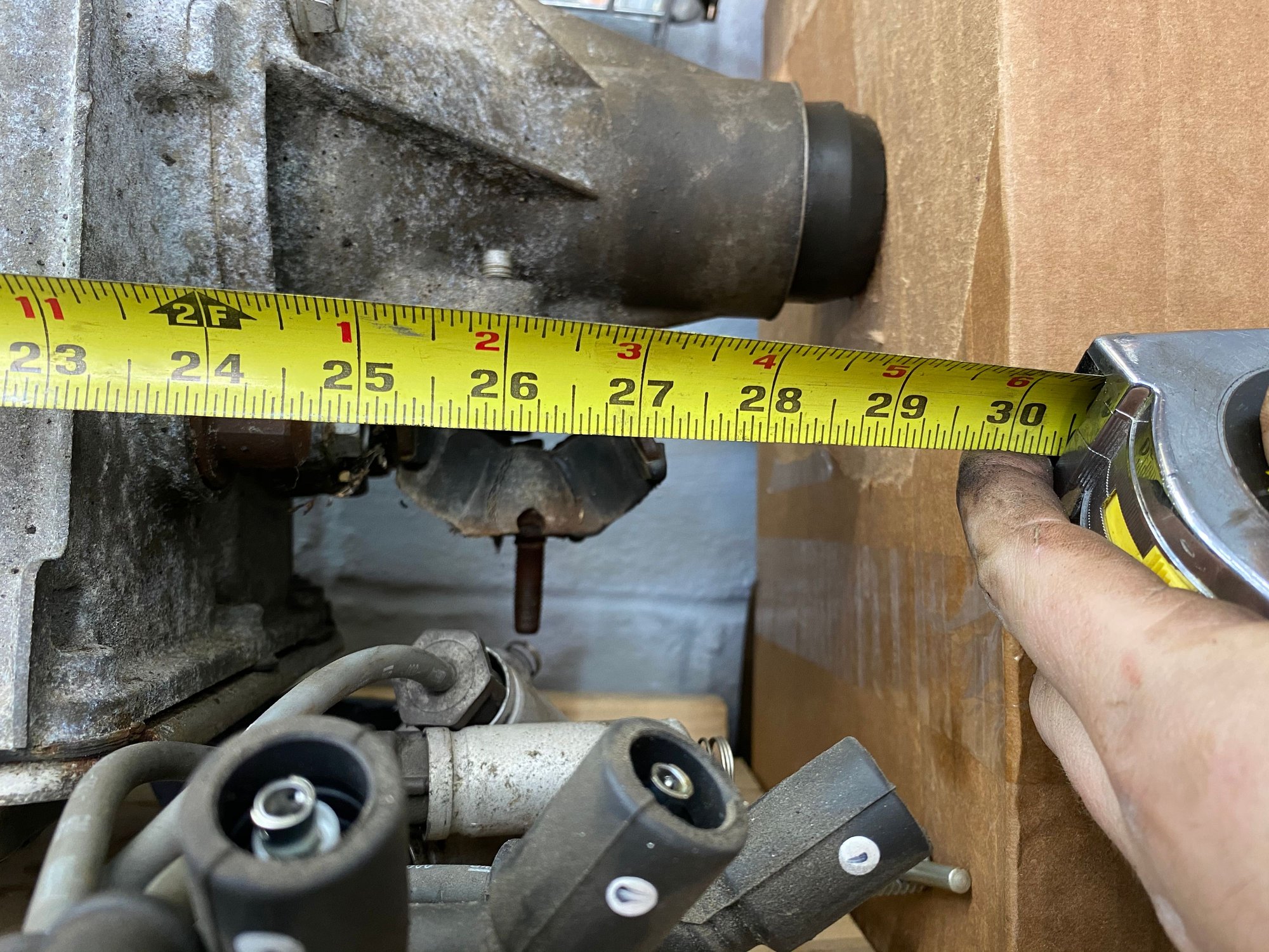

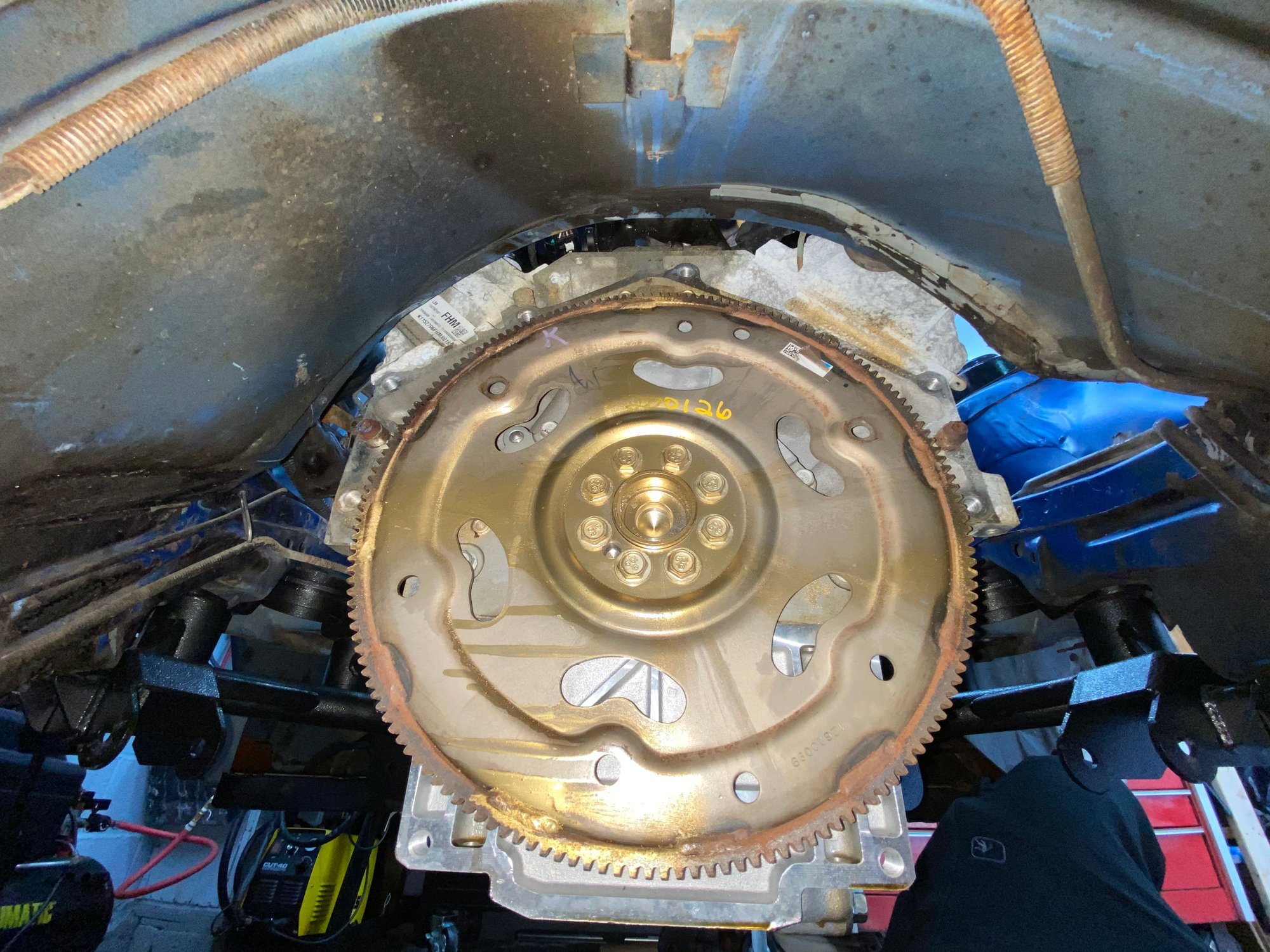

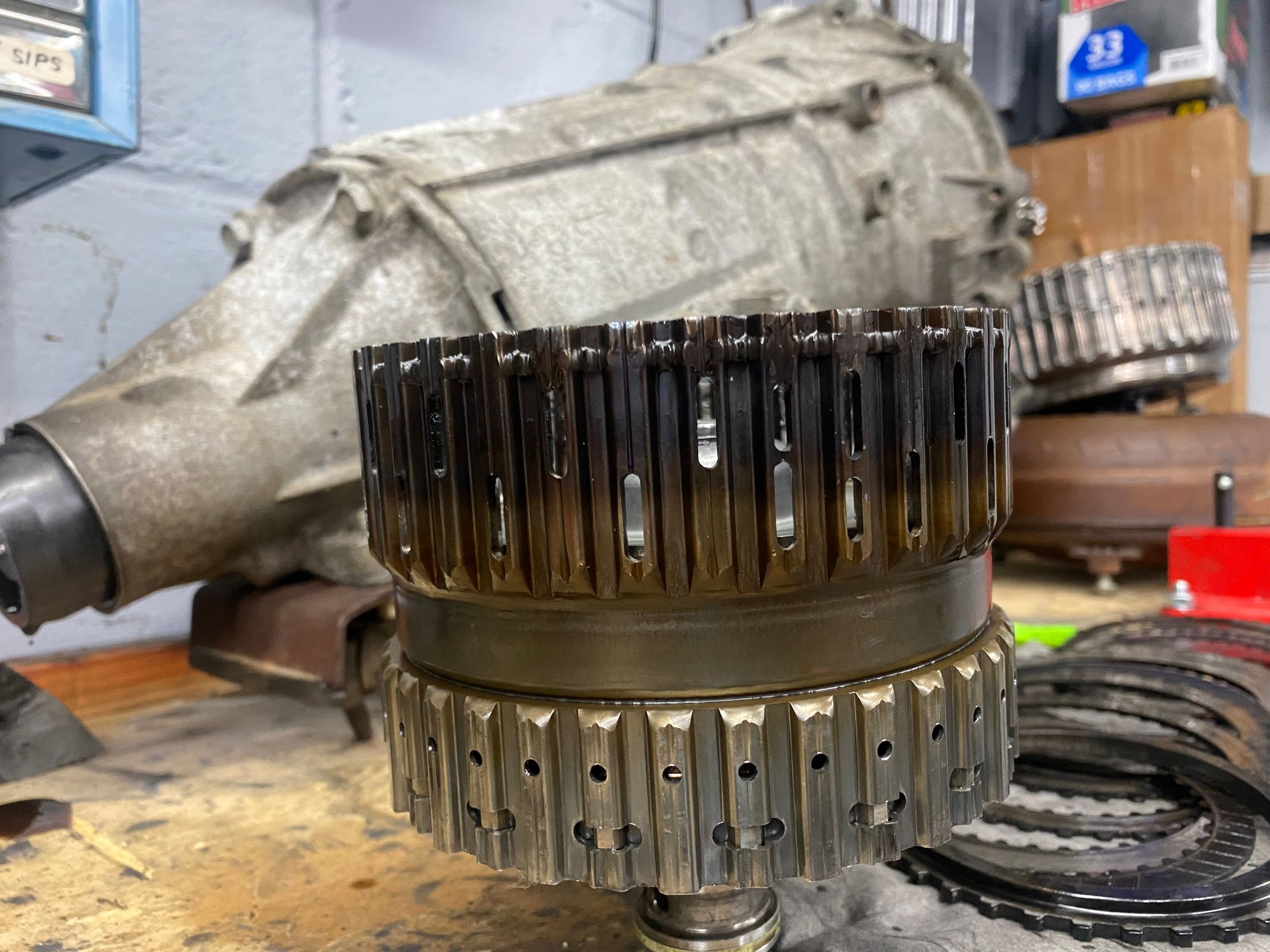

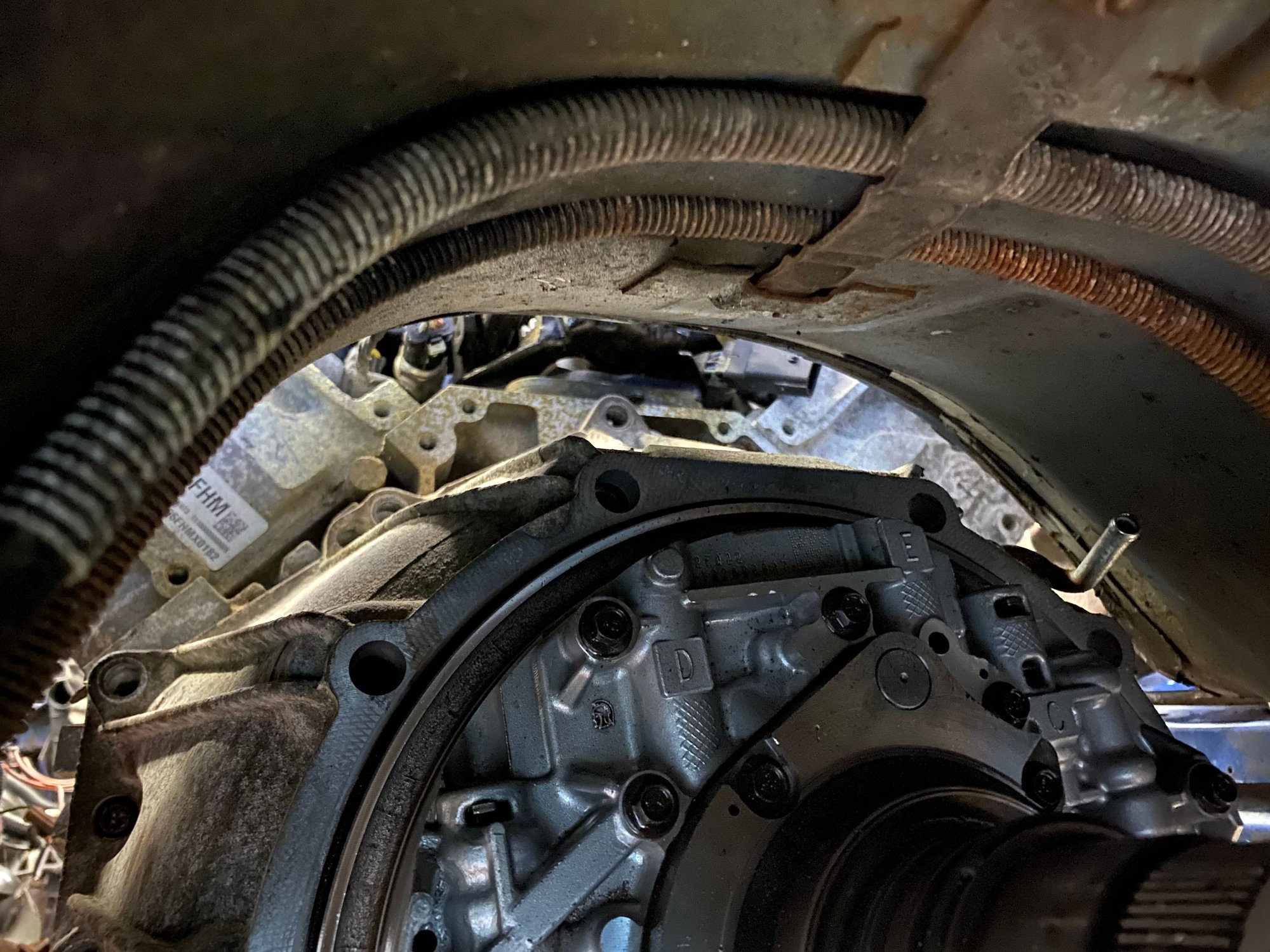

Is it just me, or the angle of the photo, but the 6l80e looks shorter than the 4l70e.
I lined them up multiple times because yea I think it actually is a little shorter.

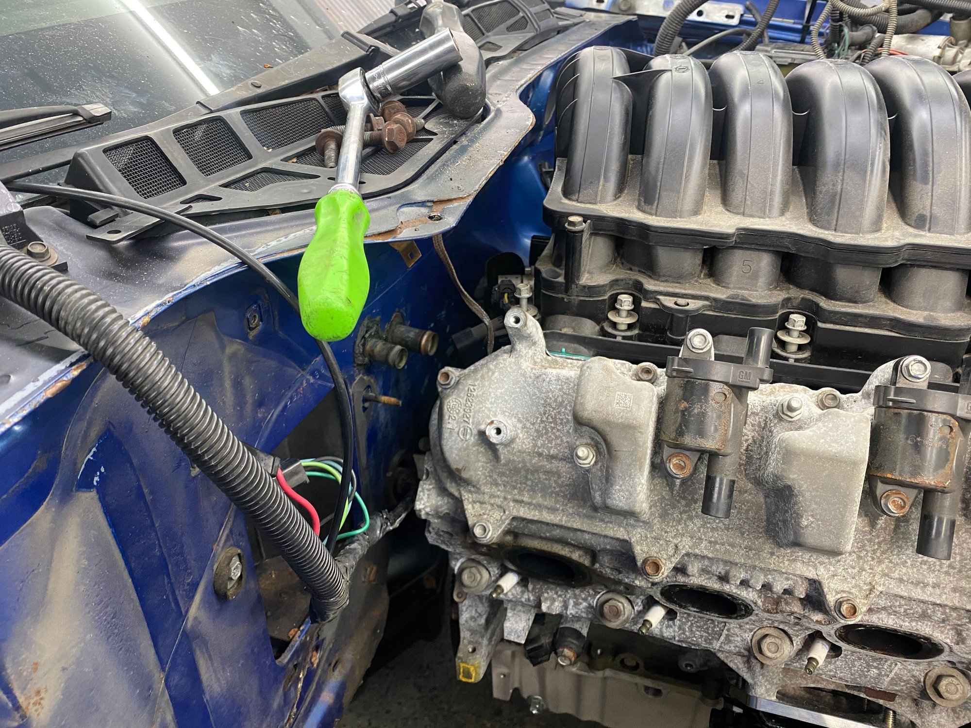

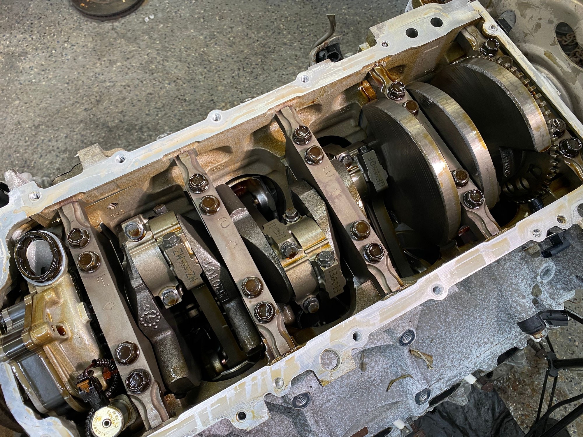

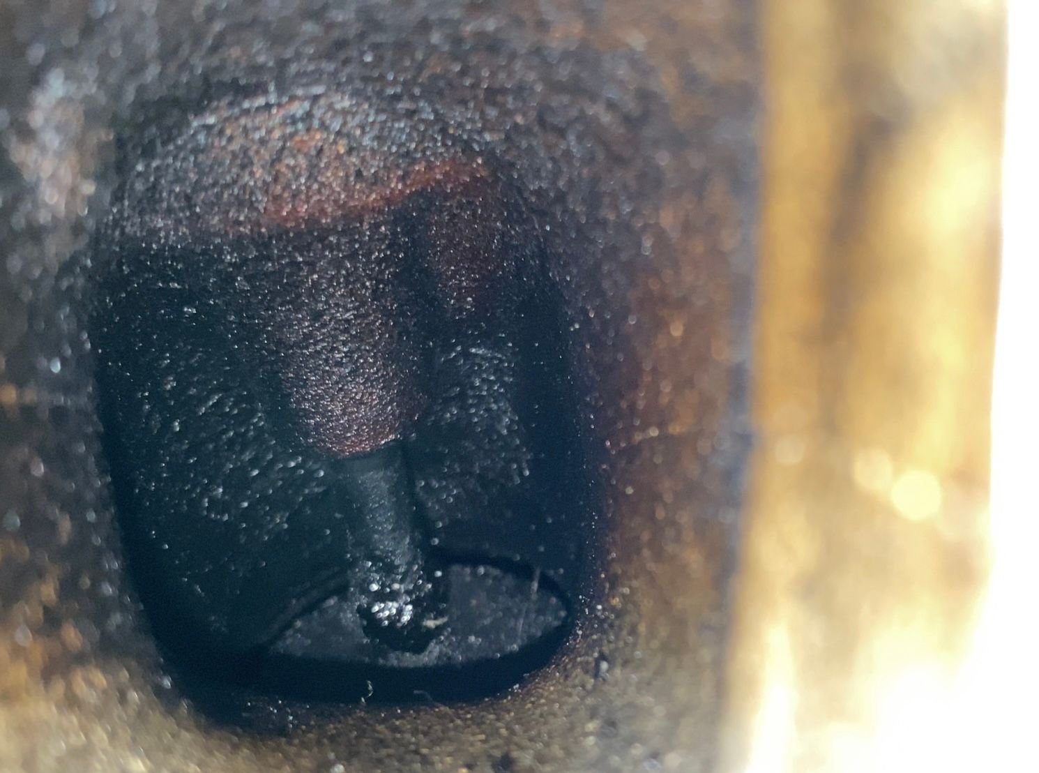

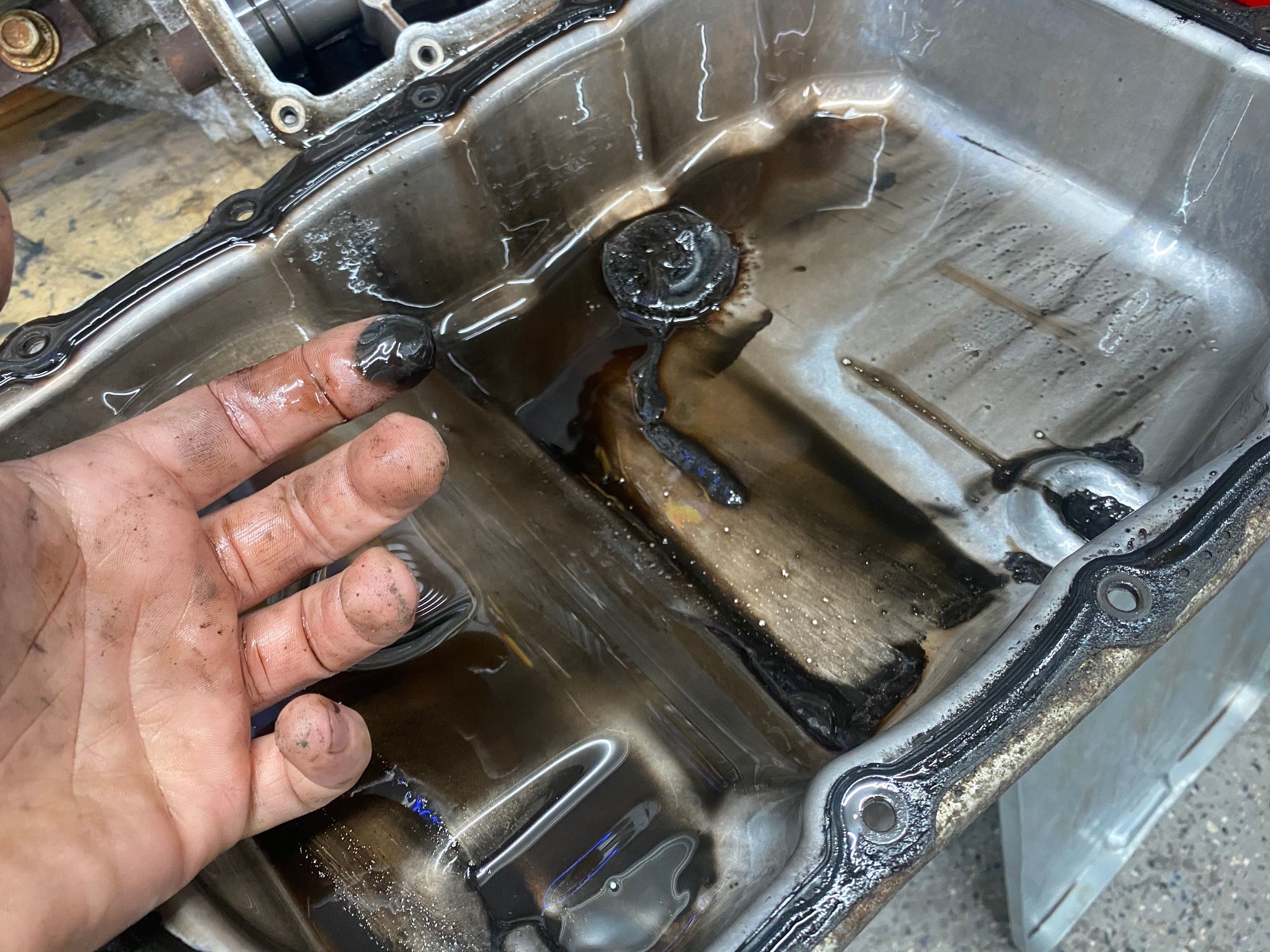

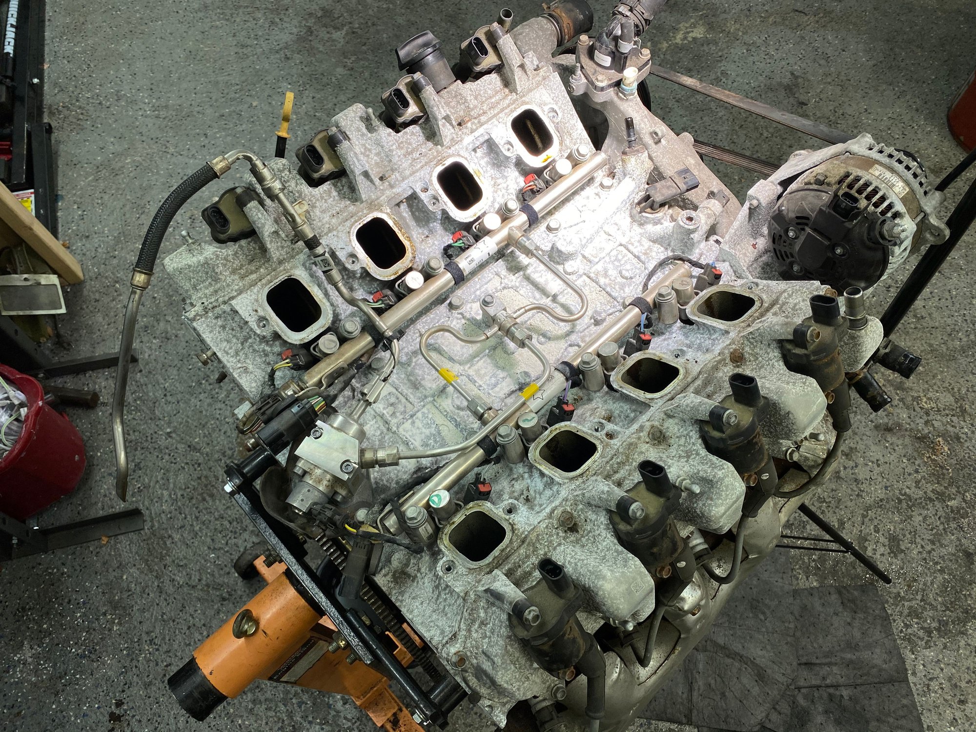

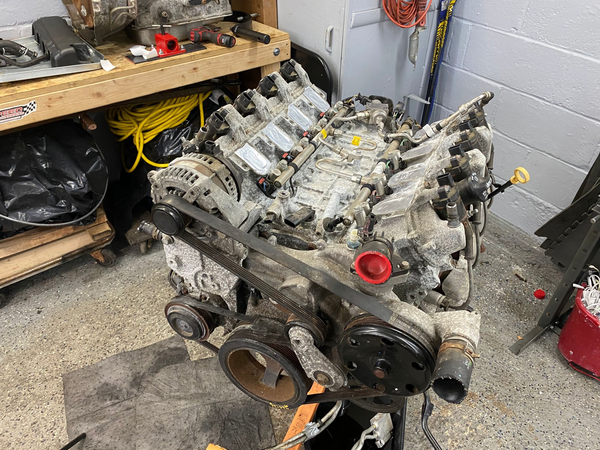

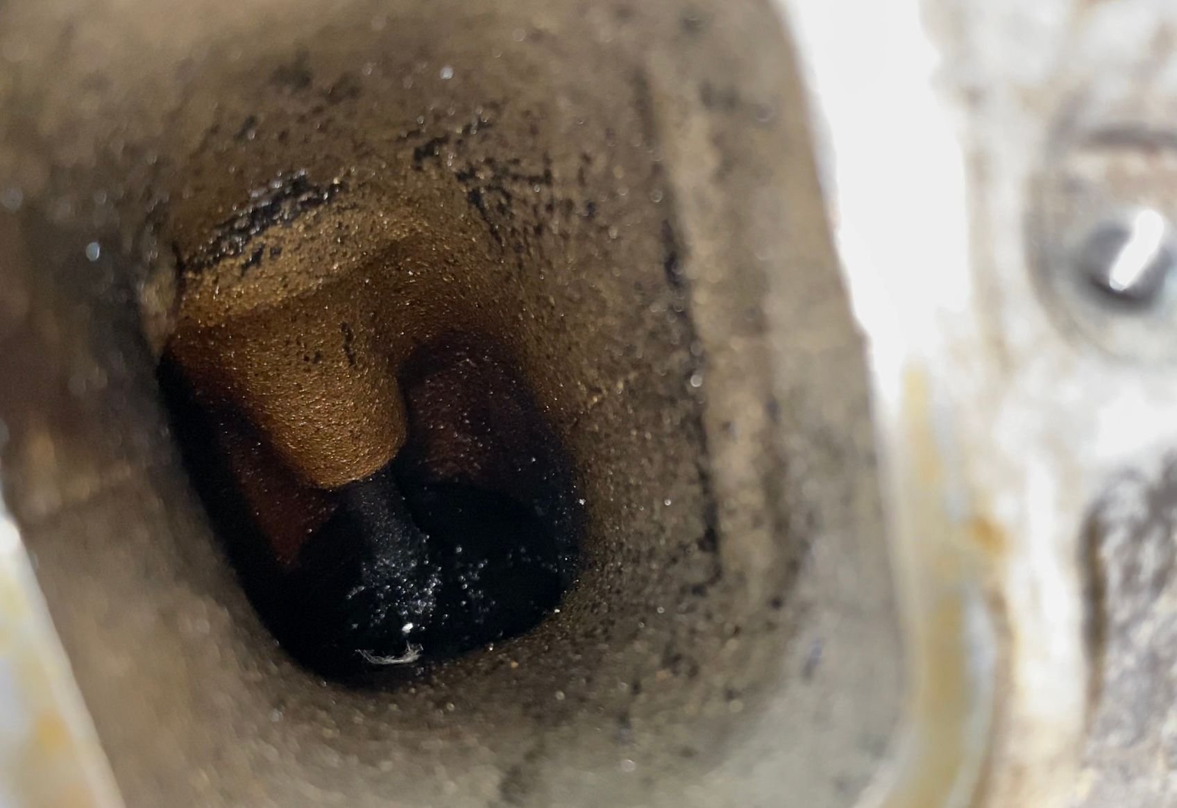

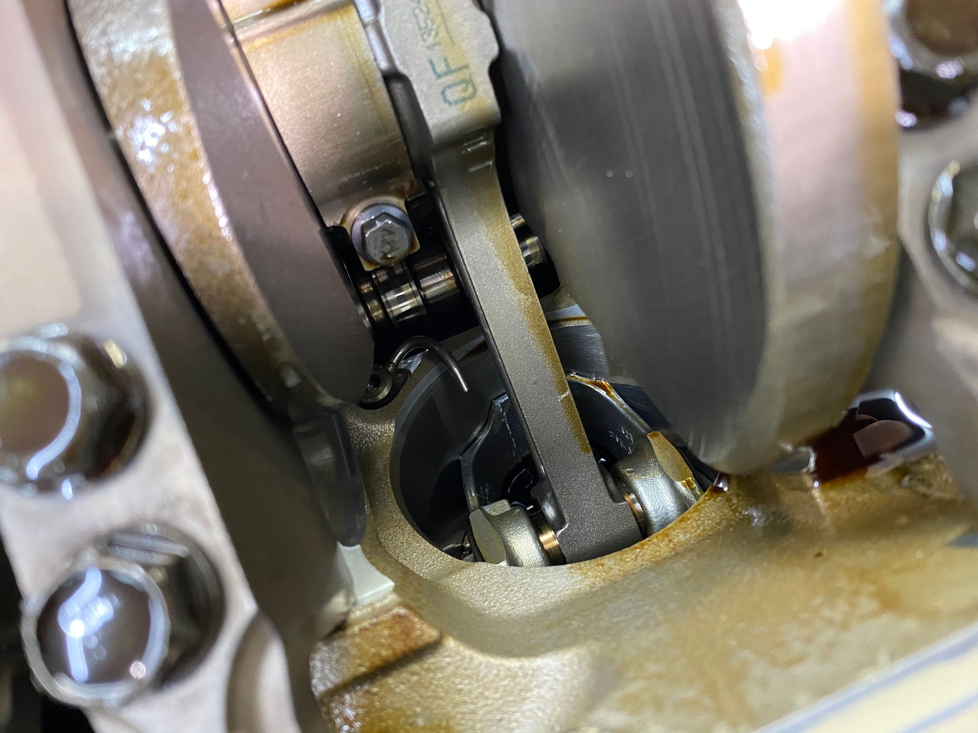

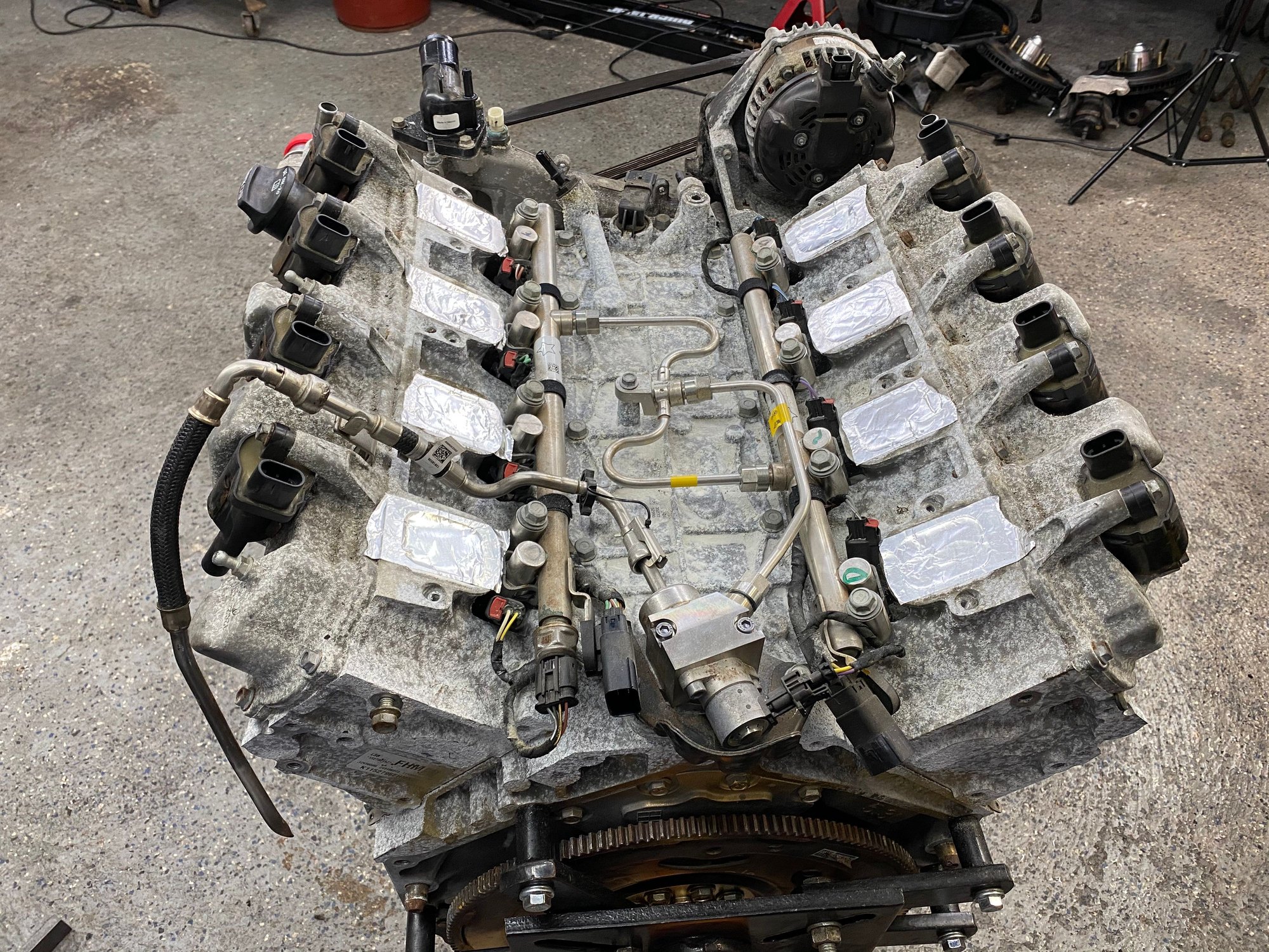

I finally found some time this morning to dig into the l83. Aside from looking like it came out of a river, everything seems to be there. The valves are actually pretty gunky and I have no plans of pulling the heads so I’m not sure how I want to clean them. I’m considering throwing some seafoam through a vacuum line when it’s back together. I also removed the vacuum pump and it won’t be going back on as I’m not keeping afm. The Holley pan comes with plugs for the oil feed and drain ports, but I found an adapter from erl’s that steps the 12mm feed port down to a 1/8 so that seems like a good spot for the 3rd gen oil gauge sender. Tomorrow I’m putting on the mounts and oil pan then dropping it in for a test fit.

Do you know what application it came out of? How does the bottom end look? Or are you waiting for the new pan? That is kinda gunky. Must have gone a ways between oil changes and used crappy gas.
Old Oct 28, 2020 | 06:37 PM
It came out of a 2016 Yukon. I’ll be pulling the pan tomorrow so hopefully it doesn’t look like that inside. Its common for DI engines to get gunky on the intake valves as they’re not getting constantly sprayed with fuel. A catch can will probably help, but I think sea-foaming every few oil changes is probably the better option.
Agreed. I'd take a small pic and knock off the heavy stuff and shop vac it out. Rotate each valve closed. The sea foam should work. Catch cans are good for any LS/LT. I know you're going N/A at first but use -8 for future boost plans.

I'm surprised at 65k and 4 years old that the aluminum looks as scaley as it does but it doesn't matter much if the insides are good.
I'd look into walnut shell blasting those intake ports. They don't look terrible but look a little worse than mine with 50k more miles on it. Easy insurance to do now.
An old-school trick (carbureted & no catalytic converter) for cleaning that gunk from the intake ports and valves was to use brown (not Minute) rice. You would rev the engine and pour some brown rice down the carburetor. The rice would "sandblast" the ports and valves and go right out the tailpipe. It's "hard" enough to do the cleaning, but not so hard to damage parts. I have done this in the past. It works.

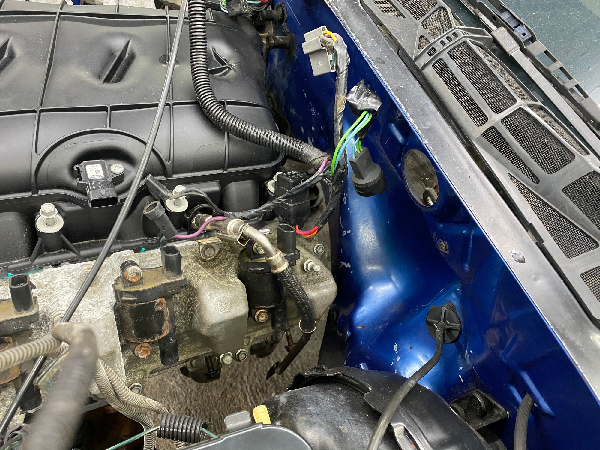

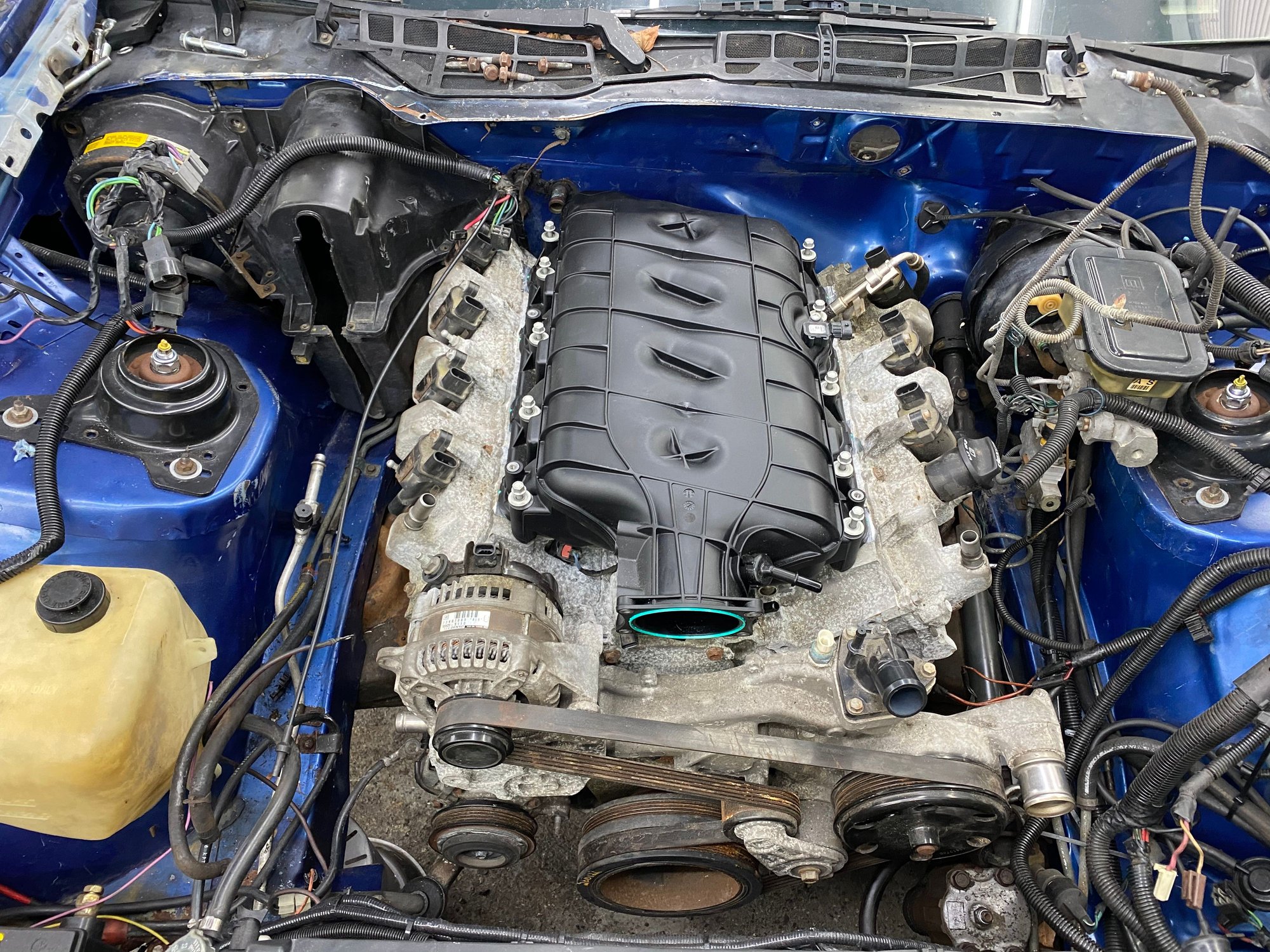

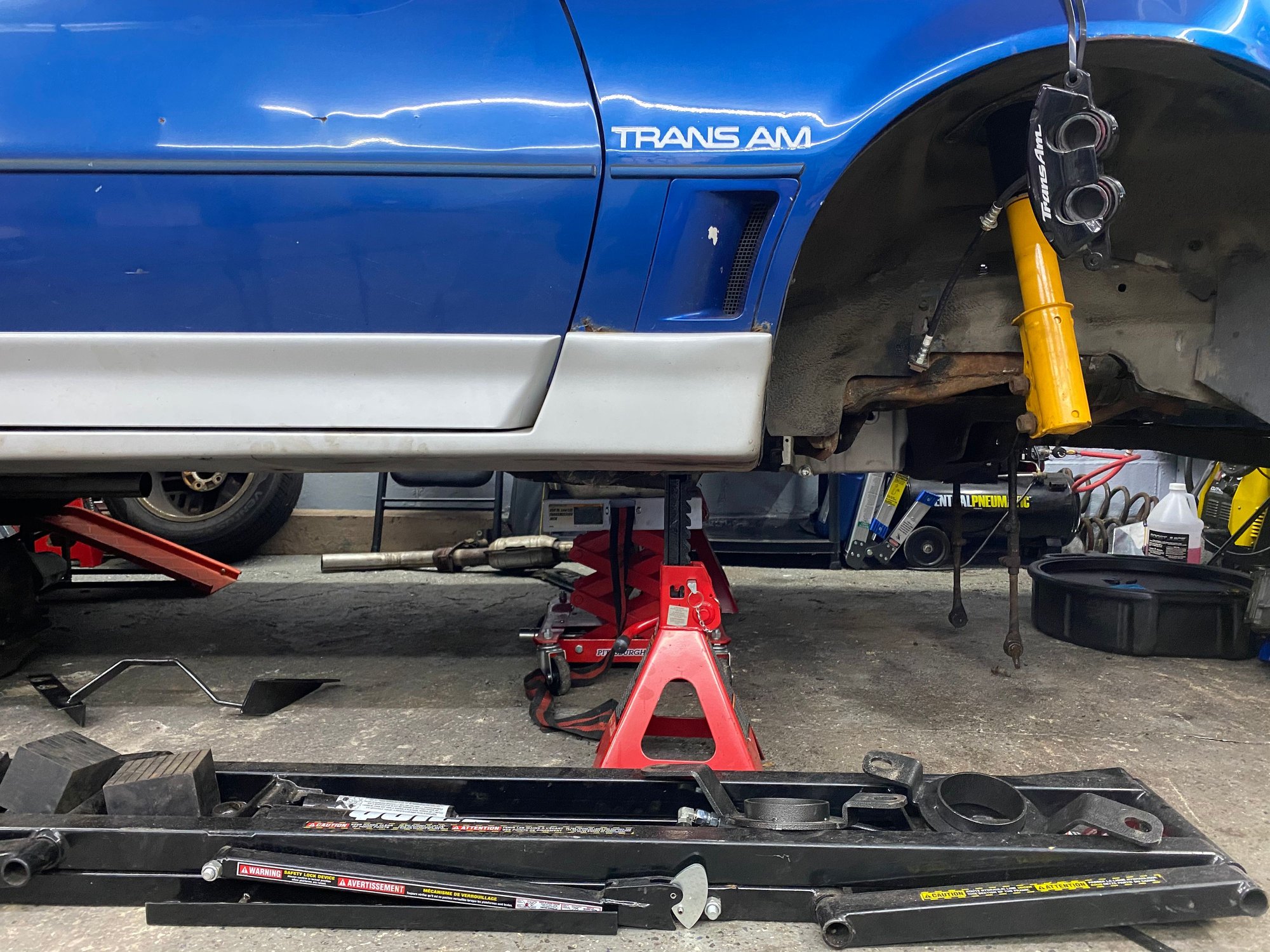

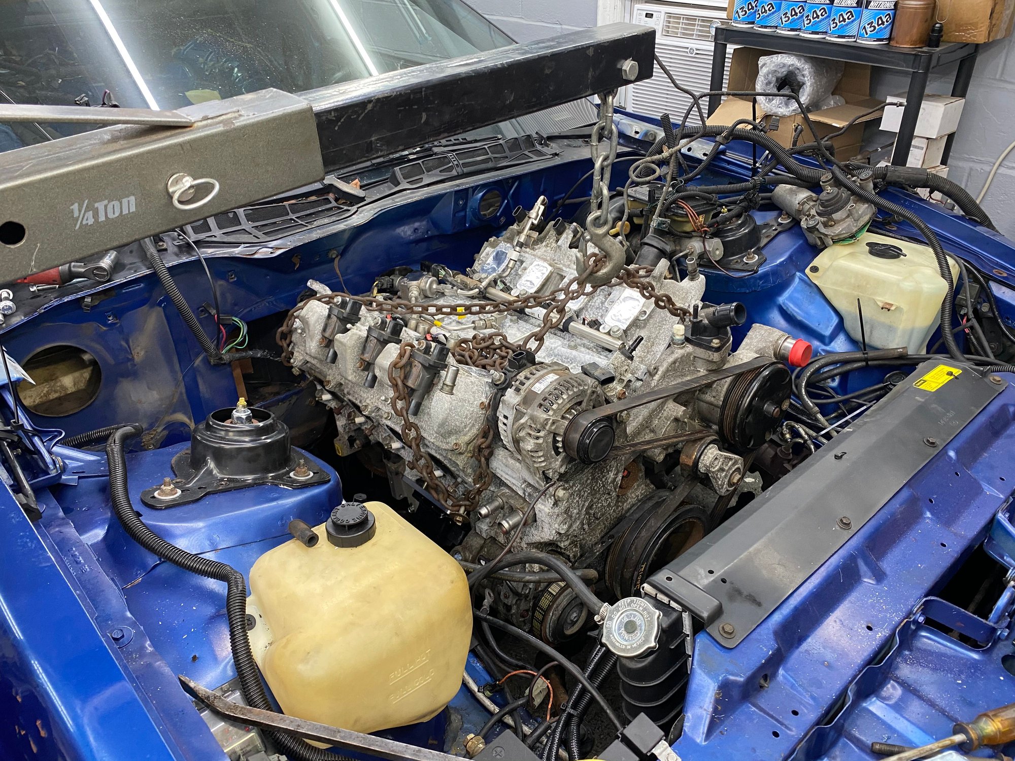

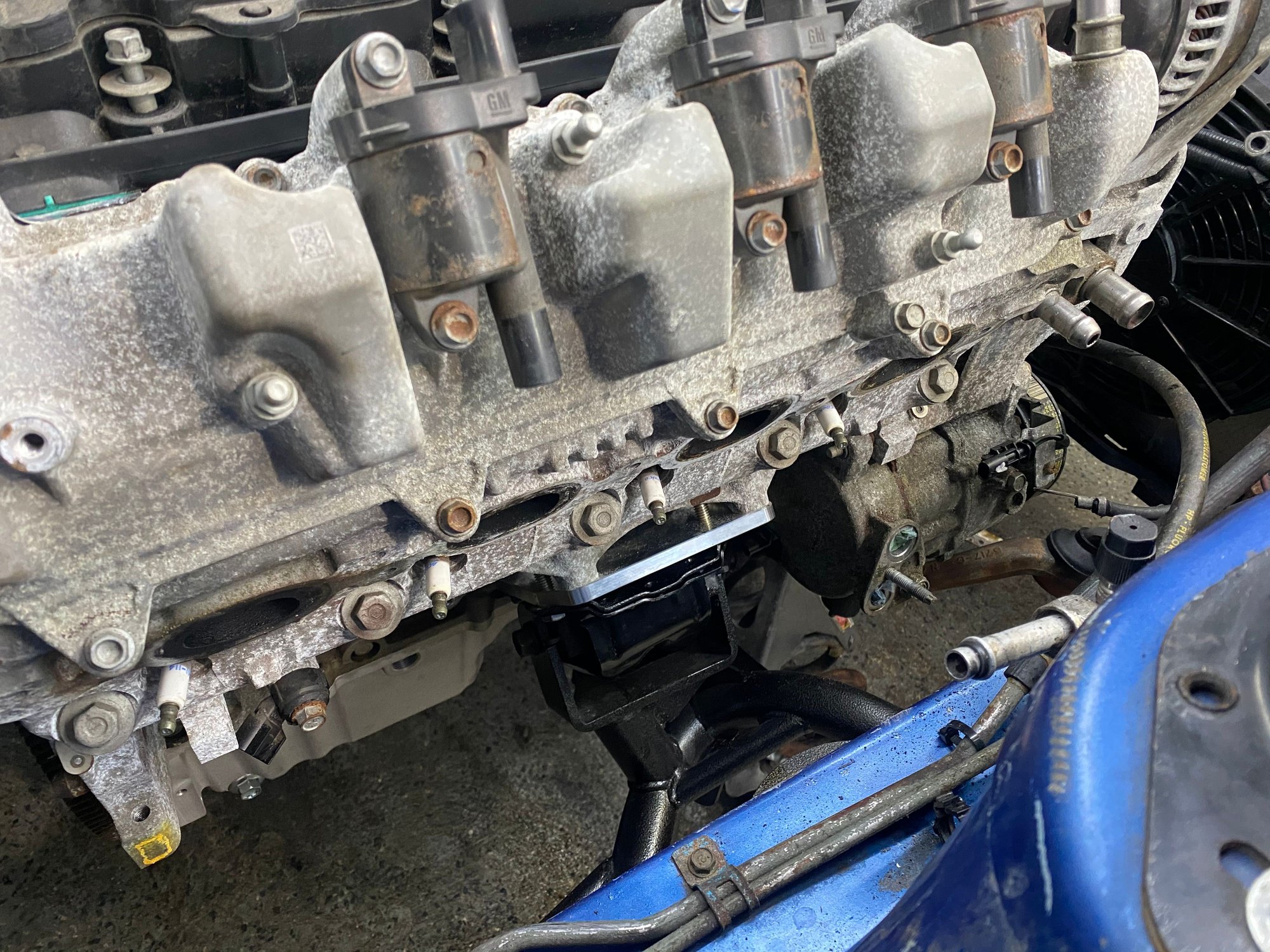

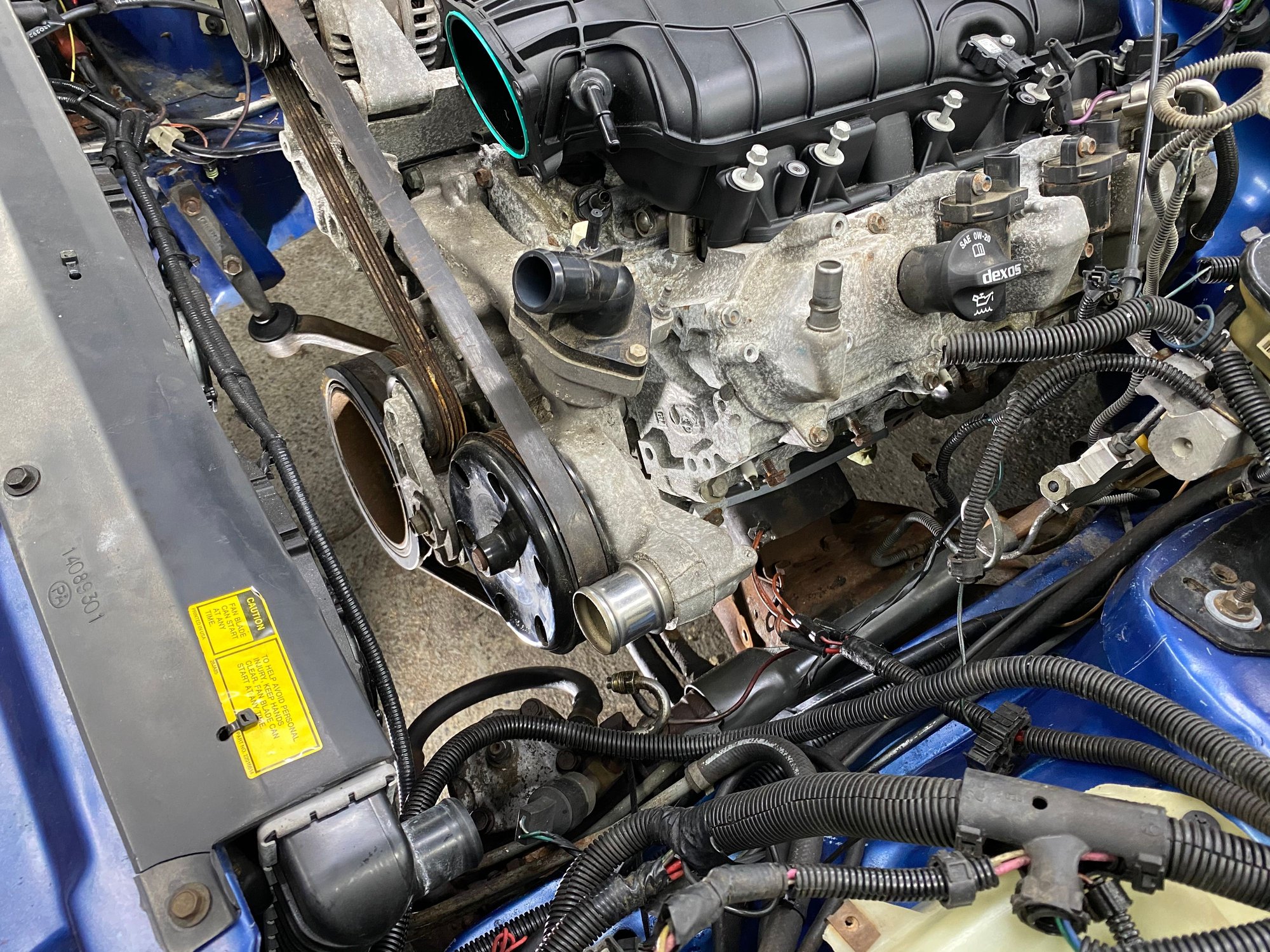

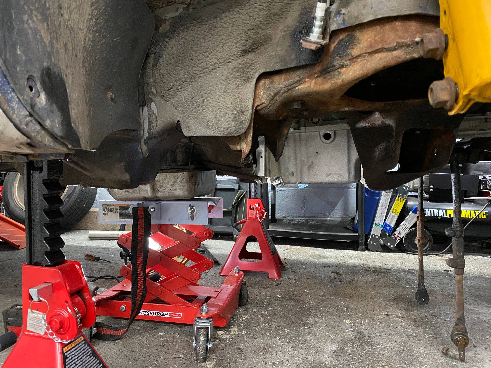

Well the engine is technically in the car, but no where near mounted in place. Unfortunately the mounts I got sit the motor waaay too far back, and while the a/c compressor clears beautifully, the motor sits on the firewall..You can see the heater core is impossible to get to, and there’s no way the a/c box is going back in, plus yeah it’s literally wedged against the firewall. I’m gonna try flipping the mount adapters backwards as it seems it will push the motor about an inch and a half forward. Not sure if this will be enough, but its a start. I also screwed up and basically got the wrong adapters. After taking another look at dirty dingo’s site, they don’t actually have these mounts under the 3rd gen swap section. The only 3rd gen, gen V adapters they sell are the adjustables which use the old stock sbc mounts.
The issue now is that I have an ls swap k member, so essentially the mounts are backwards. All the swap stuff seems to have the fork end on the block and the rubber on the k member. I need 4th gen mounts on the block for this to work. I new I had the wrong stuff when the 4th gen mount was too big to clear the bottom of the block. The bolt holes still lined up though, so I just cut the bottoms down and I’m planning on welding the seam if I get them to work. Also the inside of the motor looks NOTHING like the outside or intake valves. This is very good news
Boy that thing sits high. You going to be able to get the wiper motor back on?
Hopefully. The back isn’t down all the way so its sitting higher back there. I think there will be enough room once I get the correct mounting and get it off the firewall.

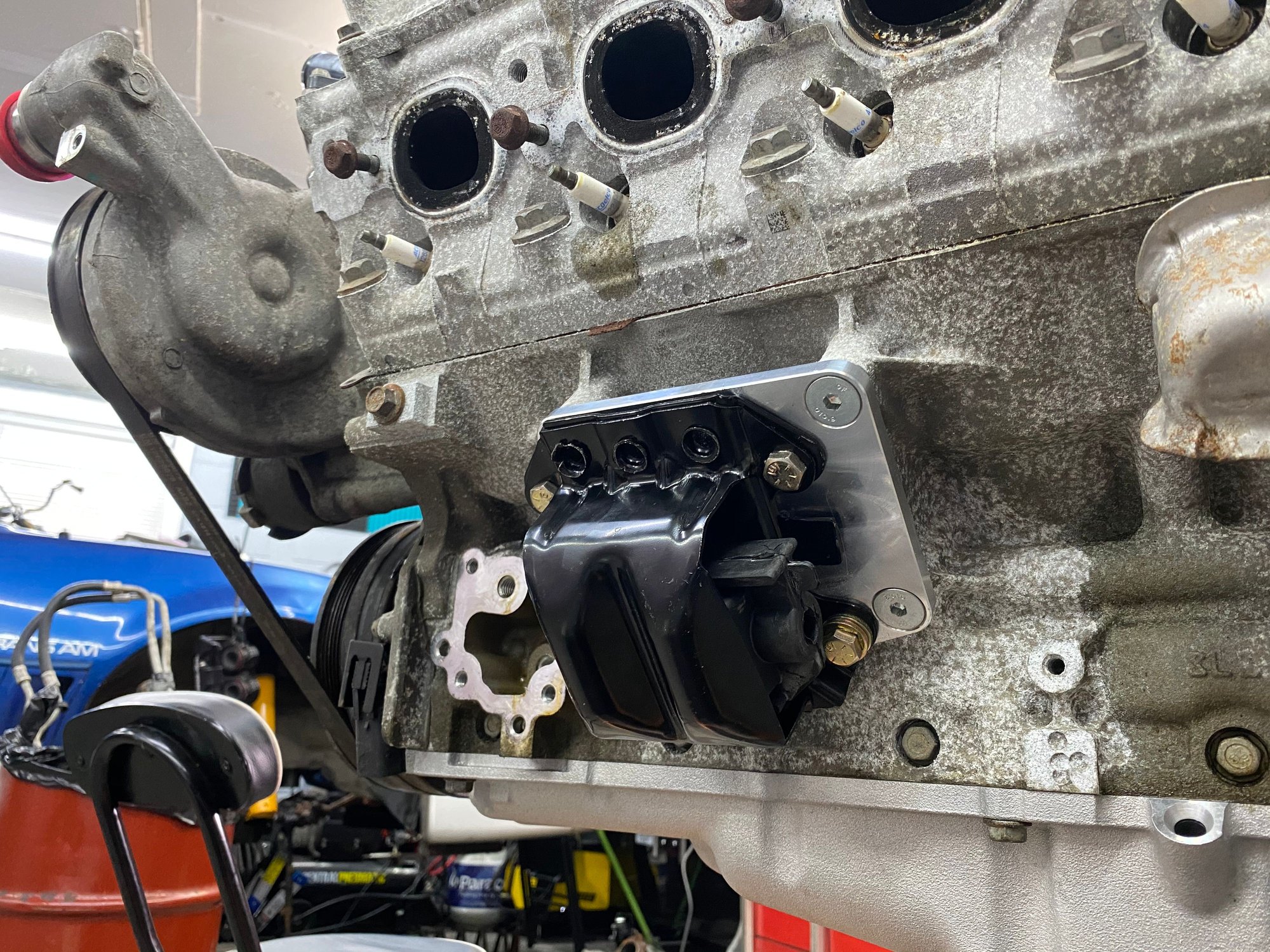

You're making good progress. Based on your images, I would venture to guess that the Hooker Blackheart LT clamshell brackets I referenced previously would lower your engine 3/4" from where it is now and move it forward by the same amount. The torque of that LT engine is also going to eat up those rubber motor mounts in pretty short order. We've had a couple of guys here at Holley try to use them in mild LS swap builds and they don't seem to last beyond a few months.
Thanks for the tip with the mounts. I ordered the lt clamshells from Holley along with their poly inserts.

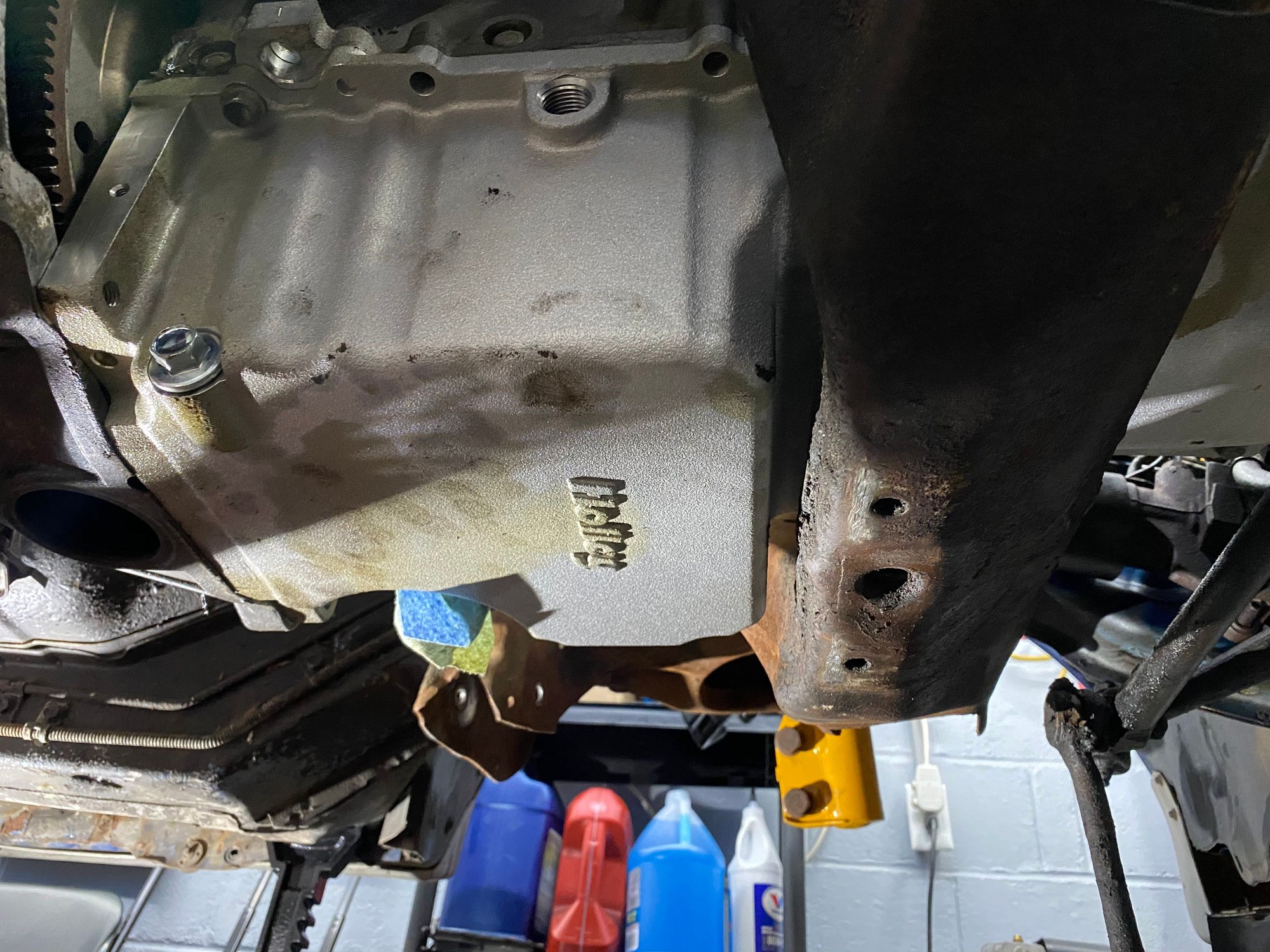

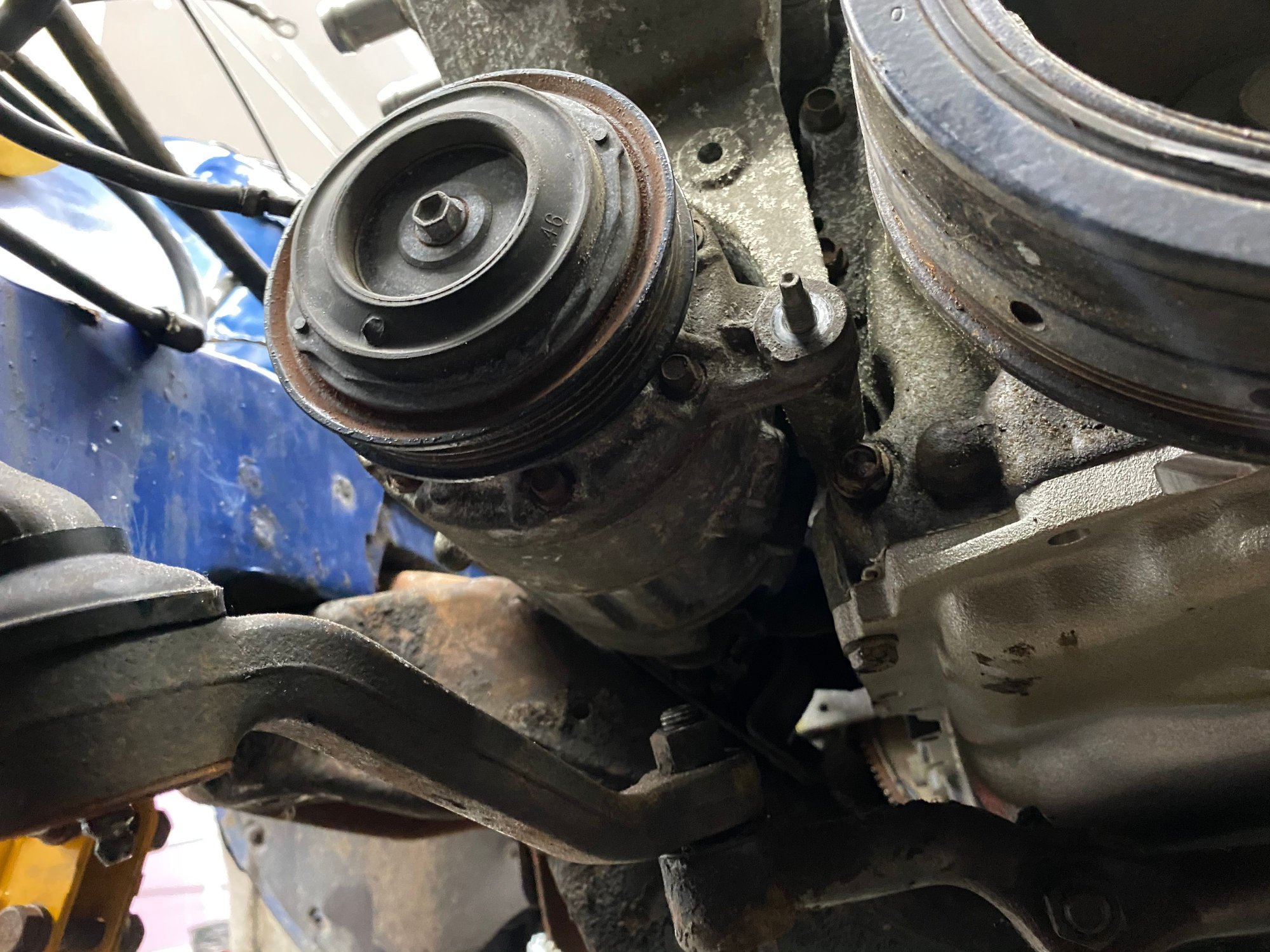

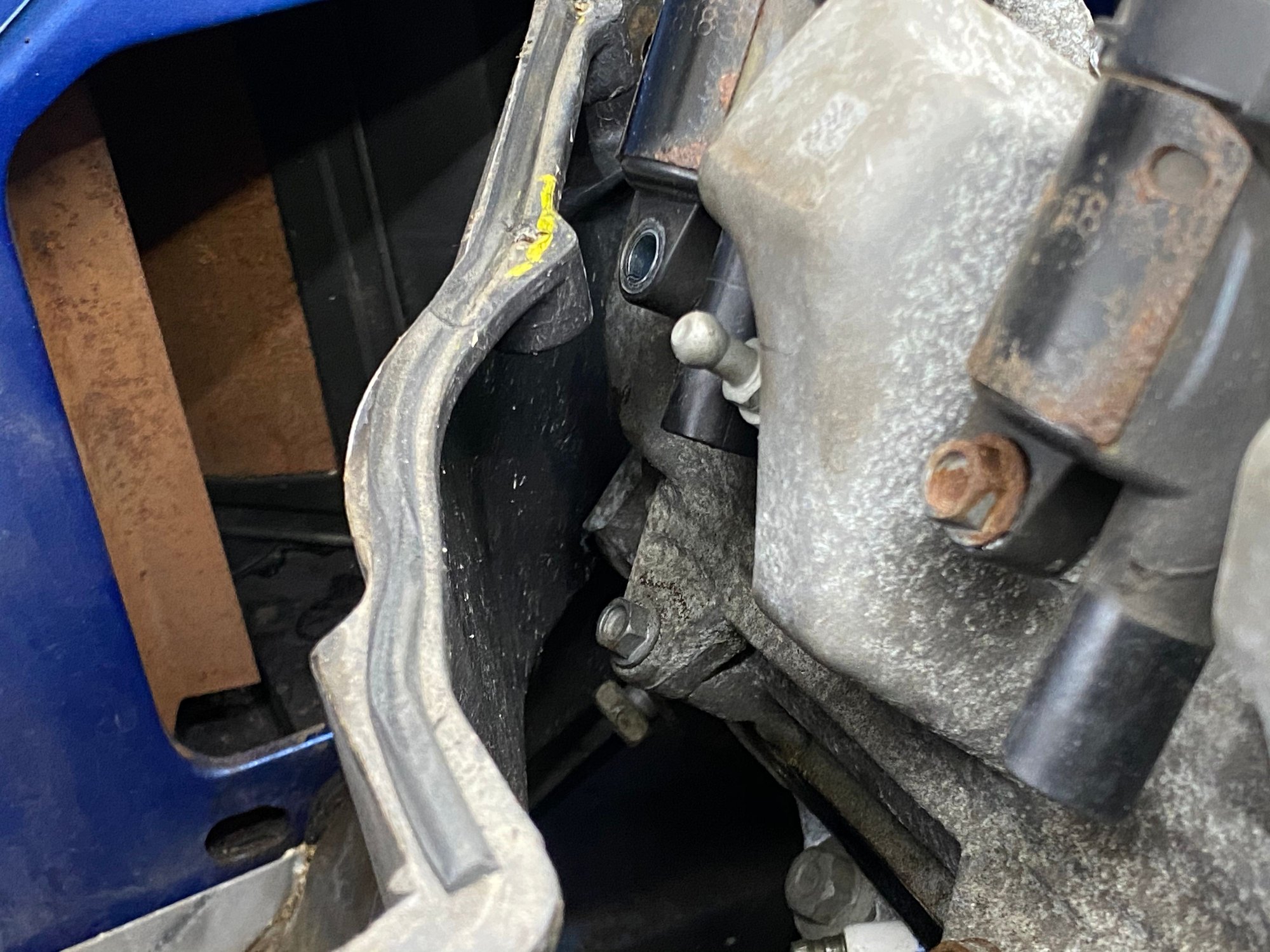

Well just for fun I decided to pull the motor back out and try flipping the adapter plates from driver to passenger side. This helped greatly and moved the motor forward about an inch and a half, and I was able to slide the bolts through. Its no longer touching the firewall, and the a/c compressor has miles of space. It’s still sitting high though, and the truck intake still seems like a no go at this point. I talked with Matt at Tunetime Performance and he gave me an lt1 intake to play with and it clears a little better...
The Holley lt clamshells came in today, so after I swap them in the height SHOULD be the best its gonna get. My only real concern at this point is the bell housing clearance with the bottom of the firewall. After the new mounts are in I’m planning on tearing the trans apart so I can test fit the case, or at least just the bell housing.

I’m really trying to keep the low mount a/c. Umi states that you can’t keep it with their k member.

Ok I’m finally started to get somewhere! I pulled the motor and put the stock k member back in. I mocked everything up with the worn out 30 year old mounts and it still fits perfect. The motor is sitting substantially lower and far enough forward that I can get to the bell housing bolts from inside the bay. The oil pan has plenty of space around the k member, and its only going to get better when I swap in the poly mount inserts. I can get the compressor back on by trimming the unused section of the mount adapter off, and ict billet confirmed this as well. With the motor this far forward it seems like the transmission should tuck up pretty well. I’m gutting the case next week then I’ll be mocking the trans up to see where it falls. The wiper motor will also clear now, and the a/c box fits as well. It might need a small amount of trimming to ensure the valve cover doesn’t rub, but its in there!

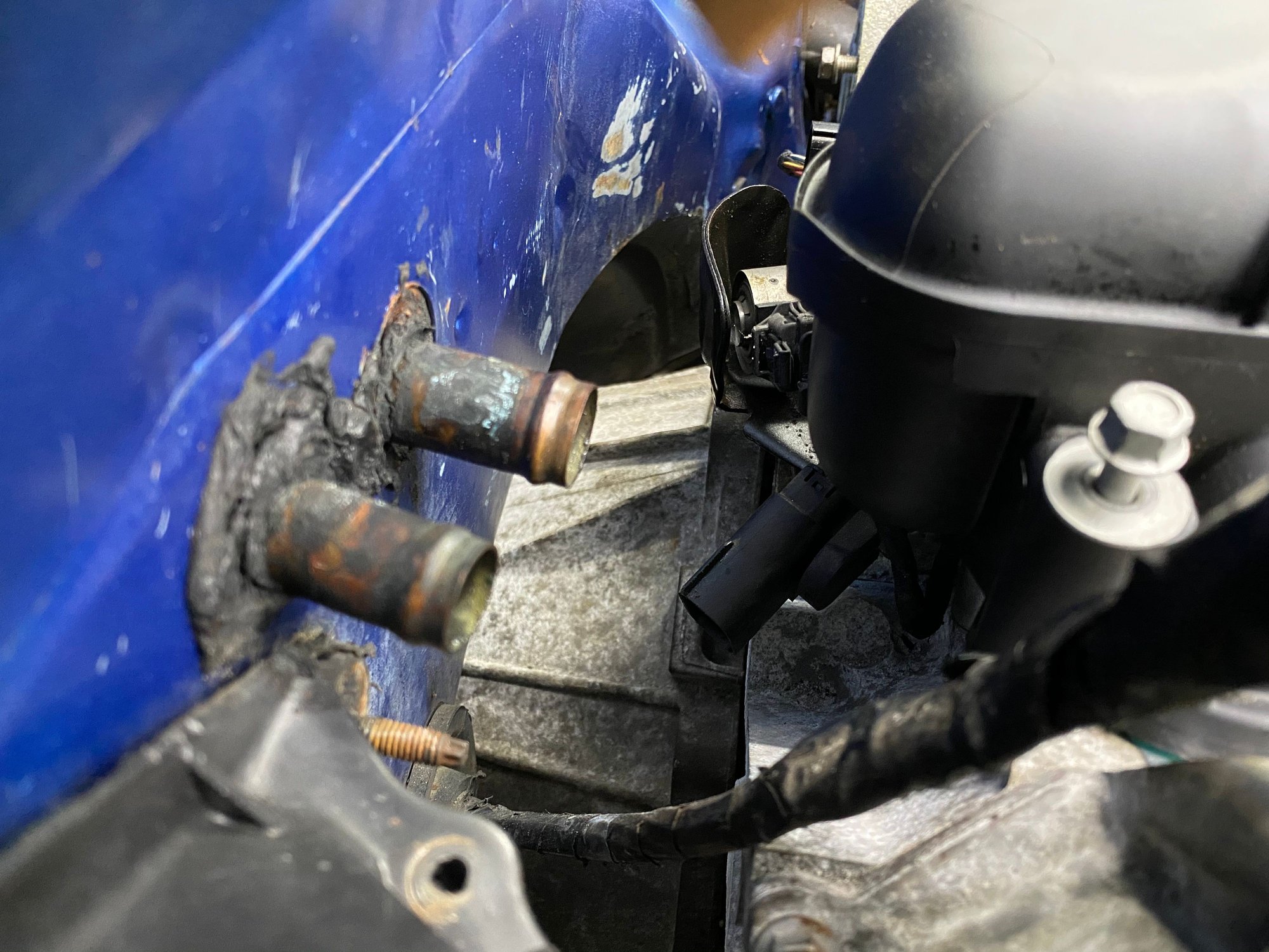

Ok the engine is in it’s final position. I ended up moving the motor mounts one position forward on the ict billet plate. This moved the engine back another 1/2 inch. Doing this gave me a little more space between the accessories and radiator, as well as allow for some more up and down wiggle room with the oil pan and crossmember. This is also the furthest I can mount the motor while still fitting the truck compressor. I still might ding or notch the k member by the hose connections being I don’t know how big the hose bulkhead is going to be. The best part is I can still EASILY remove the compressor with the motor bolted in. The a/c box clears as well, but I might notch that connecting flange a little being it will sit slightly higher with the new mounts that won’t be 34 years old.. Also theres a small connector on the very back and bottom of the compressor. Its not for the clutch so I’m assuming its a pressure switch/sensor. I’m planning on cutting away the plastic from the pins so I can bend them at a 90 and solder on some extension wires. It comes straight out and is almost touching the clamshell, so there’s no way the normal connector will work, assuming I use it.
Finally I gutted the trans and got the case into position. The bell housing clears without an issue, and the trans mount is only an inch or two forward from the old t-56 hawks crossmember I had on hand. I need to get driveline angle measurements before making/modifying a final crossmember, but for now the trans is centered in the tunnel and I’m very happy with space I have around the tail shaft. A crossmember mounted torque arm doesn’t seem like it would be an issue. For the height, she is a bit low.. Keep in mind its nowhere near its final position, and there’s still some room to move it up, I just couldn’t clear another tooth on the jackstand. I heard somewhere that a G8 pan is shallower so I will look into that. I’m probably going to ding the tunnel in a few places as well, but honestly I’m just going to be aiming for as close to 0 degrees I can get on the tail-housing. I have no plans for lowering this thing, so I won’t be stuffing it up as high as possible. I just want to get it to the point where the angles are correct and everything is happy.
Next step is to yank the motor, clean it up really nice and spray the bay. After that I’m moving onto the wiring and fuel system, and finally I’ll finish up the trans crossmember, driveshaft, and torque arm.

Wow, the 6L80 hangs down low. I had one for my '66 but I was going to have to tunnel the car to bring the driveshaft up enough (because air ride). Ended up bailing it and going with a 4L80. Good luck! The LTx content is great.

It looks like you are going to have too much down angle on the engine/ trans. A shallower trans pan would help ground clearance but not the drive line angle. also, the Camaro and G8 trans mount have two mount to crossmember bolts where the truck mount only has one. I tried both and I liked the Camaro better. It is heavier construction and slightly taller.

Yea that truck mount is toast so I'll probably replace it with a Camaro unit. I'm pulling the trans down again tomorrow so I can see where the close spots are and shape the tunnel to fit better.

If possible you may want to try and see if you can use a 5th gen Camaro trans pan as it's slightly deeper than an SS pan but still more shallow then the stock truck pan. I believe it holds about a quart more than a G8/SS pan. The extra fluid provided from the Camaro pan will probably help the longevity of your transmission.

Pulled the trans and shaved down the ribs on the case that were making contact in the tunnel. I saw another thread on here where someone did the same and it seemed to work out. I also had to remove the hold down for the fuel lines, and I’m probably gonna re-route them as well. I slightly dinged in a few spots in the tunnel and got the angle under 3 degrees. I leveled the car out on jackstands, so this number should be pretty close. Ground clearance already looks way better and with a camaro or g8 pan it looks like it will be the same height as the engine k member. There’s about 1/4 of an inch of space between the top of the trans and the tunnel, so before the finally assembly I’m going to ding in a few spots a bit more just for insurance. Really happy with the fitment so far, I’m gonna pull the motor next week and start the bay resto as well as clean up the block.

If you still have tunnel clearance that is great. It's been a long time since I put an angle gage on mine but if I remember right I was at 4 degrees down. Looks like it's going well, good work!
