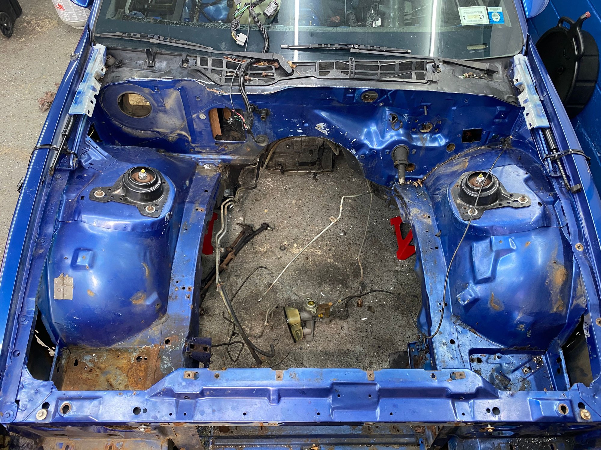

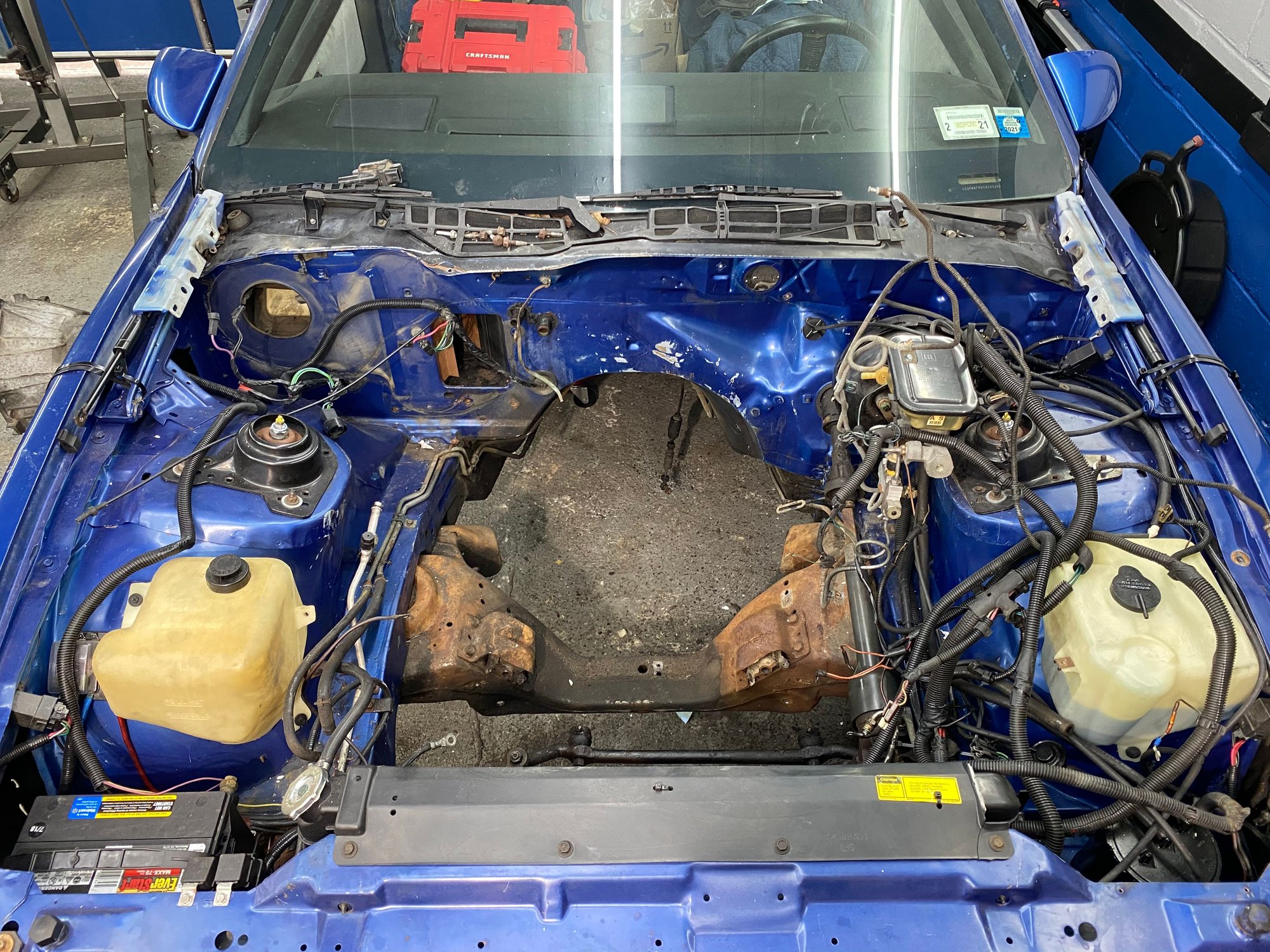

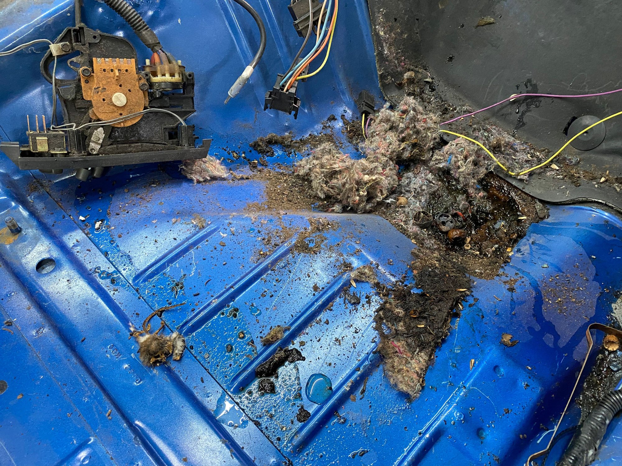

Finally back at it, started tearing the engine bay down to prep/paint. Battery tray was looking pretty crusty so I decided to swap it out. Snow removal slowed me down this week and I only have tomorrow to get some work done until next week. Hoping to at least have the battery tray welded up and the rusty spots sanded down and por 15’d.
I also pulled the dash so I can swap out the water logged firewall insulation. I’m gonna throw a heater core in while I’m at it and I need to fix the munched parts of the dash harness. Yea I finally figured out where the mice got their nest materials from..

Yikes! I'm glad I've never seen evidence of mice in mine... That must be a bear to clean.
Out of curiosity, how tough is it to remove the dash? My heater core has been full of coolant and sitting for ~10 years so it's probably worth changing. I've also got all the wires from pre-LS engine just hanging out waiting to be cleaned up. Or should I go and look for a new video on dash removal on your channel?

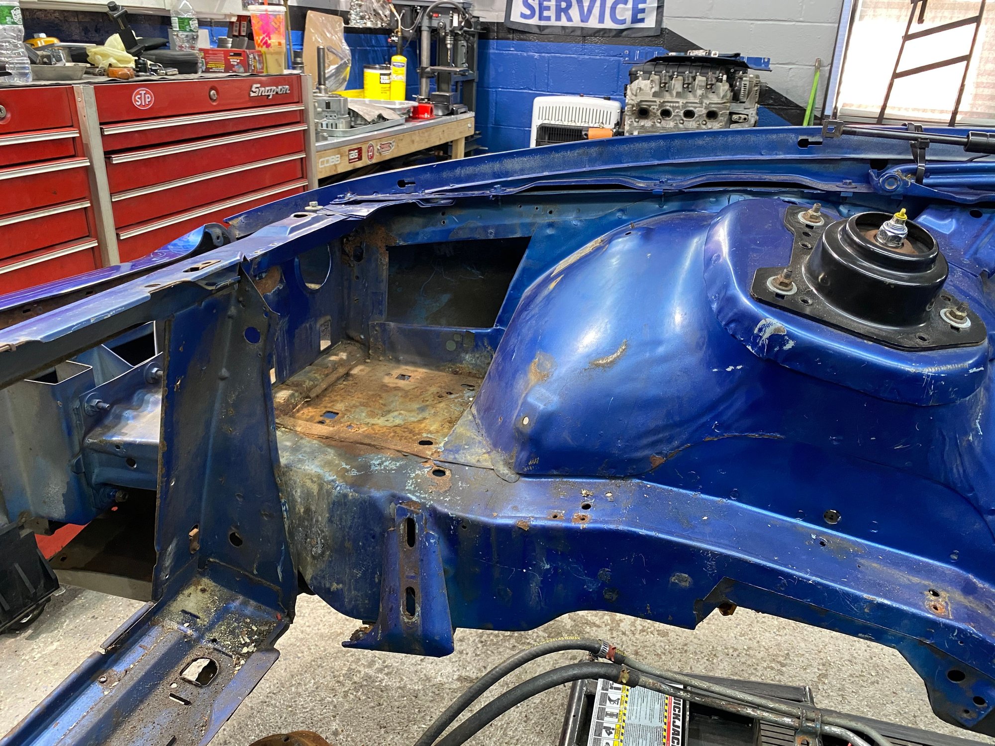

This snow every few days has been killing me on progress! Whenever I work on the trans am I need to pull the Camaro out for space, so whenever it snows that means I need to spend the morning removing it from in front of the garage. Plus I started messing around with stocks so I kill a few hours each morning making mostly stupid trades..

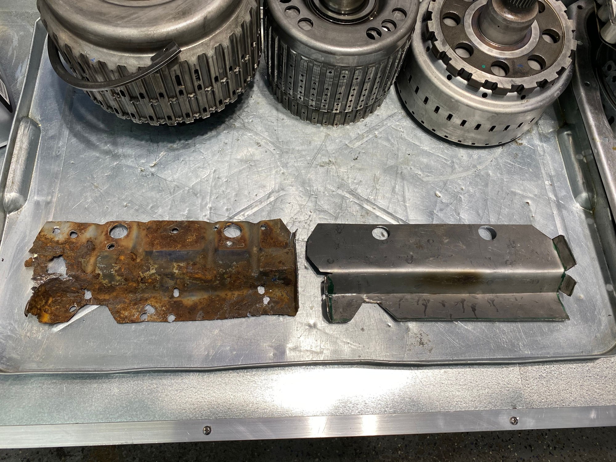

Anyway I got the battery tray welded in and wire wheel’d any flaking spots around the bay. I’ll be back at it all day Monday being I’m off from the day job. I hope to have the remaining rust por 15’d with the bay cleaned and ready for scuffing and primer.
Fabbed this section with the vise and a hammer.

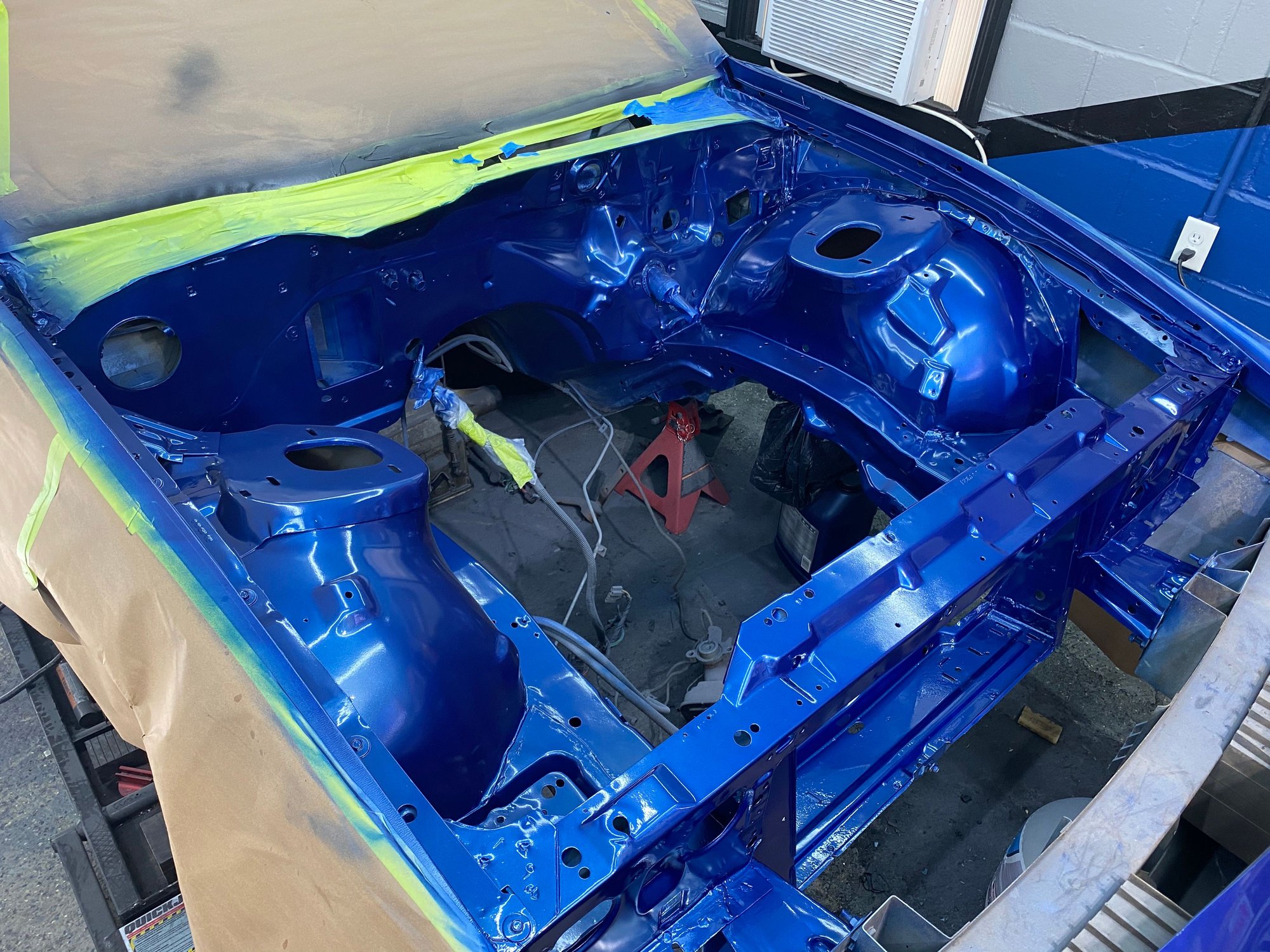

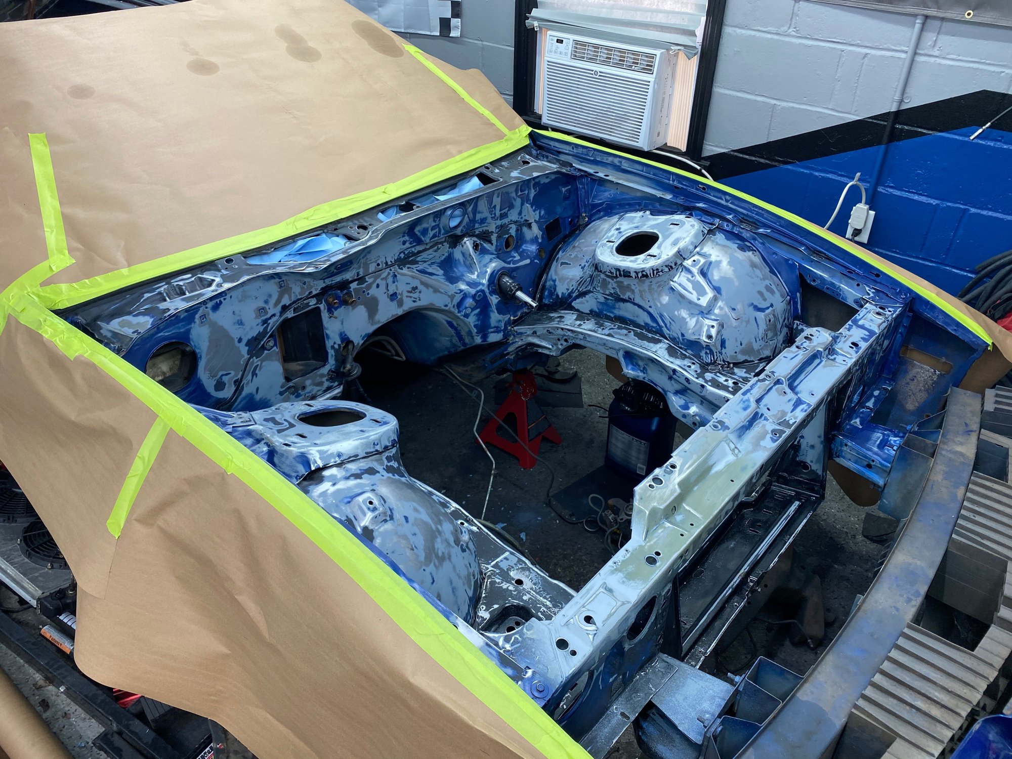

Engine bay painting is done and the video hit youtube today. It took me a whole month to get this wrapped up but I’m really happy with the results. Hopefully the snow backs off so I can rip through the interior prep a little faster. I ended up painting the cowl while I was in there and re-finished the k member with some por 15 and a top coat of satin vht. Next up is heater core replacement, firewall insulation, rust repairs on the floor boards, and sound deadening the entire floor/most of the interior. I’ll keep the updates coming👍

Amazing job!
Especially for a DIY paint-job!

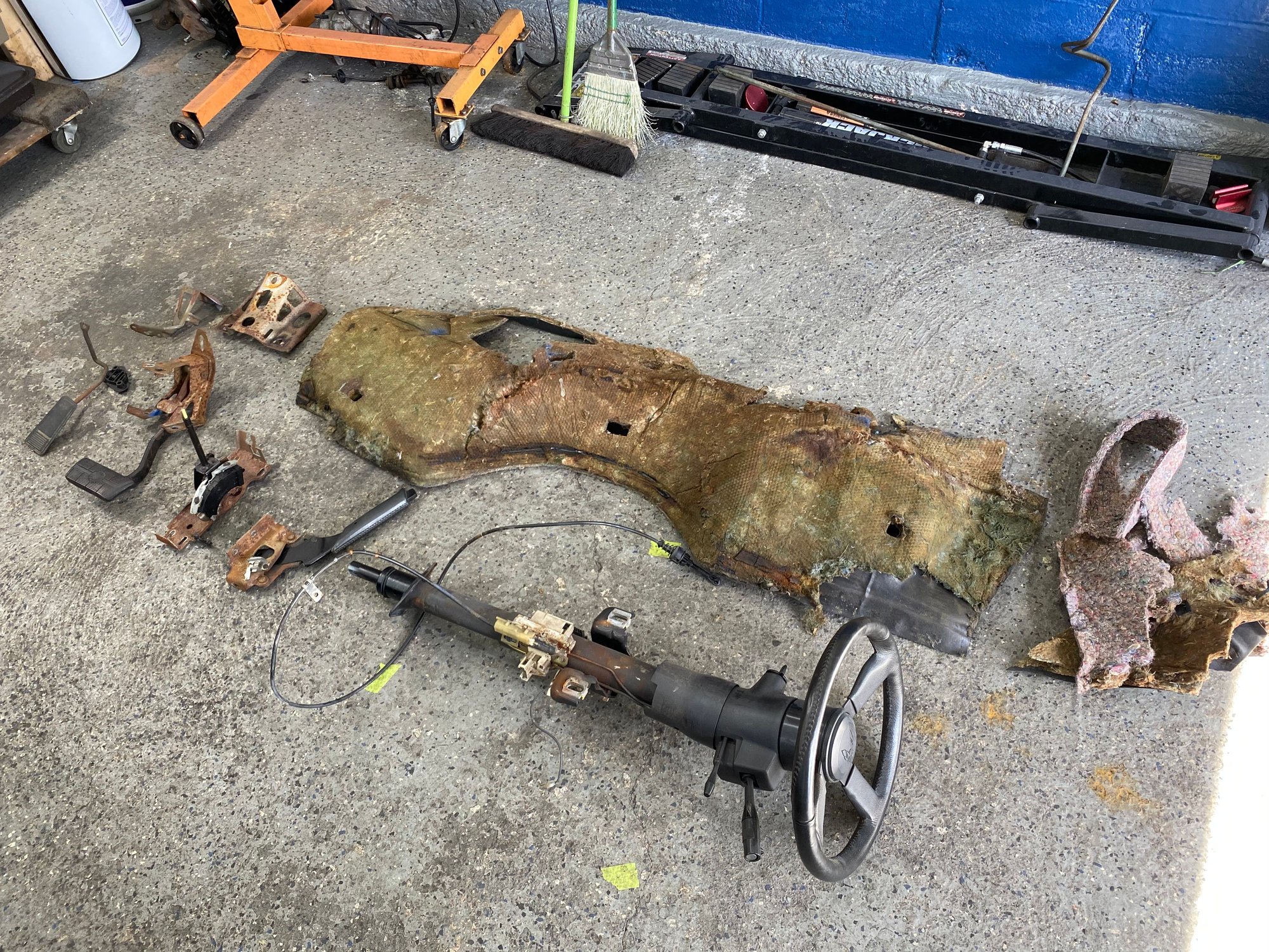

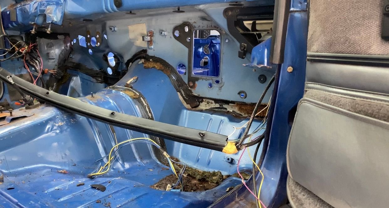

Well I kept peeling back the onion and the interior is no more. I pulled the heater core and found it stuffed with rat **** along with another nest. Also found a dead one on top of it. I have some rust that needs to be fixed, but I’m not sure how I want to go about it. The driver side has some random little holes but overall is solid. Theres also a significant hole right behind the heater box where the floor seam meets the firewall. That should be a simple cut and fix, I just don’t know how much of the driver side I want to cut out and replace. In addition to all that I managed to get some more engine bay stuff painted, and I might just powder coat the column brackets and brake pedal assembly being they’re small enough to easily do. Lastly I got the fuel door cut and the Detroit Speed unit welded in.

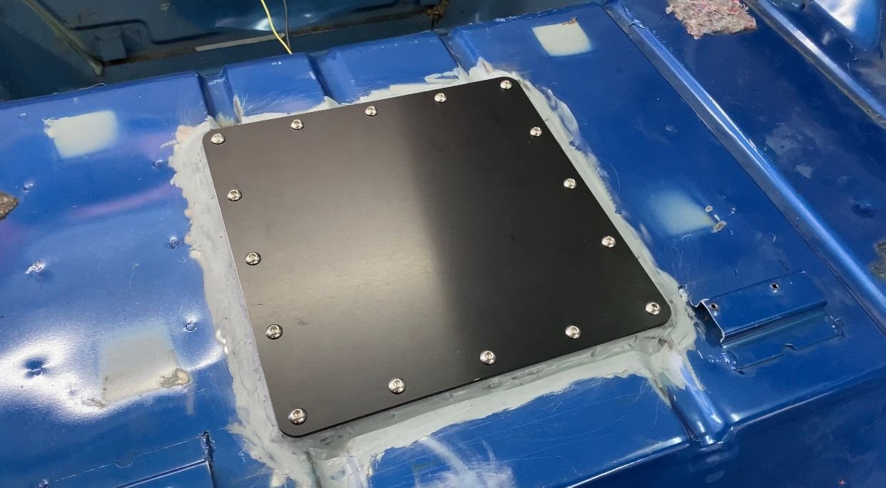

just to clarify, that is the DSE fuel door setup? I might eventually want to go that route. I am surprised they didn't make it an inch bigger on the sides so it had more material at the edge instead of it meeting the Sheetmetal right after the oem stamp/roll/curve. interesting.
engine bay looks great. brings me back to last January when I went crazy inside mine doing all that stuff

The trap door is a generic part, they are really intending it to be welded into a, mostly, flat panel

Yea their door isn’t specific to any car, its a universal part.

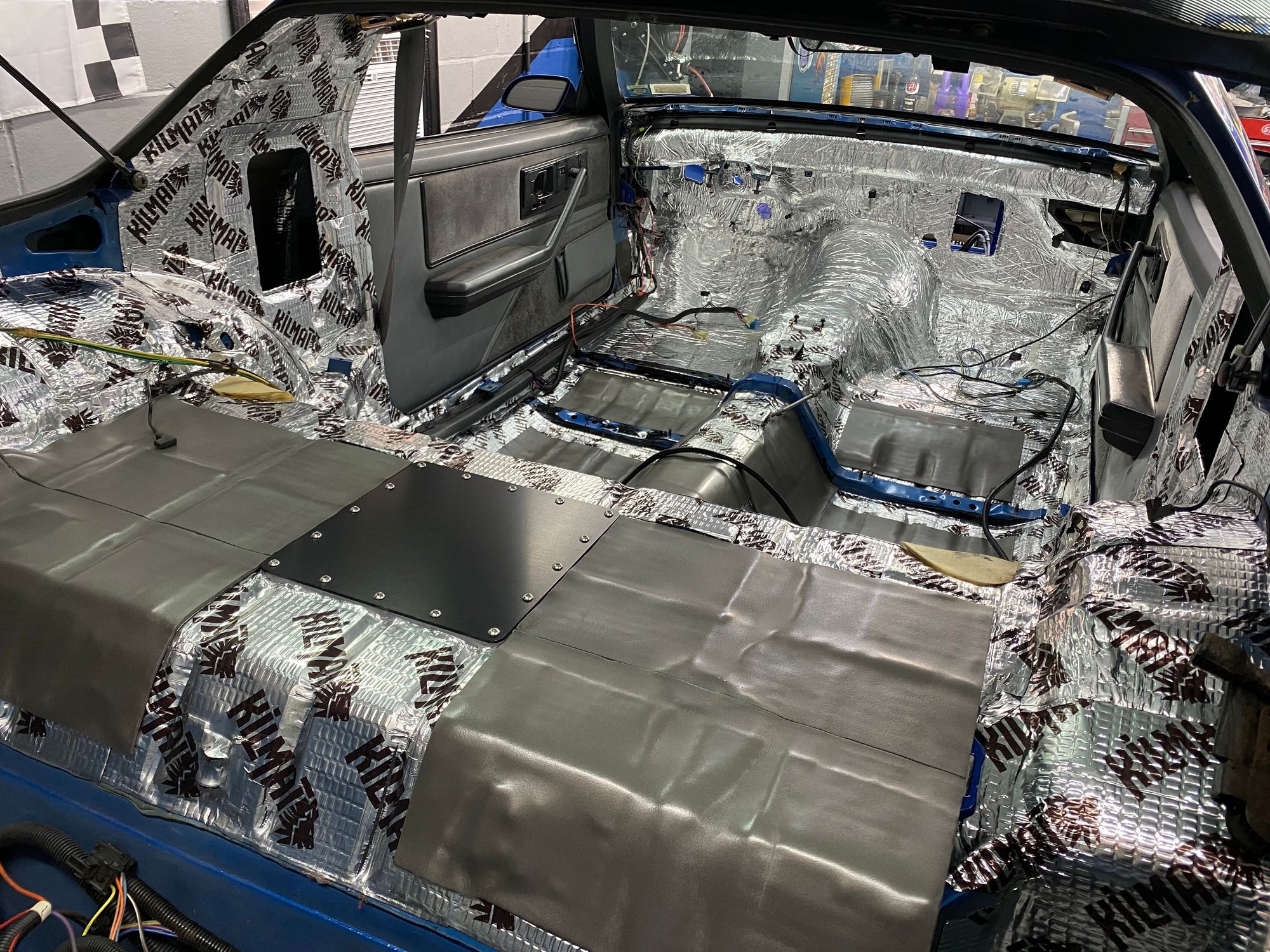

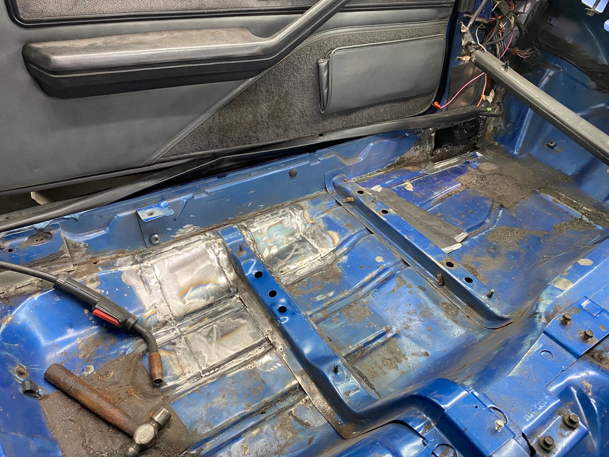

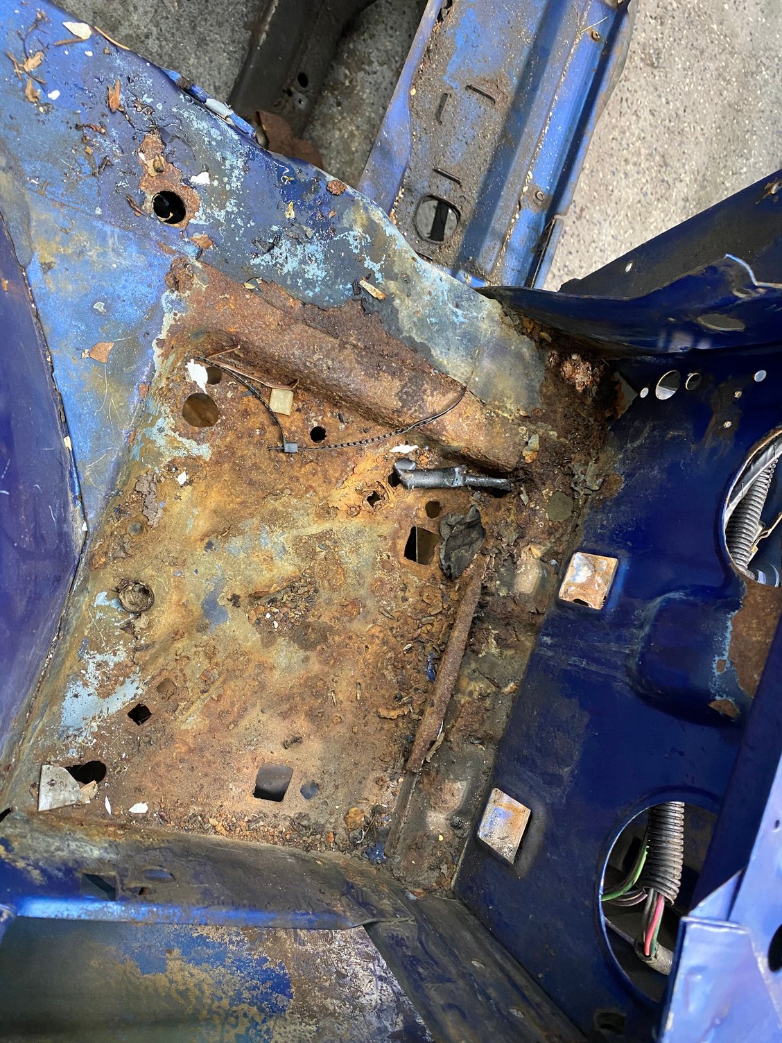

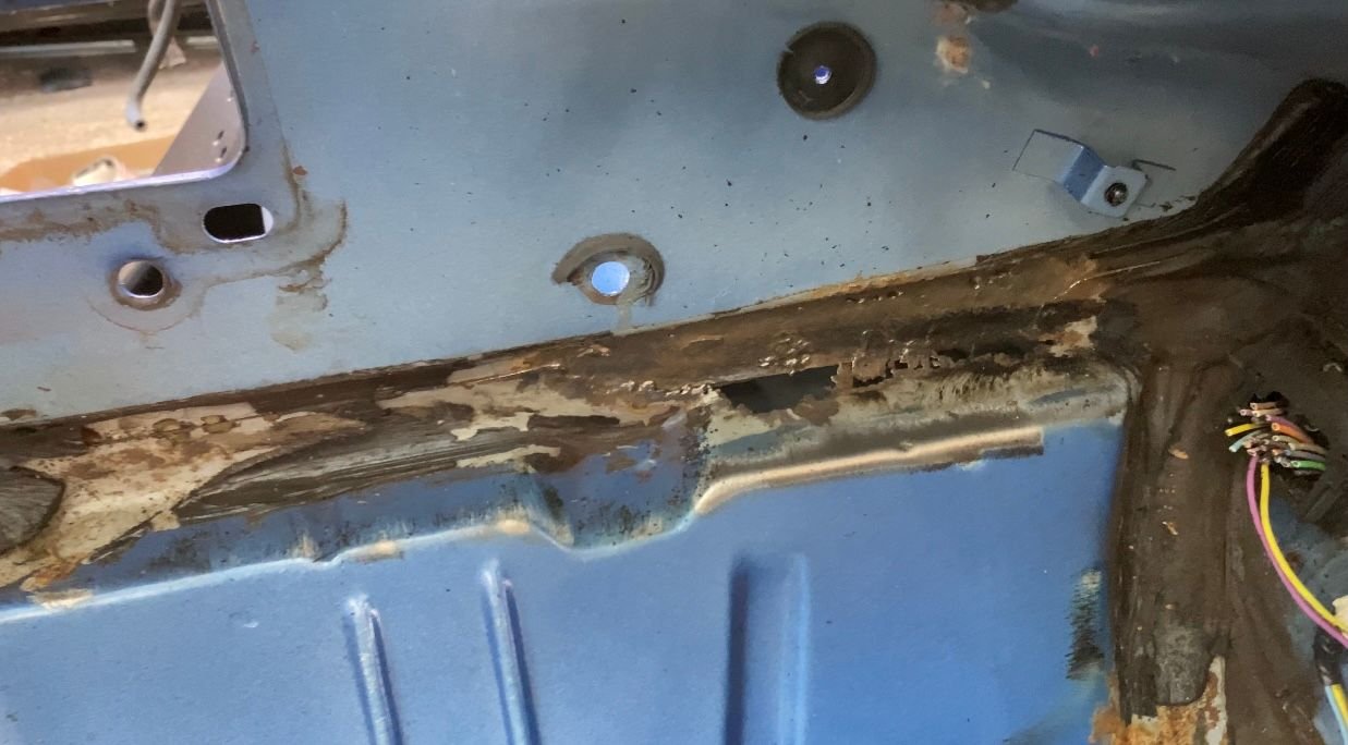

Next video finally went up. Did some rust repair on the floors, finished up some stuff in the engine bay, laid down some sound deadening and new firewall insulation. Next up is wiring.

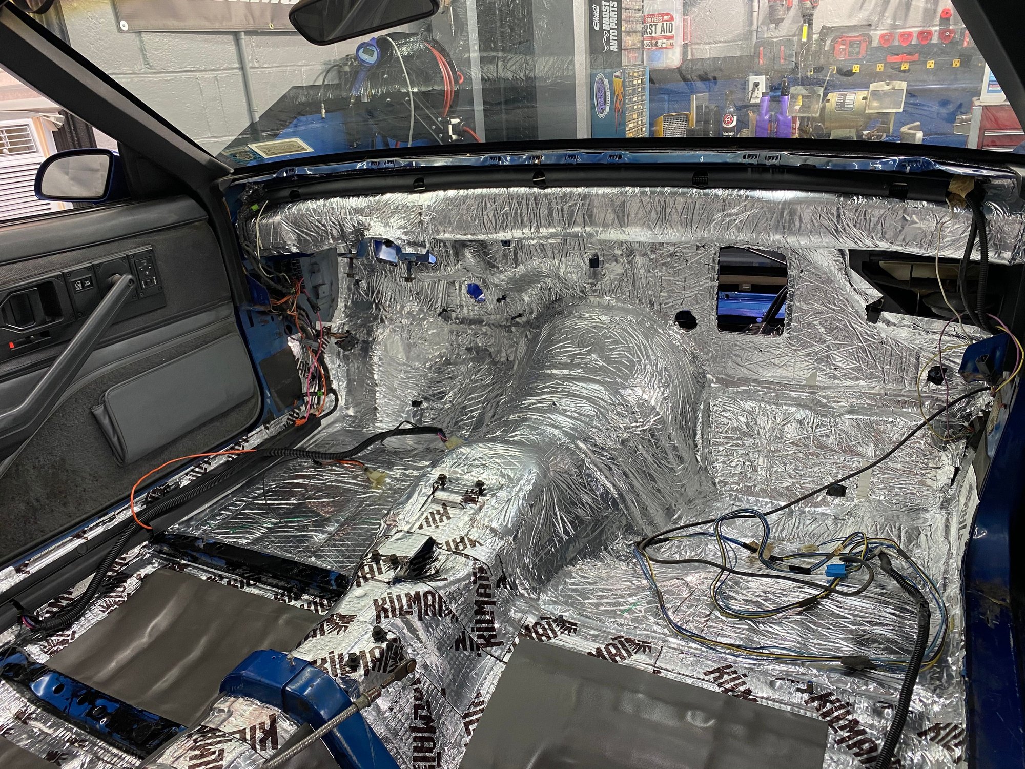

Looks great. I like how the hushmat squares are smaller. The Eastwood product I am using is large and needs to be cut down. What are the black sound deadening squares? Are those a hushmat product?

Yuk!!! Man I so don't miss living up north but I guess for 30+ years this one isn't that bad, but still Yuk
I think the deadening is excessive? I have never added any in any of my cars but does it really make it tomb like?
100% coverage on VIBRATION dampening, like this, is a waste of product and gains no more benefit over a 25-40% coverage area. If you really want sound deadening, you add mass, like the factory mass backed carpet. I did 25-40% vibration damper, 100% 1/8" closed cell foam over that, then 100% mass loaded vinyl, then the factory mass backed carpet. I didn't even finish and my car rivals new car sound levels in the interior

Yea I read about the 25% rule. This stuff was really cheap and being I already had 3 boxes, I just decided to cover everything. Being the floor was seam sealed and mismatched I wanted a clean surface to secure my wiring too, plus I figured it may provide an extra barrier in case the t tops leaked again. I have oem carpet going in with the heavy backing so I didn’t go as crazy with the foam sheets.
