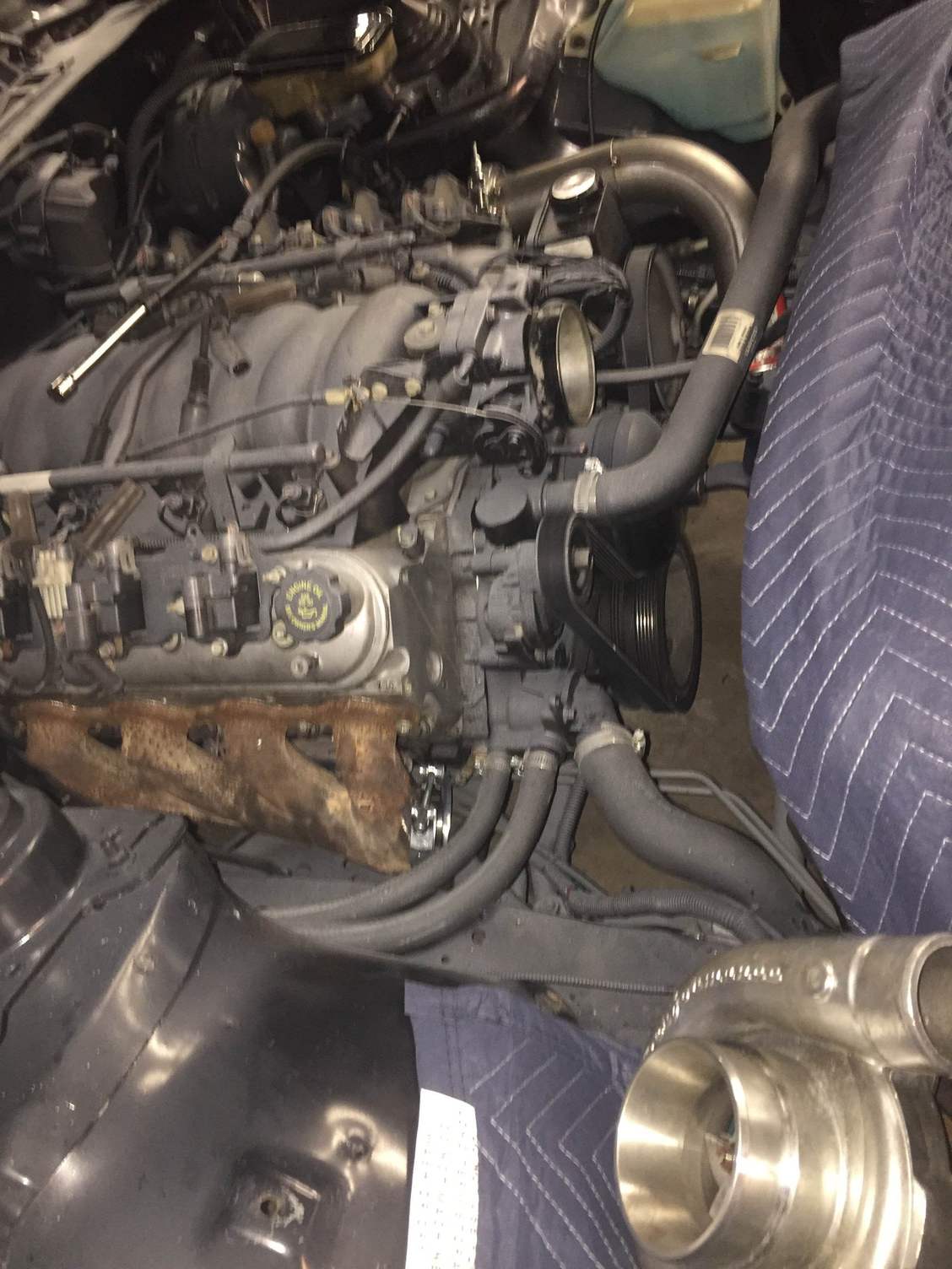

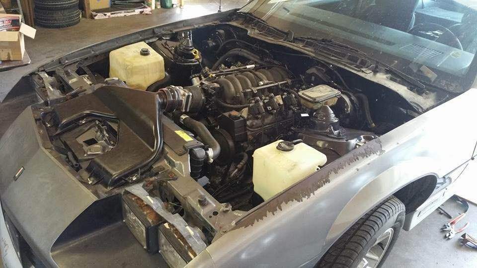

We started in on the original plan of getting it running with the 305, making it sound good, and look decent. That plan failed quickly so we went a different direction. I scored a deal, 6 hours away for a 5.3L with a junk cam and possibly lifters, built 4l60E, wiring harness, and PCM, from a guy parting out a 98 Trans am, that had been 5.3 swapped, for 900 bucks. We drove down to grab it and came back, only to learn it was a 4.8 after pulling the heads. Previous owners had added an after market comp cam with stock springs and it made quick work of a couple of lobes and a few lifters. A free early ls1 cam and a few spare laying around lifters and we slapped it back together with new HG and ARP Rod Bolts. We ripped the 305/700r4 out and stabbed her into place with the help of Hawks mounts and crossmember. The mounts worked perfectly, however we did have a hell of a time getting the trans crossmember to work, requiring a cutting torch and grinder. With the help of a friend the 98 harness was repinned for a 99+pcm and converted to a stand alone. We used the stock TPI fuel pump and added a vette regulator, and a nice AN line to the rail.

After that and a little tuning, the misses and I really enjoyed the car. The cat back was deal quiet, it was un assuming, and just great all around for driving around town. In the mean time we swapped in a 4th gen fuel tank I had, and a 3.73 posi disk brake 4th gen rear end, noticing a nice fuel pump access hole in the process. It really woke the car up, and if the thing didnt already look like a turd we probably would have been happy. But you cant be ugly and slow...

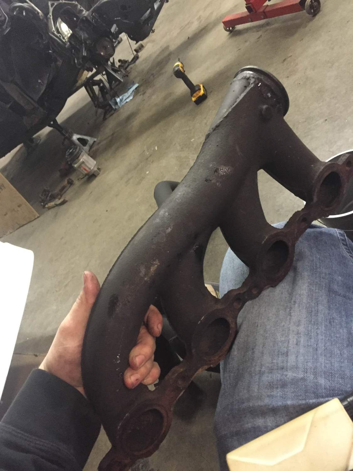

Turbo build was pretty straight forward. A few great friends helped me and we ended up with two flipped driver side truck manifolds, and custom everything else into a SLP Loud Mouth I bought used for 75 bucks. Used on3 76mm Turbo, VS racing 50MM WG, and a RFL BOF. 60LB injectors and we utilized that fuel pump access hole for a Walbro 450 intank. Running just off the waste gates 6 lb spring this things been a riot. A few more tweeks and she may be ready for some more boost.
