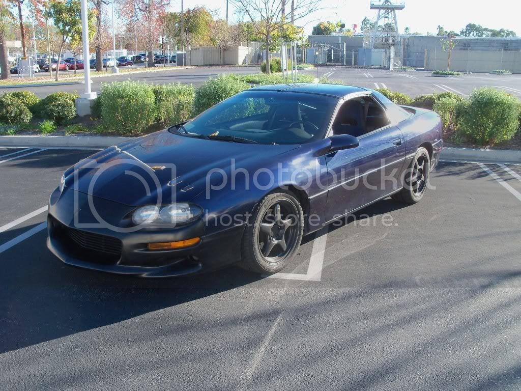

probably gonna keep it a bit longer. its getting sorta famous online and at local shows.
went and took some new pics eventhough i hate the color of this thing. some instagram page wanted to share it.

Swapper's Avatar
