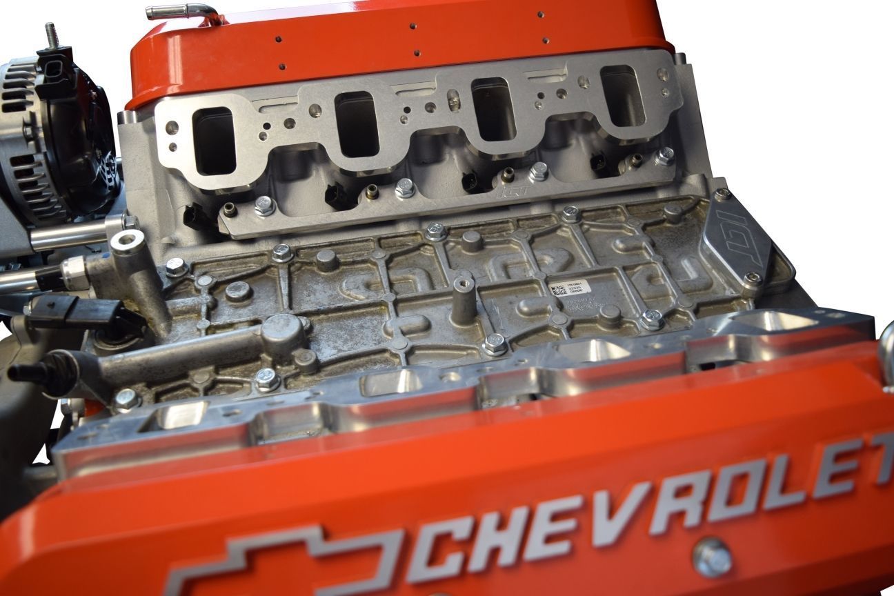

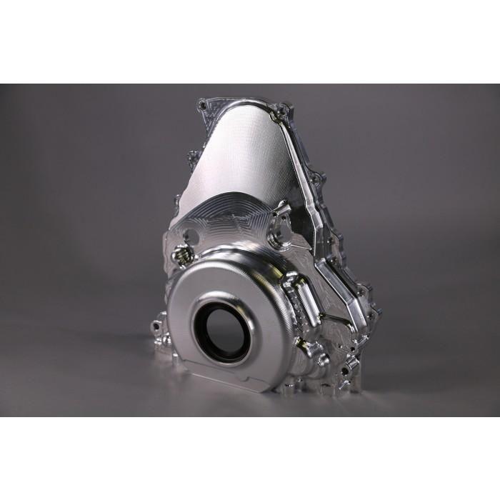

I would stay away from Direct-Injection for the time being.
When Building the Gen-5 SBC Engines, I omit the Direct-Injection System:
ICT Billet Block-Off Plates installed after removing all Direct-Injection Components.
Then I often use a Holley Intake-Manifold, such as this Hi-Ram.
No matter what, I use "Normal" Port Fuel-Injectors.
Below is the Holley Hi-Ram for Gen-5 SBC Engines, with PORT Fuel-Injection (NOT Direct-Injection):
Also the DOD/ AFM System and Lifters are removed.
ICT Billet Valley-Cover for DOD/ AFM removal, and Direct-Injection removal:
The VVT System can remain, unless a Camshaft swap is going to Happen.
In that case, the VVT System and Camshaft is also removed:
