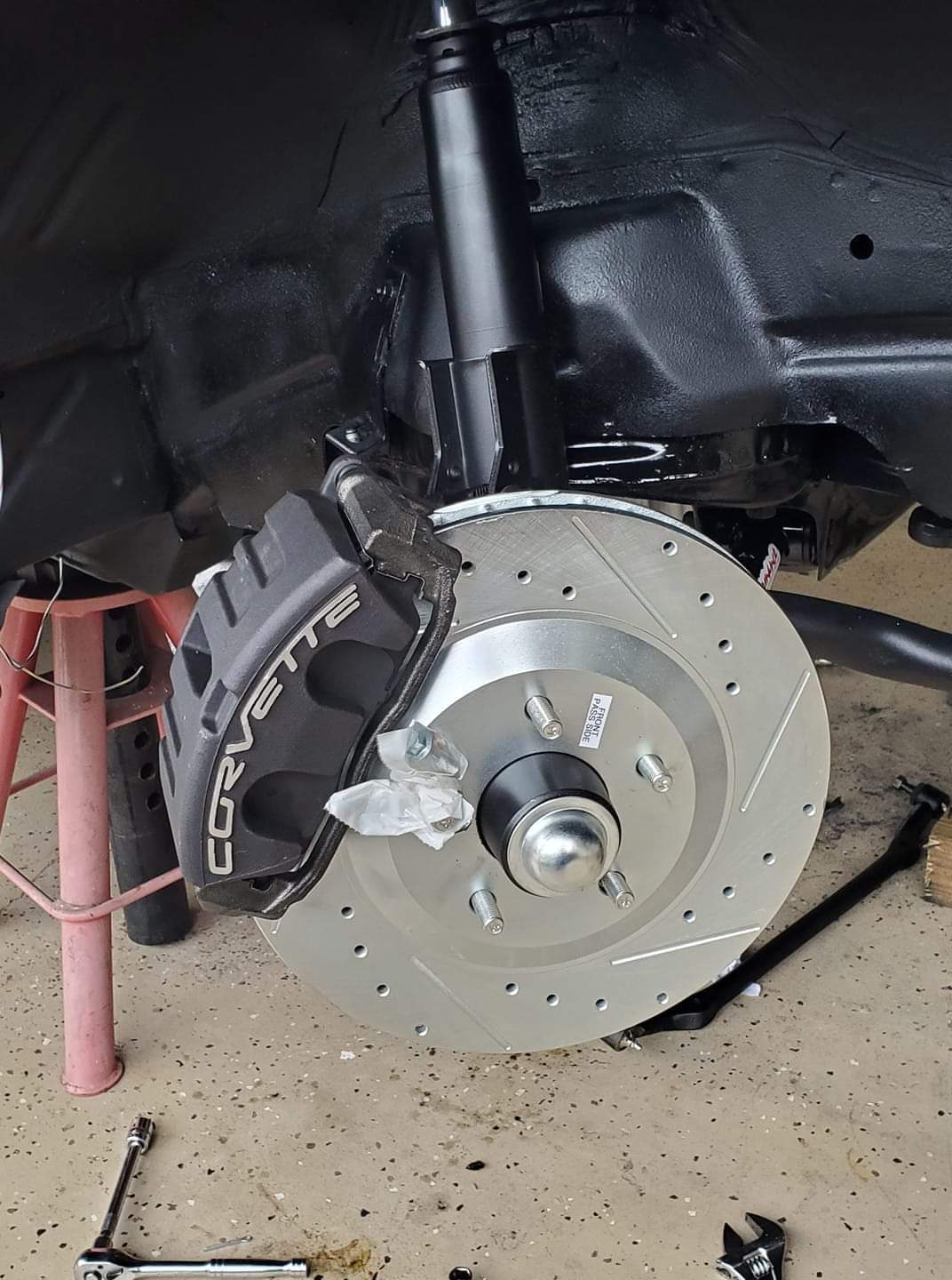

So I gutted the car and installed all kinds of new parts.... C6 front brakes, UMI control arms, rear end from a 2002 WS6 Trans Am with 3.73 gears. I put in a Z-28 front sway bar and wonder bar from UMI. Weld in UMI SFC's, Caster / Camber plates, etc...

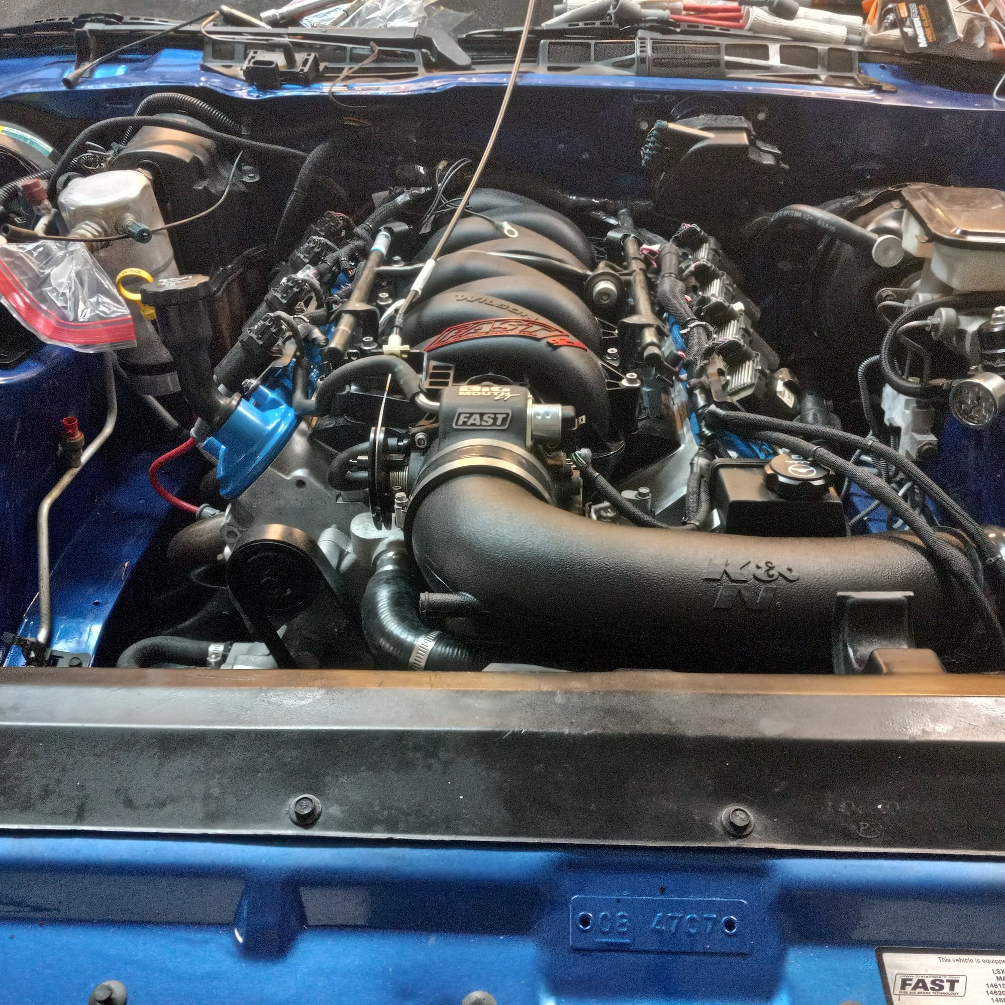

Motor was a 5.3L LM7 that I punched out to a 3.905" bore with Icon forged pistons, full floating rods and stock crank. 243 heads, from a C5 ZO6, BTR stage 3 LS1 cam, Long tube headers, Magnaflow catback, FAST 92mm intake and throttle body and all the other supporting mods. Just now getting to the wiring, with a painless harness and 0411 PCM. Once its up and running the car will be going to the body shop for a new paint job then a new convertible top...

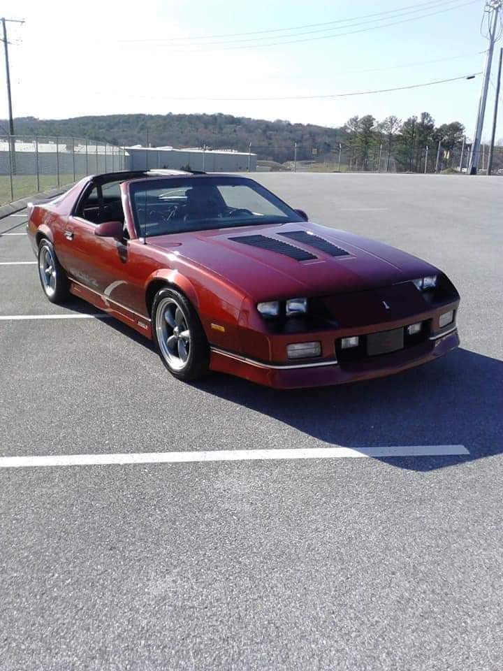

This is my previous build... was a beautiful car inside and out. Selling it was a HUGE mistake... as I'm sure some of you have done the same. So I'm building the drop top so the wife and I can go cruising on sunny days, hit a few cars shows and just enjoy the car.
