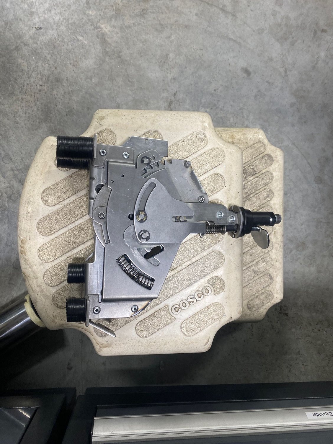

Finally, I am back on this project?
First item was finishing up the wiper motor.

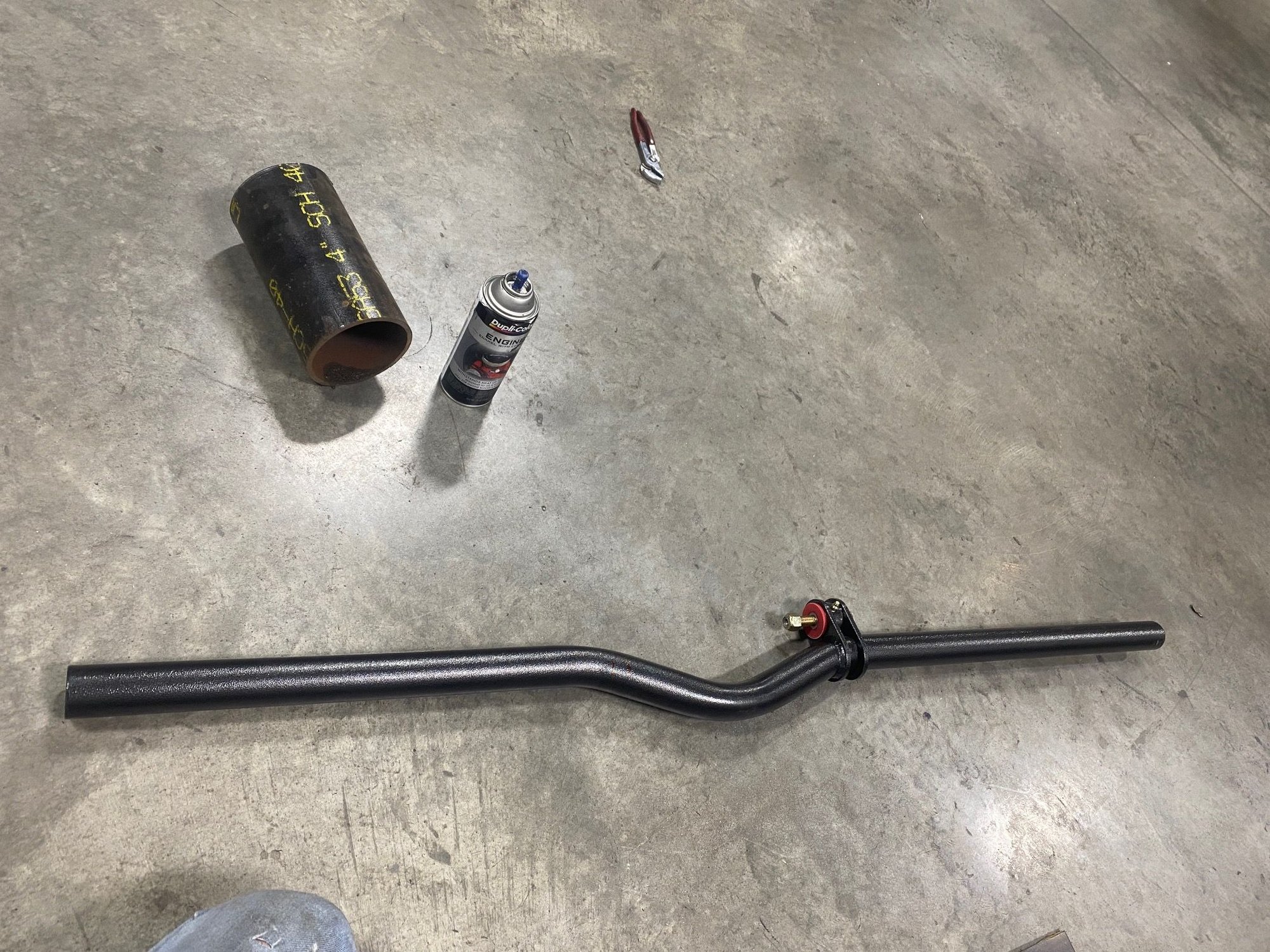

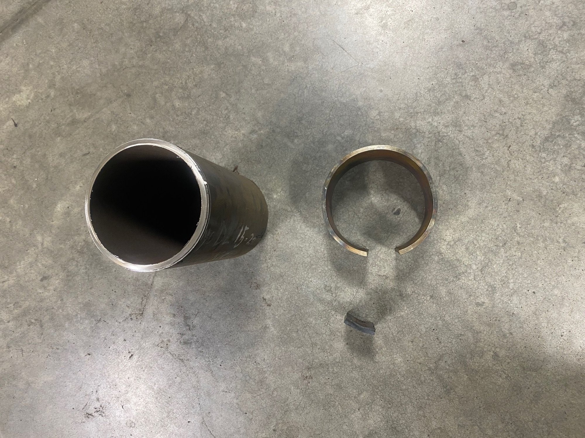

Due to the low ride height, the crossmember would be less than 3" off the ground.
I cut the crossmember in 3 pieces & proceeded to build a new version.
I wanted to make a passthrough for the exhaust & needed a 5" piece of tubing.
Unfortunately, I could only find a 4" piece of pipe, so I cut it & made it larger.
This is what I ended up with.
It is finally in place & now I'm trying to get some paint on it. I gained almost 2" of extra ground clearance.

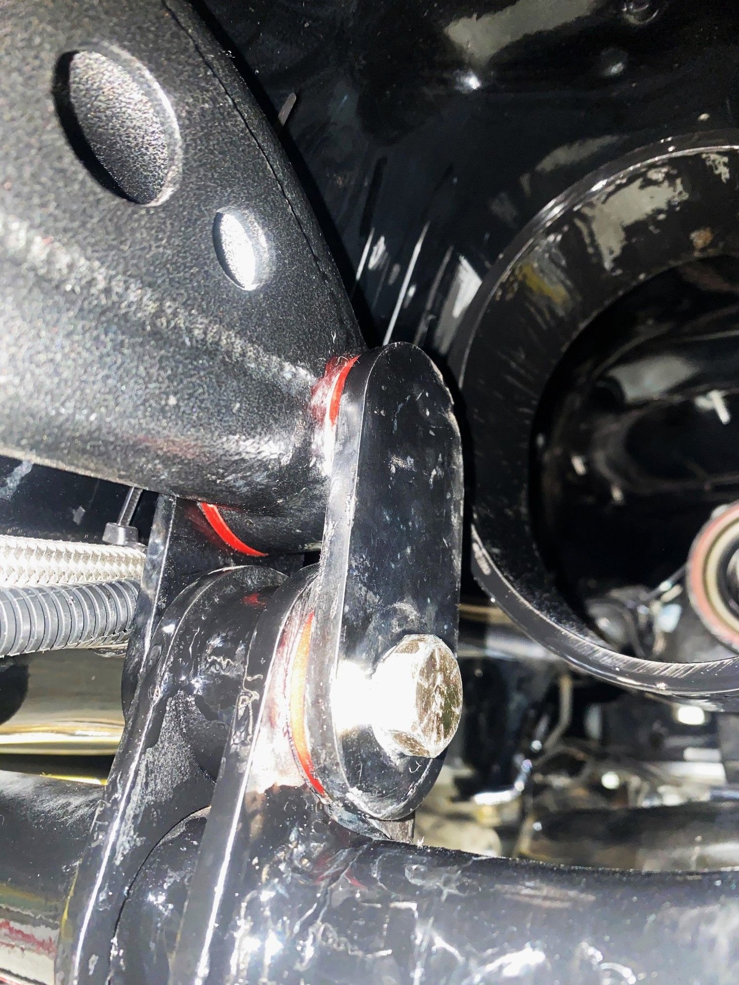

For more driveshaft clearance I modified the torque arm link.
The original bushings are approximately 5/16" thick, so I machined them down to .156" each.
Then I bored out the internal bushing from 1/2" to 5/8".
Then I threaded the 1 link for 5/8-18 & bored the other so I could weld the link directly to the bolt.
This allowed me to thread the 2 links together with only a few threads protruding & no bolt heads or nuts to take up space.
This added a lot of clearance on both sides for floor & driveshaft clearance.

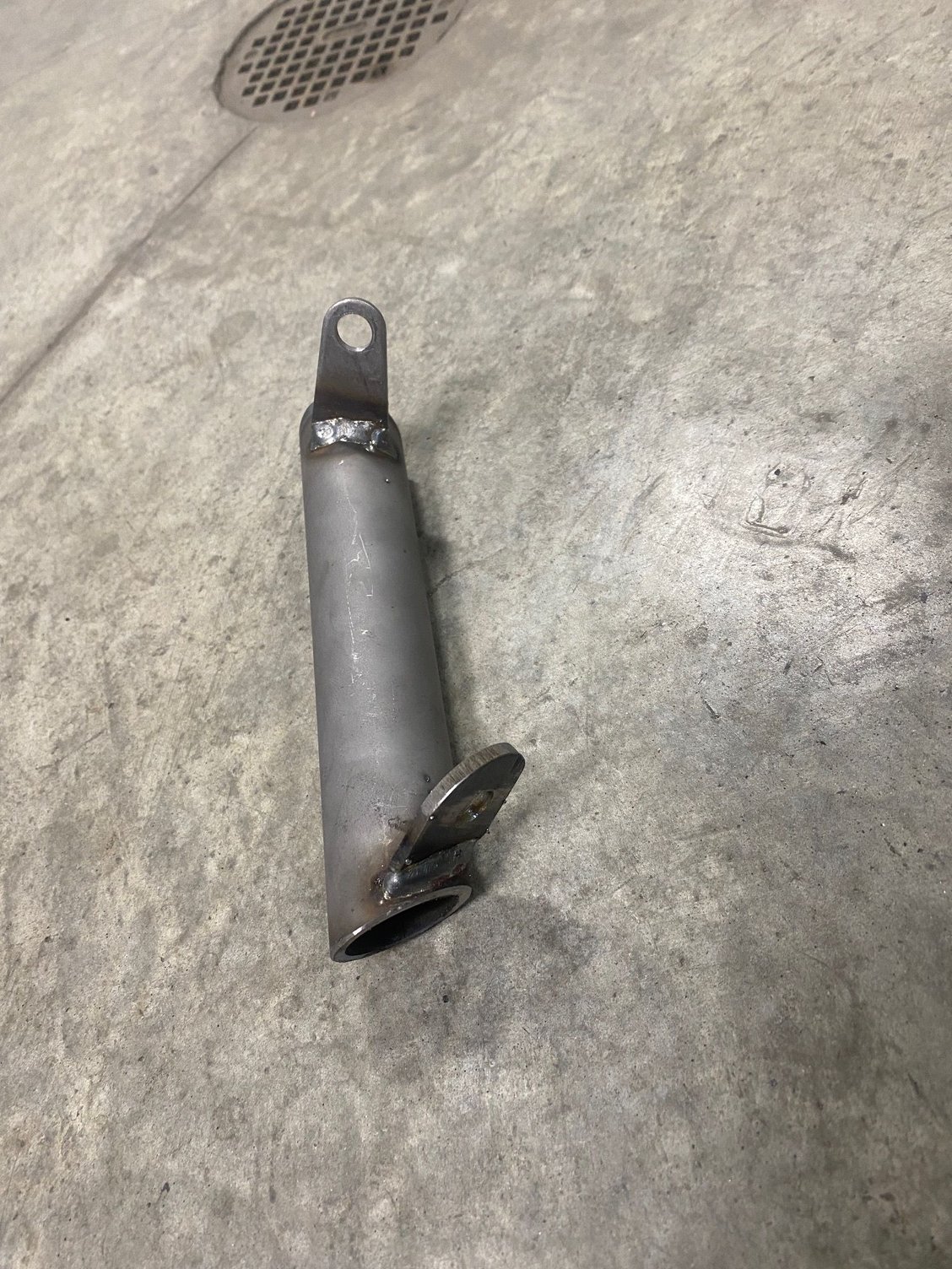

I'm talking about the torque arm that broke, not the crossmember.
The 4" lg. straight pin broke off the front.

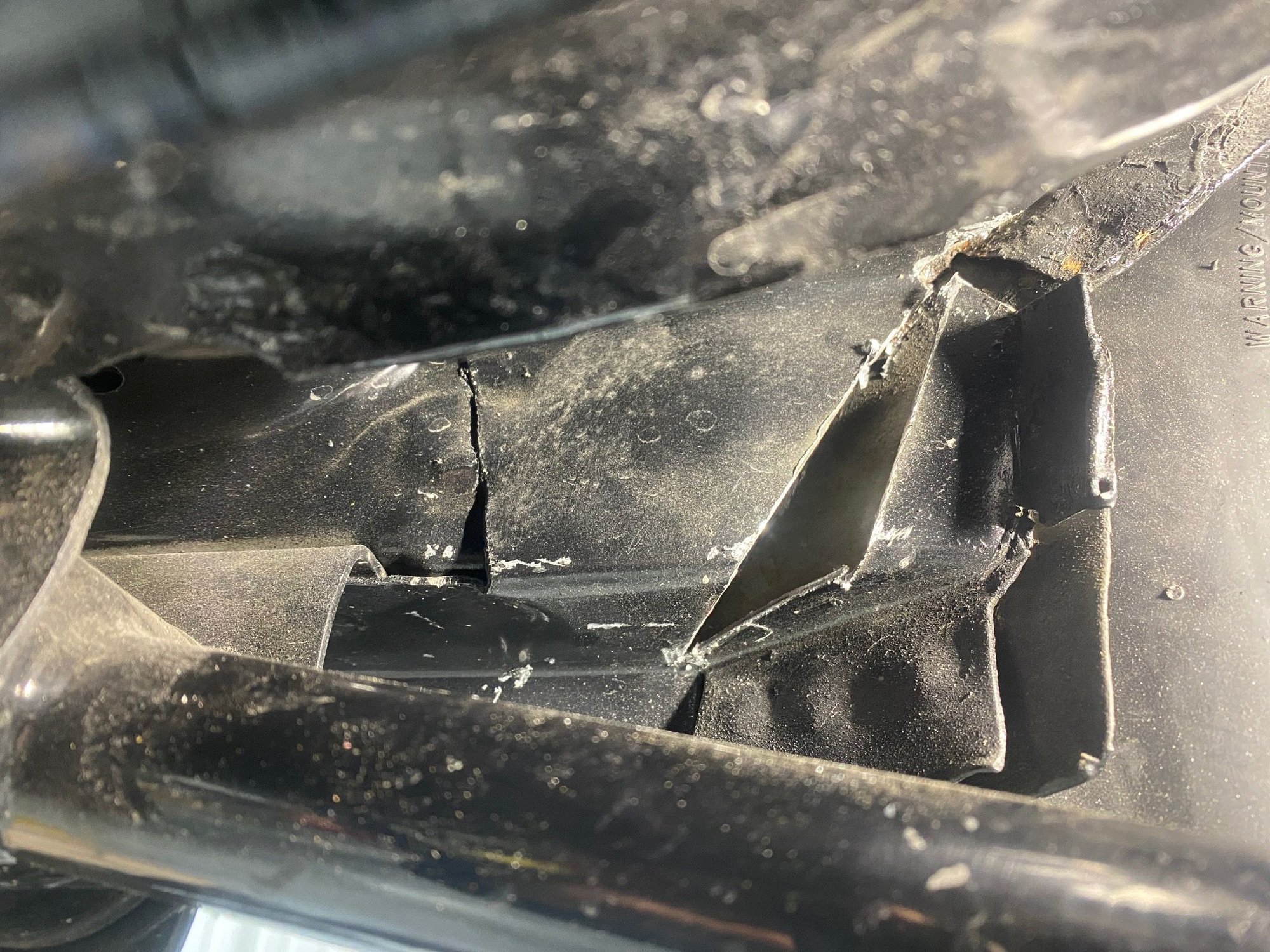

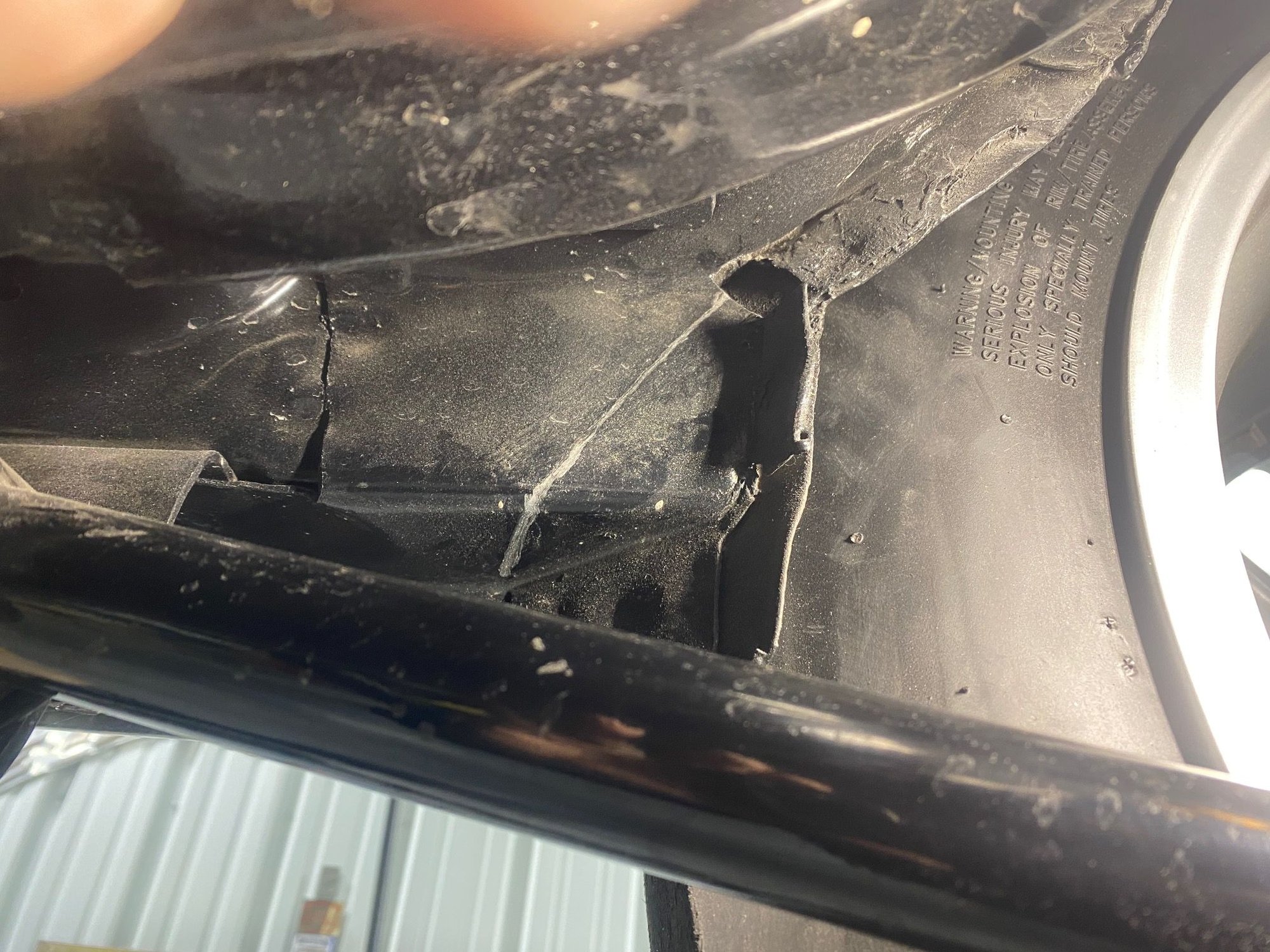

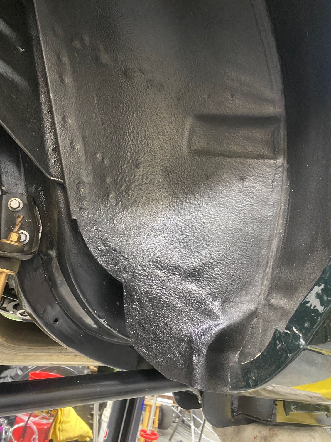

I started making room for larger tires.
I test fitted a set of 28 x 10.50 slicks under the car that I have for my S10 & of course the bump stops are against the tires with 6.5" BS wheels.
They are 18" wheels but still have the same dimensions.
I looked for the least intrusive place to remove the bump stops without removing more structure than necessary.
A few cuts & the inner structure is still intact.
I welded & ground the seams & put some fresh undercoat on everything.
There is no evidence of modifications.

Yes, it is very tight at the front corner near the control arm. I will be modifying that next & post some pictures.
Originally Posted by ughmas
Very clean work! looks great, what kind of undercoating do you use? Has that "factory" look that I would want to achieve (I was planning on using 3M rubberized)
I had issues with the 3M staying sticky.
Quite a few years back, I found a company called HUD. It looks nice & dries like bedliner, which can also be painted.

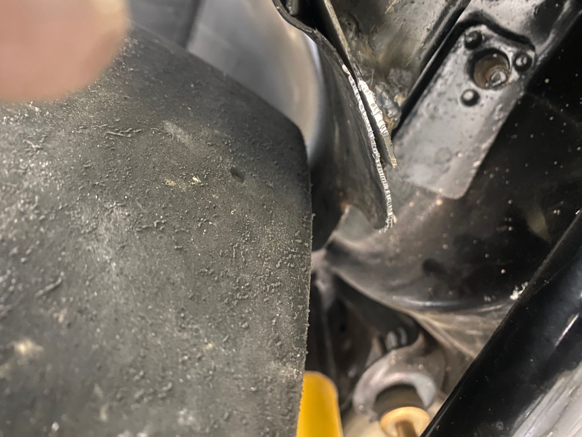

As promised, here is a picture of the interference area. At full droop, the tread is against the inner fender.
I drew & made a small pie cut in the area behind the fender well.
After a few taps the gap was closed up & welded back together. Here is the clearance afterwards.
It still looks largely untouched.

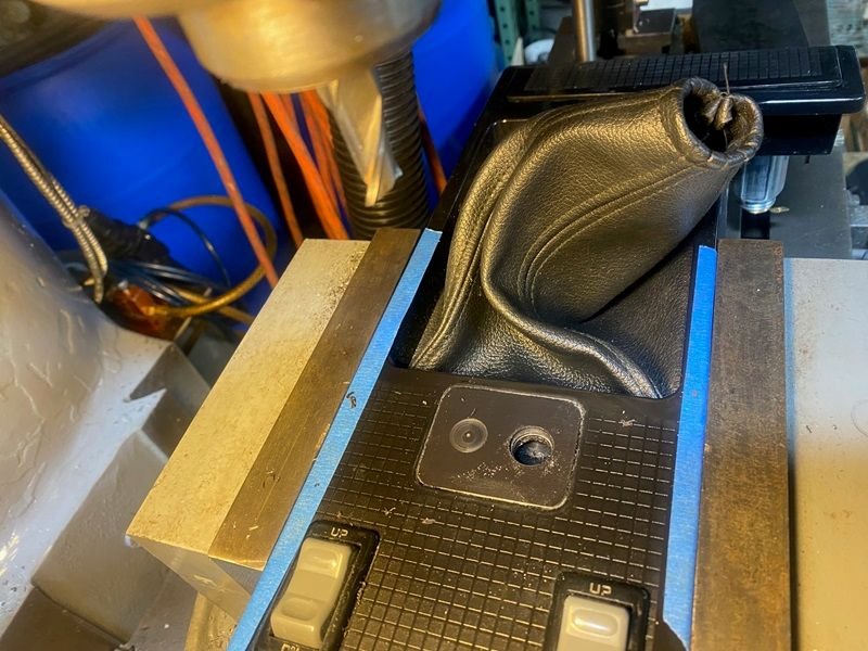

Old Feb 4, 2024 | 12:23 AM
  #82
Lonnie P's Avatar
Joined: May 2006
Posts: 585
Likes: 76
From: Pittsburgh, PA
Car: 91 Formula
Engine: 2012 LS9
Transmission: 4L80E
Axle/Gears: Strange 60 3.54:1
Re: 1991 Formula LS9 Build
I worked on the shifter install, which turned out to be a bigger project than expected.
When you look into aftermarket shifters for a Firebird, they all say "not for factory console".
I figured I would do some experimenting since I have the manual cover that has a more generous opening than the auto does.
I did not want a race style shifter so I looked at the B&M hammer.
It is easy to use & offers both conventional & ratcheting abilities.
I mocked up a few spacers to get it positioned at the correct height as well as cut off some of the excess brackets that were in the way.
Afterwards, I put in a few nut-serts since getting a wrench above the trans is nearly impossible.
My next issue was the location of the shifter cable is right where the exhaust is.
The standard location of the cable & bracket is below the flange of the transmission pan, so I started building a bracket to raise the cable above the oil pan rail.
Of course, that changes the throw of the shifter arm so that also needs modified.
I finally got it all sorted out & it clears the exhaust nicely.
The console is all buttoned up with neutral safety & backup lights connected.
Now I have to find something to cover the gear pattern indicator.

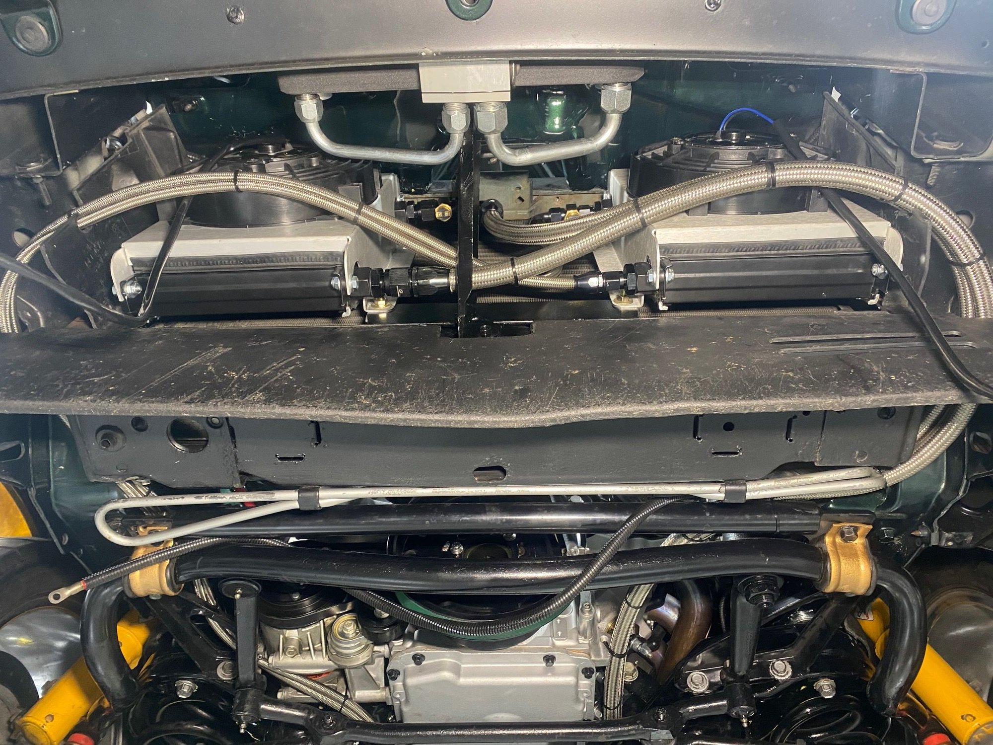

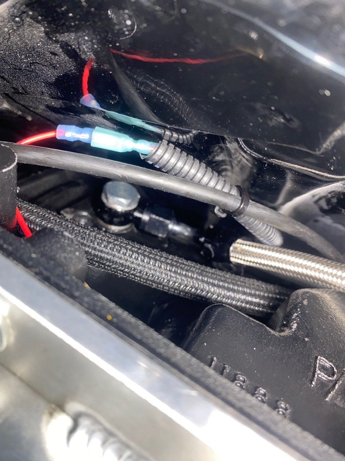

Old Feb 10, 2024 | 09:47 PM
  #85
Lonnie P's Avatar
Joined: May 2006
Posts: 585
Likes: 76
Car: 91 Formula
Engine: 2012 LS9
Transmission: 4L80E
For those that build cars, here is something that most can relate to...
A friend of mine calls it the "Rule of 5's"
For everything you change or modify, it seems to affect 5 other things.
Here is my latest...
I pulled the new wiring from under the console to the transmission.
That seemed to go decent other than the trans connector is huge & the floor hole is much smaller.
After de-pinning the connector, I managed to get the harness through the hole.
This is where the "Rule" comes into play.
I attempted to take the wiring from the console to the under-dash area where the Holley EFI computer is going to be mounted.
It should have been easy, but previously I installed a double DIN radio, which takes up a lot (basically all) of the space in the dash area.
With the trans wiring in place, the radio is about 3/8" from going back into position, so I will have to reroute some items under the dash to get everything in place.
Nothing is ever easy.
So, in order to feel a sense of accomplishment, I switched to the trans cooler lines.
I started looking for a nice line route & a good location for the trans cooler in front of the radiator.

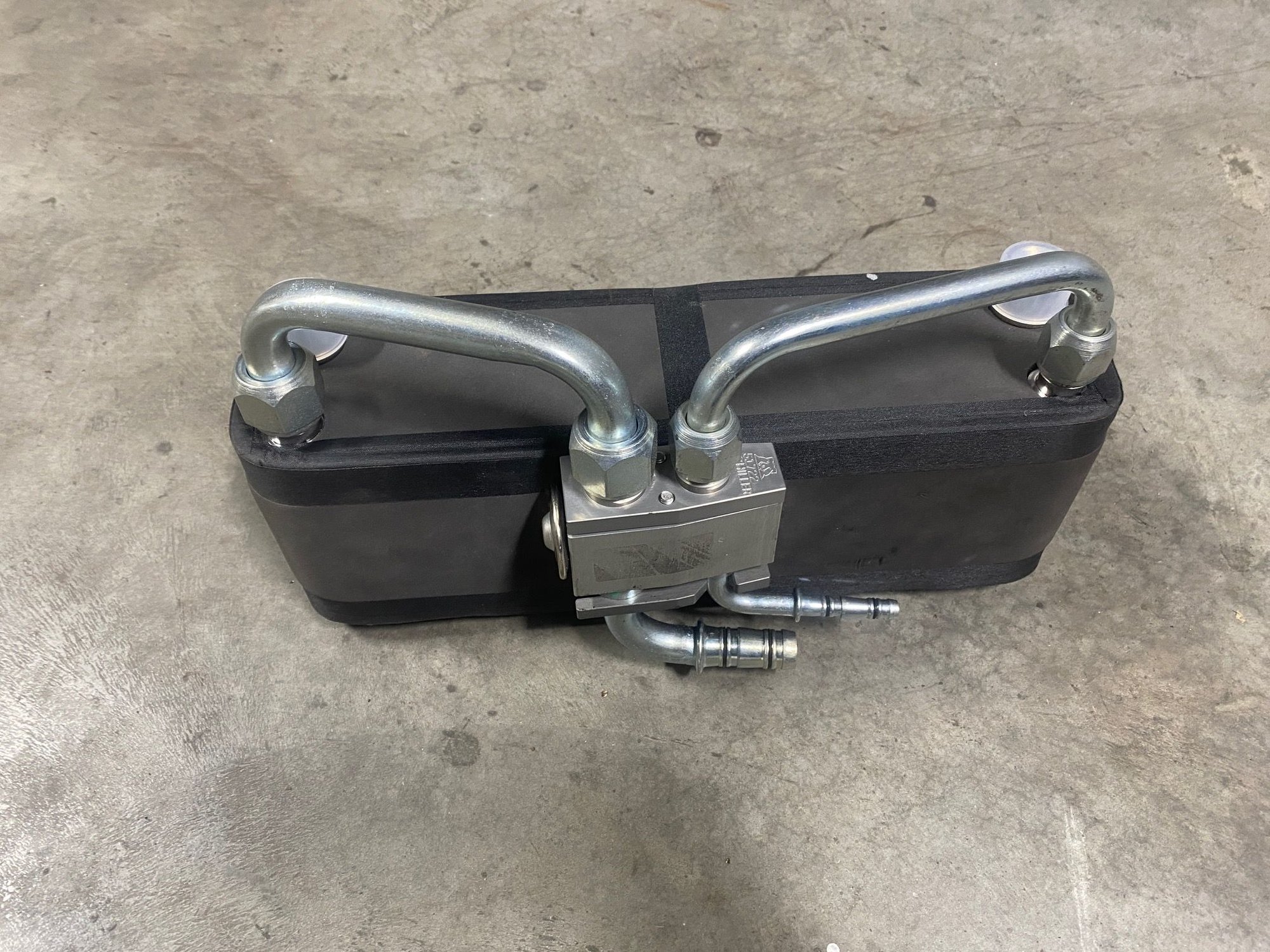

But, in order to get the trans cooler installed, I realized I have to mount the chiller in the bumper first.
I really liked the results of a refrigerated intercooler, which uses the AC to cool the water for the supercharger.
Once again, I switched priorities.
Here is the chiller before I installed it.
I fit it into the front bumper support, since that was the only logical place I could mount it.
I forgot to take pictures of the brackets.
I will be plumbing it in the near future also, as it needs tee'd into the high & low pressure AC lines, along with mounting the pump & reservoir.
Finally, I could mount the trans & oil coolers.
They have been sitting here for a year now, so I'm also happy to get them off the floor.
Because of the trans brake, I chose coolers with thermostatically activated integral fans, that I can also manually override.
I put nut-serts & studs on the cooler flanges & mounted them to the edges of the radiator support & also to an additional cross brace in the center.
Because of the port locations, I ended up mounting the coolers on the opposite sides instead of trying to put sharp bends in the hoses.
It's amazing how fast the whole day is consumed.

Slow progress today...
I was able to make a tube to protect the trans lines from the exhaust & flywheel.
I never liked how the lines are exposed in this area & considered one of the cast dust covers, but they are rather expensive.
It secures the lines pretty well in a busy area.

I made a little more progress today on the oil cooler lines.
A word of advice to anyone putting in a 4L80E.... connect the trans cooler lines first, before putting the transmission in.
You can get 1 fingertip on the fittings & with the aid of multiple stubby wrenches you can tighten them 1 flat at a time if you remove the mount & lower transmission a few inches.
It's almost as much fun as getting poked in the eye with a stick.
The dust on the floor looks terrible when the photos are taken so close up lol.
I also got the engine oil cooler lines installed.
They were not much easier than the transmission lines due to being behind the headers & a -10 line instead of -6 for the trans.
The routing to the front was not too bad considering the lines are not that flexible.
Up front the coolers are installed & plumbed. I still have some final touches & a few clamps to install but everything fit pretty well.
Even with a 4L60, getting to the lines after the install is a PITA. I was swapping transmission with such frequency (or so it seemed) that I fashioned a couple of short -6AN tails that stay attached. I swung those over onto the passenger side frame rail to a bulkhead style AN to tubing adapter and ran steel lines to the front. At least the adaptor fittings are easy to get to come removal/installation time. Again.
Your project is looking pretty good. There's nothing quite like a fresh build.
from my experience, I would suggest that you consider using more a weather pack connector vs those types of fast-on type connectors... wire terminals that don't support the conductor with a crimp on the insulation have a much higher likelihood of breaking over time in high vibration environments... also the terminal itself is usually much more fragile than the capability of a weatherpack etc type of terminal... the weatherpack connection is much more environmentally capable all the way around
for heat shielding another good option is Heatshield Products Hot Rod Sleeve
https://www.summitracing.com/parts/hsp-204012

Good idea, I never really thought about it. That wire is for the trans brake so I just matched the connection it came with.
All other connectors in the car are weather pack style so I should be consistent.
I'll look in my stash & find something better.

I made an insert for the gear indicator.
Then I milled it to hold the line lock & trans brake buttons.
I had to countersink the holes to get a flush fit.
Here are the buttons installed.
After a little plastic polishing, it will be ready to install.
