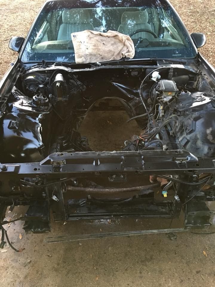

Out with the old.....
I cleaned and painted the engine bay while I was in there..

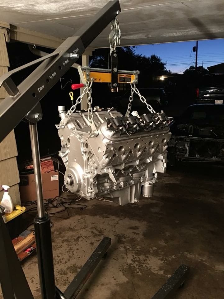

Years ago I bought a wrecked donor z28....
this engine was rebuilt with new slugs bearings and all arp hardware.

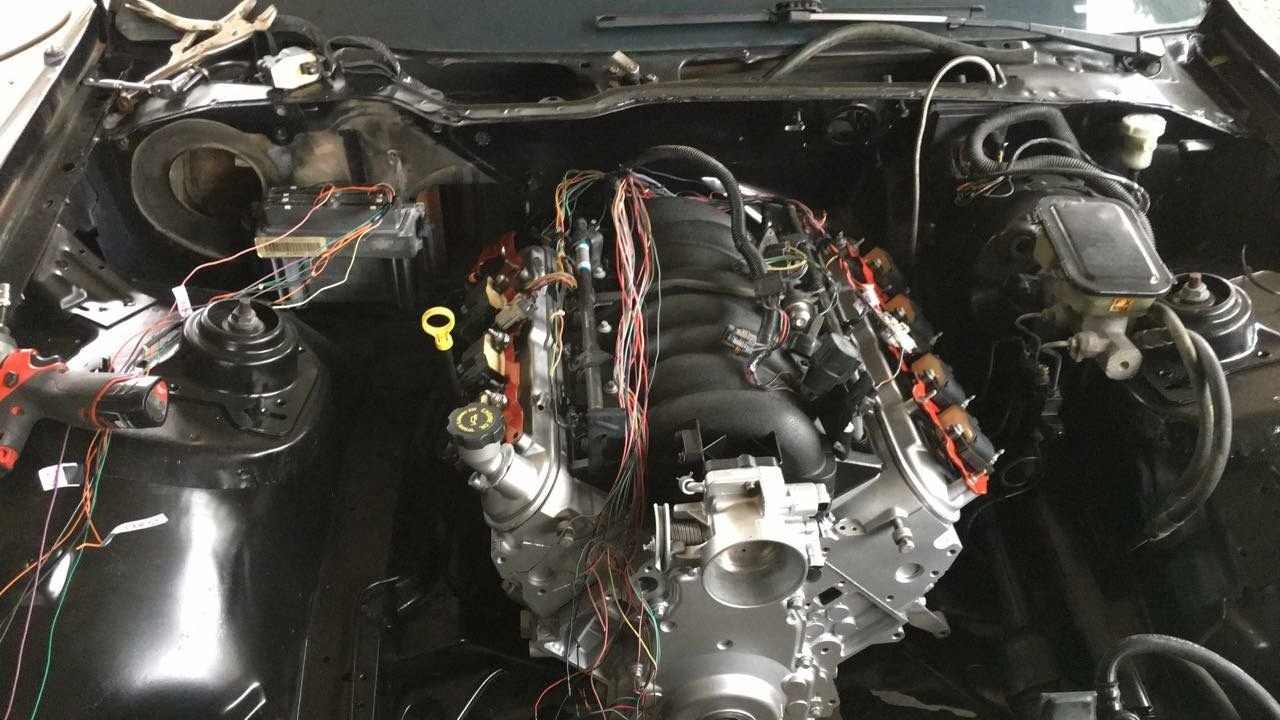

On day three started wiring...
Preparing the ls1 engine harness... (shoutout to pocket for all those awesome write ups..)
This is the engine bay stripped down to basic powers and grounds harness..
Laying and routing every.. single.. wire..

After fighting engine mounts and all sorts of other shenanigans that night ... (sorry for the links.. it was a live FB vid)https://www.facebook.com/raymond.minisall/videos/1840896072627561/
and at 0500 the next morning... the first start
https://www.facebook.com/raymond.minisall/videos/1842948455755656/
the only issue I had with the harness, was that I mixed the two wires for the coolant temp sensor. It was reading like -90* lol... I’ll be honest it took me quite a while to figure that one out... but after I did...
https://www.facebook.com/raymond.minisall/videos/1846820768701758/
https://www.facebook.com/raymond.minisall/videos/1845890128794822/
and then basically the final running product... after three long days....
