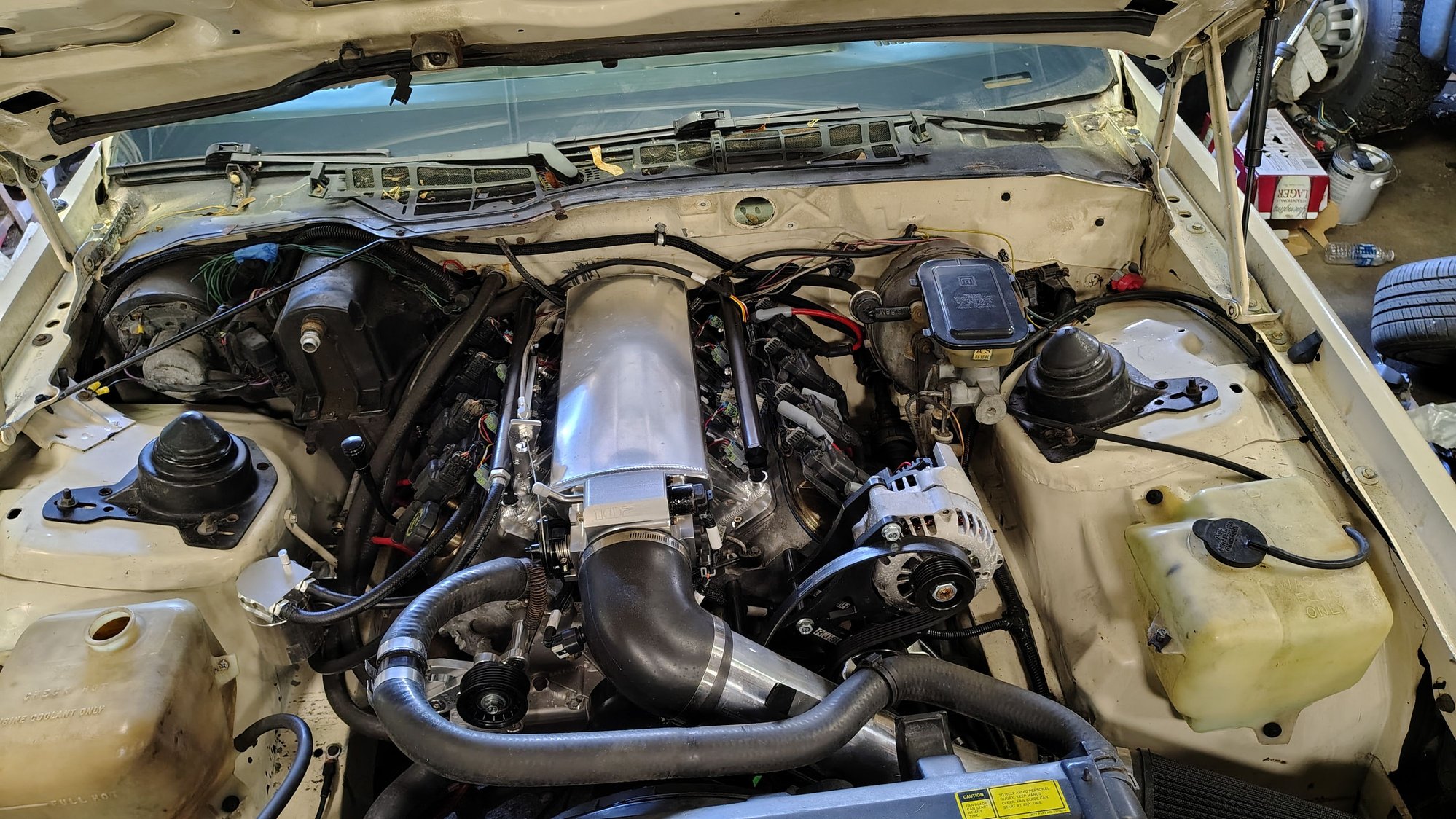

Old Dec 7, 2025 | 10:21 PM
Verynormal's Avatar
Joined: Jul 2021
Posts: 28
Re: Auto trans/exhaust advice
Engine shot when it was near done if that does anything to help.
