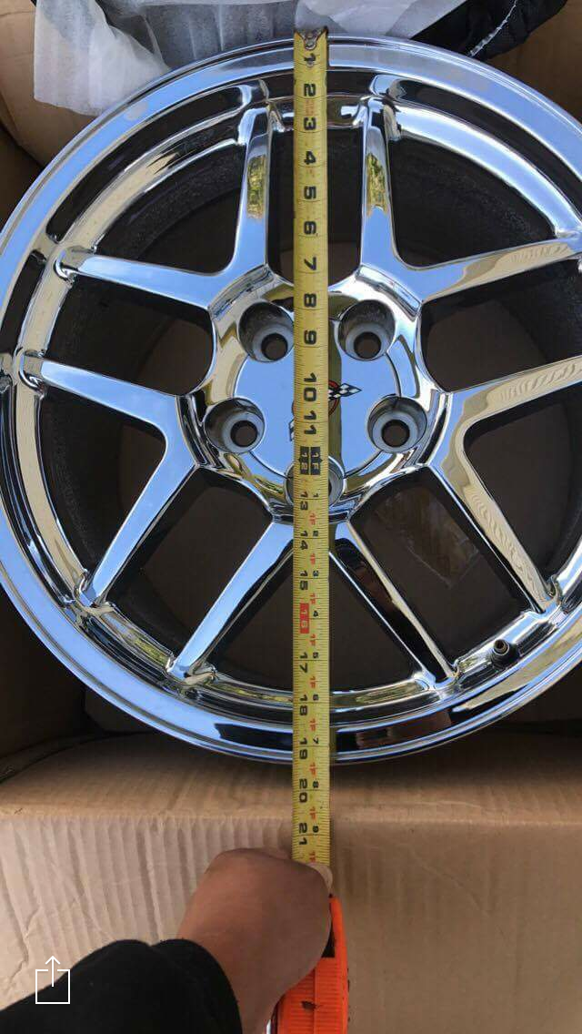

These are my wheels. Got them for a good price just don't know if they'll fit or if a 2" spacer is all I need since they're so wide.

I can't tell what it would take to make them fit but this should help you determine exactly what it is you have in terms of dimensions.
Looks to me that you're as posted earlier. 17x9.5" in the front and 18x10.5" in the rear.

Thanks man I feel like a idiot now lol that's what the guy who sold them to me told me so I ran with it. Thanks everyone for your help. Now time to find some spacers and tires. Any suggestions on what size tires to get?

Most likely going to do 245/35 in the front and 295/35 in the rear then I'll see what size spacers I need. I'll be sure to post a pic of the car when the wheels are mounted!
