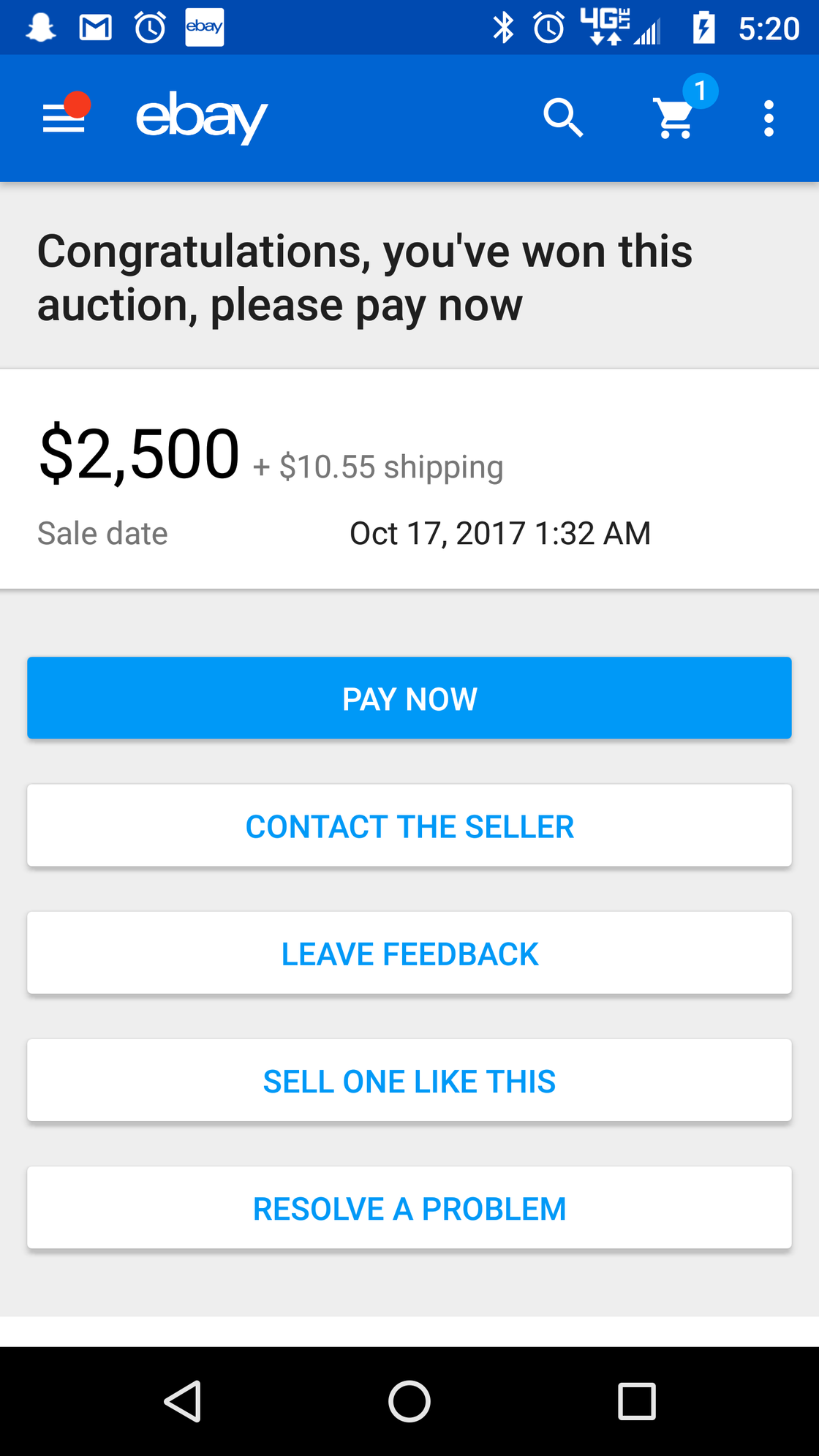

New developments as of an auction that closed on eBay...
This is just a teaser but I really have seemed to fall off the deep end now.

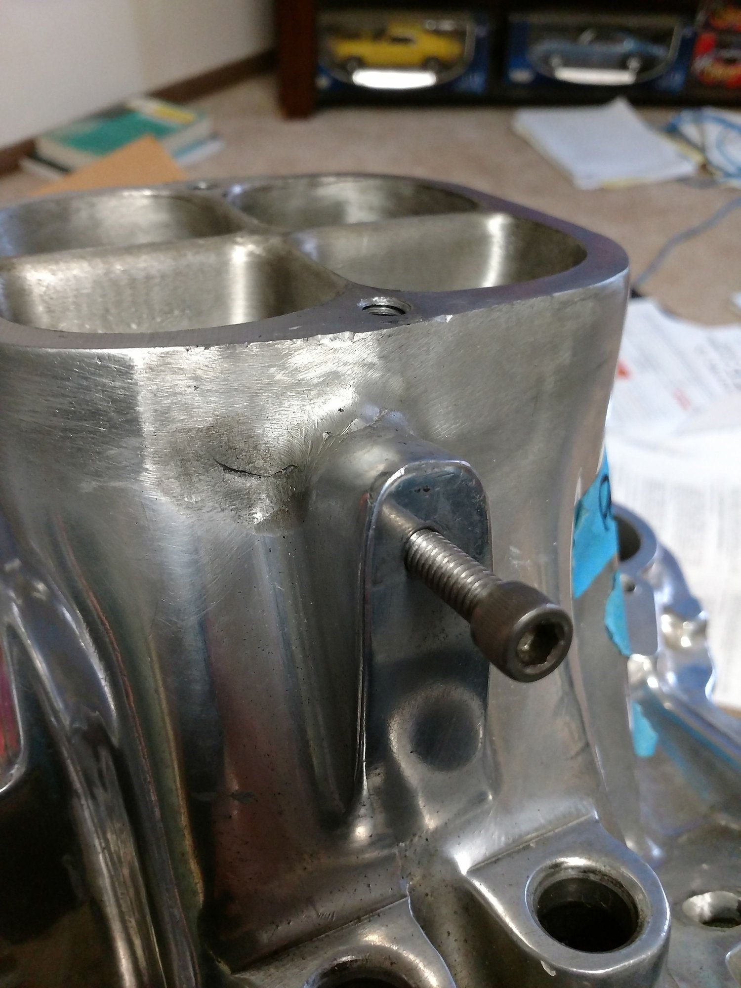

Someone hogged this intake out pretty good. I has a 1206 gasket and it was all the way out to that and the gaskets between the plenum and runners I threw away but it looked like they were nipping the sides of it when they ported them out. One comment a guy made was, isn't 4 bolts a bit wimpy when you're going to be pushing air through with a procharger? I never thought about it but it does make sense.
The next thing that makes me scratch my head is all the welding that has been done. I'm not too concerned about it, the only question it really raised in my mind was why? Did they port too far and have to repair it? I don't think so because both sides have the same welding on it. Confusing but not really scaring me off by any means.

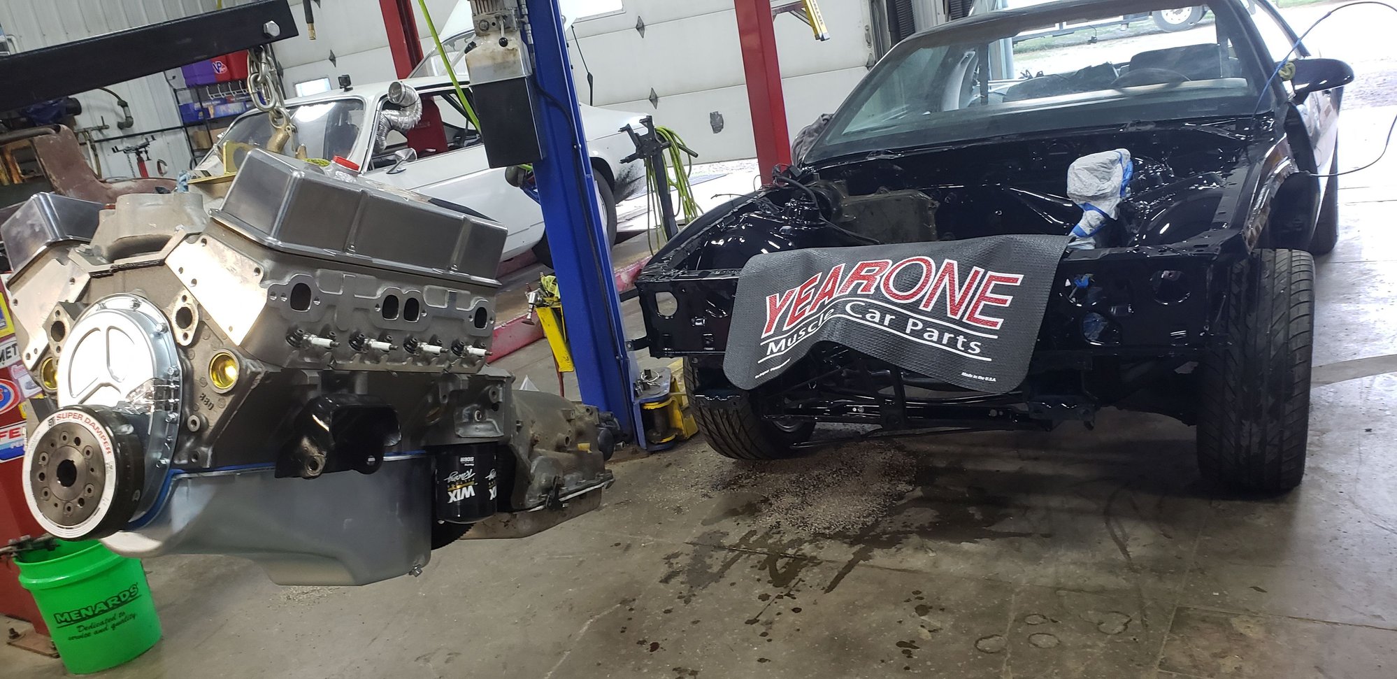

Here we are. Underhood all primered up.

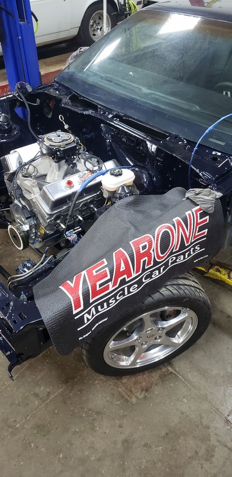

New engine in!
SO painted the underhood to match the factory color.
I welded and then smoothed a few of the factory seams inside the engine compartment to make it look cleaner.
Then i started on the accessories. I purchased a set off a later car from Jack at camaro hill. Really nice guy. Clean, sandblast then black chassis paint on those.
made new battery cables. I have been working on the car for the last week.
I will take more pictures when I make it back home tonight!

I sent the first Sniper back. Went and then bought the big 8 injector one. I went with the black finish on that
The headers on the car arr dyno Dons and they fit beautifully.
3" magnaflow high flow cat.
spintech 9000 muffler

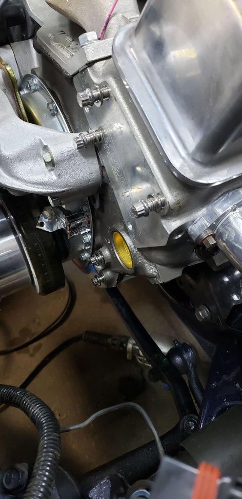

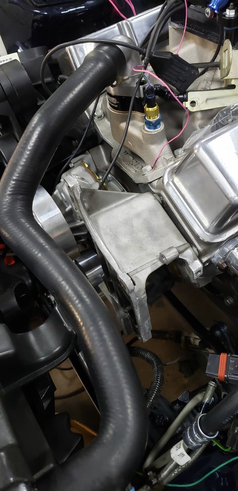

Ran each bolt in to make sure they all went in without issue.
Here is the bracket cleaned and sand blasted
took my die grinder with a sandpaper disc on it and took down the casting marks
Test fit, looks good. This waterpump did not jive on the passenger side so i took a little material off the bracket already. Now its really looking good.
Remanufactured pump, inside of the old reservoir. Cleaned everything really well, wipe it down with grease and wax remover, then sprayed with chassis black paint.
There it is. Installed with a new high pressure line. ARP stainless 12 point bolts and blue locktite on everything.

I haven't updated in a bit but it runs with the new motor! Took it up and down the block. Then back into the shed and did a nice burnout. Those wheels are off the car again. Didnt have the correct coil driver to let the holley sniper control the ignition so we dropped a HEI in that we had laying around. I'm in the shop now playing with the ignition and cleaning the interior.

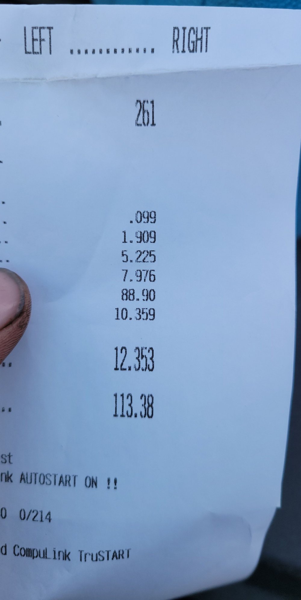

12.3 quartermile
Took the car down to the dragstrip last night for test and tune. The track is not prepped and I'm on Firestone indy 500's so that might help explain my slow 60'. This is a personal best for this car though!!! Feels much better than the 12.9 I ran last time out
