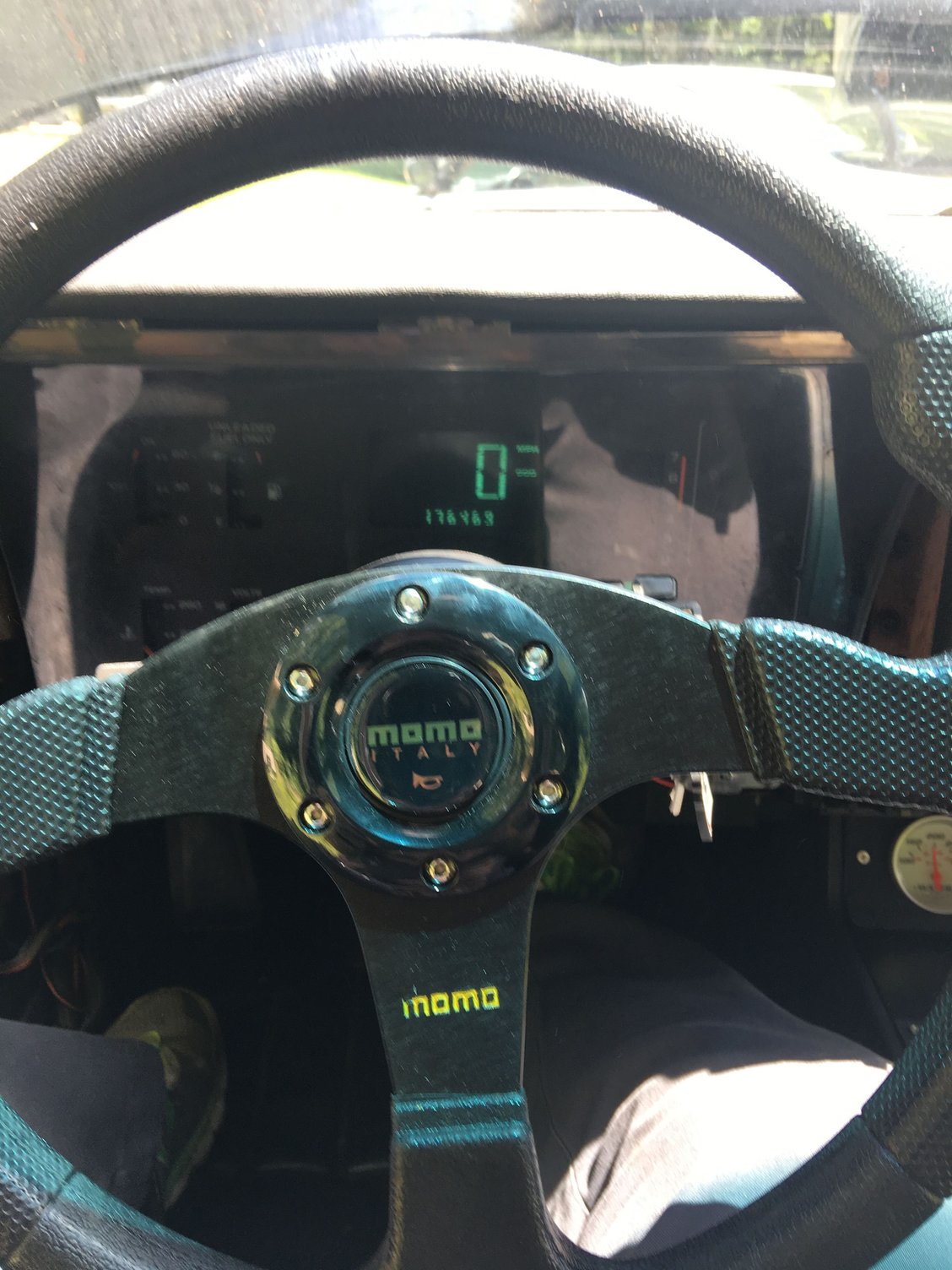

Carpet back in. Gauges in and hooked up. Center console back in.

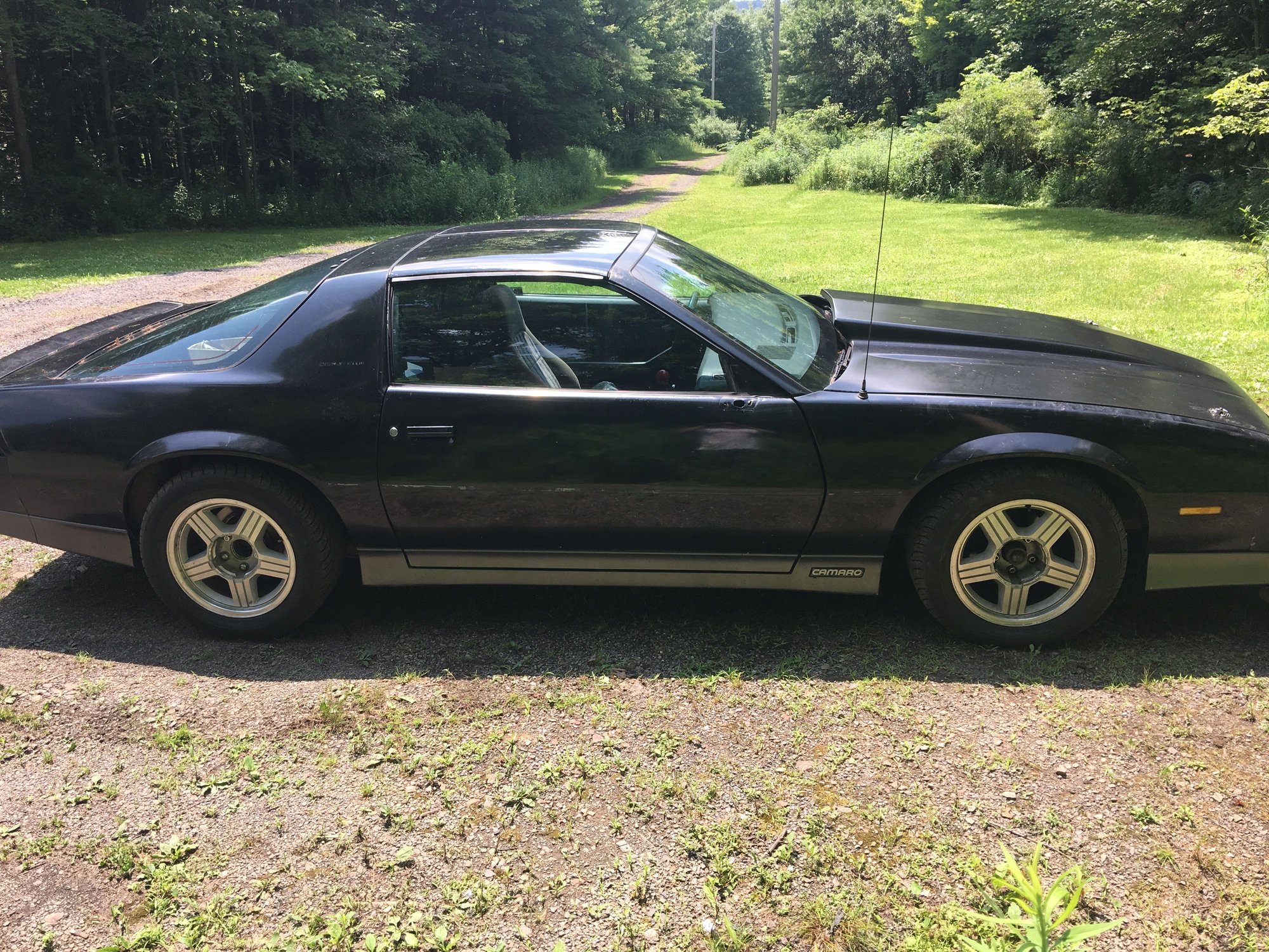

Got my front springs where I want them. Had to cut a 1/4 coil off to get it to set the way I wanted. Could maybe use another 1/4 coil off but I will let them settle before I see if I need to do that.

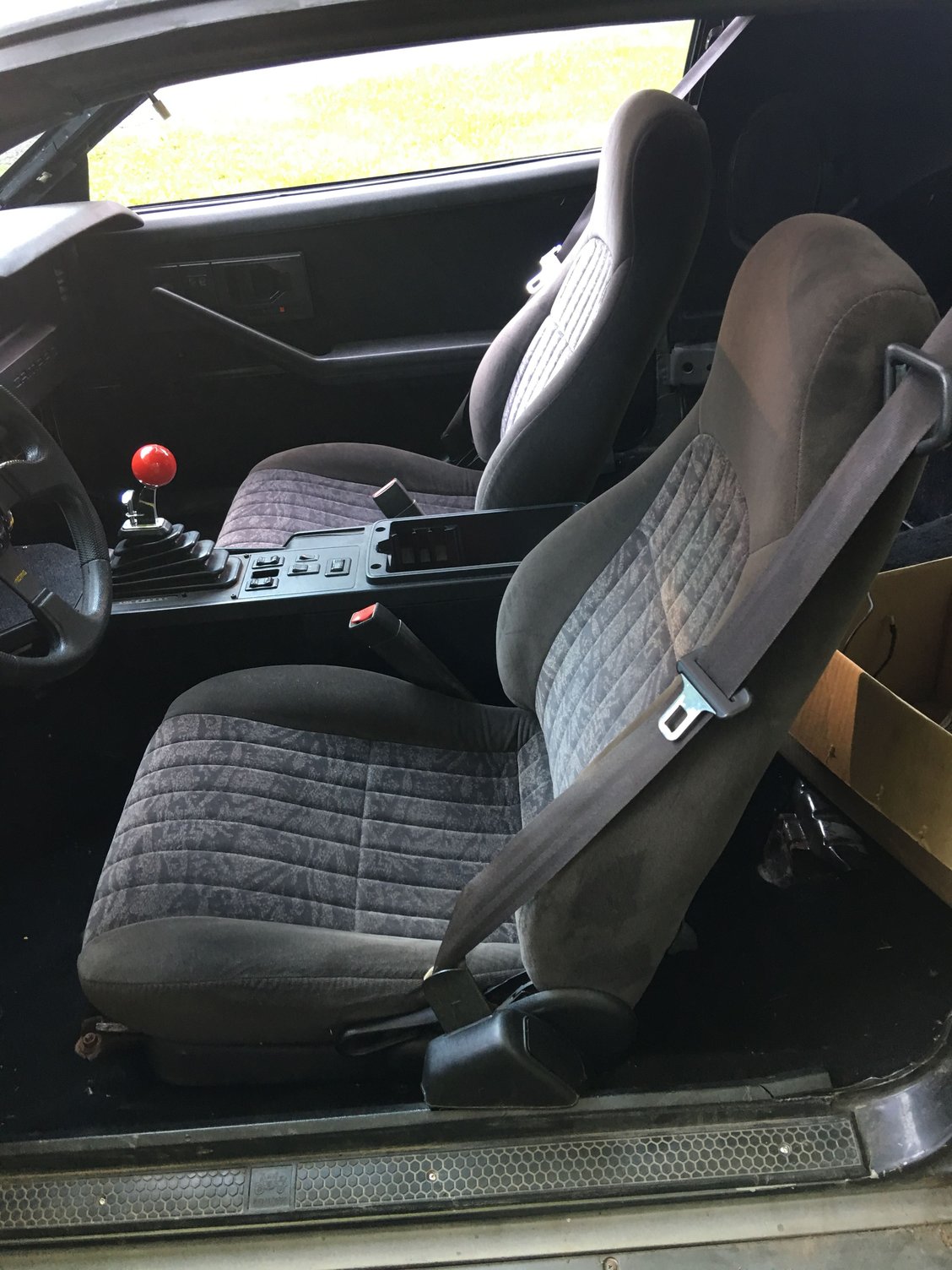

4th gen seats and seatbelts in.

So I got most of the interior back in the car. Minus the headliner and rear seats. They will stay out till I get my leaking t tops taken care of. Only 2 things left are an oil change and bleed my brakes again. It will be on the track for the UMI Autocross next Friday and Saturday!

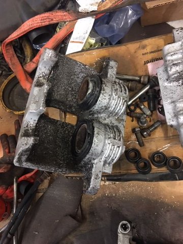

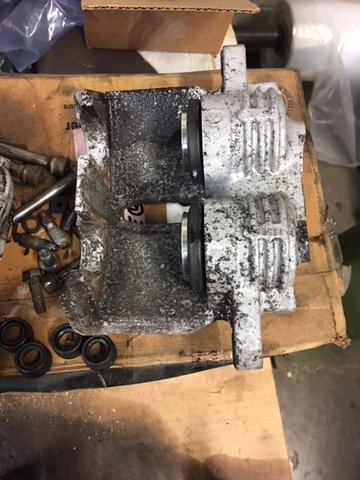

LS1 front brake upgrade time!

LS1 brackets from Bigbrakeupgrade.com and calipers blasted and painted.

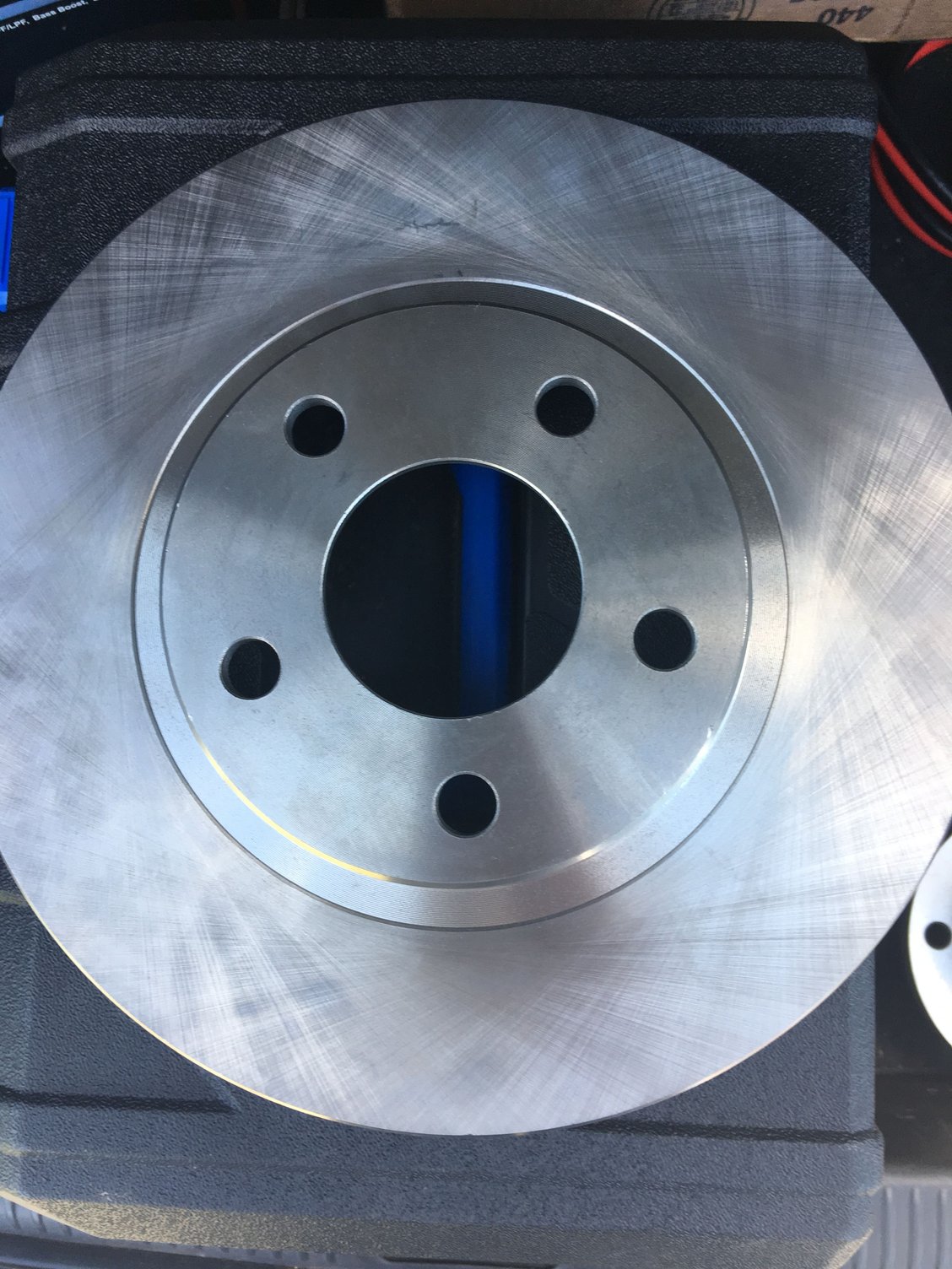

Hubs turned down for the LS1 front brake upgrade. All work done for free by my cousin. Nice when family has equipment and tools you can borrow or have them do things!

New longer studs pressed in for the brake upgrade.

Put my rear seats back in today. Also picking up a new nose for it on Saturday. Current one has a big hole in it. This might be it for anything getting done but who knows.

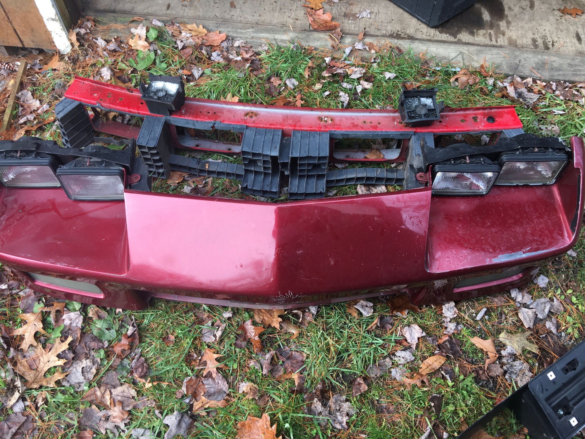

Picked up new nose and crash bar for the car today. Also installed a new steering wheel from a 88-94 cavalier. It’s so much nicer than the cheap Momo wheel I had and way nicer than the stock wheel.

That is the wheel I prefer also. If you can find it, there is a trapezoidal horn button.
Actually, find 2, I will take the other.
I tried to find one of these ones. I missed out on one on eBay. This one looks pretty good so I’m happy with it but if I come across one I’m definitely picking it up.

To say I’m disappointed is an understatement! Got the 4th gen rear on Monday from my buddy. First issue was it’s a 4 channel rear so I had to get new brake lines for it as a 4 channel has separate lines to the front for each wheel.Next issue is my buddy was told the rear was from a 00 T/A. It should have had the Torsen posi and either 3.23 or 3.42 gears. Well it has the Auburn posi unit and 2.73 gears! So pretty sure my buddy was lied to when he bought the rear. Very disappointing! It will just have to do for now as money is going elsewhere. It is a posi so that’s the only positive at this point. Maybe later this year I will find another Torsen and get another set of gears.

Well some good news on the rear end. I have found and purchased another Torsen posi unit at a very good price. I have also purchased a set of 3.42 gears. I will deal with what I have for this year and completely rebuild the rear over next winter.

Started to put the rear end in yesterday. Hopefully this afternoon I will have it in. Put some UMI lower control arms in while I had it apart.

4th gen rear installed. Brakes will be next week.
