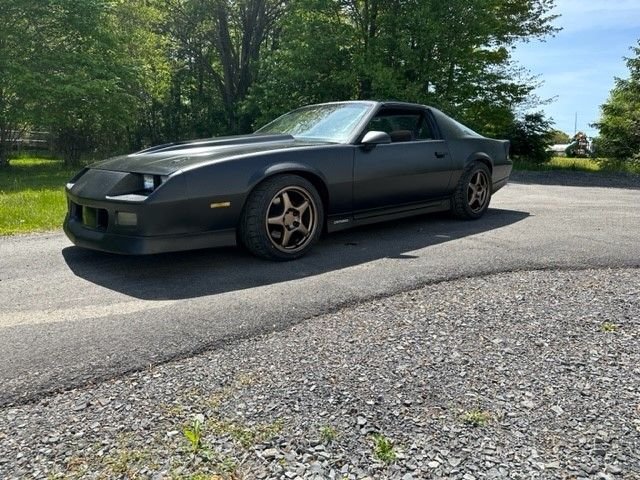

Car is now painted matte black metallic. Wheels painted bronze with new 255/40/17 Falken Azenis 615 track tires. For now this thing is done. Gonna try and enjoy it this summer before a rear gear change come fall.

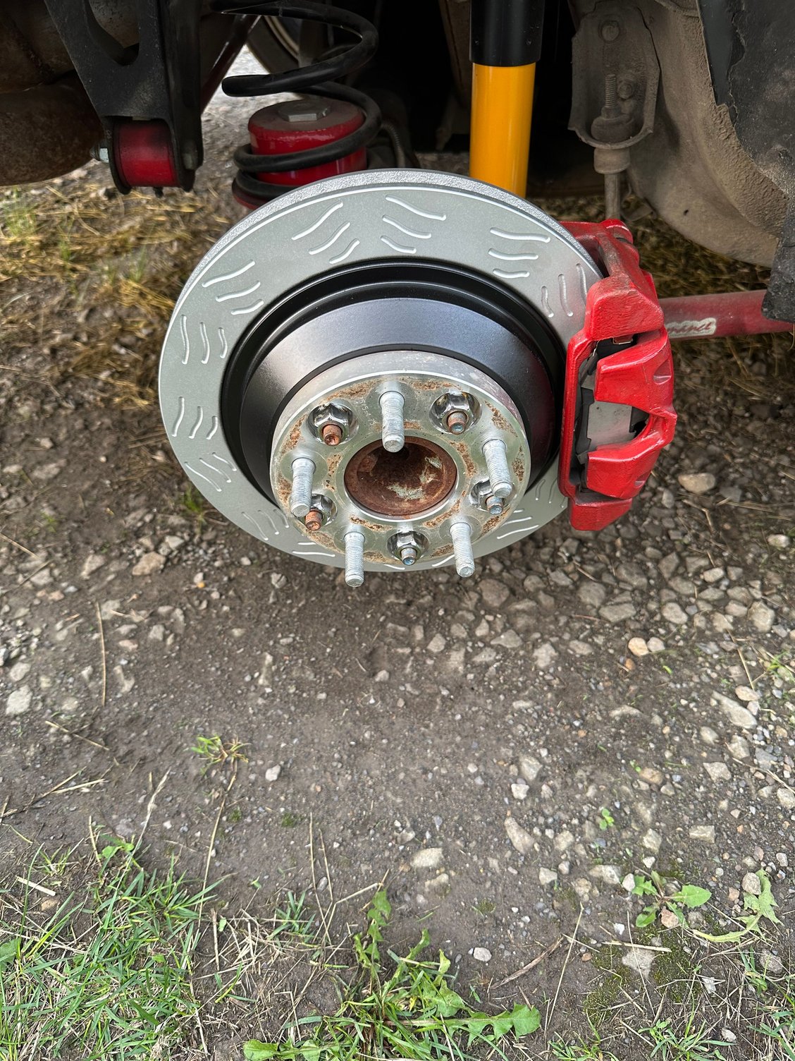

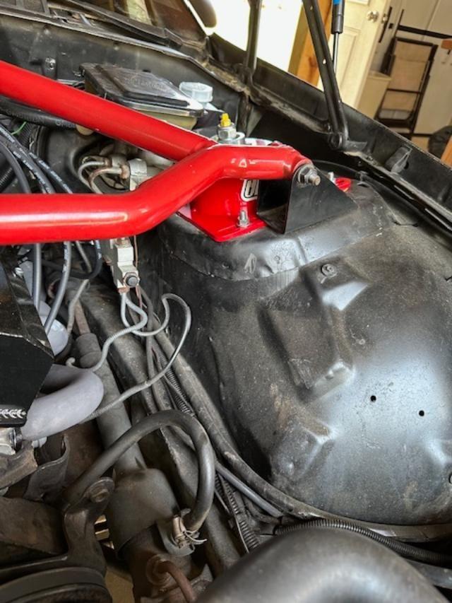

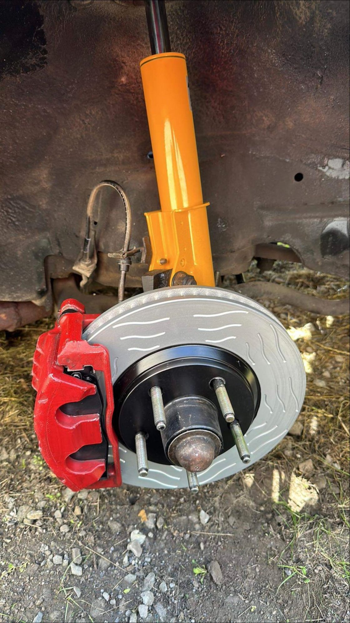

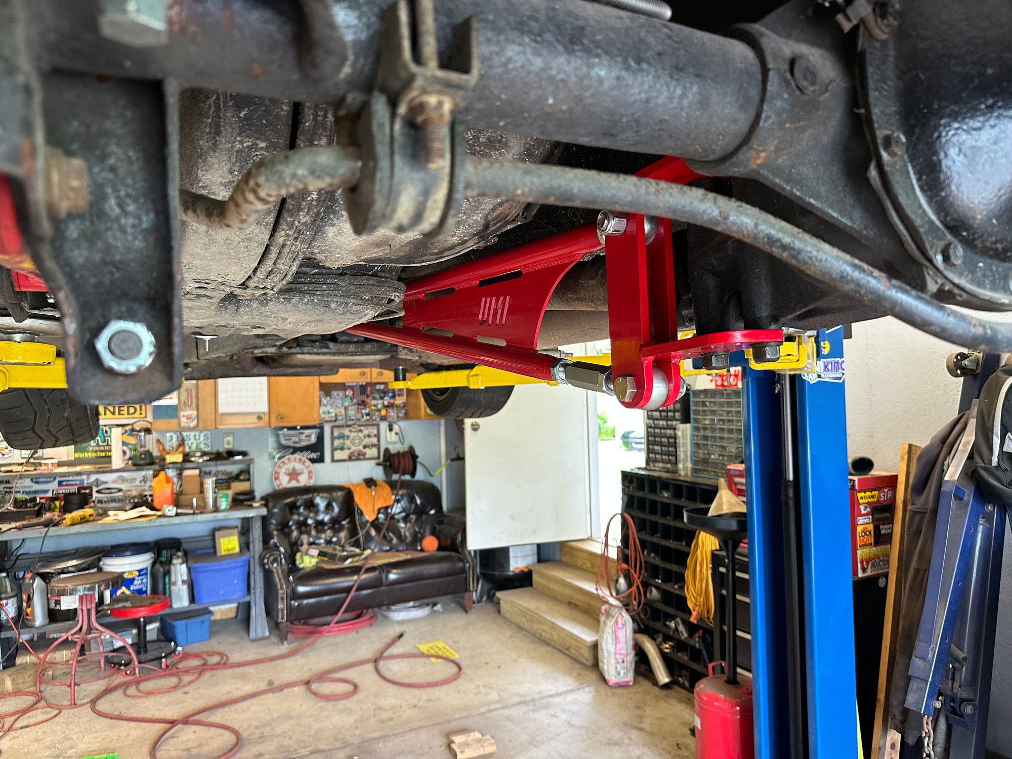

Just can’t leave the car alone. UMI torque arm, Koni sport struts, Raybestos s-groove rotors and Hawk pads installed. Now I’m done for this year. Have an autocross event in a couple weeks. I have been able to take the car out a few times so far to a cruise and a car show. Looking forward to putting some more miles on.

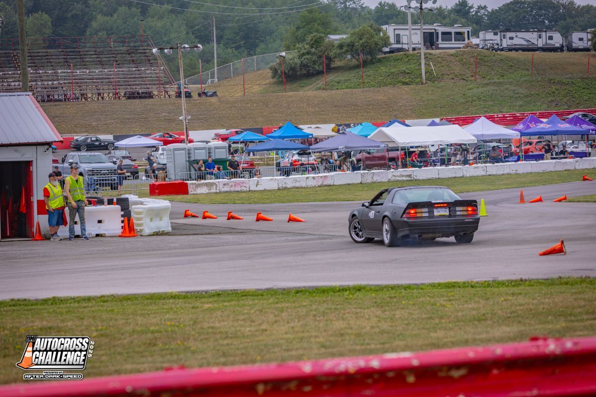

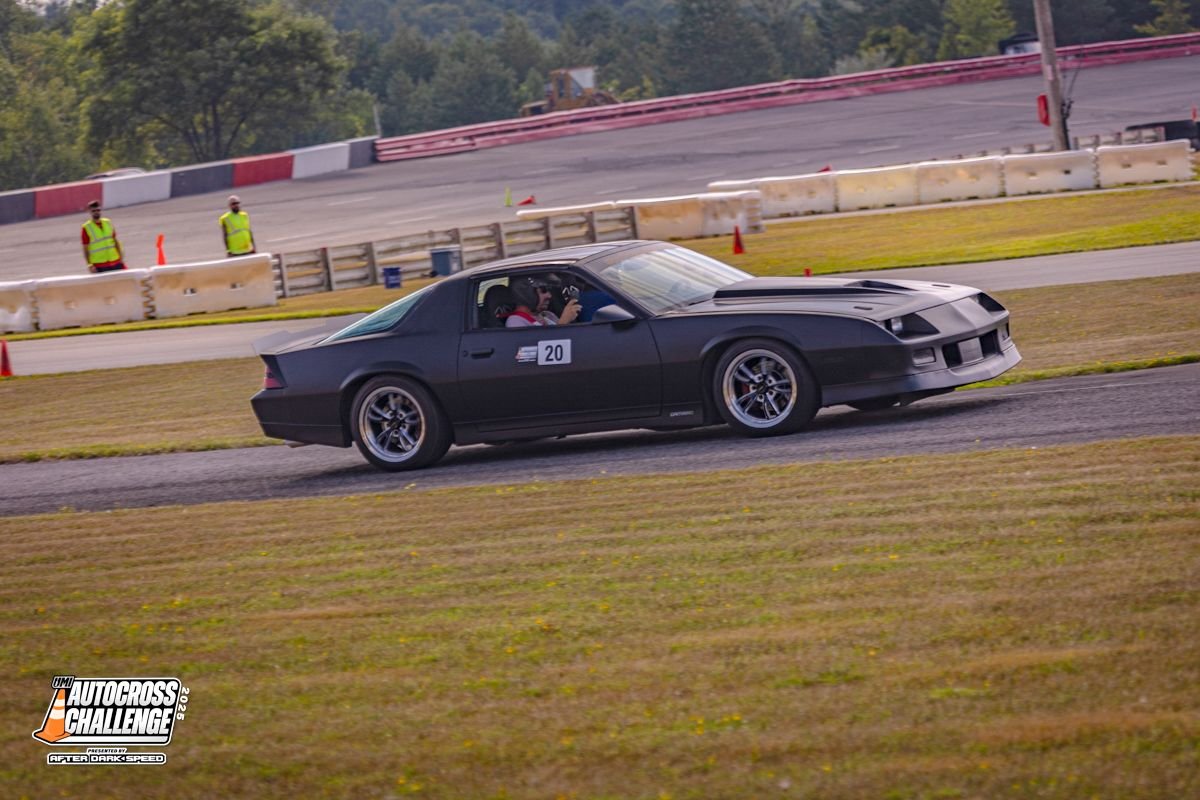

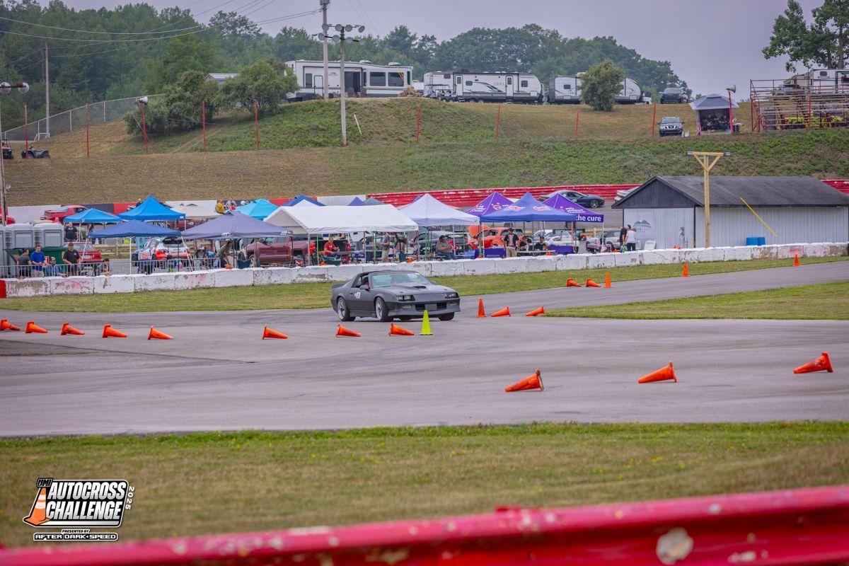

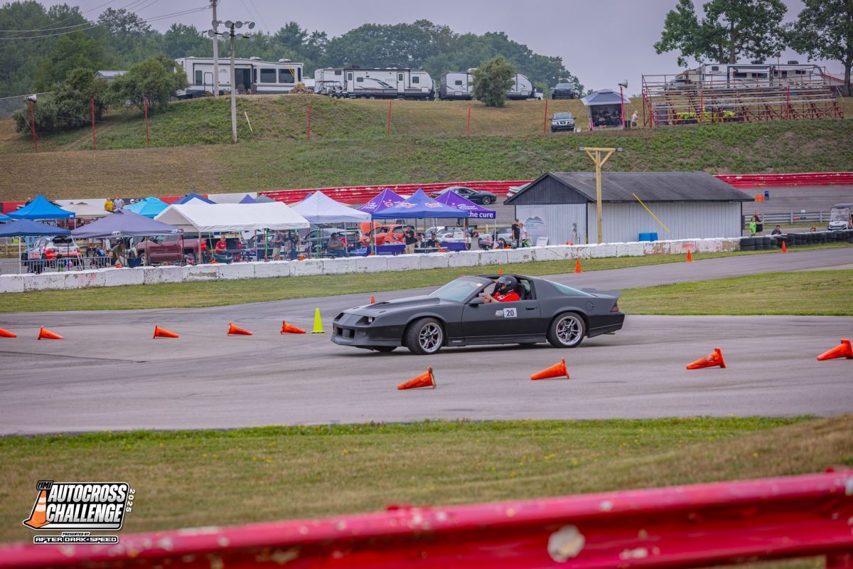

Update: Ran the car at UMI Autocross challenge last weekend. Car did well and handled great. I did break an alternator at the end of day 1 and had to scramble to get a new one but had it fixed that night. Day 2 went good with no issues. Won a few prizes including a $225 Summit gift card. With encouragement from my group of racing friends I have decided to manual swap my car. Only a T5 but I still have the 305 in it so it will be better than the automatic. Still have a few more car cruises and shows to hit this year so fall will start the swap. Can't wait to row some gears next year!

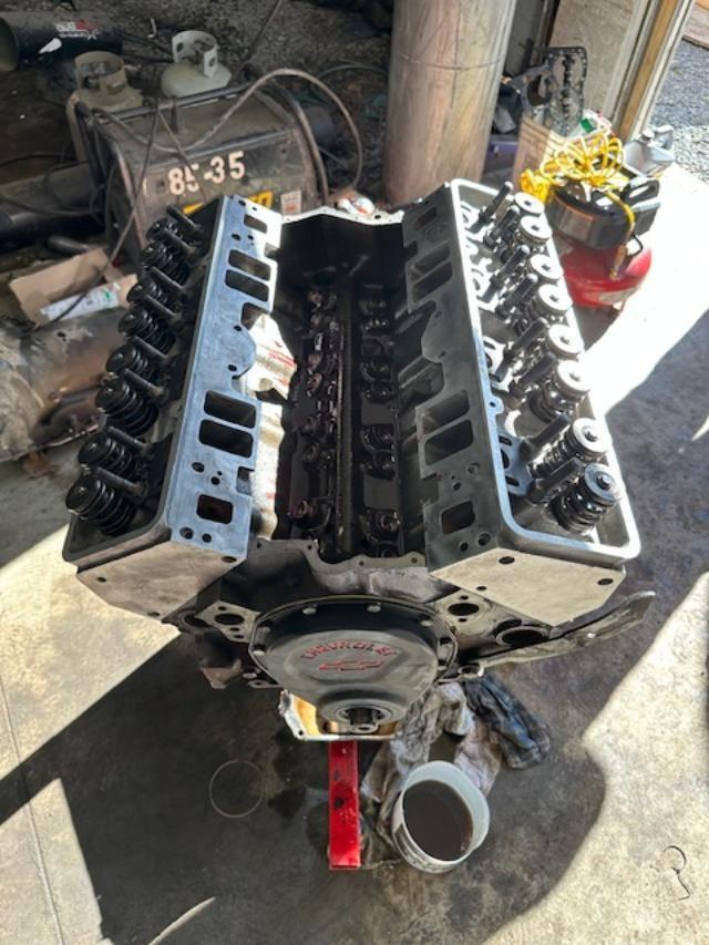

Have cleaned up the heads I bought. Just a set of speedmaster aluminum heads 64cc chambers 2.02/1.60 valves 1.6 aluminum roller rockers with 7/16" screw in studs and guide plates. They have been previously ported and polished. I have lapped in the valves and they are ready to go on the short block. Purchased a Comp cams XE274 high energy cam and lifter set. Engine should be good for around 425 tq and 425 hp. A little much for the T5 so I will have to be careful till I can upgrade the tranny. Looking forward to spring to get it all installed. Also getting some other wheels ZR1 reps in 17" x 11".

Update on engine project. Mostly assembled had to order the correct pushrods before we went any farther. Will be finished up this weekend and ready to swap in the car along with the T5 transmission. Hoping to have it all done by middle to end of May.

Fired the engine last weekend. My buddy has a run stand so we broke in the cam and made sure we had no leaks. Engine sounds good and had no issues other than a valve cover leak. Next weekend will start the process of engine/trans swap. Can't wait to see what this thing can do. Will have more photos of the tear down and swap as we do it.

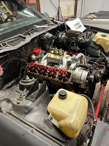

Re: 85 Berlinetta build.
Making lots of progress on the engine/trans swap. Also a new UMI trans/torque arm relocation bracket.

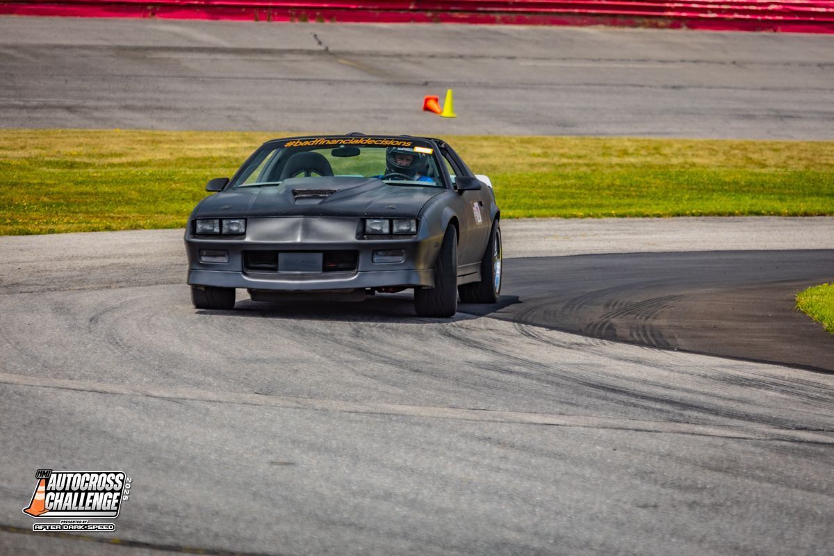

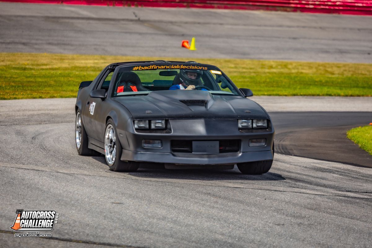

Well this years autocross did not go as planned. First run on day one went good car felt fast and handled good. Got back in line for run 2 and car wouldn’t start. Starter was heat soaked. Missed 3 morning runs and got it ready for afternoon runs. Decided to let it run in line. Big mistake. Car started to overheat but was just about ready for my run. Went to move up in line and brake pedal went right to the floor. Brake fluid boiled. I guess I should have guessed the cooling system needed an upgrade with the new engine and need to move my brake lines away from the headers. New parts already ordered.

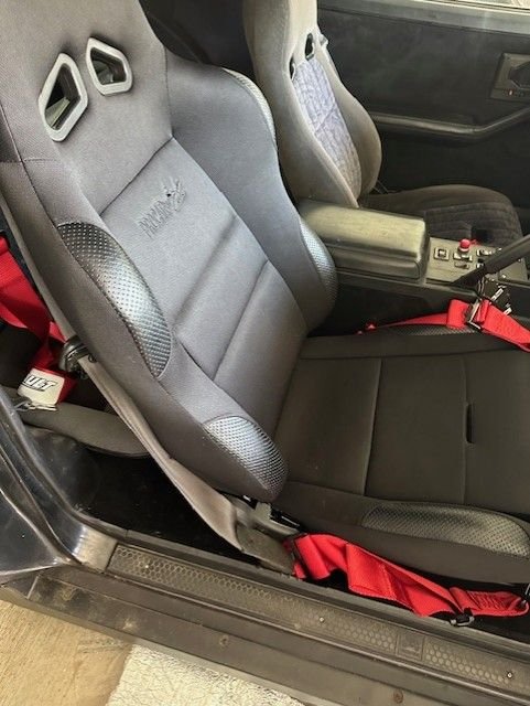

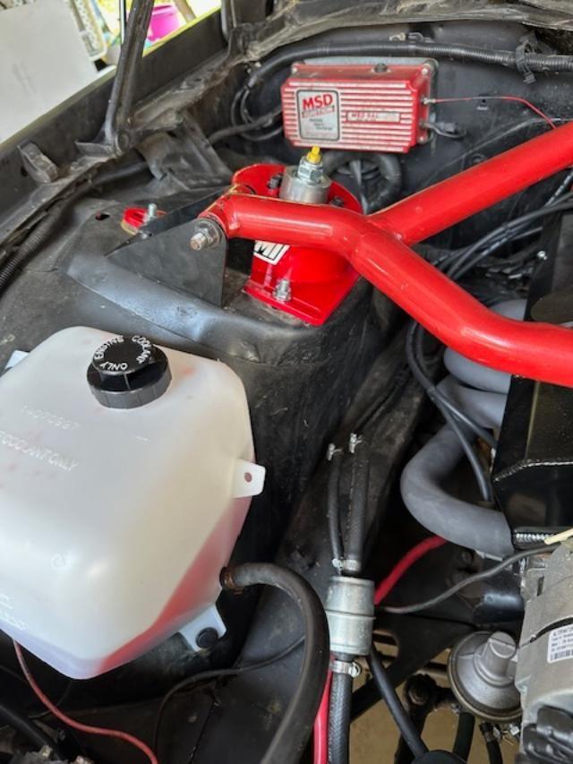

Some things going on this winter. New set of Vision 149 17x10 wheels and new Procar seats. Still have some other things to do but to cold for that right now.

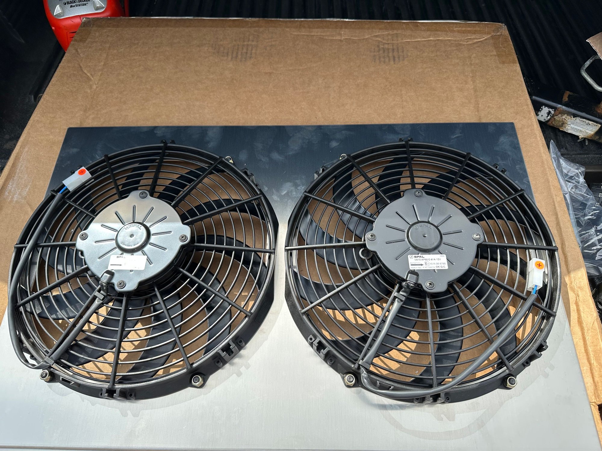

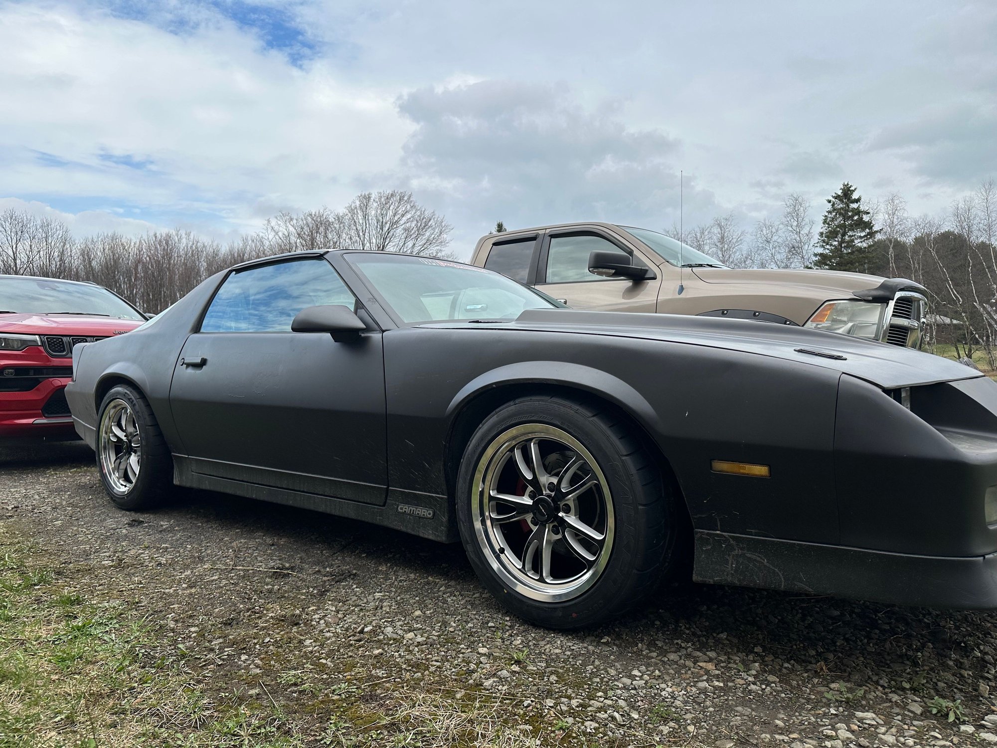

Finally getting some things done. New fan shroud with dual 12” Spal fans. New wheels and tires on.

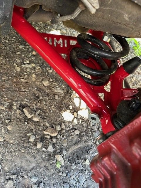

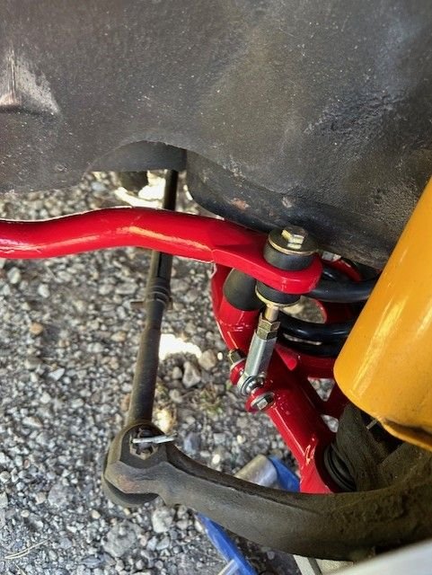

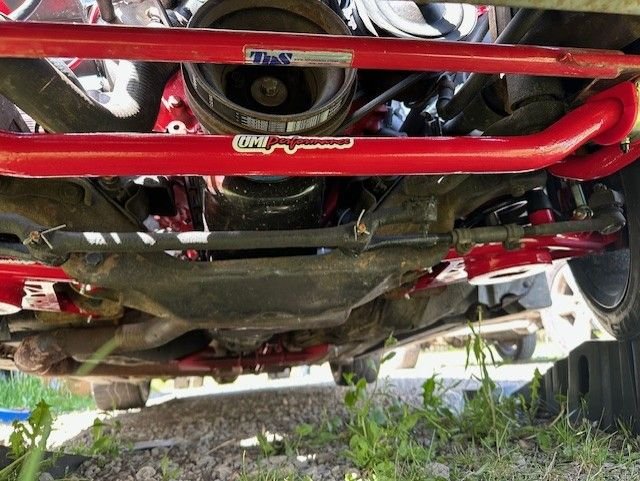

Finally got my front control arms on and got a new UMI sway bar. Car is all buttoned up for this year and ready to do some cruising and autocross.

I finally got my overheating problem fixed. Those new Spal fans did the trick. Took it out yesterday in 95 deg heat and it never went over 195. let it idle in my driveway after my drive and it sat at 190.

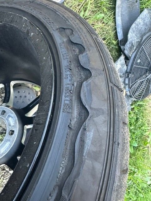

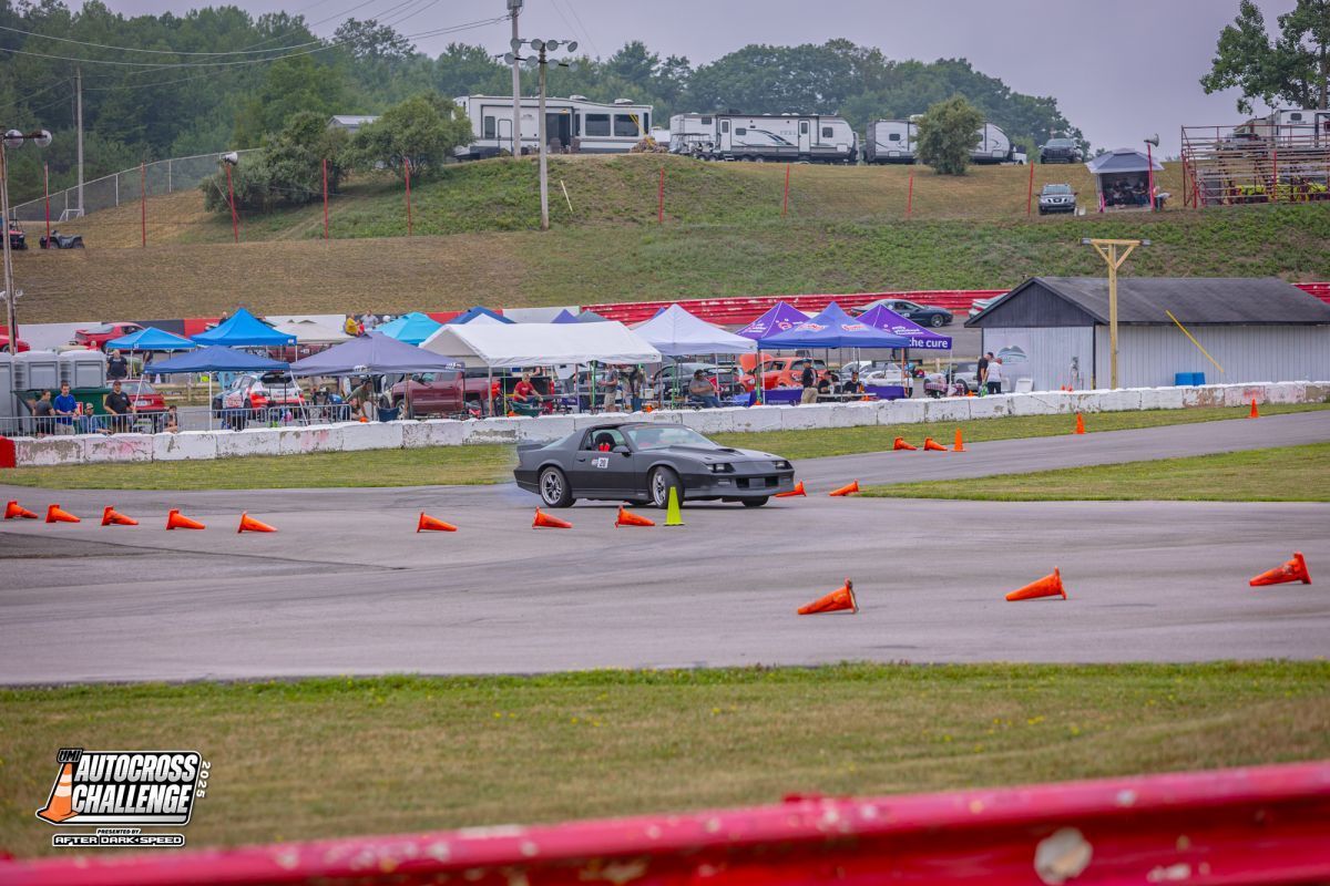

Finally able to update since UMI autocross challenge. Car ran great all weekend. I did have a spin and ruined a tire as it caught the inner lip of the body and shredded it.

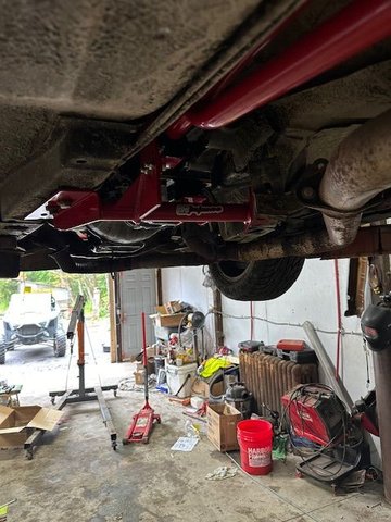

Getting ready for some more upgrades. UMI road race K-member, hi torque starter and new steering wheel with quick disconnect.

That's gonna' be a pretty big job ---- Looking forward to seeing your installation pics !

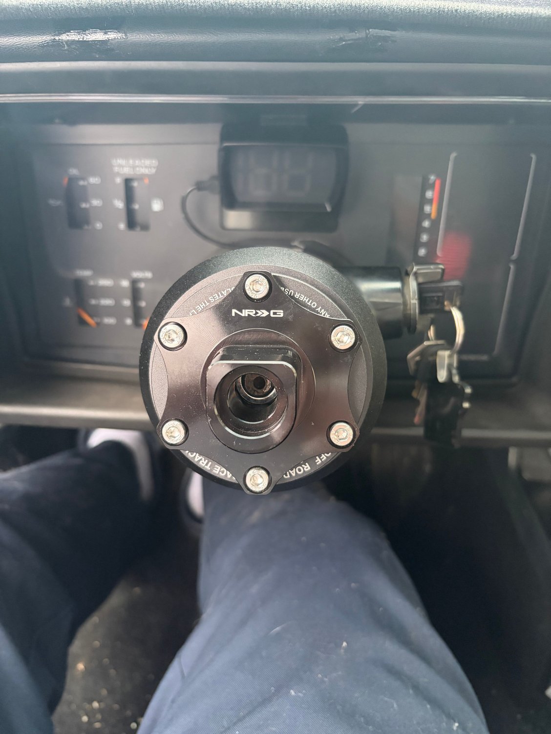

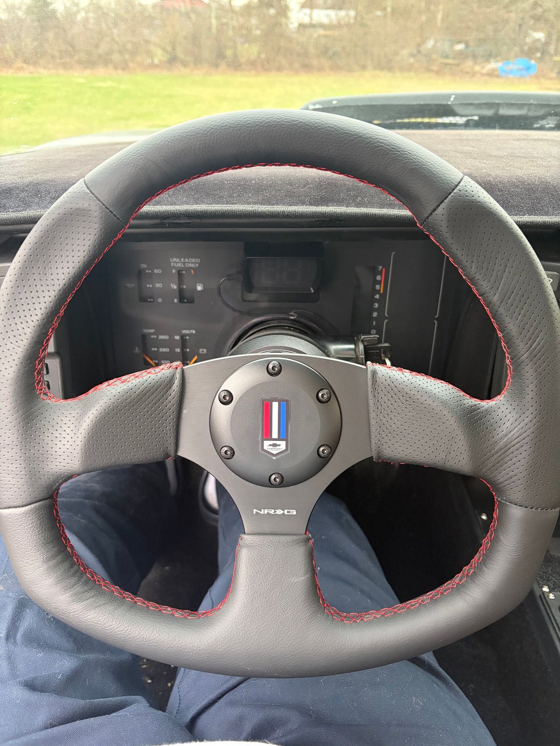

Got a new steering wheel and quick disconnect.
