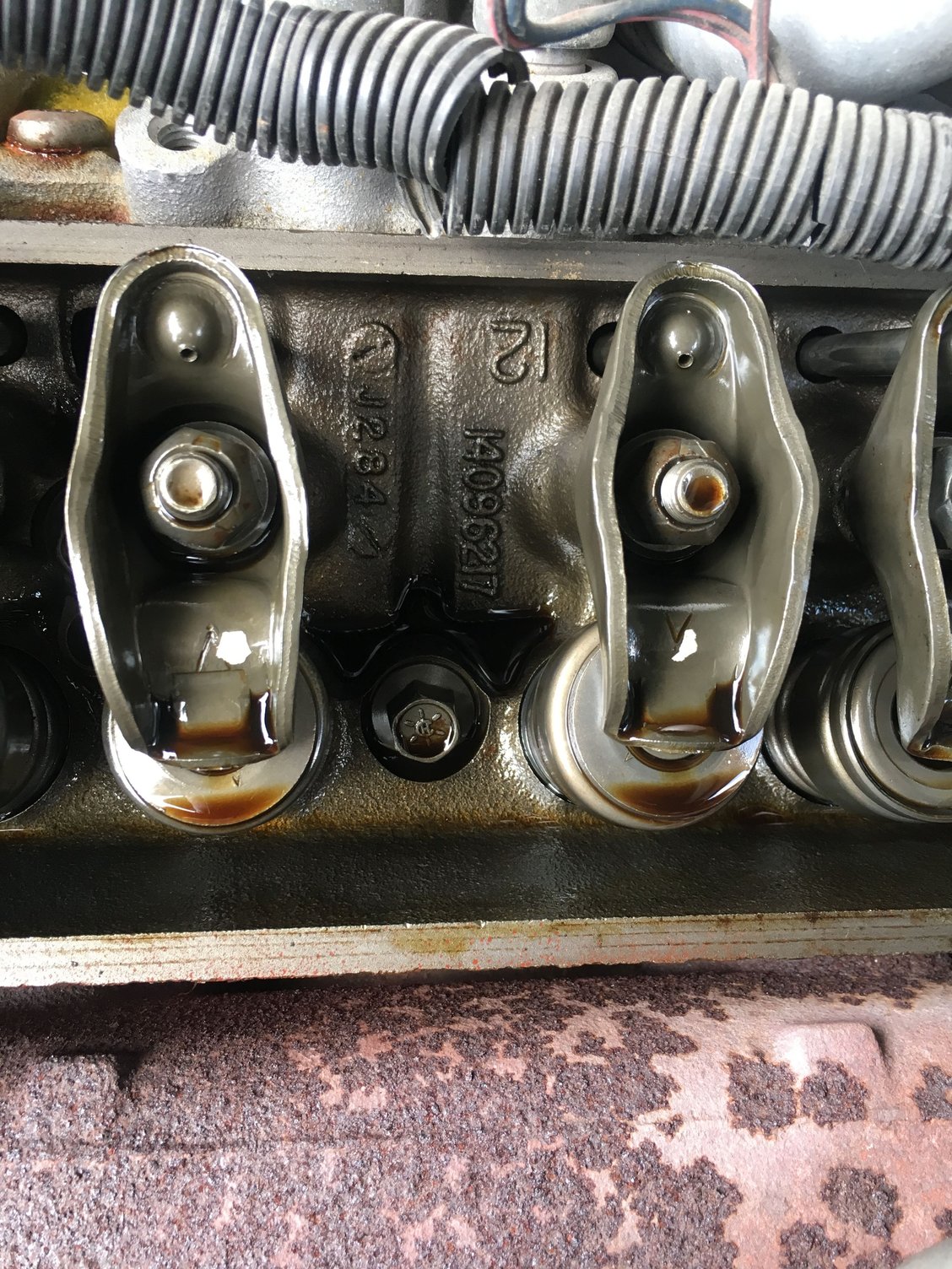

Since they didn't make a t-top IROC-Z with a 350 I'd like to find out what this 350 is out of. It'd be nice to know if it's an L98, 200+ HP, etc but the only thing I've found besides the 5.7LG SGI I believe is DJ216 off to the left, and 638 cast behind the psp. Can't see anything on a pad on the front of the passenger side head, the ac components are all in the way. Maybe I should just be happy it's really a 350.

See what #s are on the cylinder heads maybe they will be ending in 083..Thats the heads that come on L98s

Didn't get to check the cylinder head casting today but from what the PO stated they used everything from the LB9 and just dropped in a 350 block when the 305 crapped out.
Doesn't the 305 heads have the 1.84 valves? The 084's. The 350 heads should have the 1.94 valves correct? I wonder if your injectors have been changed to 22# for the 350.

I'm pretty sure the 305 heads pretty much all run 184 valves .305 TPI heads are #081. 305 TBI heads are #187 . We had a carbed 350 in an old 34 Chevy coupe running 081 heads with a lil cam and it ran very strong.

Re: My Unicorn - My 1990 IROC-Z
Without access to that pad that's behind the AC/SP bracket I'm taking long shots at other ways to track down the specs on a 350 sbc while the P/O is searching for records but mentioned to his recollection it was a GM crate engine installed by a shop.
- From L to R, I see a BIG # 5 then 5.7LG SGI then I see D121, does D121 mean anything?
P/O Response: "What we do know is that the block was swapped out, as well as the crank and the main bearings and all that because the crank had seized. Everything else that was in the engine was reused which is lifters heads cam everything else to my understanding."
I guess it can be narrowed down to a 87-95 and the D121 should be the date code? April 12, 1991? 175hp, 215hp? Higher?
This became important once it sunk in that a older Mitsubishi eclipse smashed the gas on me on the highway and left me embarrassed and disappointed in the IROC-Z

Couldn't wait until lunch... Yes you see coolant off to the upper left, the thermostat gasket is toast.
Crate motor, 285/300hp
Roller Rockers? Flat-Tappet Rockers? Does it even matter when ordering parts / bolt on mods?
How do I milk all 300HP out of it
