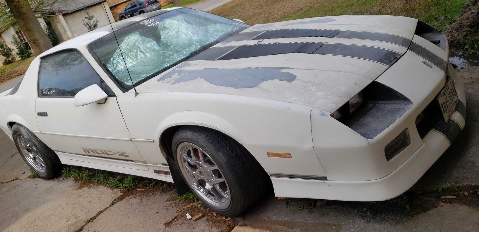

Im seeing people tell their story so I'll share mine and will do updates.
I found this car on craigslist back in 2012 or 13 and trailored it across Texas to my home. It was in really good shape at the time. Still had its original paint which looked good. Stock IROC wheels, the interior was almost all intact from the factory and it had the dreaded, sagging headliner.
One of the previous owners had taken out the original 5.0L motor and replaced it with a 5.7L TPI out of a 91 Corvette. The 4 speed auto was still in it and a "truck cam" had been installed. The car was super torquey down low but was a dog up top. I bought new wheels and fitted them with 245/285
tires. The previous owner had also put lower control arms and an upgraded sway bar on the car with Bilstein shocks.
I then had the following upgraded to the car: Dart iron eagle heads, 1.6 rockers, shorties, dual spintech mufflers, 13in Baer (front) brakes,11in Wilwood (rear) all slotted and drilled, 31 spline axles 3.73 gears. An electric cutout was also installed which are a lot of fun. I lowered the car but cant remember what springs I went with.
I didn't want to abandon the TPI motor for a swap. I know it's probably the better idea when it comes to power and possibly even financially. I've just been set on building a TPI because no one else is and it makes the car different.
Months later the transmission began slipping so I had a reputable transmission shop completely rebuild it all the way through upgrading everything and went with a 3200 Yank convertor. I was itching to add some black to the car so I had vinyl stripes added with gold metallic pin striping.
I've posted a pic of what it looked like in 2013/2014 before but will soon add that picture here

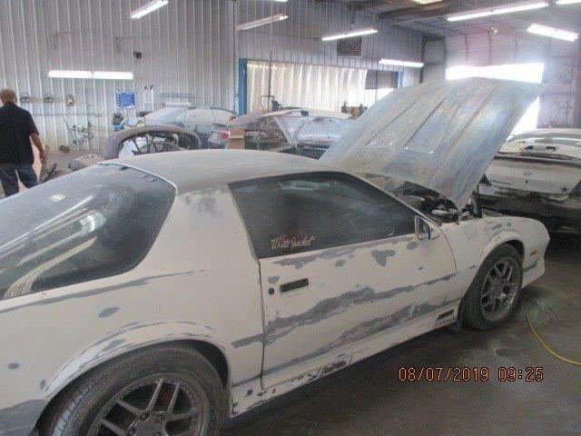

Some of the last pictures of Whitejacket before the paint went downhill.

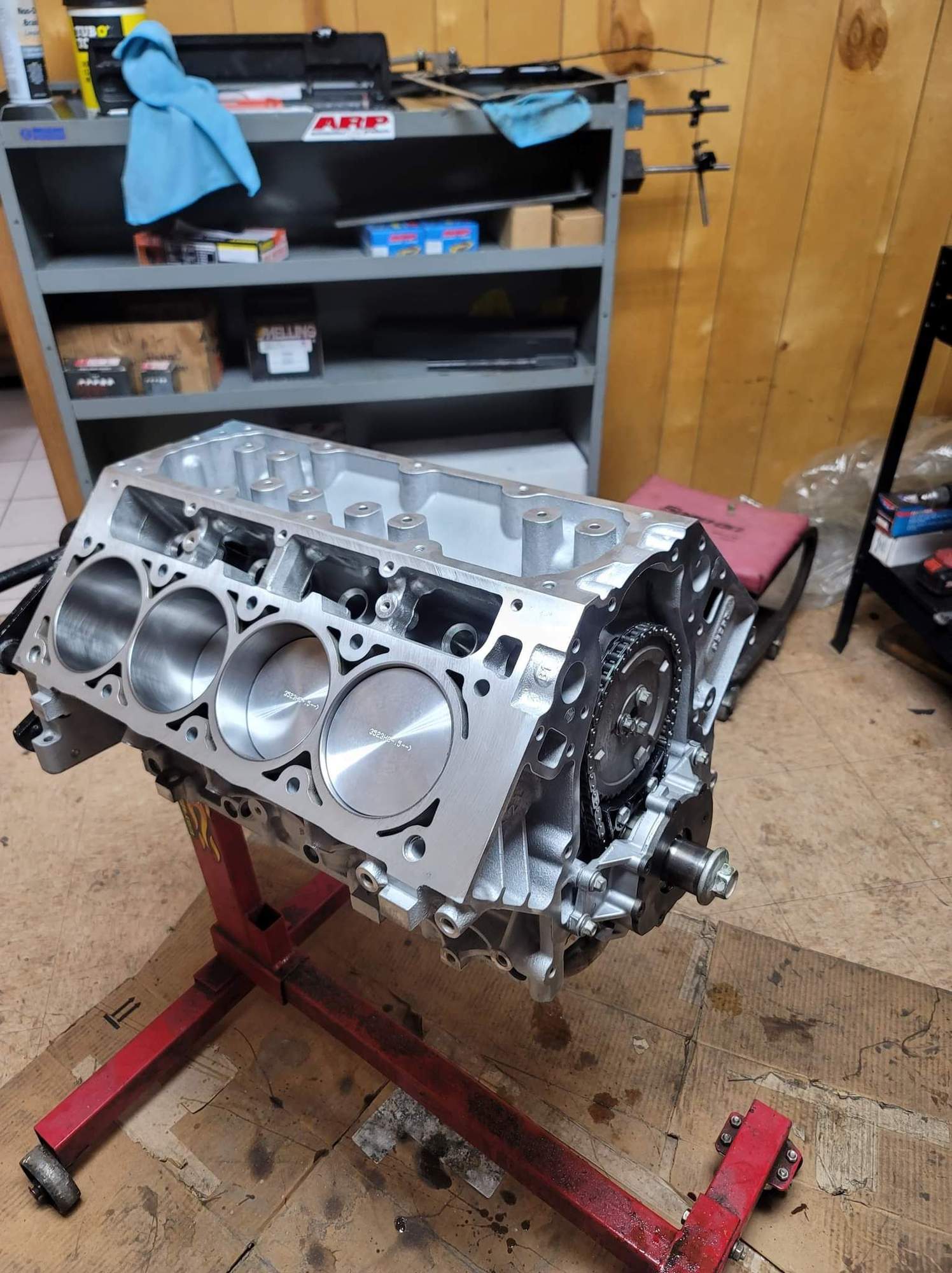

Here's the only two pics of the LS3. It was picked up today outta Houston.

- Freshly built LS3, hot tanked, light hone, square decked
- TSP stage III cam, 231/246, .640/.615, 111 LSA
- Cleveland cam bearings
- King main and rod bearings
- New plugs and barbell
- LS3 crankshaft still micropolished and balanced
- LS3 rods reconditioned w/ARP 2000 rod bolts
- Keith Black hyper flattop pistons
- Mahle piston rings gapped. 026 .028
- LS2 timing tensioner
- GM LS7 lifters and trays
- CNC Rebuilt 823 ported heads by Greg Good, Heads flow 374 cfm
- TSP .660 dual springs w/titanium retainers
- ARP head bolts
- GM rockers w/comp cams Trunniun upgrade
- 11:1 compression
Exact build made 540 RWHP in a manual.. I have a built 700R4 with 3200 yank

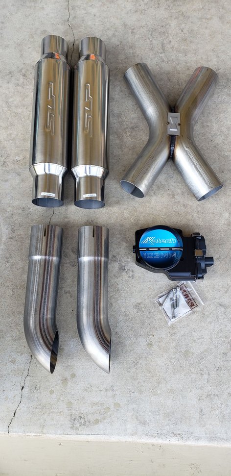

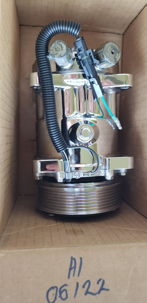

I have a potential buyer that's coming by this weekend for the 5.7 TPI motor that's currently in the car. Currently I'm looking at adding a T56 to the LS3 that's scheduled to go in.
Parts ordered a few days ago for this swap
Rock Auto
- power steering pressure hose #363170
- water pump #251744 (251-744)
- power steering pump pulley #12559890
- power steering reservoir bracket #12555222
- thermostat housing/water outlet #1511057 (15-11057)
- harmonic balancer #12560115
- harmonic balancer bolt #12557840
- power steering pump #12279
- power steering reservoir line hose #SK903A60
- timing cover seal #29602 (296-02)
- alternator generator #13597233
ICT Billit
- LS Corvette R4 A/C Air Conditioner Compressor Bracket LS1 LS3 CTS-V LSX LS7 LS9. SKU: 551585X-1
- L
S Corvette - Alternator / Power Steering Pump Bracket Kit. SKU: 551521X-1

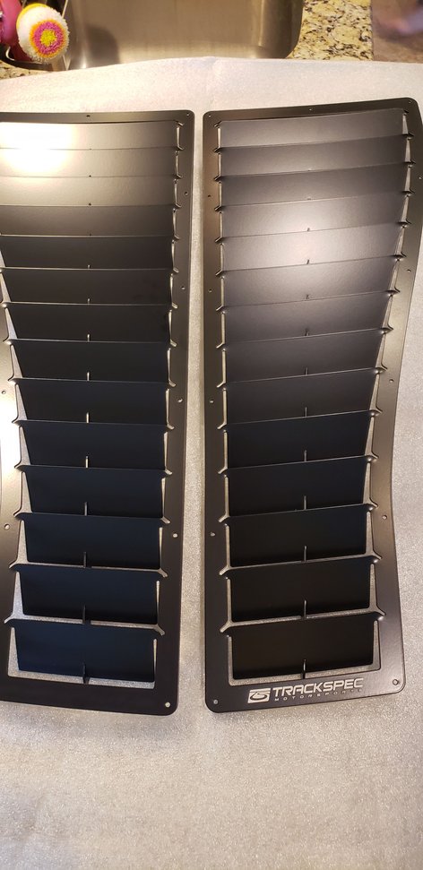

I've decided my first exterior upgrade will be ditching the original hood louvers for functional louvers.

Update time!
So I sold both the TPI motor and the 700R4.
The LS3 that I listed and posted pictures previously is officially in. I decided to go with a T56. Here are the specs
stage III T56 which includes:

Headers have been purchased. They are made for 82-92 Camaro/firebird LS1, LS2, LS3, LS6 swaps. 1 7/8 primaries, 3 inch collector, mandrel bent, 304 stainless, machined flange. Ill also be purchasing 2 SLP Loudmouth II bullet mufflers, and a stainless X-Pipe. The mufflers are 3 inch in and 3 inch out. Below are the part numbers for all three.
Long tube headers Speed-Engineering SKU: 25-1035
SLP Loudmouth II bullet mufflers Summit Racing SLP Performance 31067
Turn downs
JEGS 30536 3.0" ID Exhaust Turndowns Pair
X-Pipe JEGS Black Widow 3in stainless Part Number 112-BW0014-3
*NOTE* I will not be installing this exhaust myself. A local exhaust shop is doing the work.

Re: Whitejacket (87' Iroc)
Turn downs
Be prepared to **** off your family, friends, and neighbors with that exhaust. I speak from experience.
Many of my car buddies love the sound of my car, but they’re a bunch of cavemen like me, so……..

Yeah I'm a little worried about that but have already made up my mind. Im going to forewarn them before the car comes back. I've had really loud systems before but never in this neighborhood.
I saw the same x-pipe (close pipes) that you have but wasn't sure about fit. Yours looks great and I'm assuming it worked out nicely

The exhaust parts I listed (not the headers)came out to be $326 including tax/shipping with my military discount

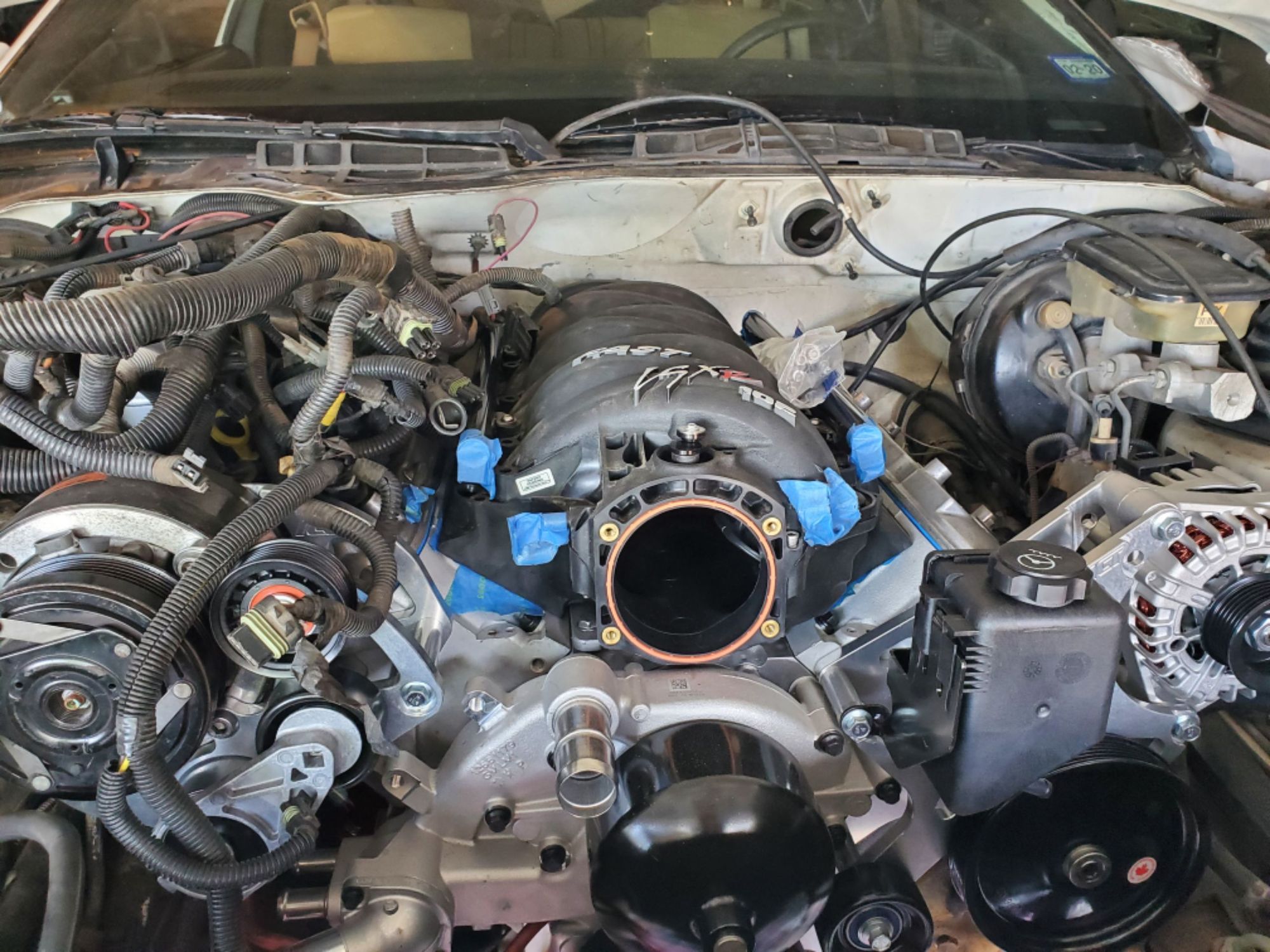

Update time! Parts are coming in and the guy putting my car together sent an updated pic. Thats the Fast LSXR intake. Shipped, I paid $900 from a guy that purchased and claimed to have never used it. It was in a box and his 1,200 hp setup was too much for this intake. I purchased the Katech 103mm drive by wire throttle body from Texas-Speed.

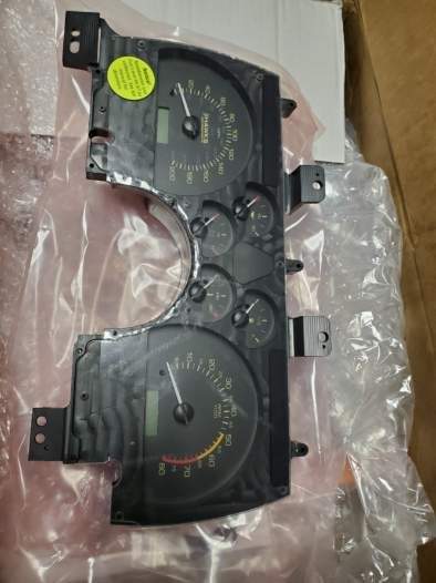

UPDATE TIME!
I got a text from my mechanic/friend last night. He stated that I needed a part, and only one company makes it. Who?? *sigh* Hawks Motorsports. This is less than a week after I swore I'd never deal with them again. Something that I left out of my crossmember post in this thread is, years ago I needed around 11k or so in parts. Most of them I planned on going through Hawks. That experience left me with buying elsewhere.
So here I am... getting texts and he also informs me I need a 90-92' gauge cluster. Apparently the options are, switching to an electric setup or converting electric to cable. My car is an 87' so its naturally cable. This is all in regards to the speedometer.
Last night I began looking at clusters while in bed. After about 45 mins of looking around, I find "THE ONE," you know, when you find something and you just have to have it. Price be damned. Well... it appeared that only company that sells it is... you guessed it, Hawks Motorsports. FML
So with my tail tucked between my legs I call them, and Ryan from customer service/sales answers. He asks me If I've ever purchased through them before. I said yes, and mentioned my last order disappeared into thin air. I wasn't rude to him because, to be honest, it wasn't Hawks fault to begin with and I made that clear. The address I gave them was incorrect. Instead of giving my mechanics address to his home, I gave the address to his community event center for his neighborhood!
To make matters worse, the address to that building was to an open field next to the center. So FedEx, in all their glory dumps it at their door. If your community event center is like most. The doors stay locked and they only open when an event is scheduled. No one is rarely there! Also, I apparently didn't check off the box on my order for some sorta delivery insurance which they told me was like... $4?
Either way, I recommend that you take that option. It cost me a couple hundred dollars in the end
Back to Hawks, and this guy named Ryan. Ryan completes my order and informs me it didn't go through. I'm thinking, you gotta be kidding me, it's always something when I call these people. He asks for my card number and he forgot the last digit lol
After that was finished we talked more on my previous issue. I never intended them to do anything other than take my order and end the call.. But this guy tells me hes calling me back. 5 mins later my phone rings and "HAWKS THIRD GEN" flashes on the caller ID. Its Ryan, he did some research, established everything I said was true. He then tells me he's going to get with someone above him to see what they can do!
Wow! I'm very impressed and surprised. I was not anticipating any of this. I assumed last week I was stuck like Chuck and just took it on the chin.
I wanna thank Ryan at Hawks Motorsports

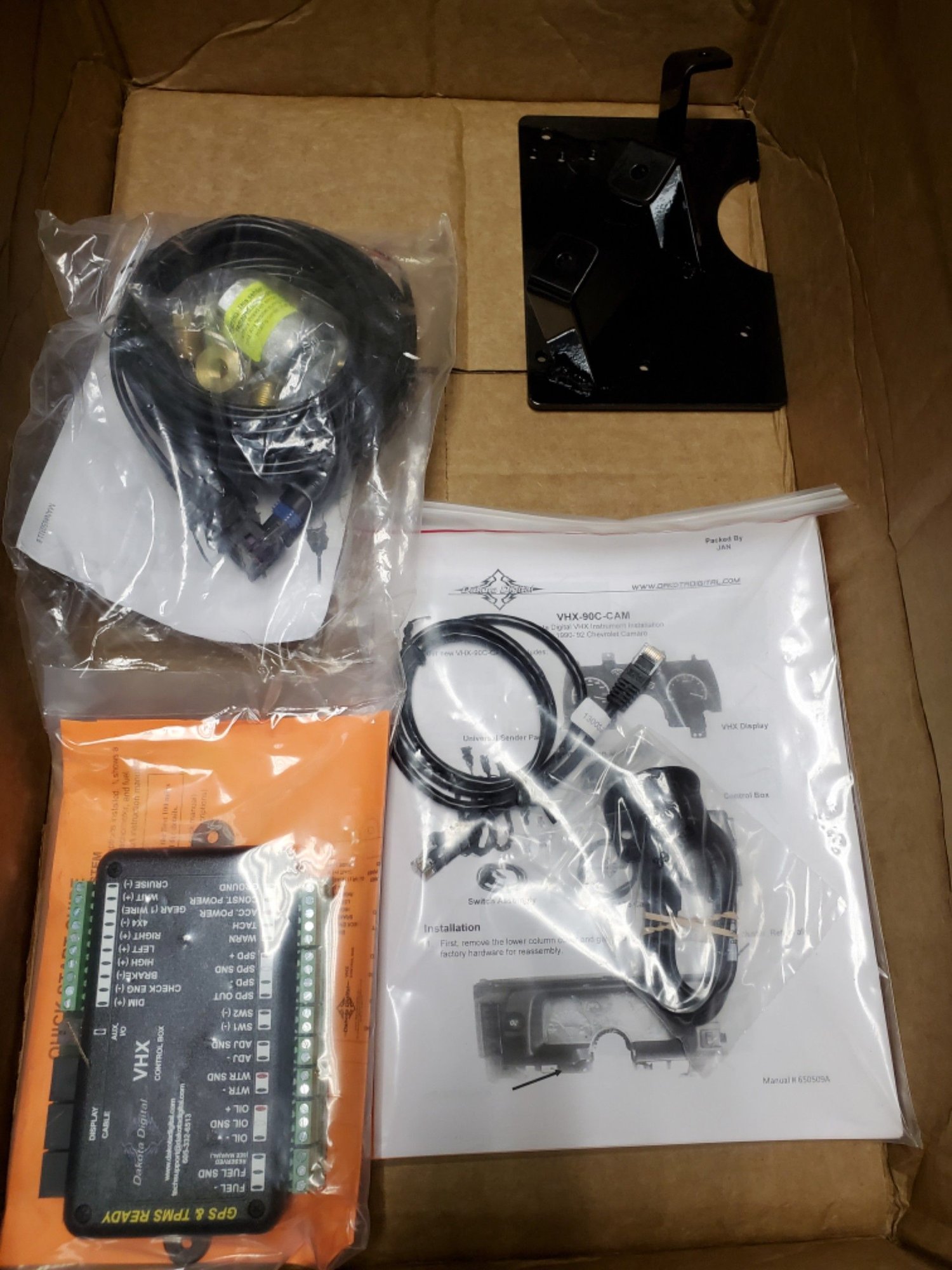

Here's exactly what I ordered. I'll have the mechanic take pics of my cluster when it comes in and do some show and tell.
82-92 CAMARO/FIREBIRD LSX SWAP ELECTRONIC GAS PEDAL MOUNTING BRACKET LS2/LS3/LS7 $49.95
1990-92 Camaro Hawks Restoration Series Instrument Cluster 200mph HM-VHX-90C-CAM-200 $845
1990-92 Camaro Hawks Restoration Series Instrument Cluster 200mph HM-VHX-90C-CAM-200 $845[/QUOTE]
You and your friend will really like the Dakota Digital gauges, they make the integration of all the components so much easier.

I'm hoping it will brighten up things a little. My current cluster has a scratch across it. Its not awful but it bugs me. Having a brand new one is exciting. I plan on showing the car some and small details like this add some, wow factor
I plan on keeping the stock cluster in a box. Ive seen so many parts off classic cars go for ridiculous money over the years. And who knows... maybe one day I'll get old and cheesy and decide to take on a project of returning it to factory spec

Get this! The cluster and bracket I ordered from Hawks needed a signature. My mechanic was not at his house but a note was left. I found out it was located at the nearest CVS store which is a central pickup area. He drives up there and they claim they don't have it. He gives them my name, his name.... nothing!
So I called and I get the same answer, they have nothing indicating its there and they checked every package. So I begin to dig in and find out it had been delivered to CVS and the person who signed for it was "Romero". When I call CVS back and tell them the information I just learned, you could them hear it in her voice that I wasn't some obnoxious customer who wouldn't stop calling. She did say they had a "Romero" and referred to them as "she"
So now a manger is looking and they call me back to tell me the store manager is getting involved and I would get a call back. The next morning my phone rings and sure enough its a manager stating they finally found it and it was located in some odd place that things are never kept.
When my mechanic goes to pick it up I get a text stating the box had been OPENED and parts might have been damaged!
It appears someone took the gamble of opening it to see if it was worth stealing and then hid it to buy time. Im guessing they hoped it wouldn't be found anytime soon?
All is well. Ill post a picture of it all. I've also ordered a bunch of parts which I'll share and post the part numbers and post pictures

1985-92 Camaro IROC-Z/Z28 Hood Louver Vent Kit
IROCT1HL Hawks Motorsports

I'm really looking forward to having functional hood louvers

They're in!

my pickup's backseat loaded down with parts and dropped off. The stupid cross member is on backorder and slowing everything down
