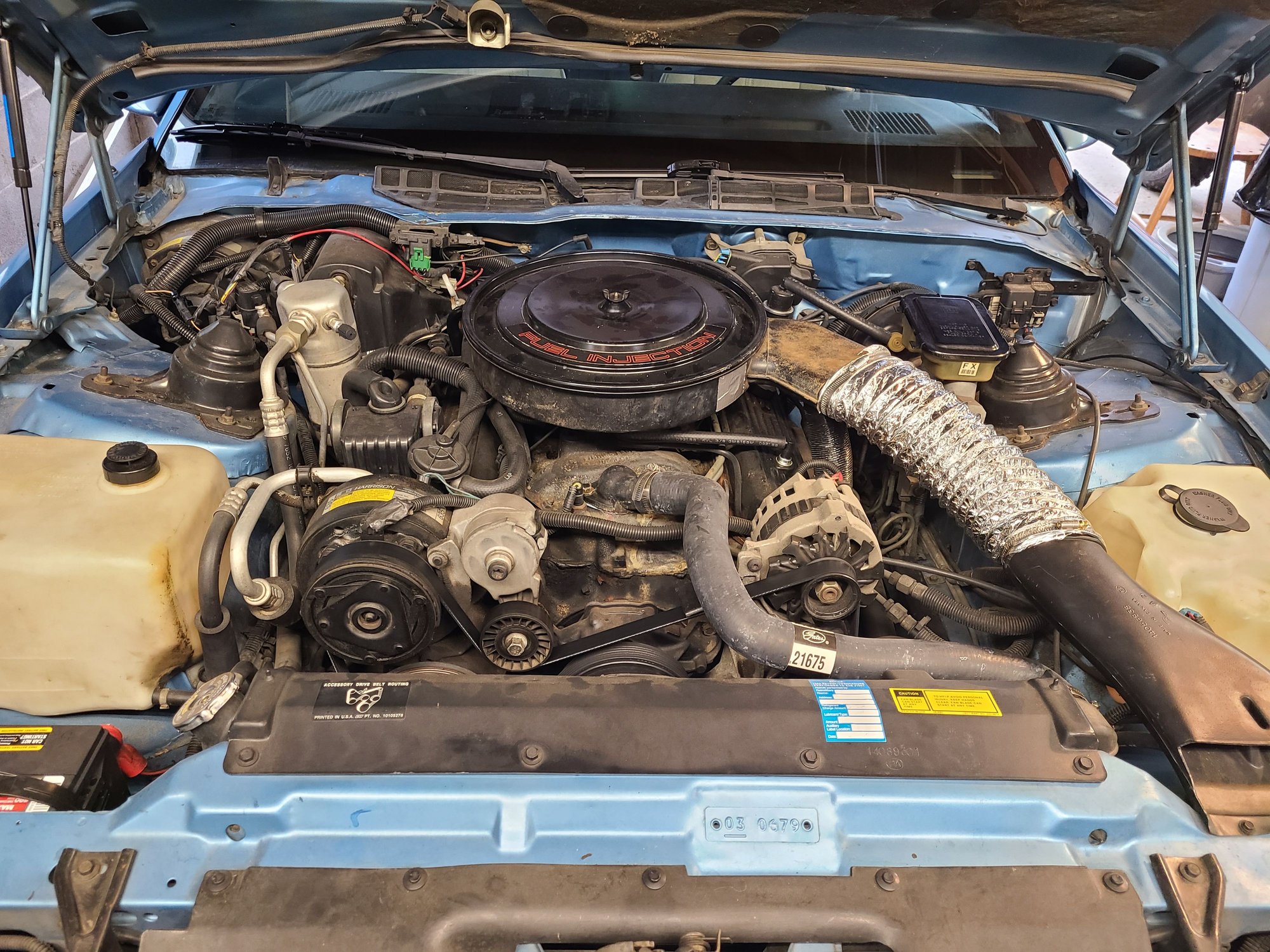

I got to spend some time in the garage this evening and got the truck air filter base installed.
The reason I wanted to do this is two fold.
Firstly, the factory snorkle REALLY necks down and limits potential air flow.
Secondly the ThermAC heat riser port on the car base stays open all the time.The truck base has a two part system. One flap opens the cool air feed to the snorkle and there is another flap that closes off the heat riser port to help maintain and control the inlet temperatures.
Here you can see the original base and intake hose. It has a truck lid installed on the factory base in this picture.
The truck base has a built in spacer but it's not as tall as the factory spacer. I used a 1/4" plastic spacer under the base to allow me to clock out without grinding out the ears in the neck of the filter. This allowed me turn the snorkel from the passenger side to the driver's side to clear the AIR box and heater hose fittings. I hole sawed holes for the IAT sensor and PCV vent breather in the proper locations and then sealed the old PCV breather hole with duct tape for the time being. Then I was able to install the factory car lid and air filter as well as use some 4" drier vent tubing to hook up the cold air scoop behind the driver's side headlights. I had to put a vacuum cap on the old ThermAC supply port on the throttle body as well.
I was even able to use the factory heat riser tube from the manifold to the snorkle to help warm up the engine and maintain inlet temperatures.
Here you can see the factory snorkle and how it necks down at the tube that attaches to the scoop.
As it turns out, the truck base doesn't shroud the injector pod as much as the F-body one which should allow for more and better air flow into the throttle body.
A little test drive without any hard data makes me think it helped. IATs were better than I expected. No higher than 120°F idling around town and a cool 95°F on the interstate

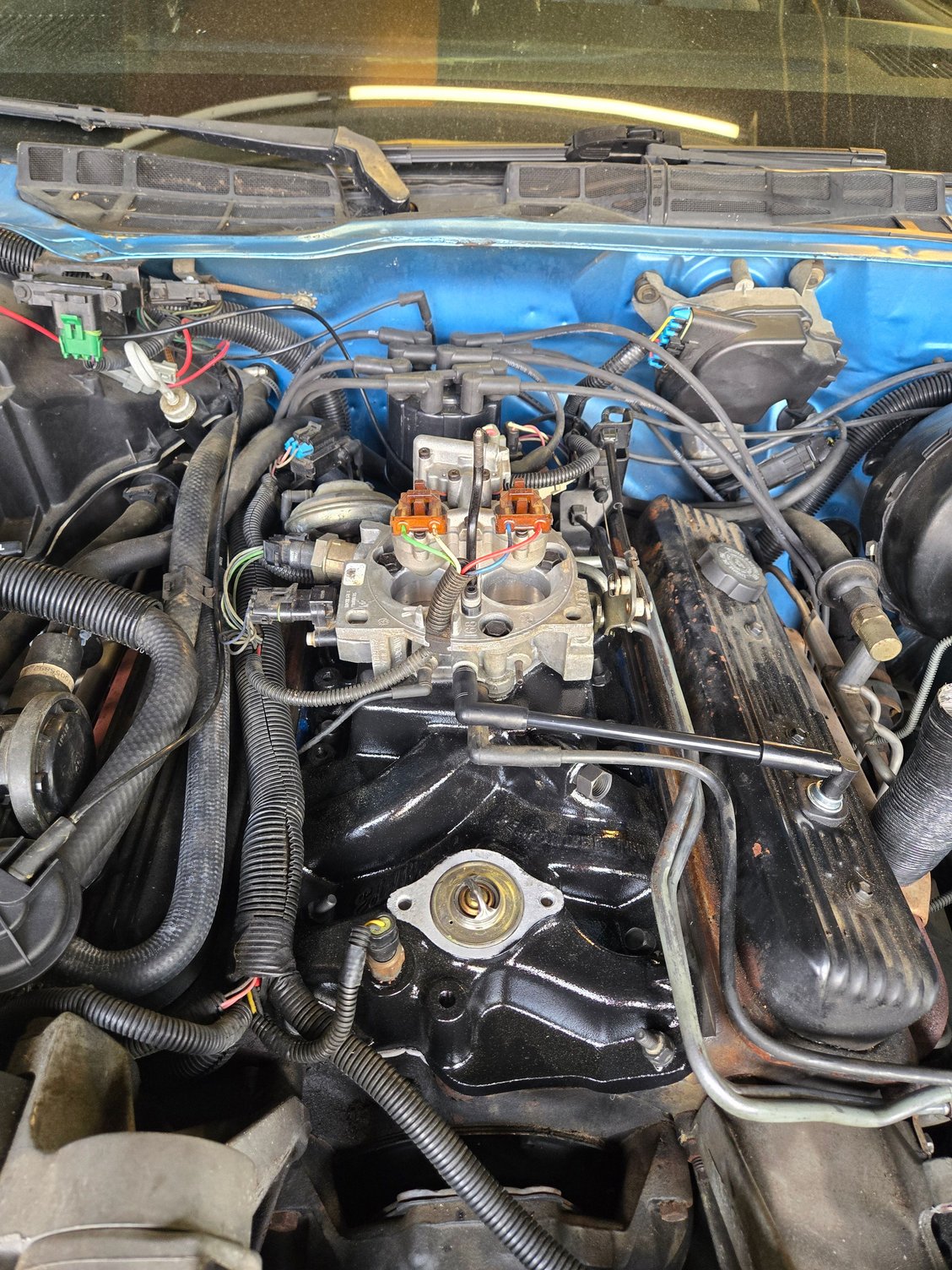

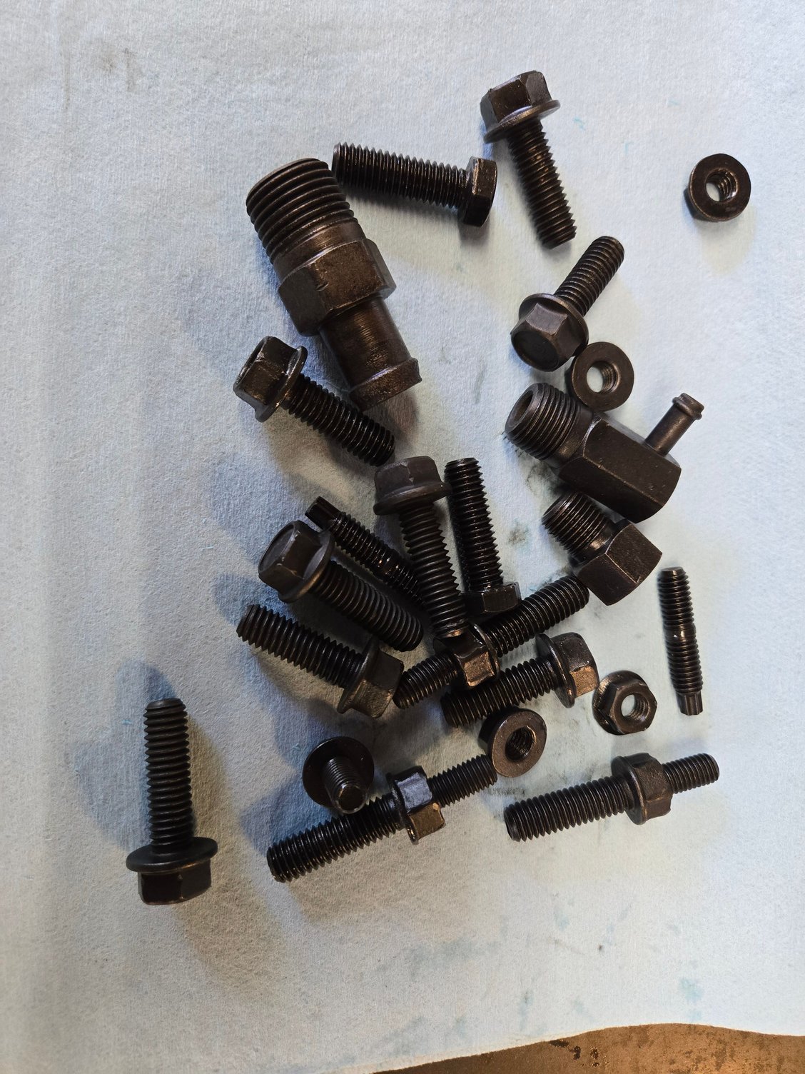

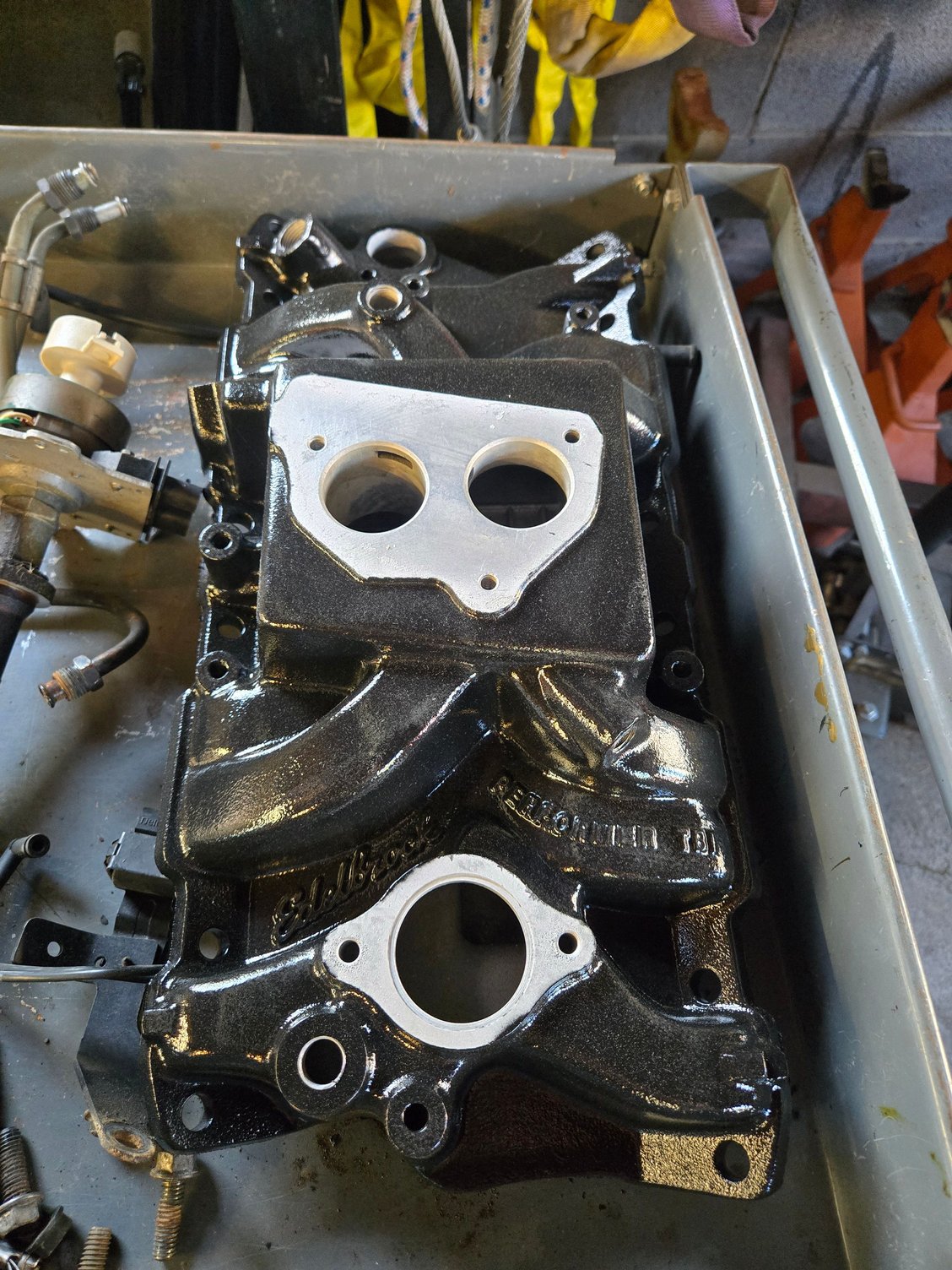

Been a while. Too much going on to really work on the Camaro much. Got it out Sunday and drove it around. The heater control valve was leaking when I got home so I tried to snug the hose clamp to see if that would help and the nipple broke off and covered me in warm coolant.
Wound up pulling the intake to swap on my Edelbrock TBI manifold since the coolant was drained and found a crack in the heater outlet on it. Supposed to have a guy look at welding it up this evening so hopefully I can get it back together soon.
Gonna do a few TBI mods and clean the throttle body while it's apart.

I have one of those intakes too (not yet installed). I hope you'll post and let us know if you can feel any seat-of-the-pants difference with the intake and TBI mods. Not expecting miracles, but a noticeable difference would be nice.

I'm not expecting much. I'm sure it has some benefit or Edelbrock wouldn't still be making it nearly 40 years after the TBI went out of production. I want it more for the nostalgia of it. I figure with a set of headers and possibly a cam, it'll show some gains but that's not this go round. I'd like to get some LB9 heads and a L31 cam in it eventually. But I need to be able to tune it first.

Intake is repaired. I've got to prep it for paint. Injectors and pod spacer from CFM Technologies have arrived. Lots of parts showing up from Rock Auto soon. Got my distributor from @Airwolfe today as well.
Gotta see if my TBI rebuild kit has a regulator diaphragm in it and order the adjustable regulator and decide on a WBO2 setup to get it all adjusted up.

Cleaned up the throttle body, ground down the air horns, installed a JET adjustable fuel pressure regulator, matched injectors from CFM Technologies and one of their injector pod spacers.
Got to clean up my manifold bolts and do a black oxide coating on them and I'll be ready to start reassembling it.

Took my intake bolts over to a buddy's shop and bead blasted them. Then used a black oxide treatment on them.

[QUOTE=sleeper84;6584479]Took my intake bolts over to a buddy's shop and bead blasted them. Then used a black oxide treatment on them.
I’m doing some bolts/hose clamps on mine. The oil sealer won’t last long so I’m going to spray them with catalyzed satin clear. This is without the satin clear on yet….

I need to find something I guess but I've never had luck painting bolts then tightened them.

Making progress. Gotta bend up a new brake vacuum line since the OE one doesn't fit. Also have a replacement breather grommet inbound. Hope to get it started sometime this week.
Old May 2, 2026 | 08:45 PM
Airwolfe's Avatar
Joined: Oct 2020
Posts: 1,462
Likes: 713
Car: 1992 Pontiac Firebird
Engine: 5.0L L03 TBI
Re: 1989 RS Revival
Caught my eye that the green connector with the lighter green weatherpack seal isn't properly seated into the MAP sensor.
I think when Edelbrock designed the Performer TBI intake manifold it was with an eye toward installation into GMT400 trucks. Maybe the vacuum brake line from a GMT400 truck would work or maybe combined with an F-body vacuum line would work. Your welder buddy could fix you up if cutting and welding both together would make something that fit right.
Also keep in mind that the Edelbrock Performer TBI intake manifold has a TBI pad height that is about 0.250" taller than the stock GM TBI intake manifold. I noticed that you have had a GMT400 truck air cleaner lid installed that is 0.9875" taller than the stock F-body air cleaner lid.
Check air cleaner to hood clearance before slamming the hood shut.

I have never noticed the MAP plug. I have personally never had it unplugged so I will remedy that.
For the air cleaner, I'm running a GMT400 base with the Camaro lid and filter. I had to run a 1/4" spacer to clear the distributor with the stock manifold so I'm hoping I can go without it and be OK this way. It really opens up flow and the larger snorkel helps as well.
It's not pretty but it's a work in progress.

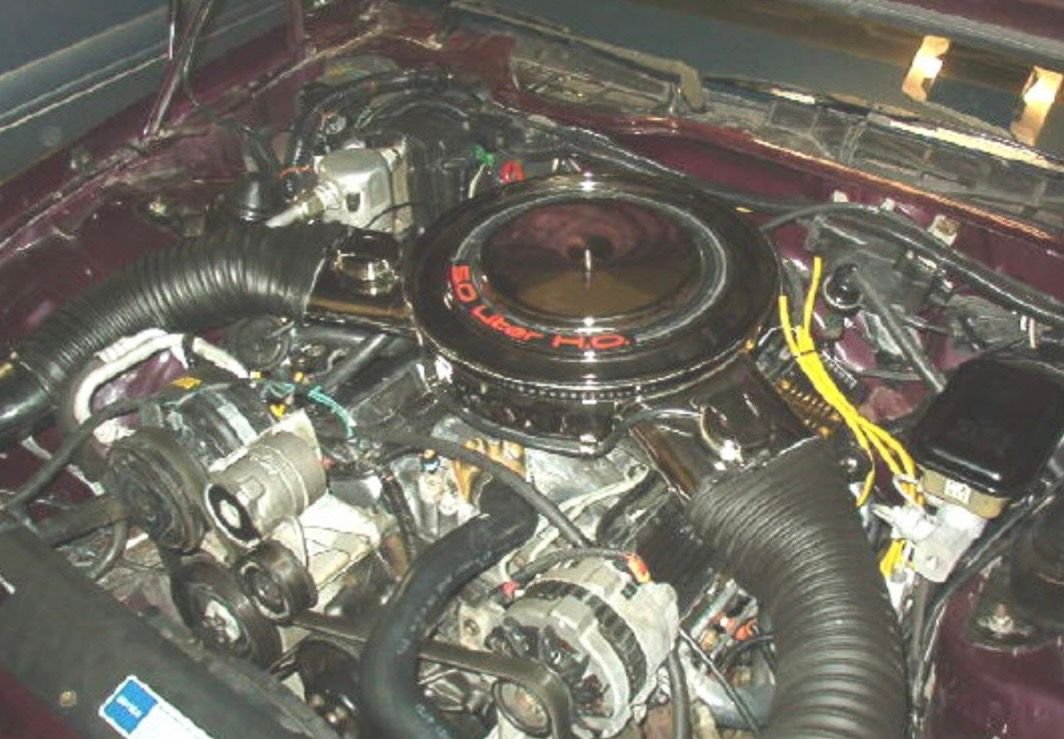

Have you thought about running a dual snorkel air cleaner from the L69?

I have but for the price and with my A/C and AIR intact, I don't think it would fit.

There was a member here named (azvolfan) that did a dual snorkel on his L03. However, his last post was in ‘19.

That's looks pretty good but I think he had to relocate the coolant jug.
