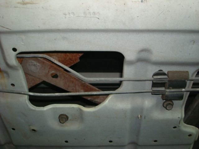

At some point in this cars history the doors had been gutted and aluminum panels made. I've removed those, drilled out the leftover rivets and after buying 2 sets of parts doors managed to get enough parts to put the manual windows back in and functioning.
I have the door glasses too but no sense putting them in until after the car is painted.

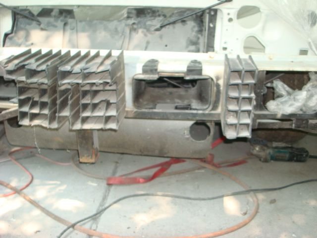

Also reinstalled the radiator support cross rods and plastic air ducting. All this stuff was cleaned up but got dusty.
Drivers window regulator riveted back in place.

Passenger regulator riveted back in.

Laying out the cross rods and radiator ducting.
Its dusty but I'll blow it off when I get my compressor fixed.

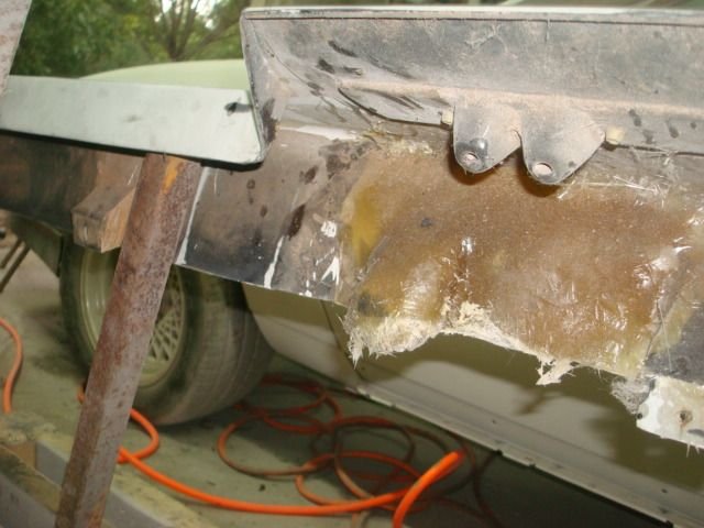

The worse damage on this car was the passenger side quarter panel. It looks like they got into another car racing side by side and that cars tire shoved the wheel opening back in and up a couple inches. This area is double panel so its harder to work.

This whole area was up and in by a good bit plus no wheel opening body line.
This is how far the wheel flare body line had moved up from the damage. It should be about 3/4 inch from the bottom.

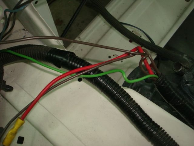

The original headlight/fog light harness that was in the car had been modified and had quite a few cut wires and missing plugs so after looking at the GM service manual I figured it was best just to mock it up in place and figure out what and why. The early pre-race pictures of this car show Hella fog lights in the place of the front park/turn lamps so since those werent used the plugs were cut off. The factory fog lights were removed but those wires are still there however looks like the relay wiring was bypassed.

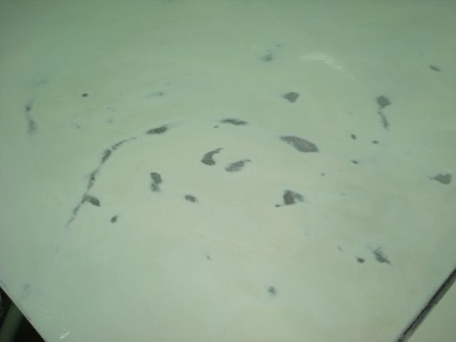

I started lightly blocking the first coats of epoxy today on the passenger side to start revealing my high and low spots. Will probably start the bondo work on it next week.

You can see the high and low spots coming out while blocking it.

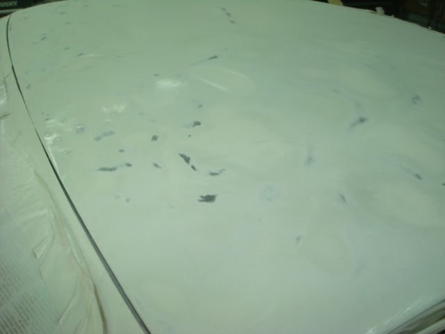

Did a little hand blocking on the driver door and fender today and then roughed in the passenger side door.

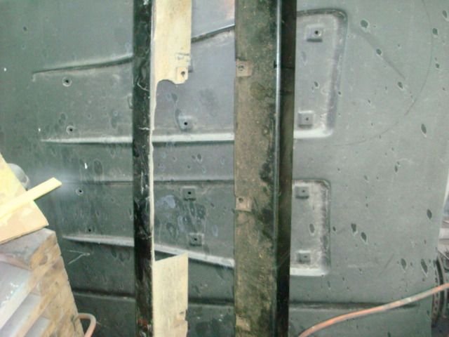

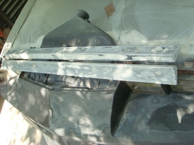

Started pulling needed parts off the parts car. Got the passenger ground effect, the entire nose and a few others parts off so far. Its nice to just walk out front and pull what I need vs having to find and wait for it.
Pulling the inner fenders off the parts car as both were broken on the MC car.
Passenger ground effect was missing on the MC car as it had a fender swapped and never put back together.
Driver side effect off the Morrison Cook car on the left. You can see where they had cut it out because of the jacking rail under the car.
I'll modify the replacement passenger side effect to match the driver side one.

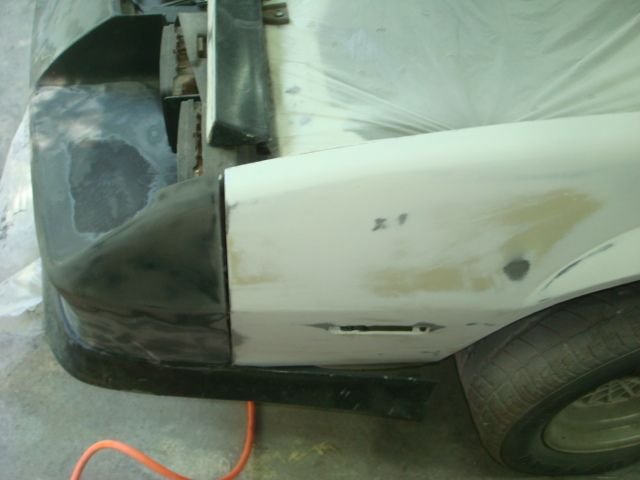

The nos replacement fender on the MC car only had a couple of bolts holding it on when I got it so started bolting it in place and found the bottom was setting in from the fender too much so had to twist and bend the bottom back half a good bit to get it to fit. The gap is wider at the top than the bottom [ on both sides] as the original first 2 cars had a "nose droop" built into them. Quite a few back in the day always wondered how these got through tech like that but its not really something you would expect.
Fender bottom in too far once bolted in place so it had to be bent to pull it out.
You can see it better in this pic.
After twisting and bending the lower rear half of the fender to be flush with the door.
Better pic.
Couple of special tools.

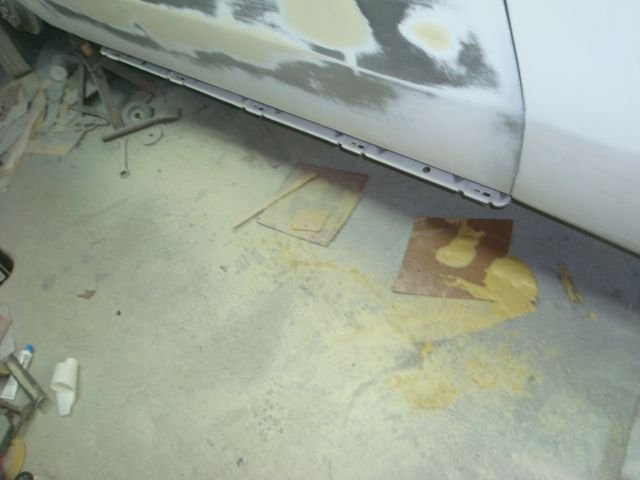

Started hand blocking the first layer of bondo and epoxy on the door and found a high area.
This area in tan was high but it blocked down.

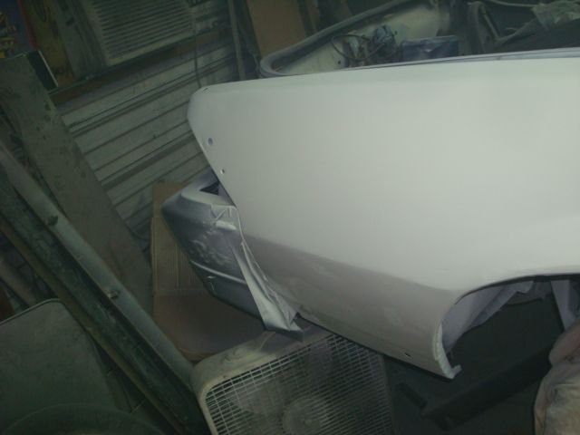

Caught up the last few days of work and pics. It was 102 here today with the heat index but got out in the shop and installed the front lower fender brace [had to bend the lower front of the fender too] and then got the first coat of bondo and epoxy on it.
Just checking the nose to fender fit before starting bondo work. It is not bolted on but rather just setting on the studs. Looks to fit pretty good already.
Setting the air filter box in to ck fit.
Driver side just setting on the studs also.
First round of bondo on the fender. This was an nos fender with no antenna hole but it was never primes so it surface rusted and had been dented prior. For the time I have in it would have been easier to use a diff one but keeping orig parts with the car
Sanding out the first bondo coat.
Still a little more needed but close.
Sealed back in with epoxy.
Much better door to fender fit horizontally.

Switched to a new spray gun and air regulator today plus running a secondary filter set up just when spraying but got the first coat of bondo on the driver quarter today, it roughed in and sealed back in with epoxy.
First coat of bondo on the rear of the driver quarter.
Roughed in with 40 and 80 on the board file.
Reply 0

A little more work on the passenger quarter.
Just a little more shaping and bondo work.
Sealed back in.
This is the untouched quarter on my 89 for comparison.

I lightly hand blocked the roof to reveal the high spots and then spent a little more time with a hammer and dolly on them to try and cut down on how much bondo is in the roof compared to before.
I ran out of bondo today but got started on the front portion of the roof.
Passenger front half of roof. All the bare metal spots are high spots and the shiny unsanded ones are low spots.
Closer look at passenger front corner.
Deepest gouges are in the front center.
Driver side.
First coat of bondo passenger side. It looks like a lot but its fairly thin.
First coat on driver front. I still have to do the mid section but waiting on bondo.
View from the front.
Started sanding out the passenger front corner but left it high until I get the other side rouged in and the mid section of the roof in bondo.
Reply 0

Waiting on bondo and epoxy so started sanding the bumper cover and ground effect parts. The original driver side lower ground effect that was still on the car looks to have came off a gold car at some point, was broken, then modified, repaired and then broken again [ from jacking the car during pit stops] and is nearly broken in half again so I pulled the other one off my parts car and will modify it.
Starting to sand the bumper cover. I'll eventually pull it back off and take it completely apart to refinish everything but figured its easier to do the bulk of the sanding in place.
Blocking out the bondo work on the fender from a couple weeks ago. Still needs more work.
Sanding through paint layers on the door ground effect you can see the factory white, then the silver that Morrison Cook painted it and then black from whoever was the last to race it.
Both door effects sanded and ready for epoxy.
Original driver ground effect that I pulled. You can see it was orig gold so it had to come off a different car.
Silver paint on the back side of the emblem glue tells me it was replaced while MC was racing it.
The Tuned Port decal below the emblem was painted over.
My sander had a pad failure.
Passenger side ground effect off the parts car sanded.
Ground effect on the left is the modified one that I pulled from the car and the one on the right is off my parts car.
Reply 0

Hand blocked the roof today to reveal the high and low spots. Worked a little more bondo in the low spots and a little more hammer and dolly work before sealing it back in with the epoxy. It looks to be real close now. Somebody had asked about being able to see all the sanding scratches but at this stage I'm more concerned with adhesion so the finest grit I'm using it 80. As it progresses it will get into finer grits once everything is roughed in pretty close.
Passenger side after blocking. Dark spots are high metal spots, the gold spots are where my bondo was still high and the shiny spots are low spots.
Driver side after hand blocking.
Driver side after more hammer and dolly work on the front corner and a little more bondo.
Passenger side with a little more bondo.
Passenger side after sealing it back in with the led shop lights off.
Driver side with the shop lights off.
Passenger side with the shop lights on.
Driver side with the shop lights on.
Front view.
Reply 0

Have been messing with the roof the last couple days and after fixing a couple more areas, another coat of epoxy and hand blocking it today with 80 grit followed by 180 its ready for high build but wont need much as I have it pretty level now.
Also stopped off and picked up another T5 to have for parts. Somebody was getting ready to put it behind an LS and done the non WC 10 spline Muncie input shaft conversion. ....except it turns out the trans is an 88 WC so that shaft isnt compatible without further changes. No biggie as I bought it for parts and pieces to have spares.
Tuesdays blocking revealed a few more spots, passenger side.
Driver side.
Tuesdays epoxy coat passenger side.
Driver side.
Last blocking before high build. Started with 80 and then went to 180.
Driver side.
Slowly getting there.

Started prepping today to do the final body work here and there before going to the next step which is the high build primer. I only had 1 bolt front and rear of each fender holding them in place so pulled the nose and both fenders today so I could install all the mounting clips that go under them. Some had been missing prior to the original disassembly so I pulled one of the fenders loose on the parts car to rob them.
Also pulled the old plastic off that had been covering the freshly painted engine bay and replaced it with fresh plastic after blowing out any dust that was under it.
Plastic off and getting ready to put plastic back on from the top of the windshield to the bumper cover to keep overspray off the engine bay.
Pulling the fender off the parts car to get factory hardware.
Fenders and bumper cover taken loose.
Driver side fender mounting clips installed.
Passenger side fender mounting clips installed.
Passenger fender back on.
Driver fender back on.
Fresh plastic back in place.
I just tightened 1 bolt front and back on each side for now until I put the hood back on and can line it all up.
Reply 0

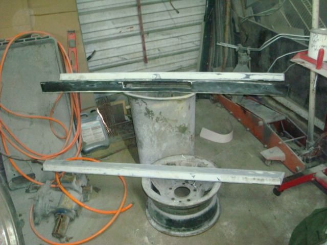

Blocked the first epoxy coat on the rear hatch and then started prepping the fiberglass ground effect to start repairing them. Waiting on supplies but my compressor quit again this evening so pulled the motor back off and dropped it at a friends for them to look at. Think it blew another capacitor but not sure.
Hand blocking the first epoxy coat on the hatch. One more spray and block and it will be done. It has a dent under the spoiler that wont be seen so I am leaving that as part of the cars history.
Ground effects ready to start making fiberglass repairs on them.
Rear spoiler sanded but I have to make repairs on one of the quarter pieces.

Started making fiberglass repairs to the lower ground effects. I've never worked with fiberglass before other than sanding it but it seems pretty straightforward. Started with smaller patches and kept going larger with each layer.
This is after about 7 layers of resin and strand. I taped the bottom so I had a surface to start building layers on.
This is what the strand looks like.
Clamping it to a 4x4 so it doesnt twist or warp as it cures.
Pulled the tape off and you can see the filled in area. I'll put a couple more layers on this side and then trim the edge.

Sep 24, 2023 | 12:16 AM
  #96
Re: Morrison Cook #98 SCCA Escort World Champion 88 Iroc
Spraying epoxy today with the new gun and larger 1.7 tip and its going to be a little learning curve for me. I've still haven't gotten a reply from SPI on this latest gallon of epoxy so went to the larger tip to see if it helped any.
First 2 coats of epoxy on the ground effects and rear spoiler.
Lower ground effects sealed in.
Center rear spoiler and door ground effects sealed in.
I'll sand these next and then do any of the bondo work over the epoxy.
I still need the cut the bottoms to match the one pulled off the car for the jacking bars under the car.
Passenger one on top that had the big area missing.

The pedals were missing when I bought the car but the hanger was still bolted in. I removed it when I pulled the brake booster, steering column, etc to paint the firewall so a friend brought me a set of pedals yesterday so I loosely installed them in the original hanger.
Went ahead and hand blocked the first 2 coats of epoxy on the ground effects and rear spoiler so ready to do a little body work on them next as needed.
Pedals loosely back in the hanger.
Hand blocked the fiberglass parts.
Driver side was a little wavier than the passenger side.
Rear spoiler pieces blocked. Need to finish the repair on the 1 corner piece.
I'll put 2 more coats of the white epoxy on after repairs and then put them back on the car.
