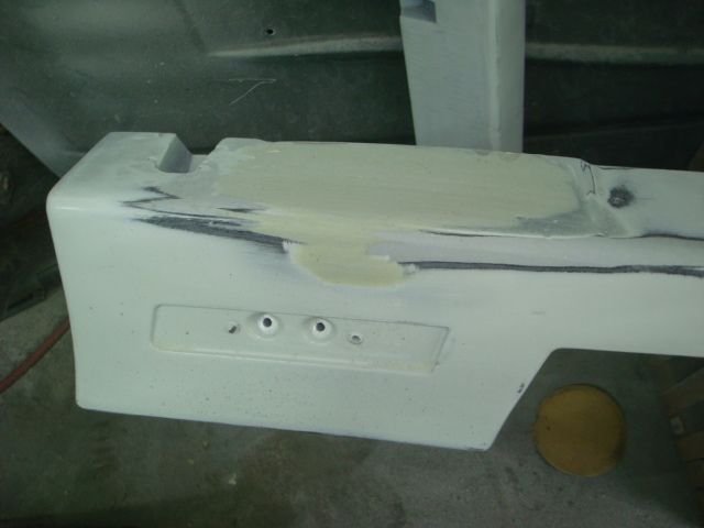

Short afternoon in the shop as I had to go pick up some Corvair parts, lol and stopped back by my buddies place that runs some of the Cannonball stuff.
I did get tiger hair wiped over some of the repaired areas in the fiberglass parts, that sanded back down and a couple spots wiped back with a thin coat of bondo. Nearly all those surfaces face the pavement so they'll never be seen but just wanted to smooth them up a little.
Tiger hair over the repaired fiberglass patch on the front of the driver side ground effect.
Tiger hair over the spoiler corner repair.
Small spot on the back of the driver side.
Tiger hair over the patch on the front of the passenger side ground effect.
Driver front tiger hair sanded down.
Passenger front tiger hair sanded.
Spoiler corner kitty hair sanded.
Light wipe of bondo on the passenger front.
Bondo on the spoiler corner.

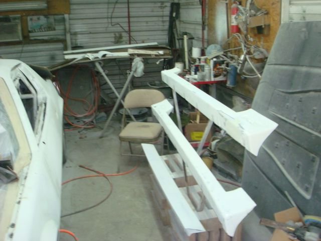

Sanded the couple bondo spots and then started to get the rear quarter ground effect pieces sanded so I could spray them and made another interesting discovery. Both look to have been replaced at one time with one of them originally being off a red car. The other is cracked nearly in half horizontally [ from the side that had the damaged quarter] so going to pull one off the parts car. Got the other ground effects and rear spoiler sealed in with 2 more coats of epoxy. I'll hand block them next and then put them back on the car. Going to paint them on the car as it would have been done while the car was being raced.

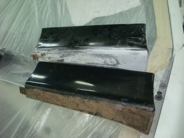

Driver rear quarter ground effect. Looks to be red/maroon under the white.
Passenger side, its split in half almost. I think its a replacement though as it had writing on the back side.
Not sure what this was for.
Bondo on spoiler corner sanded out.
Bondo on passenger ground effect sanded out.

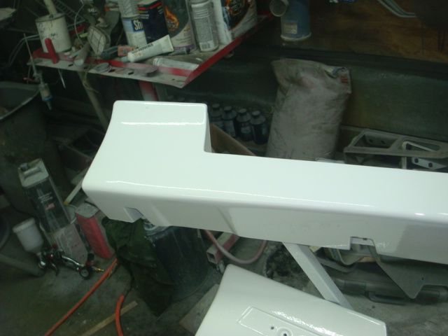

Staged and ready for 2 more coats of epoxy.
Ground effects and center spoiler.
Spoiler corners and door ground effects.

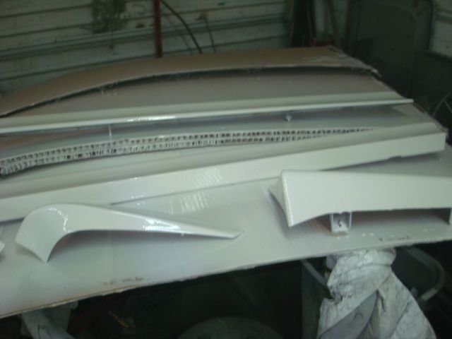

Flipped the rear spoiler pieces over today and just lightly dusted the undersides of them to get rid of the black. Sprayed 2 more coats on the rear hatch and then just set the side ground effects back in place on the car but not bolted up yet. Was also able to pull the passenger side rear quarter ground effect off the parts car.
Light coat of epoxy on the undersides of the rear spoiler pieces.
2 more coats on the hatch. I think after I sand them it wont need anymore.

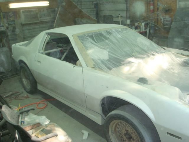

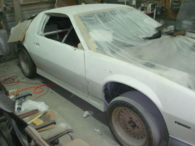

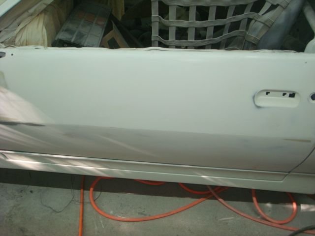

Re: Morrison Cook #98 SCCA Escort World Champion 88 Iroc
Sealed the driver side back in from wheel well to wheel well today along with the passenger rear lower ground effect. Loaded up 1 of the 2 short blocks for it and headed to my engine guy in the morning with it.
Pretty sure this is the last coat of epoxy on it wheel well to wheel well before high build. Still have to do some bondo work on the front of the fender though.
Door to fender sealed in.
Door to quarter sealed in.
Keep in mind this is just the first stages of primer.
Happy with how the door came out given all the damage.
Sealed in the passenger rear lower ground effect.

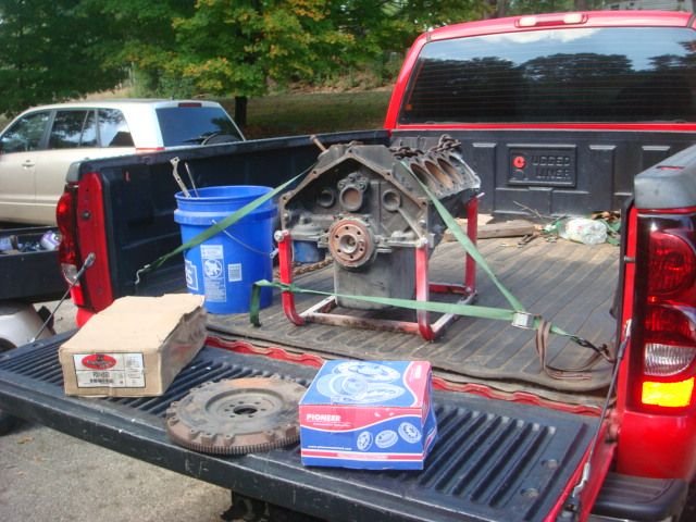

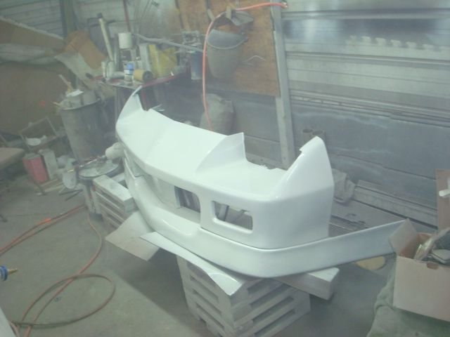

The brand new short block that we are robbing the crank and rods from to build the 302 inch engine.

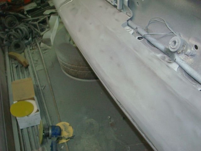

Started getting the hood ready for epoxy today and only got the underside sanding as it all had to be done by hand.
Lots of nooks and crannies to hand sand.
May possibly be the original hood based on no paint where the hinges were?
Sanded and ready to spray epoxy on the underside.

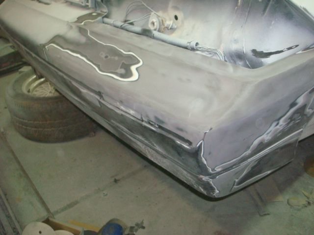

Had a whole bunch of stuff going on today but did manage to sneak down to the shop this morning and spray the underside of the hood with gray epoxy. I went with gray because the rest of the engine bay was sealed in gray after I stripped it to bare metal and then sprayed the white base over that.

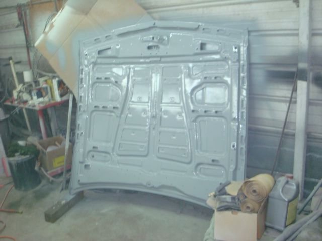

Sanded the hood this morning and sealed it in epoxy. It was white under the black so is either the original hood or was replaced while Morrison Cook was racing it.
Also started stripping the hood hinges and hood latch support.
Sanded the hood to get it ready to seal in epoxy. I didnt see the need to take it to bare metal given how it sanded.
First 2 coats of epoxy.
Stripping the hood hinges and latch support.

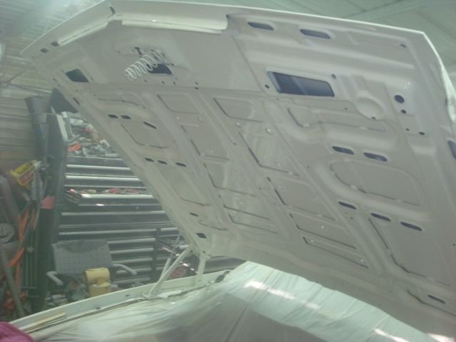

Bolted the hood hinges on today and then set the hood in place and started lining up the front end.
Hinges rougly back in place.
When you have no help you figure out how to get things done. Blankets and cardboard around the opening and then cat walk the hood onto the car.
Setting atop the hinges at a 90 degree angle.
Using a rod to support the front to start lining up the holes for the hinge bolts. It becomes a balancing act at the point.
Bolted to the hinges.
Not too bad of a fit for the first time.
This gap is slightly narrow, I'll move the fender out just a minute amount.
This one is slightly wide but partly because the top edge of the fender bows out in the center. I'll work on it some.
Center lines all line up good.
Nose piece is not bolted on so it will come up and in a little when it gets bolted up.
Little by little. Looks like it may be a few days before my next window temp wise to spray epoxy.

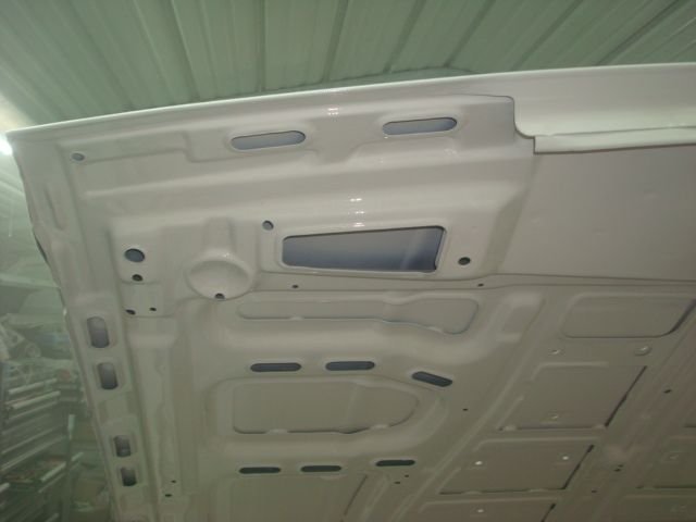

Painted the bottom side of the hood and the hinges today but wont known until tomorrow if I royally screwed it up or if its ok. I had what I thought was reducer but turned out to be a second hardener that I have no idea where it came from so the mix ratios are off.
On top of that I had both the base and the clear sprayed under the bottom side of the hood before remembering I needed to do the hood latch support bracket and the safety catch. Luckily I had poured my extra base and clear back into their mixing cups so it just took a little more time to get it all painted.
First coat of PPG base.
Second coat of base.
After 3 coats of base and 2 coats of matte clear.
We'll see how it cures out if it does. I'll be replacing the hood struts so didnt bother masking them.
Driver top.
Passenger top.
Passenger bottom.
Driver bottom.
Hood latch support and safety catch.

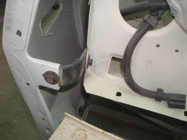

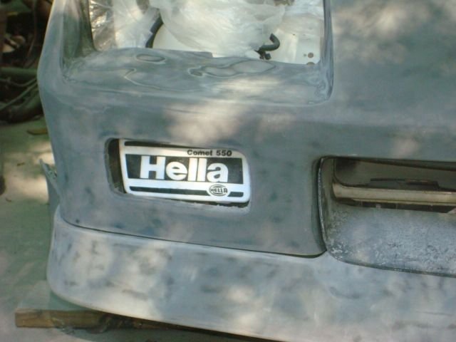

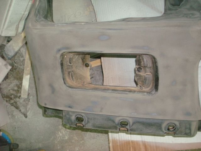

Worked on the fenders to hood gaps today and ended up having to bend both fenders to get the gaps I was looking for. The passenger side was the worse as it moved away in the center but started out probably a quarter of an inch higher that the top of the hood in the center with the front and backs being level. Where the fender bolts to the unibody structure and it comes up it should be at a 90 degree angle however it was about 135 degree so it pulled the center top of the fender out and away from the hood edge. I grabbed the wheel opening at the front and back and then pulled up and out while rolling the top of the fender edge towards the hood edge. This closed the gap so it was parallel and also dropped that same edge down so its level with the hood. Kinda hard to explain but it worked.
On the driver side I had to do the opposite pulling the fender down and out to open the gap as needed.
After that went back to stripping the front bumper cover. Its been painted several times and had lots of paint cracks and chipping so taking it down to its original factory base paint. Once I have most of it done will pull it off the car and take it all apart to finish. Prob going to use the lower spoiler that is on the bumper cover originally on the car but have to repair it. I also still need to modify the parking light holes for the Hella fog lights like Morrison Cook had done originally.
3 more hours today on stripping the paint on the bumper cover.
I wont be using the lower spoiler as the one on the other cover is better but also needs repair.
The mess in the floor is all from todays sanding so you can see how much paint I took off.

A little more slight tweaking on the fender to hood gaps.
Gaps are much closer to being the same now. Keep in mind the bumper cover is just setting in place,
Driver side gap now.
Passenger side gap now.

Sanded some more on the bumper cover and then pulled it off and took it apart. Cut the parking light brackets out like Morrison Cook originally did so they could run the Hella driving lights in that place.
Bumper cover back off.
Taking it apart to finish sanding and make modifications/repairs.
More sanding.
Passenger side park lamp pocket before cutting.
Driver side before cutting.
Passenger side cut out.
This is what I removed.
Driver side cut out.
Driver side material removed.
Sitting back on the car so I can fab the brackets for the Hella lights.
The light brackets mount off the bumper reinforcement. The hole is there but the lights were gone as later 88 they went to a brake cooling duct.
Lower spoiler that was orig on the car. I'm going to repair and reuse it.

Took about 3 hours today to strip the lower spoiler. It had the factory white, then the silver that Morrison Cook painted it, primer, another layer of white and then another layer of silver and then primer by whoever raced it next followed by yellow, then primer and then purple.
I bolted it back to the stripped bumper cover off the parts car so it has more rigidity when I attempt to repair it. Dug the Hella lights out and made a quick set of brackets to mount them but looks like I need to make them 1 inch longer. Set the bumper cover back on just to see where they set.
The last pic is from the SCCA archives and is the earliest known race picture of my car early 88 showing the lights.
Lower spoiler had to be stripped all the way to the urethane, not sure just yet if it can be repaired.
Spoiler bolted back onto the bumper cover.
Fabbing up brackets to mount the Hella lights.
Loosely setting the bumper cover on to see where the lights sit in the cut outs.
First brackets were 3 inch center to center mounted in the original holes that Morrison Cook had drilled in the bumper reinforcement. Looks like they need to come out another inch.
I wasnt worried about lining them up, just checking distance and location.
Very early pic of my car showing the lights. Later pics show them taped over.

Spayed the first 3 coats of epoxy on the bumper cover and lower spoiler today to start the process as it will prob get 6 to 8 total. I've got a urethane welder and urethane rods on the way to repair the lower spoiler. While it looks good in the pics it has several cracks underneath that will only get worse if not fixed plus the bottom center area is rubbed through.
Installed the mid fender to radiator support brackets and shot a quick coat of white on them even though they wont be seen.
First coat of epoxy primer.
Second coat.
Third coat.
Third coat, the spoiler looks decent but the cracks are on the bottom side where it rolls under and will be mostly repaired from the back side.

Picked up another engine yesterday from a friend just to rob a few parts off of and then dug my 5.7 short block out and dropped it off at my engine builders today.
This had been in a 88 Camaro but just got it for a few bolt on pieces I needed for my TPI engine build.
5.7 short block from an Iroc, will only be using the block for the 302 build. Also a set of TRW forged 11 to 1 pistons for it, flywheel and balancer.

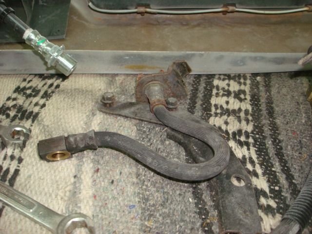

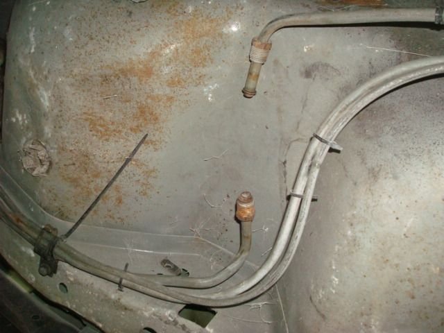

Back to the saga on the brake and fuel lines. Originally the return and vent lines had some sort of internal blockages that even brake clean and compressor air would not clear out so I pulled them all off and bought new reproduction lines. Well, once on the car the reproduction lines were awful and had major differences over the originals so I pulled them off and set them aside.
I could pull the lines off the parts car but thats a fair amount of work and then disables the car from running so today I took a metal coat hanger, a can of PB Blaster and a can of carb cleaner along with the compressor and started working the blockages out. Was finally successful in getting them opened up so then took a little sandpaper and scotchbrite and did a light cleaning on the exterior of them
Was getting late so just set them under the car and will start hanging them tomorrow. Also brought a table over from my lower shop and turned the front bumper cover upside down on it so I can start repairing the cracks in the lower spoiler.
Both sets of fuel lines on my bench outside the shop.
Working on getting the blockages out.
A little cleanup on the lines.
Blanket down so I dont scratch the new paint. Will hang the rear first loosely and then bolt the front clamps in place.
Bumper cover upside down on the bench to start repairs.
Old Oct 20, 2023 | 03:02 AM

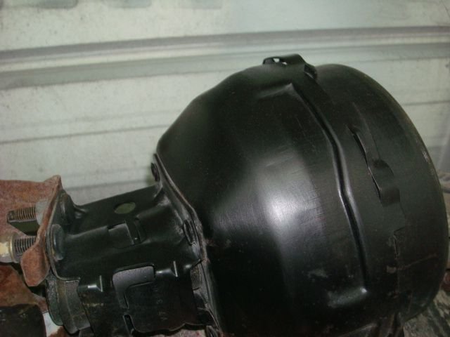

I pulled the rear brake parts back off today as well as the brakes off my spare rear end and started sorting that stuff out today. I had bought a used set of PBR calipers off here but the guy neglected to tell me that 1 was 3rd Gen and the other was 4th Gen. Luckily the spare rear had the correct ones on it.
Also tested another black spray paint today in trying to match up the factory sheen used on some of the under hood parts and this one looks pretty close.
Taking parts off one of my spare 9 bolts. This one had the PBR's on it from the factory.
Couldnt get the ratchet and socket in to pull the pin so got creative.
4th Gen caliper on the top that I was sent as a 3rd Gen. Yeah they will swap but not correct for this car.
Getting the pin loose on the other caliper.
Pulling the other pin.
R and L calipers off the spare rear.
Test spray on a small spot on the booster.

Hit a snag on the new rear brake lines vs what was on the spare rear so have to get the correct stuff located and on the way.
New lines on top and old ones bottom.
Wrong new hose top.
Centers look pretty close.
Def not even close on this side.

Did not get a lot done on it today as I had to make a road trip to pick up a TPiS Mini Ram. I would love to use it on the 302 we are building to go back in the car however it would not look correct so will hang onto it to use later.
Started stripping the rear bumper cover but ran into so many different layers of paint that the 180 grit just wasnt getting it done. Have some 80 on the way and will use it to cut through the first few layers. It does still have its original rear bumper cover as the vin sticker matches.
My fb marketplace score for the week.
This end has damage from the same wreck that messed up the quarter so will be repairing it.
Lots of layers of paint.
As many times as it had been repainted was surprised to see it still had an emblem.

Luckily when I took them off the first time I had put wire ties around the 3 of them in the area of where the clamps had been so I had a rough idea where they went.
Such a great idea, I wish I had thought of that when I replaced the fuel and brake lines

I didnt plan it that way at the time but it ended up working out. It was just easy to do as I was right there pulling the bolts for the clamps.

Ran and picked up some fresh epoxy today and then back on stripping the rear bumper cover.
Had to go to 80 grit to get through most of the paint layer and then will finish it with 180.
Not a lot of space between it and the wall but will make due.
All that dust on the floor is from today.
