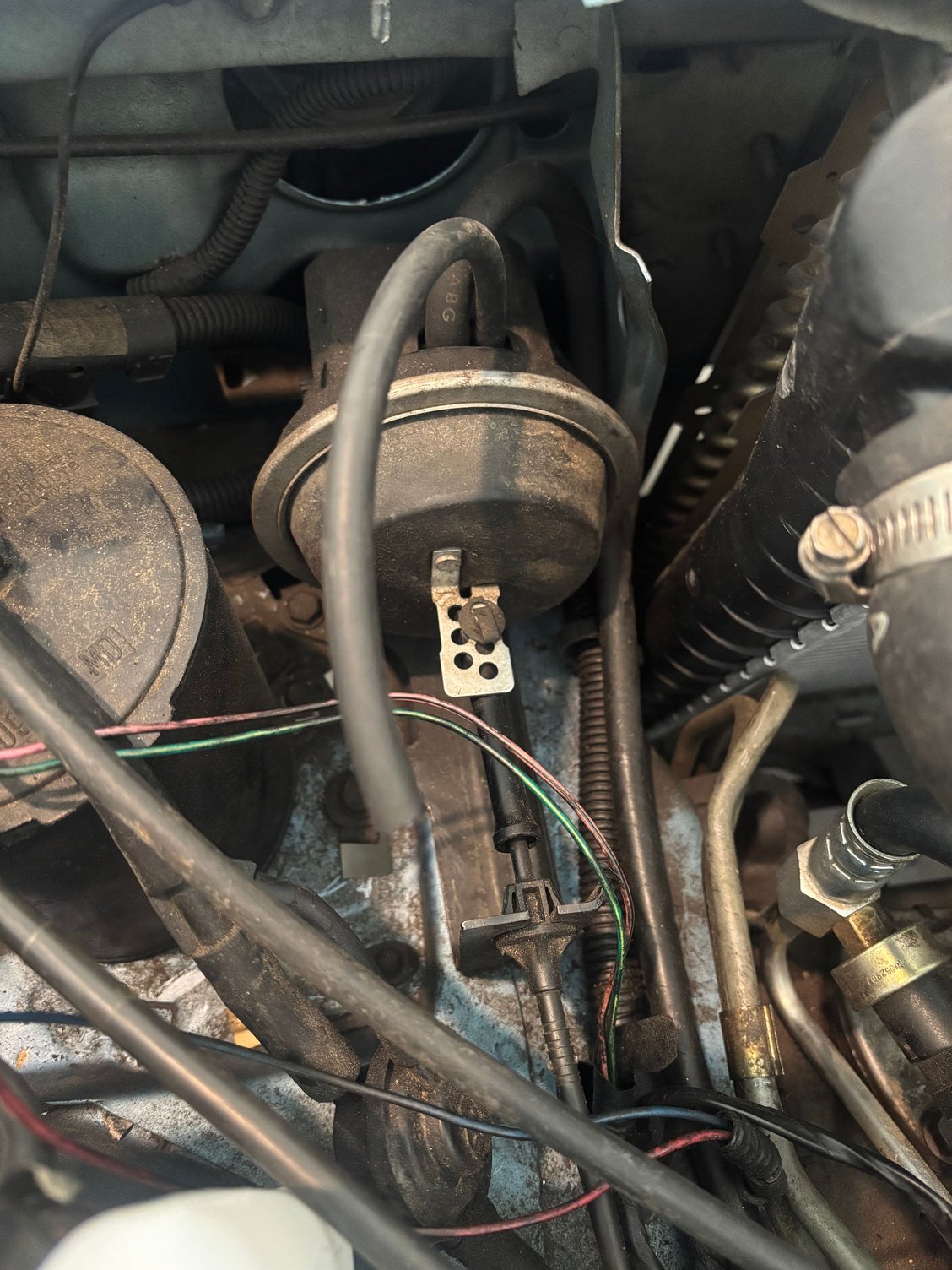

Does anyone knows where this hose goes?

Manifold?

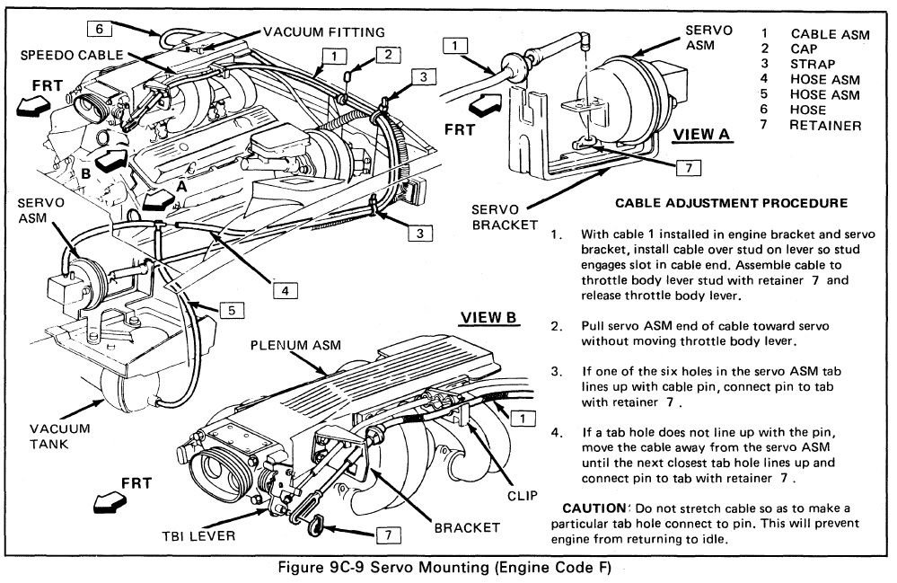

one line runs to the firewall and into the cabin the other one goes to the vacuum ball under the battery tray

Likely someone disconnected it by removing the
Likely someone disconnected it by removing the "T" from the vacuum line it connects. Good opportunity to check the vacuum tank to ensure it holds vacuum.
