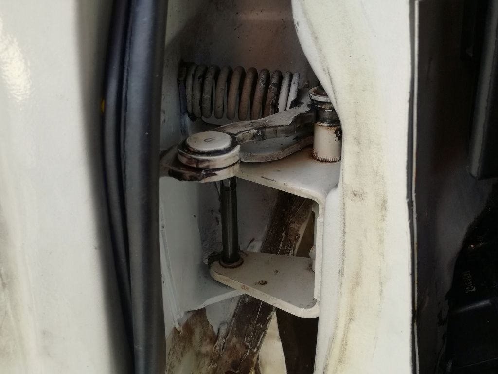

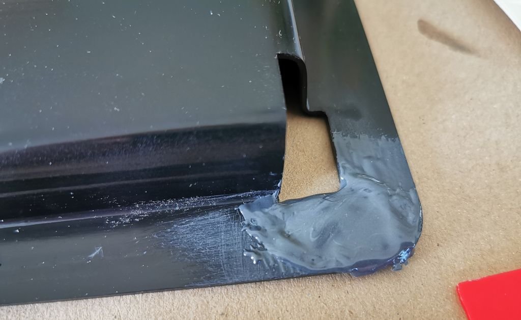

Our summer temps have been wild this year, but they're winding down now. I installed them on Sunday when it was approximately 30°C/86°F.
We're now heading back down to 23°C/73°F.
I'll update when I feel the doors have become easier to shut again.

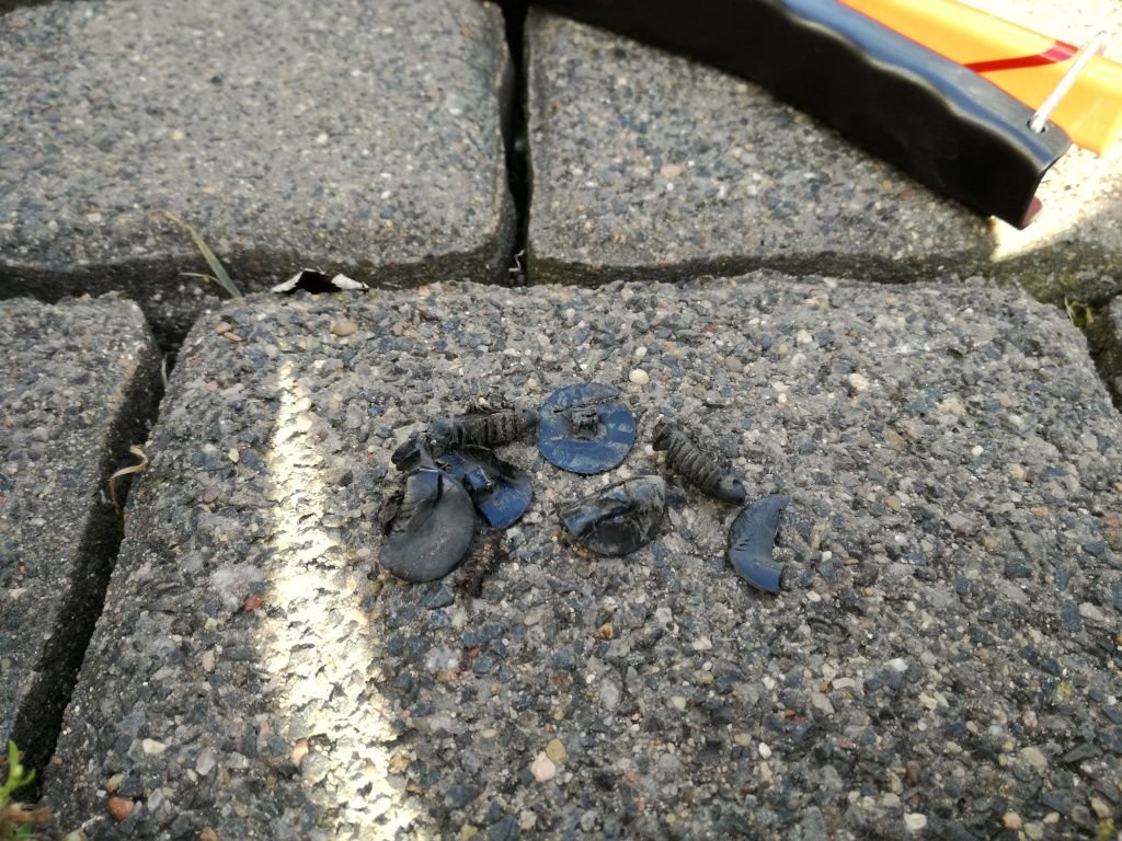

The final puzzle pieces have arrived.
No change in door slamming conditions yet.

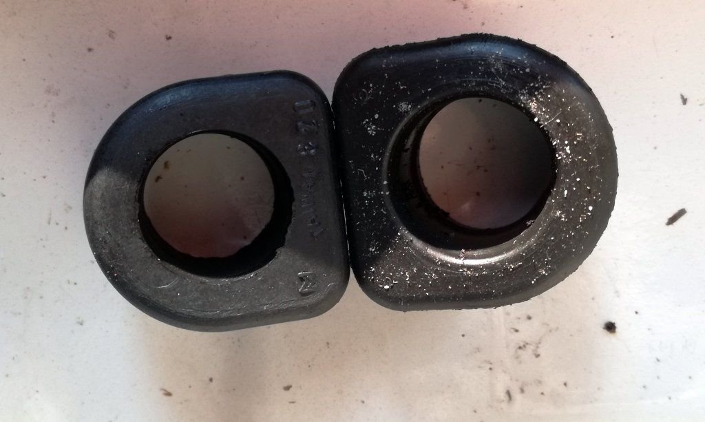

Hey dudes!
Can anyone post a pic of how their passenger side crankcase vent hose is routed?
Mine popped out of the valve cover grommet, so I bought a replacement grommet, which turns out to be ever so slightly tighter than the old one, so the hose fitting sits snugly once more.
Yet I feel the hose itself is under some pressure from the heater control valve, adding to the issue of popping out the fitting.
Don't worry about the particles on the old grommet. My engine compartment isn't that dirty, lol. I just threw the grommet on the floor before thinking about doing a comparison shot.
My door seals seem to have reached a certain level of regularity after two and a half weeks, by the way. Maybe even a little sooner.
What remains is the effect of a slightly saggy driver's door, but the passenger side closes up nicely again.

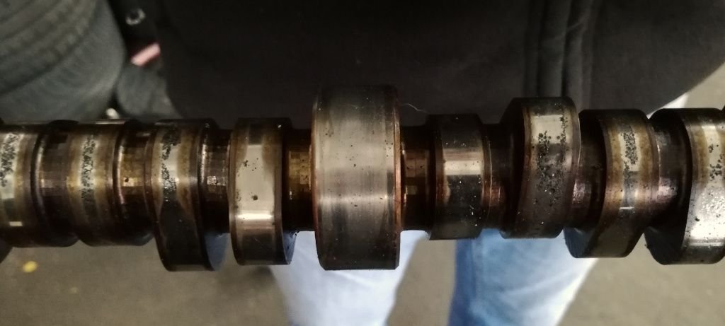

I had the shop remove the engine and overhaul most of it.

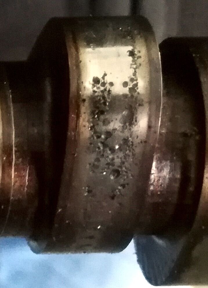

The head gaskets and the oil pan had been leaking, plus one of the freeze plugs had to be replaced in the past. It just was time for this engine to be reworked.
Also, my cam had seen better days. I still don't know what happened to it, though.
If you look very closely, you can almost see the lunar lander near one of the craters!
Thankfully the crank was in much better shape.
I was surprised that the freeze plugs were in fact just covered with dirt and already brass plugs. I thought they were all close to dying on me, after that first one cracked open.
Still got them replaced. You can't get to them all while the engine is in the car.
So yeah, it got the whole shebang: timing gears and chain, balancer, plugs, freeze plugs, gaskets, shaft seals...

Wow, those cam lobes are a mess. That's a hydraulic roller cam, right?

Yes, Dave. Those are hydros, so this shouldn't have happened. I mean... if there were dirt in the oil, ok, but why should there be and why would it only cause damage up there and nowhere else?
Well, I'm not engine building expert. But no, that shouldn't happen. Was this an aftermarket cam?
I had a carrier bearing fail years ago. Kept the old one...it's on the radio in the shop. Failed due to spalling, and that due to an excessive load is my guess. Looks a lot like that. I know the cam isn't a bearing, but it has a similar surface appearance.
Bearing Failure: Causes and Cures

I'd think it was the stock cam. It looked exactly like the replacement and I didn't go for a performance cam.
Would be surprised if the previous owner had swapped it out for an aftermarket cam.
That's a great document you shared there. The part about contamination comes very close to how the lobes looked, just less serious.
Excessive load seems to be concentrated around certain areas of the bearing, but all my lobes were damaged over their entire surface.
Both is possible, though. I used to have failing injectors and a lot of heat for a while. Perhaps someone used some kind of additive in the oil... we'll never know :/

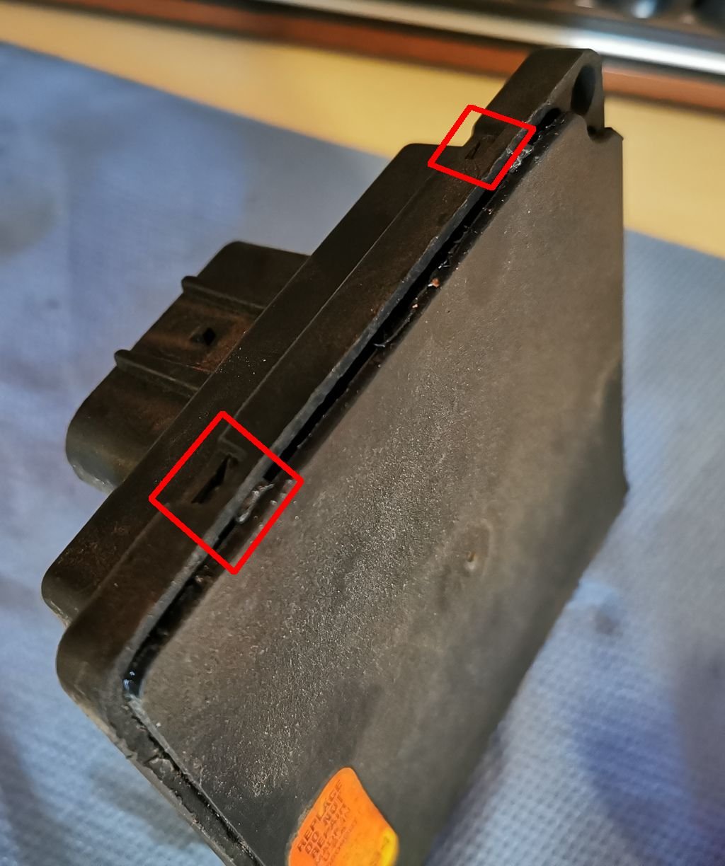

Today my distributor would not stop screeching, so I went ahead and replaced it.
The old unit would not turn as freely as the replacement once it was out and my weird drivetrain issues plus that occasional whirring sound seem to be gone now, too.
I'll have to keep an eye out for that on my next cruise, though.

Odd failure, but glad you caught it before it left you stranded, or did other damage.

So am I. That bearing in there does not seem to be very tough.

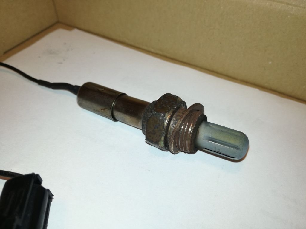

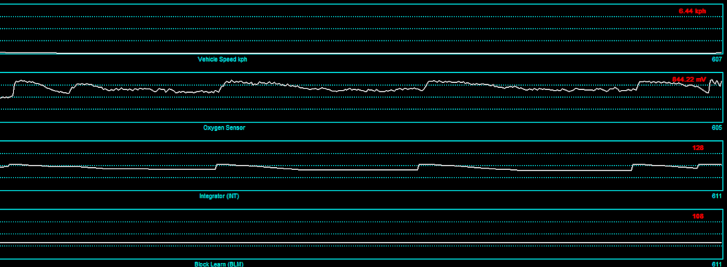

Do you know these creepy issues you can never quite pinpoint the cause of?
Let's look at how to get down to the cause and not just throw new parts at the car.
My car still had that chugging issue in low load cruises and sudden drops in power while accelerating, so I hooked up my computer to the ALDL port and did some test driving.
Additionally I studied my FSM once more, which taught me that my MAP sensor, MAT sensor, fuel pressure and TPS were ok and that the ECM uses those values to choose BLMs and INTs and checks AFRs using the oxygen sensor.
What I found suspicious was how TunerPro displayed my O2 sensor's readings and how the INTs repeatedly kept going down and back up after roughly 10 seconds at idle.
The BLMs and INTs should both be at 128, ideally. If the values are less, the ECM thinks the air/fuel ratio (AFR) is too rich, (less oxygen in the exhaust stream) and tries to compensate by reducing the injector pulse width, so they inject less fuel, thus leaning out the mixture.
This could also mean leaking injectors, but mine are BOSCH pink tops I had gotten replaced in 2012, so they should not be so far gone yet.
Higher BLMs and INTs suggest a leaner mixture, btw, so the ECM would compensate by adding fuel.
Now why didn't I dig into the injectors?
Well, the O2 sensor crosses between low and high voltages quickly, I think between 100 mV and 800 mv? The graph shows that my O2 was sticking somewhere in the higher voltages.
And that is exactly why the ECM thought I had a rich mixture. A higher Voltage means less O2 in the exhaust stream.

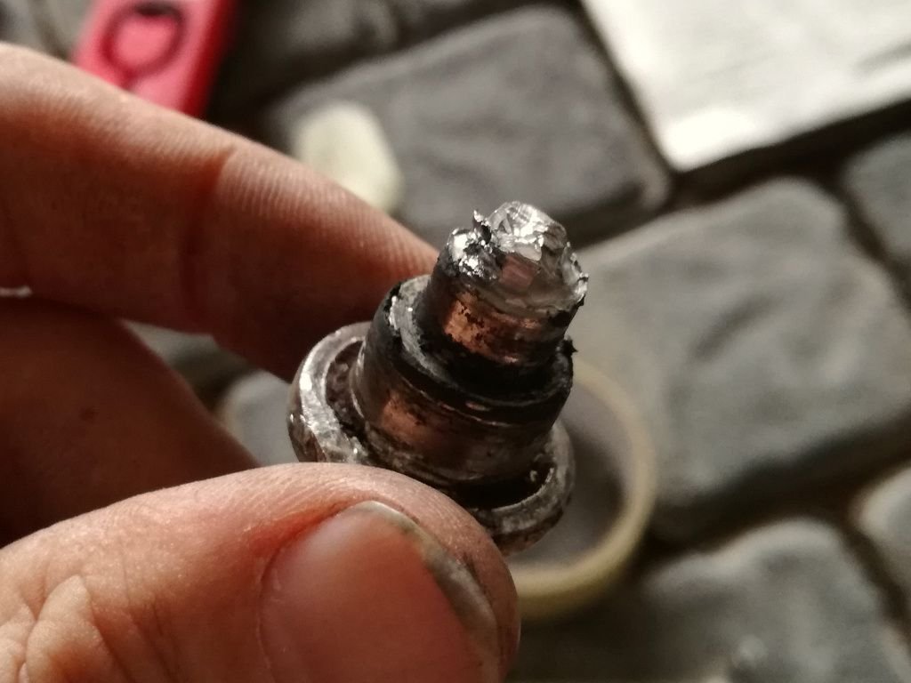

I got a replacement O2 sensor and had a hell of a time getting the old one out of my exhaust manifold. No space to work with all that emissions stuff, the steering column and the brake system around there.
This is how it looked.
See that duckegg blueish color at the tip?
My FSM diagnosis chart said something about dustlike deposits coloring the O2 sensor gray if you use a wrong type of silicone/RTV on gaskets.
I don't know about that, but I recently had my engine overhauled, including the valve stem seals. They were leaking oil into the cylinders and that would of course deposit itself on the O2 sensor.

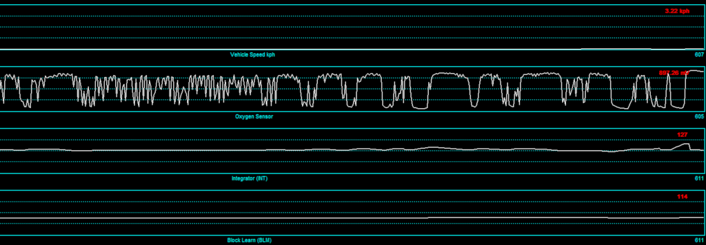

This is how my graph looks now.
See how the O2 sensor alternates through the entire band as it's supposed to?
My BLMs and INTs are not perfect, but far better than before and the repeated resetting of the values at idle is gone, too.
So far I have not witnessed the power loss and chugging again, but I will keep my eye on it.
FYI: The ECM should use a reference pulse of 450 mV while the O2 sensor is still cold, disconnected or the engine isn't running.
Mine is somewhere aroung 560 mV and I don't know why. Always has been.
That could also cause the ECM to think something's too rich, but I have to investigate that separately.

Here's another job I just can't recommend doing AT ALL!
I was putting it off so badly that I polished the oil dipstick instead.
Well, it was all grimy in a few spots, so why not?
Nice, huh?
This one's just for fun, because it looks like something you could use as a stock photo for something.
But to get back to topic:

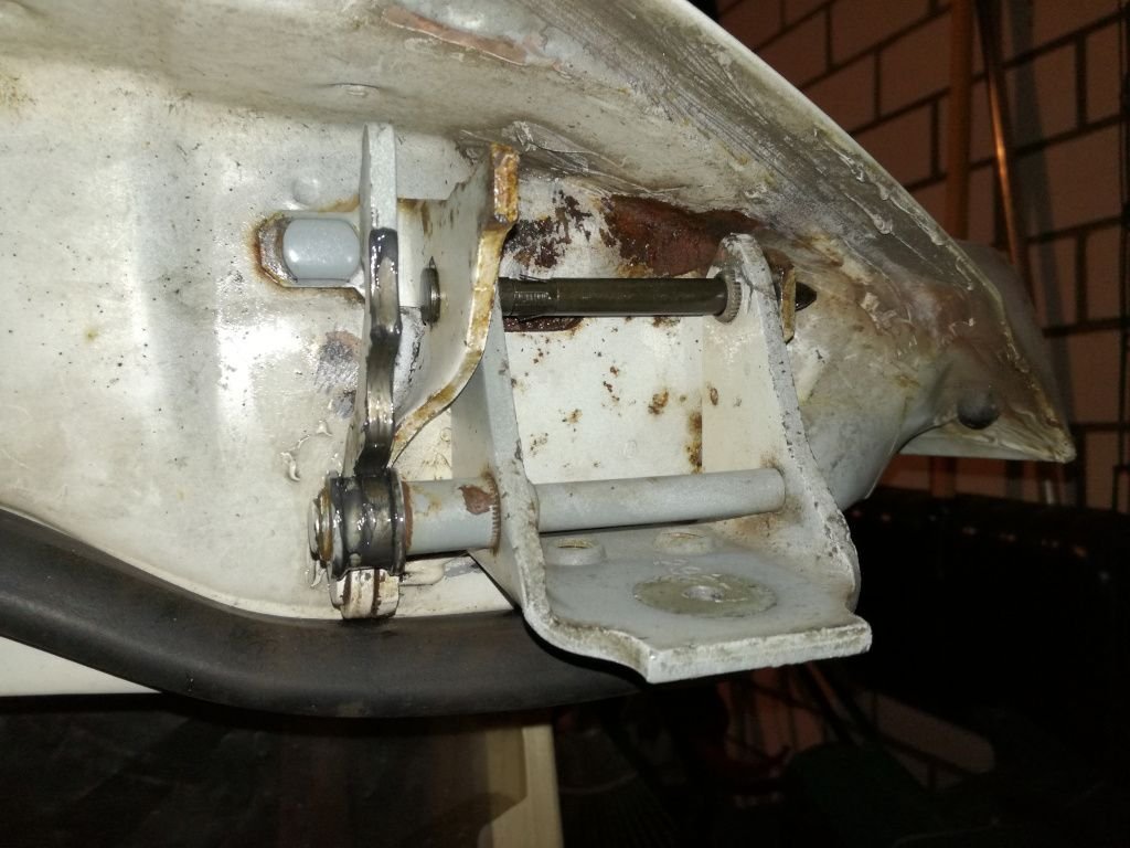

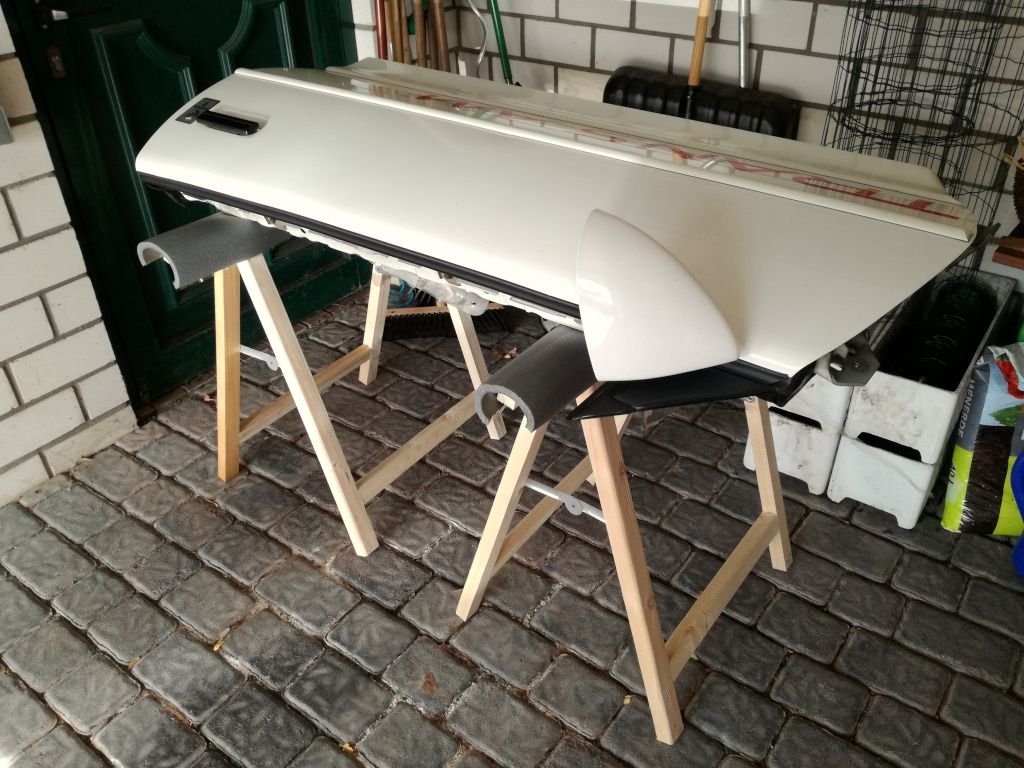

My lower driver's side door hinge was troubling me, as the bushings had clearly failed and I didn't want to put it off for too long, in fear of damaging the holes on the door side hinge... which is welded to the door.
I had a Dorman hinge pin and bushing kit lying around for a couple of years now.
A few pieces of advice before we get started:
- This is a two-people job. I'm sure you can manage it alone, given the right equipment, but I would not recommend it
- The FSM says to compress the door spring, remove the lower pin and unbolt the upper hinge. Hell nah! You can't get the spring out and how on earth are you going to get that pin out of that tight spot?
- Turn the front wheels to the right as far as they go, loosen the rear half of the fender liner and get your arm and a 13mm wrench into that space, so you can remove the front lower hinge bolt
Right, let's begin.
You'll quickly notice there's no simple all-in-one connector for the door electronics ANYWHERE.
Nope. You seriously have to remove the door panels and disconnect the power lock motor, window motor and power mirror and pull the wires through the hole towards the body.
That is, in itself, not a big problem.
It is a hassle, though, because you have to remove the protective foil from the door, at least in certain areas, and the adhesive won't hold again.

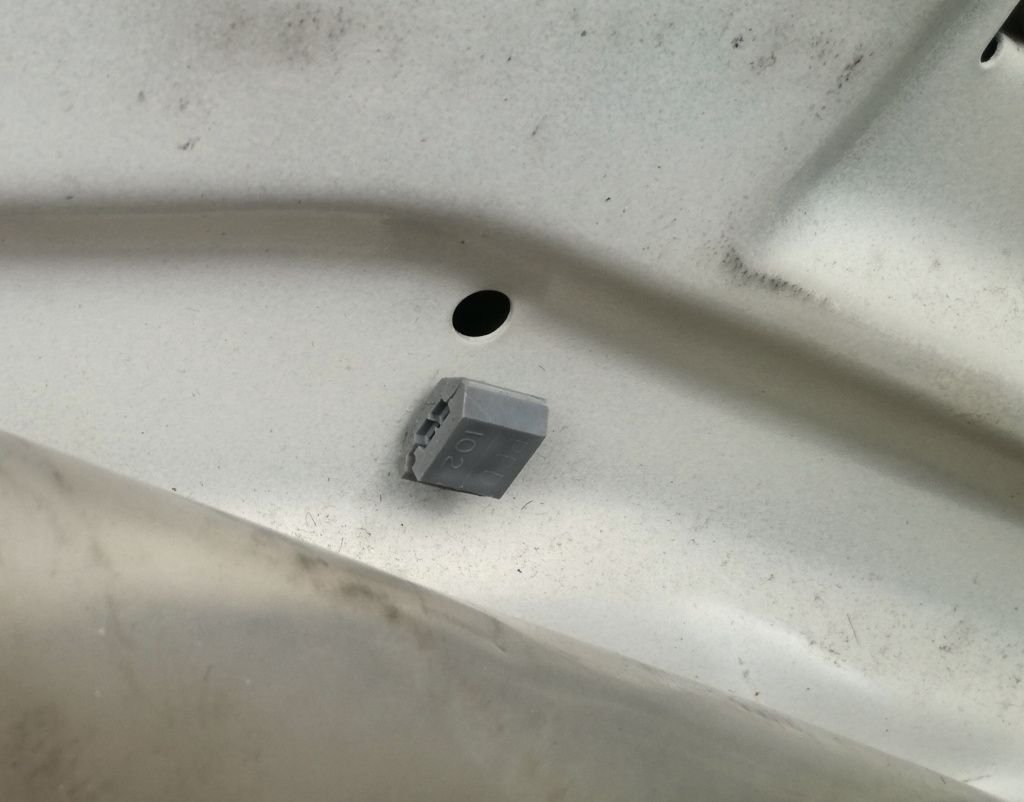

See this little fella? There's one sitting behing the metal sheet your armrest is screwed onto. Have fun opening it up and getting it back together in the end
Even more fun are those grey connectors with the staple through them. You can pry two of them out, but on the inside of the door, toward the front, there is a bump with another one and you can't rip it out.
There's no outside access to it! WHO THOUGHT OF THAT? I tore a long piece of plastic out of the wiring's isolation, which held it in place and I didn't replace it either.
Also, you may want to unscrew this switch so your interior lights don't kill your battery over the weekend. It closes to ground, so keep it from touching the body, like this.
Once you unbolt 4 13mm screws from outside the body and two 15s from the inside, you can pull the door away from the body and move those cables out of it.
These doors are heavy. I recall something around 70 pounds? I had trouble lifting it up far enough to get it onto my benches.
Next thing is the spring. You'll need a spring compressor and it will have to go between the spring coils as far apart as possible. Squeeze it, pull it, put it aside and don't remove it from the tool.
This was the end of day 1 for me. To get the fender liner out, I had to kill the pins holding it to the fender. 29 years and those suckers were still doing their job unwaveringly!
I had to break the heads off and push the remains into the fender to get them out. I still had some replacements from my Firebird left over, so I could put those to use in the end.
And since there's a mouse that keeps returning to the garage and lives inside my car jack and keeps crapping all over the floor, I decided to close the car up for the night.
Old Aug 15, 2019 | 04:29 PM
  #324
NCC-2569's Avatar
Joined: Mar 2011
Posts: 547
Likes: 27
From: Germany
Car: 1990 Trans Am
Axle/Gears: Stock
Re: NCC-2569's 1990 Trans Am (pic-heavy)
Day 2. You can remove the pin from the lower hinge by squeezing the two prongs together and pushing it out toward the top. Take the body-side hinge, push out the old bushings using a vise and replace them.
Then simply reattach. Do something against any rust spots you may encounter.
Give the moving parts some grease, reattach the spring and this hinge is done.
Oh, another piece of advice:
That single hole for the 13mm bolt? Some tutorials advise to drill it to a larger size and I totally get it now.
For the assembly at the factory this was probably a nice feature. Attach the door to the body using this one as sort of a guide pin, then tighten the rest of the bolts and all would align up nicely.
After so many years and sagging doors this tiny hole diminishes all possibility of adjusting that door. And it's a hell of a job trying to get it to align with the hole on the body.
So if you have alignment issues, enlarge this hole and spare yourself some suffering.
The other two holes have oval counterparts and allow for adjustment.
Now this is the part where it gets interesting as these two studs were flattened under pressure, so there's no easy way to remove them.
I tried a file. No chance, takes forever.
I then tried a drill with different sizes. You can't get it to line up straight, so you'll drill at an angle and get nowhere.
Finally, I got a cutting disc for a Dremel and that's what helped me achieve my goal.
Still was a PITA, because I could only remove tiny parts from the squished stud and it took me forever.
Go for the small end, btw. Not the large end.
This is what it looked like after I had removed enough material and punched the sucker out.
Punch the bushings out any way that works and carefully hammer the new ones in. Small steps, no big hits. They go in quite easily.
The new studs have threads and are secured in place with self-locking nuts.
You may experience something cracking sound, because there are teeth on the studs which will find their way into the hinge eventually and it pops into place while tightening the nuts up.
So, this is how it'll look in the end. Lower hinge...
...upper hinge.
My door works nicely again.
Oh, and when you go on to reattach the door, attach the frontmost 13mm bolts first!
You'll still be able to access the upper one without trouble and it's hard to align the holes for the lower one once the others keep the lower hinge from moving around.
Alright folks, this is all for now.
Good fight, good night!
Be safe!

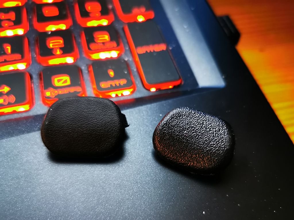

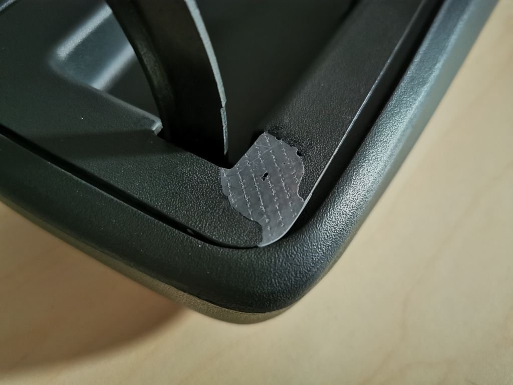

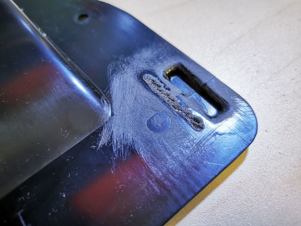

I've been wondering why the plug on my passenger side cupholder always looked so weird.
Turns out they are marked L and R and there was an upside down L plug in there, so I went looking online for an R plug.
I found a fairly cheap set of reproduction plugs from Hawk's on eBay and they looked ok in the pictures, so I ordered a set.
Here they are. Replacement L on the left, original L on the right.
Shape and fitment are perfect, but the texture is just too flat on the replacement, so it does stick out of the cupholder a bit too much for my taste.

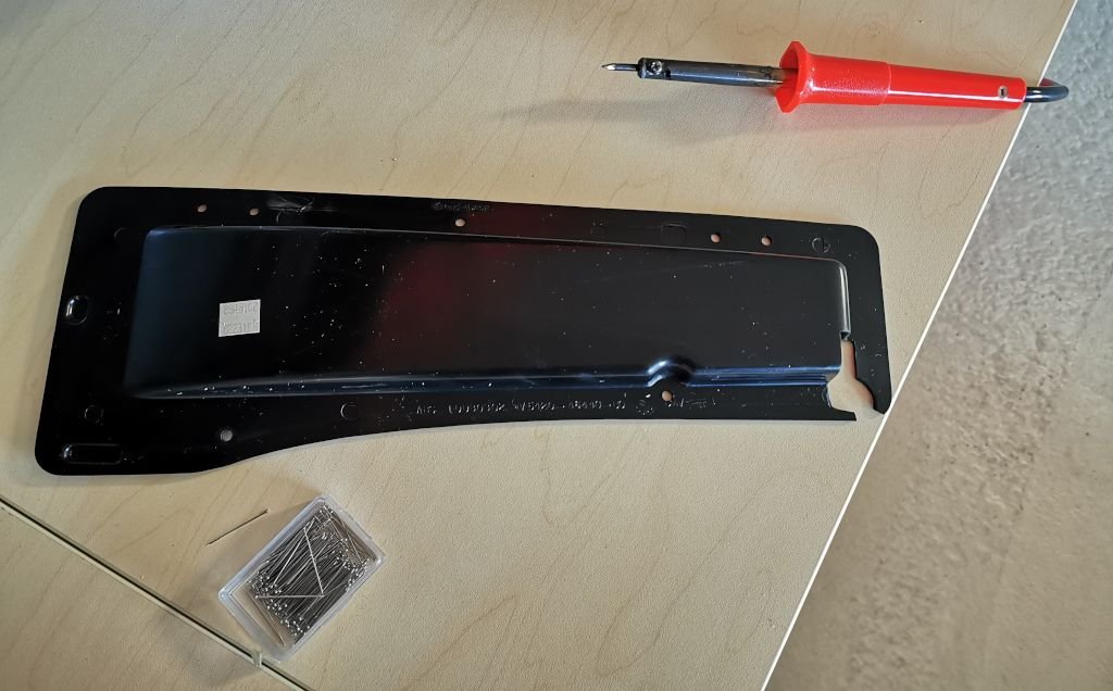

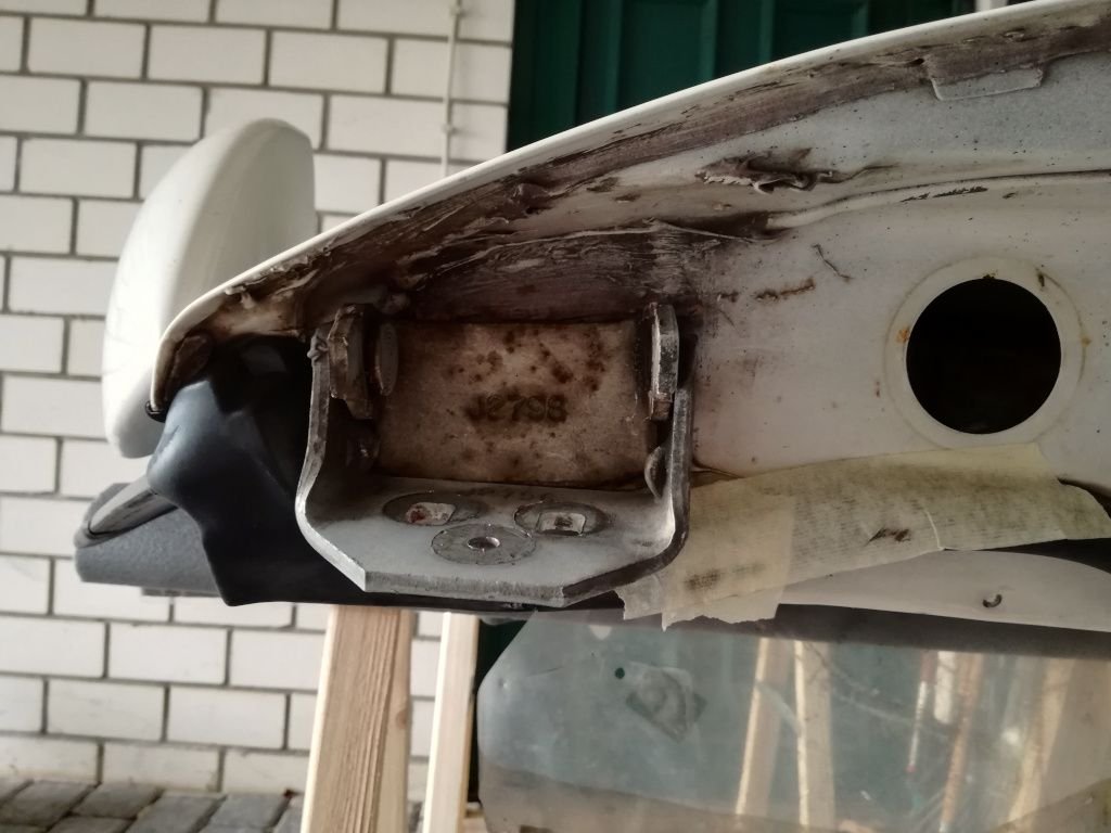

The rubber drip guard on my passenger side's t-top finally got on my nerves enough for me to seek out a replacement.
It kept getting snagged between the window and the seal up front which eventually led to its untimely demise.
Well, the main reason for getting my rear end up to fix this was always having to wait for the wife to get out of the car and then having to roll the window up and down so the window closes up properly.
I found the rubber edges for somewhere between $60 and $80 on the net at a couple of the known parts stores' sites, but they would either not ship internationally or ask $100+ just for shipping, which is one of the reasons for not doing this earlier.
Luckily, I found a local parts dealer who had two sets left! Best day EVER! 130 bucks, but still better than a 160-180 plus customs and taxes.
So, I read up on how to approach this and there are several steps to do.
1. Find a soft surface, because there will be plenty of movement that can scratch the glass.
2. Remove the torx screw (the others are phillips head screws) from the handle and the handle itself.
3. Remove 3 screws from the bezel and the bezel.
4. Remove 2 screws holding the rubber seal that meets the door window's edge.
5. GM sure loved their weatherstrip adhesive back in the days.
As I would be reusing the seal, I had to fight that gunk with a flat screwdriver from the outside in.
You'll need to pry around the ends of the seal and behind it across the entire length.
Using an upholstery/door panel removal tool or a screwdriver the edges of the seal can be carefully pried over the channels that hold it in place. Kind of like the t-top seals around the roof openings.
The seal can then be easily taken out of the channel/rail.
6. Remove 4 more screws and then the rail itself, which btw is padded with foam tape on the backside.
7. Remove drip guard. This gives us the picture below.
8. Clean all that gunk out of the rail and, most importantly, clean up all those longish dark spots where the new drip guard's adhesive will stick to.
I used a WD-40 equivalent for the main stuff, silicone remover for whatever remained and then Isopropyl to get remaining types of grease/fat etc. off of there.
9. The new drip guard will have spaces for the screws that will most likely not match perfectly, which is not a problem for those selftapping screws, though.

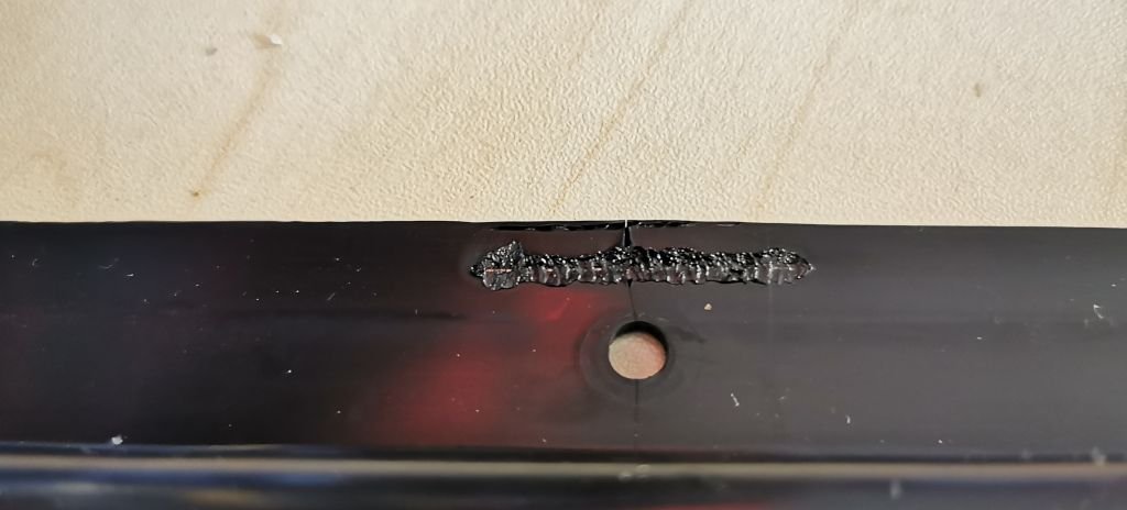

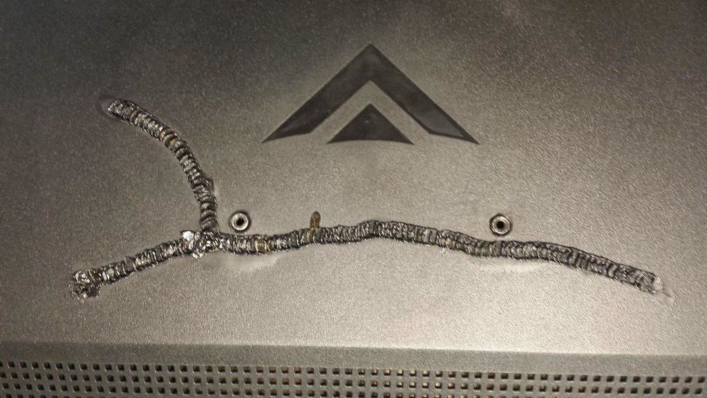

Here's a quick update about a job done quick and rather dirty... kind of the damage control type of work.
The plastic part of the lid on my center console has cracked and broken up over the years and instead of replacing it, I wanted to try fixing it up a little.
There was a crack around one of the screw openings and the front raised stopper. The rear stopper had disintegrated years ago.
Apparently there are some plastic welding or plastic repair kits available, which should be great for this type of repair work, but I couldn't source one in Germany, so I just got out an old soldering iron with an even older tip and a couple of pins.
Those repair kits usually contain a soldering iron with a triangle shaped end and a couple of S-shaped wires to melt into the plastic to bridge any cracks and solidify the part in those places.
Pins can be shaped, too, if necessary, and if you cut off the head, it won't stick out, especially if part thickness is an issue.
The soldering iron will heat up the pin and it will sink into the material, after which you can smear surrounding material over it, which would look far better with one of those kits.
I wanted to reinforce the area with JB Weld, so I scuffed the area up with 80 grit sanding paper, so it will have a better hold than on a smooth surface.
The really tricky part was the missing corner, though. I bent a couple of pins into L-shapes and melted them into place, because JB Weld would have a hard time bridging such a large gap.
Metal mesh would have been preferable.
I put duct tape of the visible side of the part to get an even surface and keep the epoxy from dripping off.
Sanding the rough edges with 400 grit paper gave me some decent edges. The pattern comes from the duct tape.
Paint would be great to cover up the spot and proper texturing even more so, but for now I'll be observing how the fix holds up over time and use, maybe then going back in and finishing the job.
Not great, but better than before.
Next up will be the replacement of my rear wing, which has corroded beyond repair. More info on that around the beginning of next month.

Finally got my car back after a week. The old Aerowing disaster ist finally gone.
Here's a look at how bad it was. The edges were already disintegrating.
And this is now.
Of course it had to start raining after a couple of dry sunny days.
They were able to use my original third brake light as it seemed to be identical to the one that came with the new wing.
Yes, there were indeed some that came with an indentation for this light.
One more thing to cross off my todo list

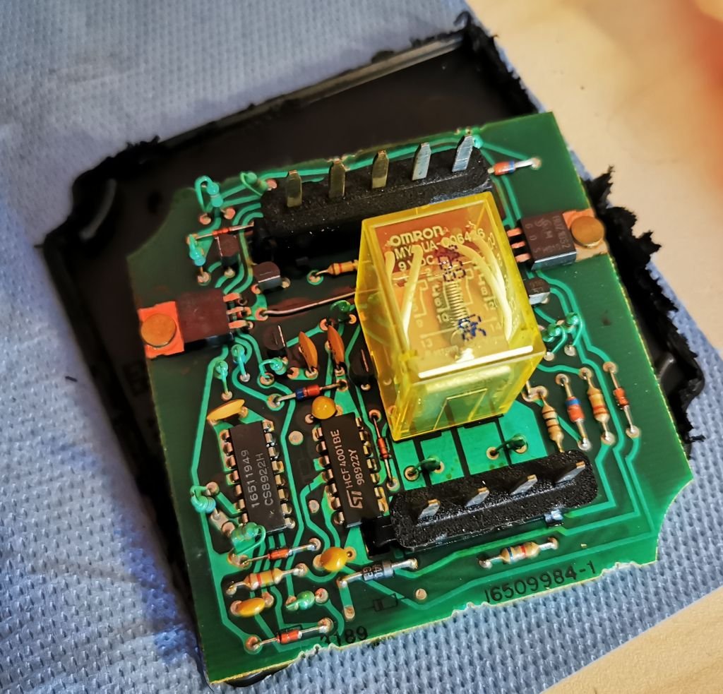

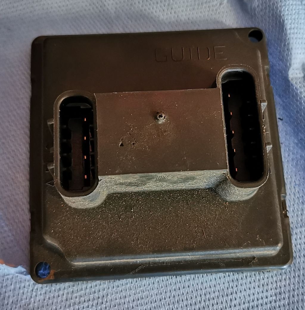

Every once in a while some things do go smoothly and a 5 minute job is just a 5 minute job.
I gave the car a good cleaning after it has sat too long without one, and as I got around to detailing the headlights, one of the doors just wouldn't open.
A while ago this already happened once on a warm evening out, but later that night both doors would open normally, so I knew I would have to tackle the GUIDE-box at some point.
Why the box and not the headlight motor? Well, I fixed those up in the past and if it hat been the motor, it would have kept running, because it could not reach its end-position for it to stop.
Back then I only found one video clip on YouTube about this and a bunch of guys simply resoldered every single contact within the box, which made it work properly again, so that was my general plan for this case.
Yesterday I found a new video:
This one focused on the solder joints for the plug-terminals and I saw the same crack in the solder on one of the pins of my 5-pin terminal.
The other 8 joints looked ok, but I gave the rest some new solder anyway, and that did the trick for my headlights.
So, this is the box you'll be looking for:
Pull the connector plugs off, then slide the module out towards the right. You can also move the module around a bit to help with removing the 4-pin plug.
Pry open the 4 little tabs around the box:
Don't be too shy with these tabs. They're not as brittle or inflexible as they usually are on other devices.
Then put on some Judas Priest - "Breaking the law" and proceed by using a flathead screwdriver to pry off the backside cover of the module.
There is some type of rubbery sealant around the opening, probably some sort of body caulk, judging by how sticky it is. You can either remove it or reuse it. There should be enough to give the module a proper seal again in the end.
Beware that there may be some caulk on the circuit board. If you want or need to remove it be veeery careful, as the protective sheet of the circuit board will rip off easily.
I have marked the solder joints of those connector pins that are most likely to be the cause of the issue.
My advice is to clean up the joints with some rubbing alcohol and a toothbrush before attempting anything with a soldering iron, because any residue or protective coatings will cause issues with heat transmission and new solder.
After that just use a soldering iron with a small tip, heat up and reflow that old solder and/or remove it using whatever means you have to do so. Then add some new solder to reinforce the joint permanently.
Here's the other side of the board with its electronic components. A rather simple design with sturdy components which were all in working order.
Please keep in mind that if you want to test this board without putting it back in the case, that connecting the 5-pin plug will add power to the board, even with the light switch off.
You'll hear that Omron-thingy clicking when the connection is made, so take care not to bridge any contacts with your fingers while you're testing your work.
Finally, just put the board back in the box, press the cover back on so the 4 tabs click into place, push around the edges for a good seal and slide the module back in place, connect the plugs and be done.
And then ENJOY the next time you flip your lightswitch into the ON position and you see both headlight doors open perfectly
PS:
Seriously, the longest part about this was getting the soldering iron up to temps. It's been a while since anything went as planned as this operation.
