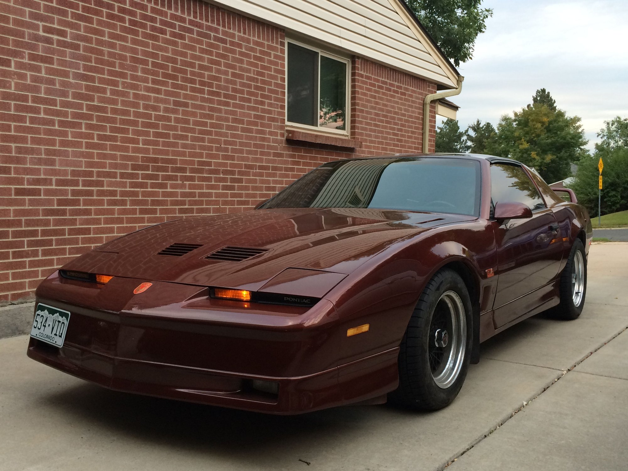

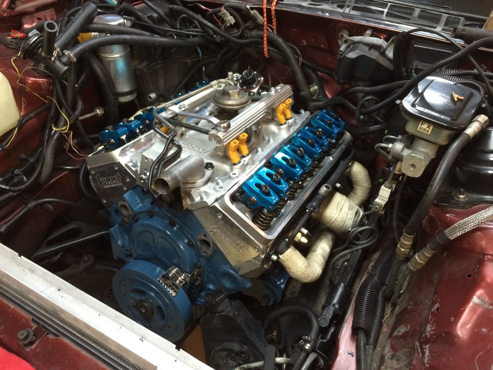

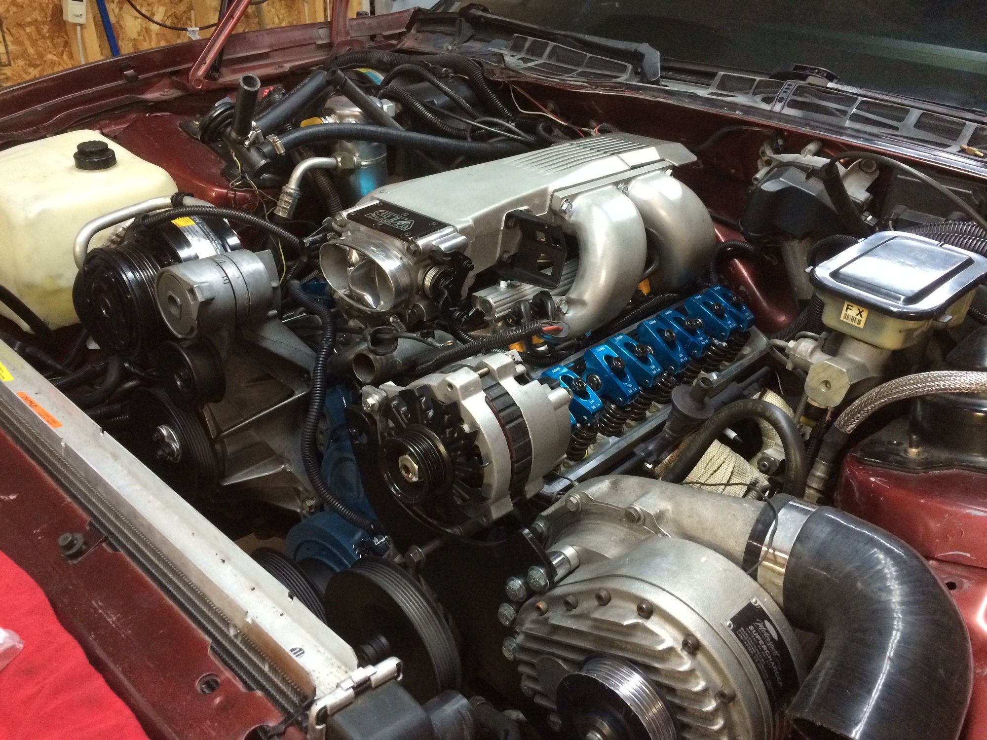

Before pulling the engine
Last shot of the engine together....little did i know how bad the PO hacked this thing together.

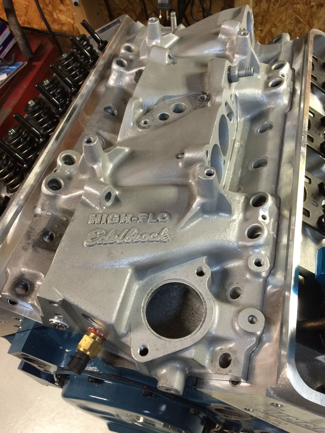

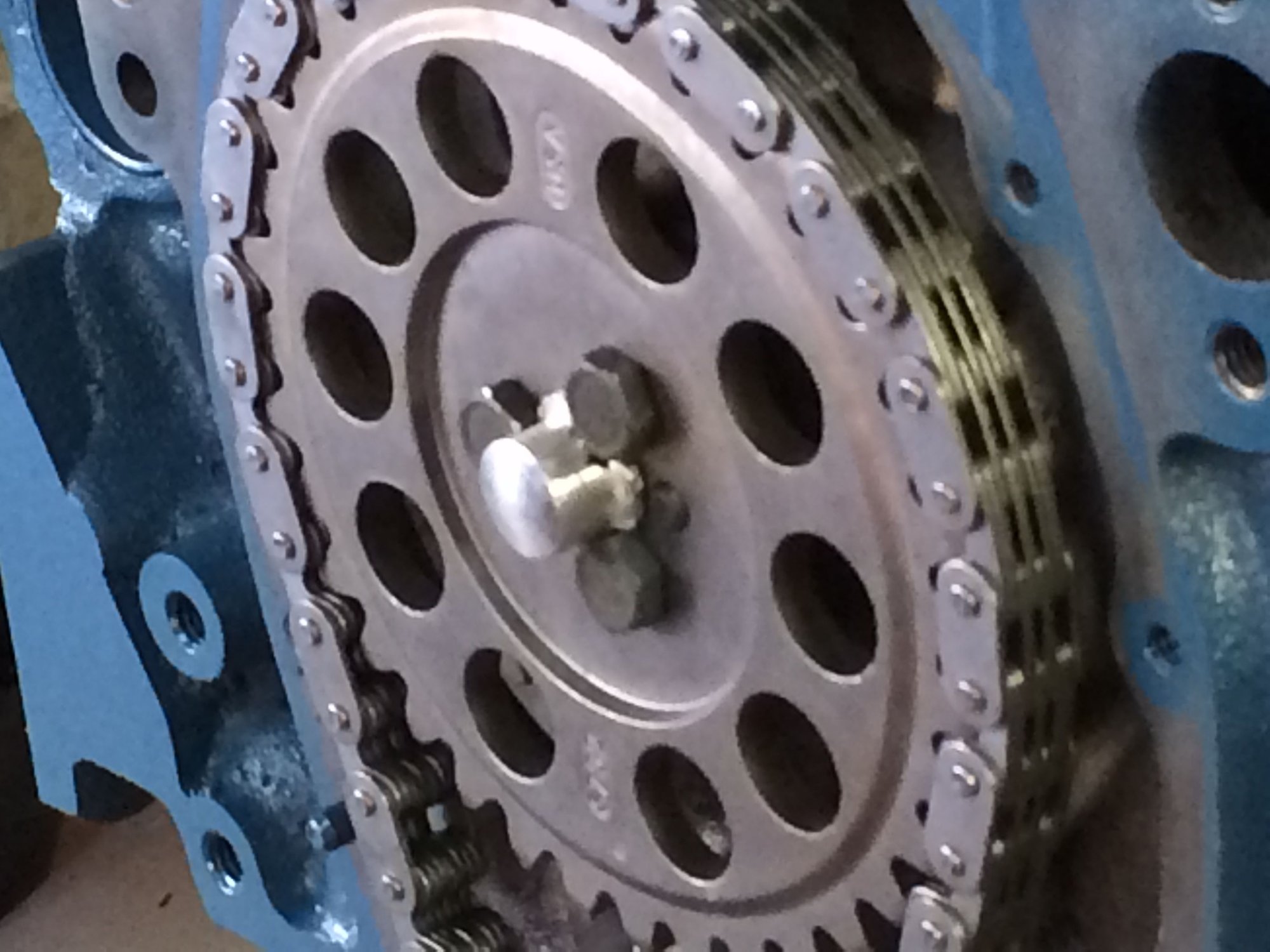

Retrofitted the roller cam

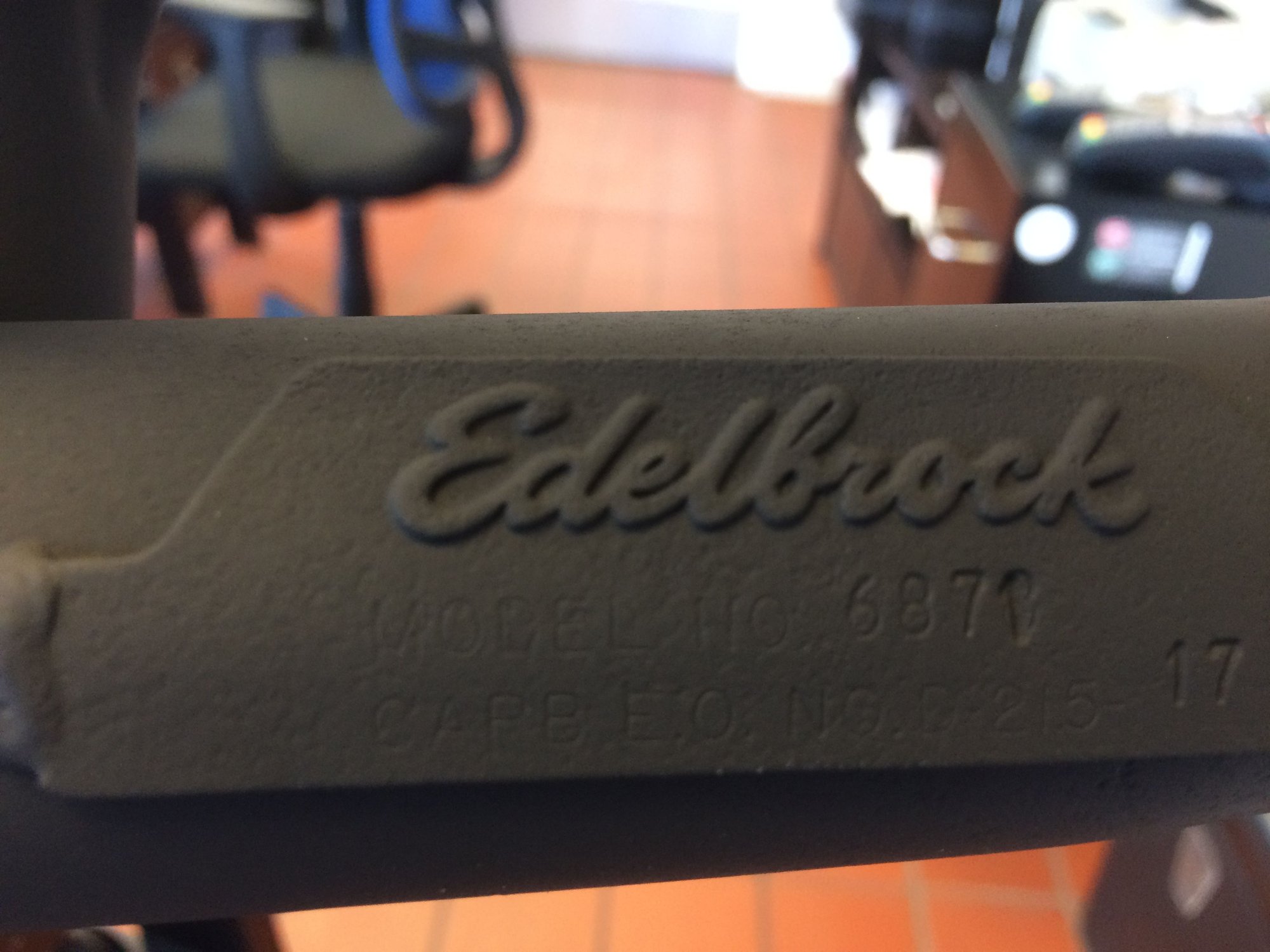

From another TGO member, 88SS6SPEED! Thanks for the great deal!. Came with SLP runners all ported!
from David Auster! Have to keep emissions in CO. Thanks sir!

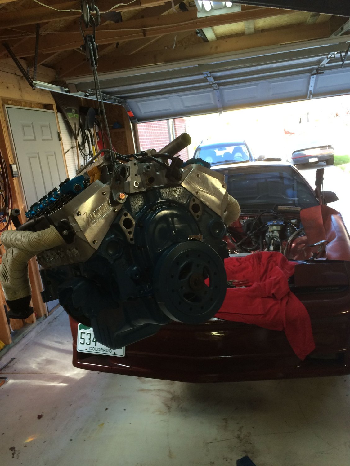

going in!
IN!

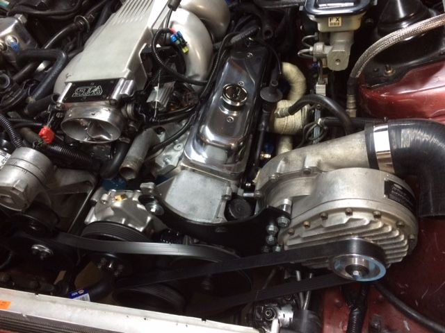

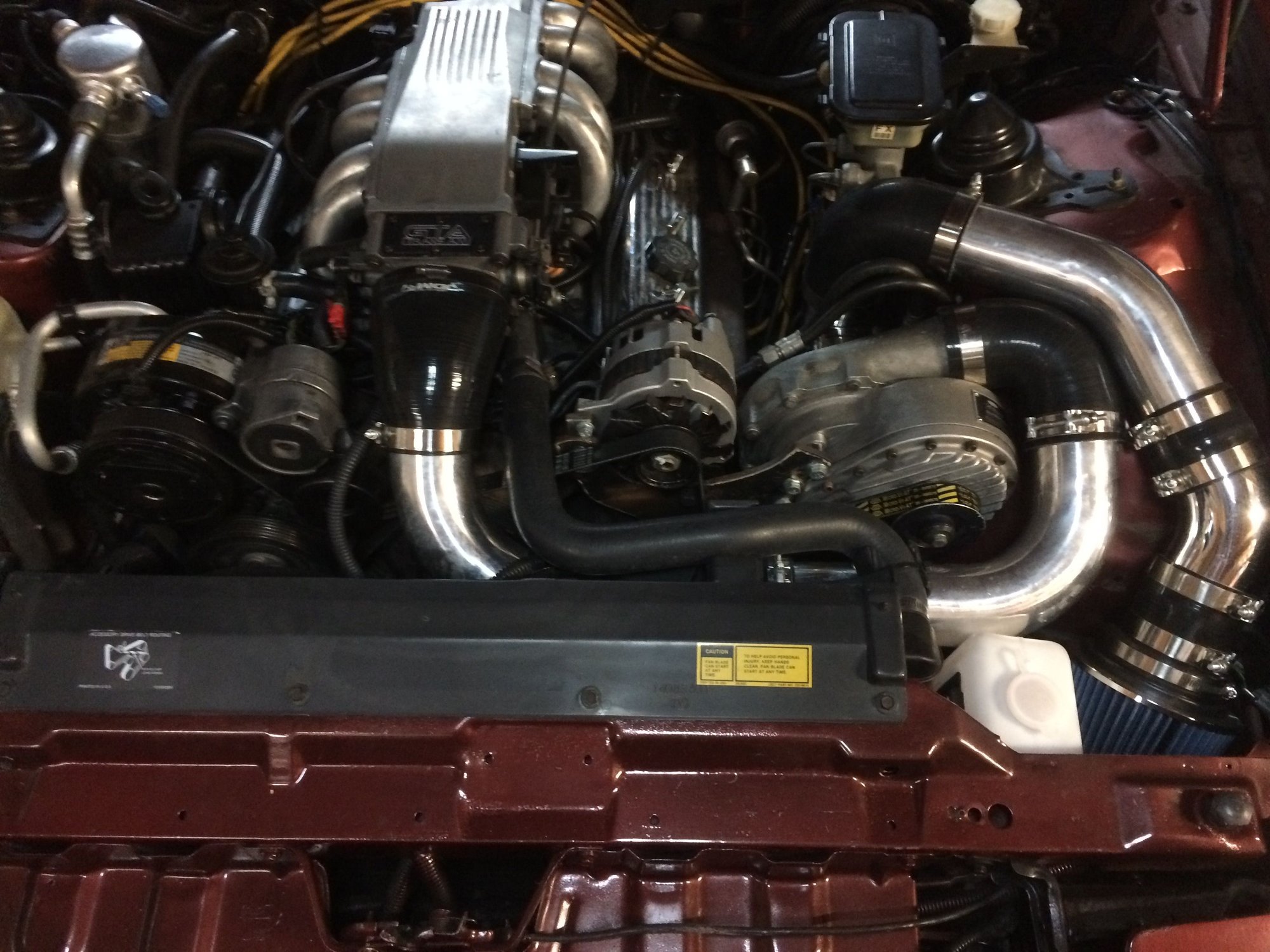

mocked up blower with smaller 2.75" pulley to figure belt size.
together and running! Broke in for 500 miles and gave her the first boost. from 2,500 rpm to 5,000 sets you in the seat HARD! success! Now off to paint....

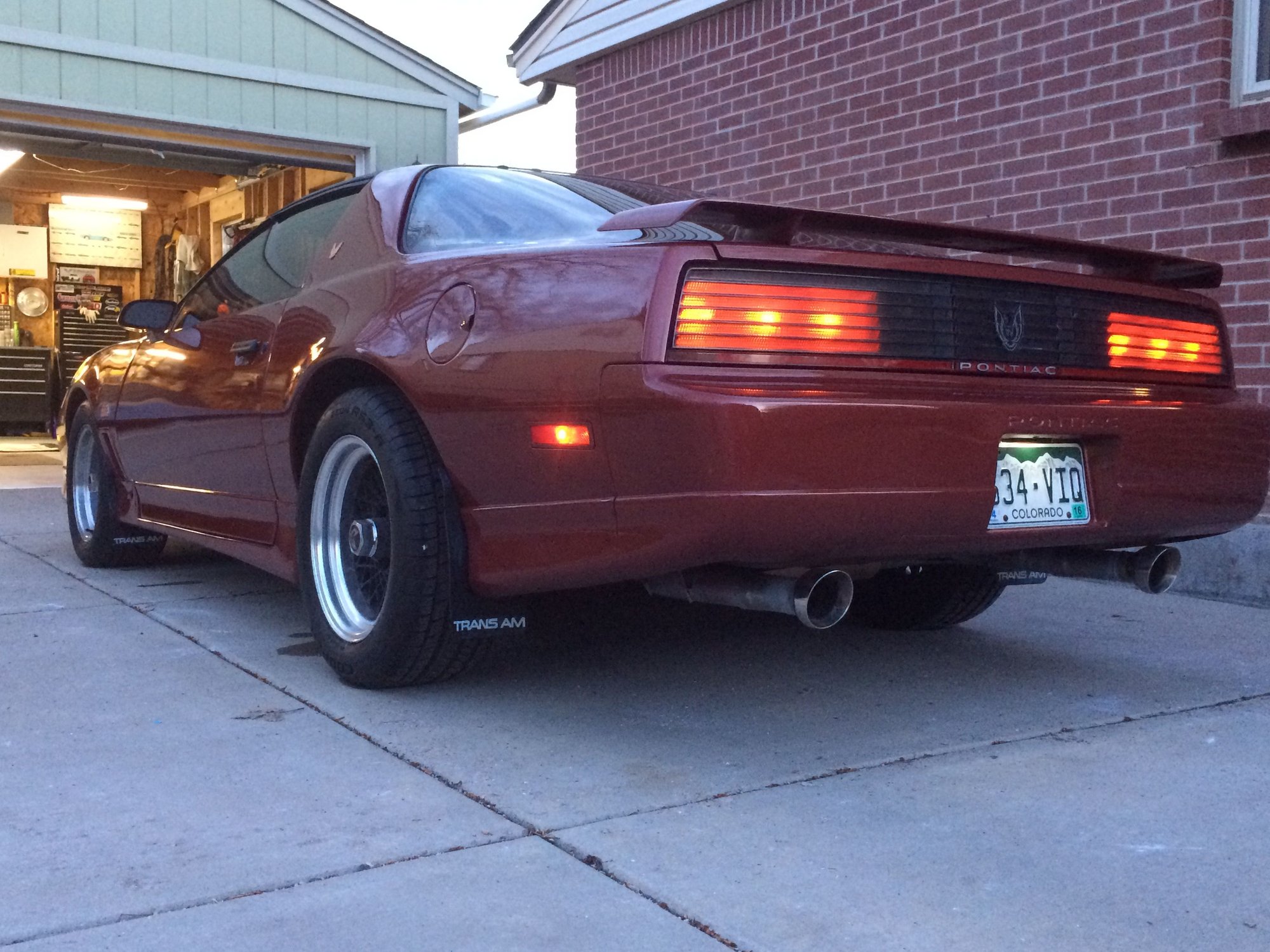

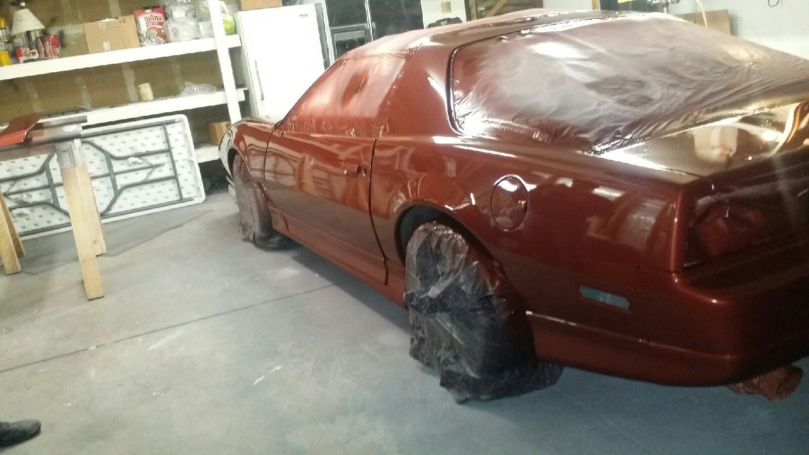

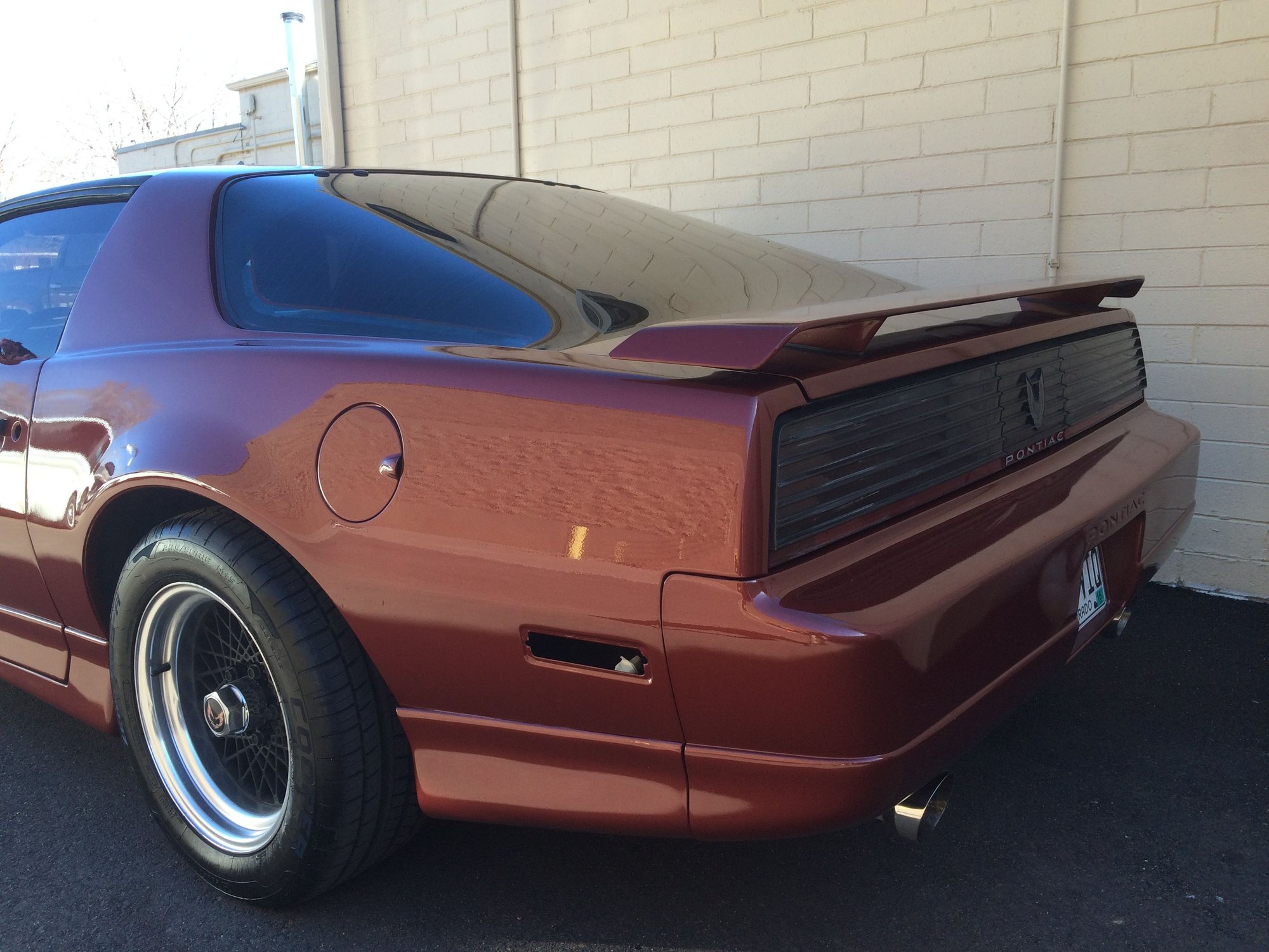

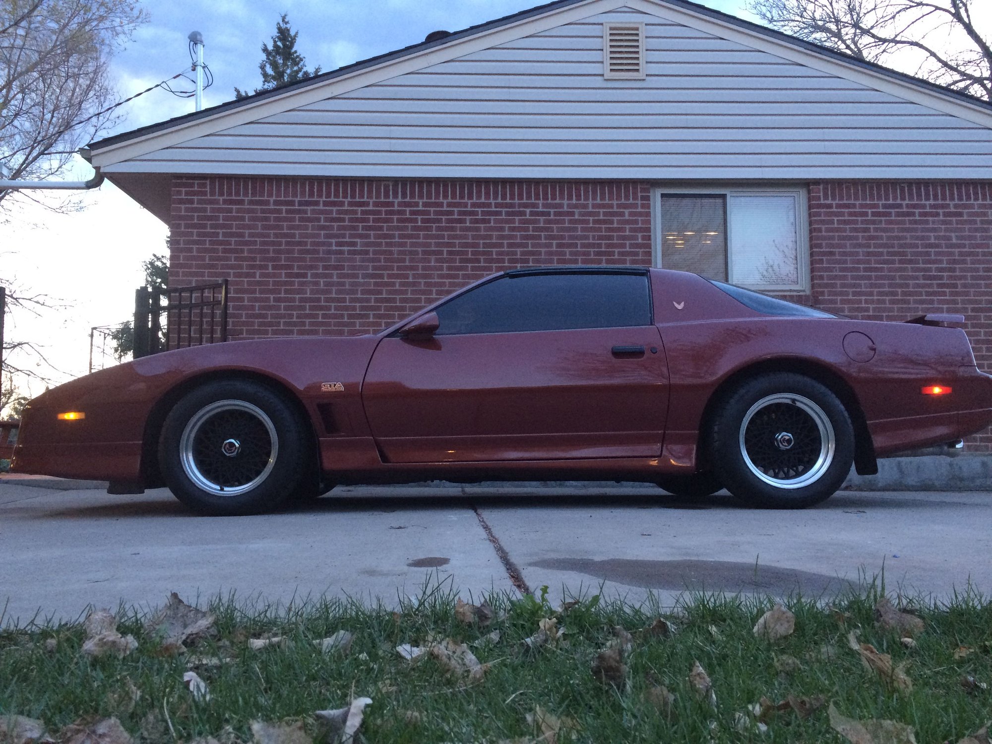

After 4 days of prep work...

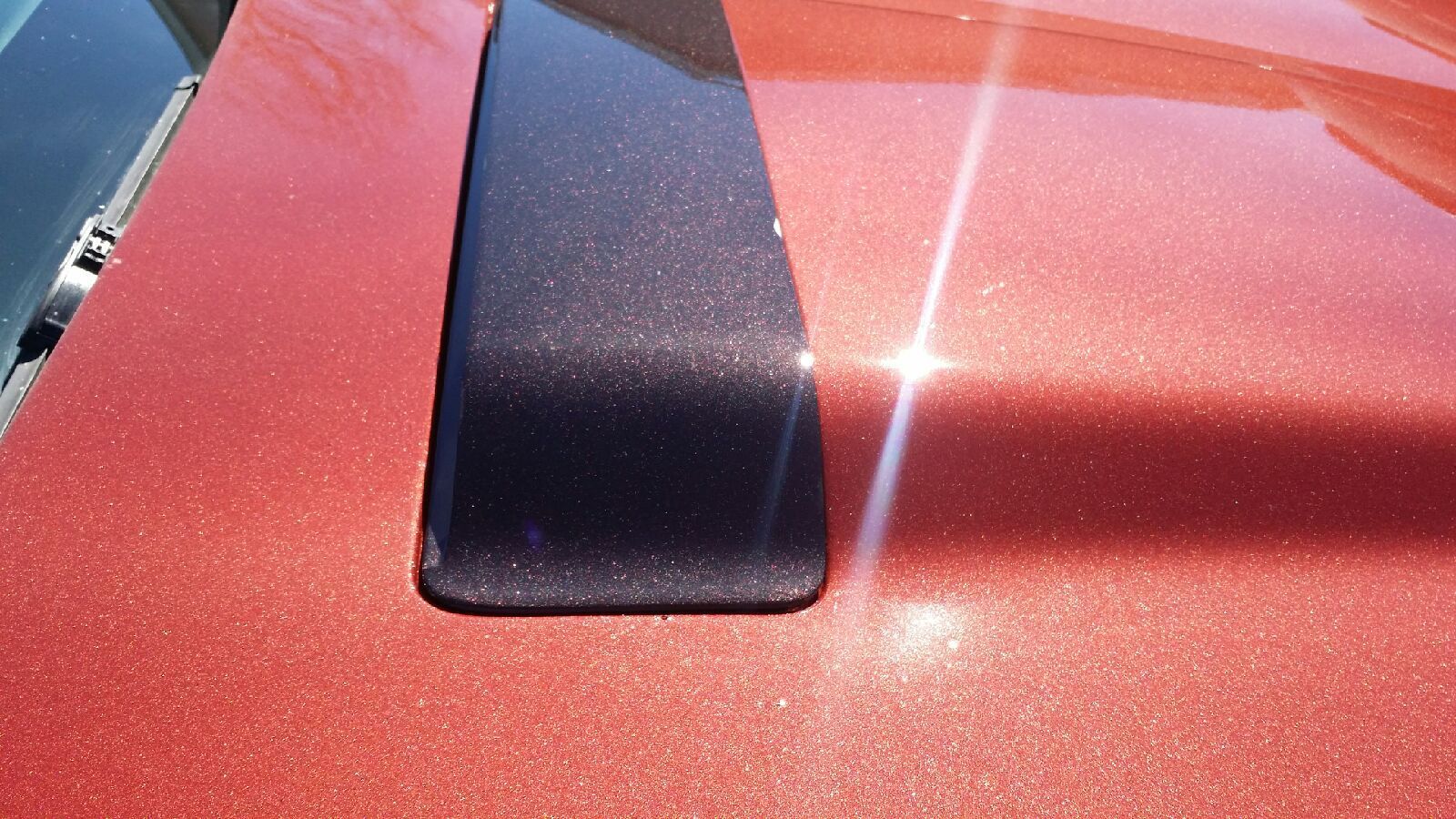

First time to check it out in the sun
84 taillights, rear deck/spoiler, and hood on an '87, my favorite combo!<br/>

thanks fellas! it's a newer GM color. Seraph Orange.

Nice build man! What model supercharger are you running?

[QUOTE=Bullydawg;6024769]Nice build man! What model supercharger are you running?[/QUOT
Thank you!!! it is a Powerdyne BD-11a. I put the kevlar belt and pressed the ceramic bearings in it. Then i put a smaller pulley in it. it finds 8 psi very easily. I would like to try that $400 upgraded impeller at some point but im happy now. Seriously, people complain about these and that they are a waste of money but they do not need oil lines ran and they are quiet. I love it.

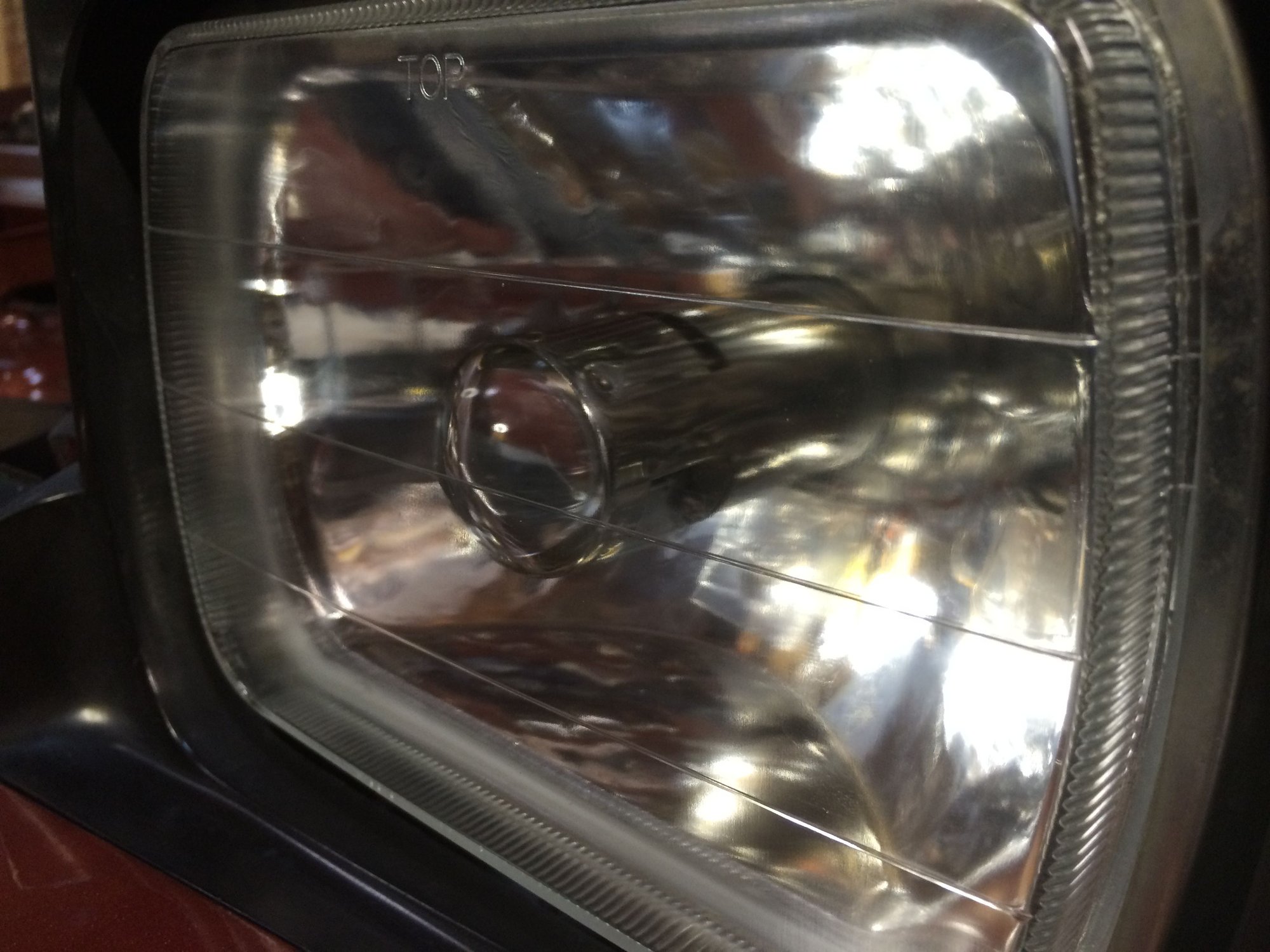

i could not find any cheap HID headlight retrofit info so i made my own combo. Easiest and cheapest with Euro quality! $130.00 for everything needed!
has the upper beam blockers for best low beam coverage! and has Xenon High beam.<br/>Innovited H4 9003 HID Bi Xenon Dual Beam Hi/Lo Projector Len 6000K White Bulbs

i only know this can work on 7x6's not sure about any other bulb housing. message me here or PM me if anyone wants to know the details of this install..
