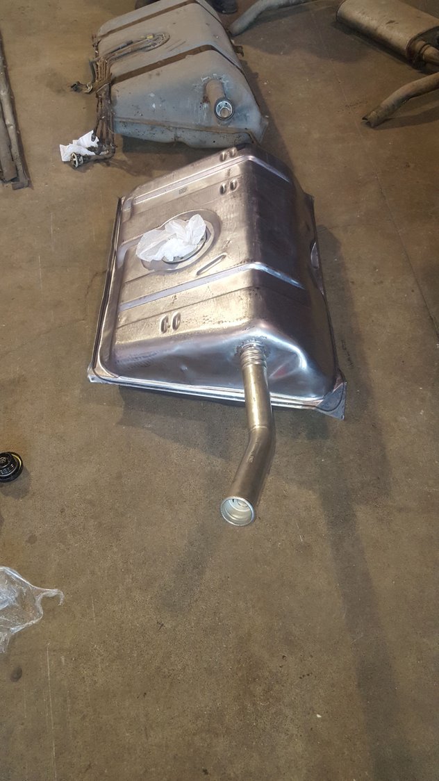

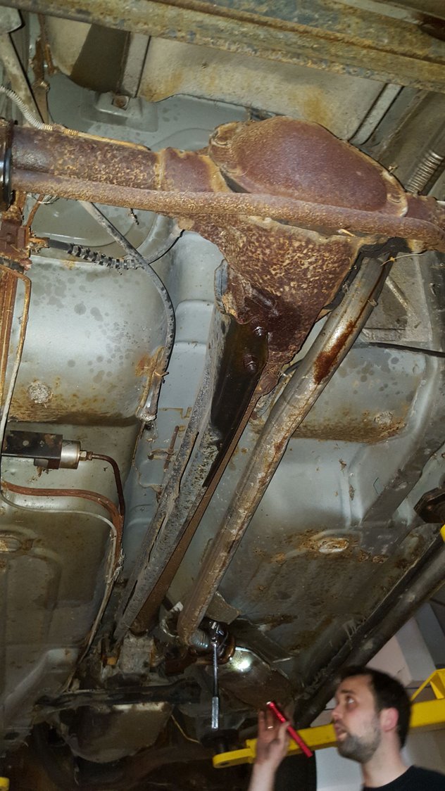

No updates on the car so far. A couple of third gen buddies of mine are buying a 87 Formula TBI parts car. Runs but crusty underneath. It's got headers and a clean Edelbrock cat back + Edelbrock TBI strut tower brace! Seeing how I need to remove my exhaust to drop the tank this is a potential dirt cheap exhaust upgrade! I won't do the headers but exhaust for sure it it sounds nice!
Even though it's crusty underneath you never know, maybe the gas tank is decent. If so I will clean it up and use it for my car. As a BONUS: The guy works at a GM dealer and put brand new discs and pads up front 2 weeks ago lolol. How convenient for me!!
I placed a small Rockauto order yesterday. For the T/A I ordered a Bosch fuel pump and 2x front brake hoses. So fingers crossed the level sender and tank are ok on Formula and I just saved some $$$.

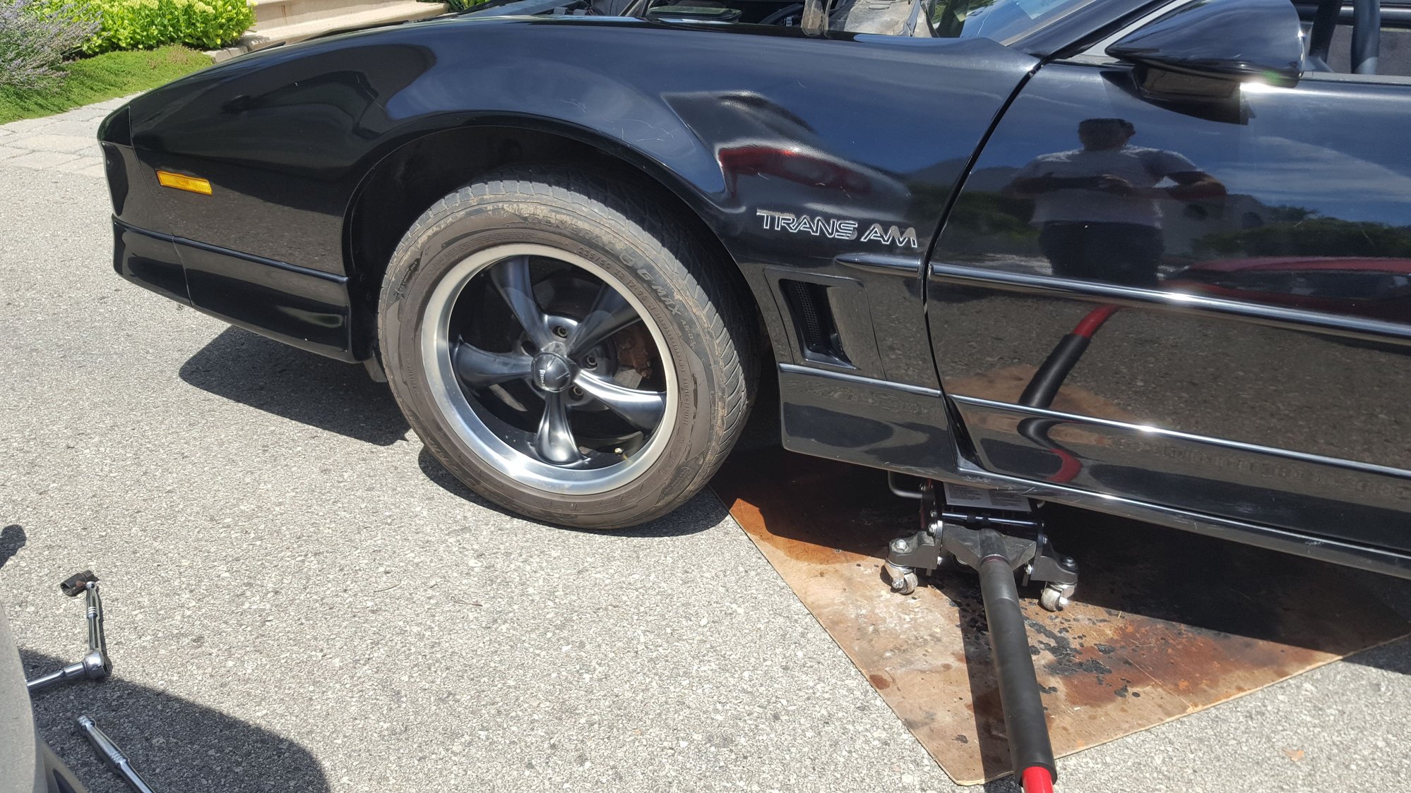

SHE RUNS!! FINALLYYYYYYY
Friday was the big day. I toyed her to a friend's shop and we got to work. I was honestly kind of nervous about it. From reading how it's a major PITA job, everything being seized to Spectra filler neck won't line up at all etc etc. So here is how it went and my views on this.
If you're going to do a fuel tank on the driveway, yes for sure I can see how much of a monster ***** job it can be. On a lift with a transmission stand it's a 4 on 10 difficulty. Taking our time in about 2 hours the tank was removed from the car.
This was the first time seeing her on a lift. Slightly dissapointed because there was a little more rust than expected on the floor but it is what it is. I'll eventually remove the rug and see how bad it looks from up top.
I sprayed everything the night before with penetrating fluid. Maybe it helped, maybe it didn't I do not know. But what I can tell you EVERY SINGLE BOLT came out of the car no problem at all. It was unreal. Even the wheels weren't stuck to the drum. We had the end link snap on the driver's side. OOOOOOOO bought 2 new MOOG for $10 CDN lolol. Also noticed the rear shocks are scrap so got new KYB's for $60 CDN. Will be installing shortly.
New parts list included:
Spectra Premium fuel tank with filler neck
Spectra Premium level sender/hanger
Bosch TBI fuel pump
AC Delco strainer and fuel filter.
The old level sender looked disgusting. Rusted out. The hose on the pump was long gone lol. The inside of the old tank was nasty and smelled horrific. Write off.
We reused the original tank straps as they were in good shape. For the "padding" on the fuel tank I took a page out of 80's Al notebook and used some yoga mat material haha!!
Everything went back together smoothly. The filler neck on the Spectra tank did not line up 100% but it's acceptable I guess. It sits lower than the stock one. The neck pretty much "sits" on the fuel door bezel. Fuel door closes no problem. I completely forgot to take a pic for you guys.
Once everything was installed we installed a hose on the return line and cycled the key many many times until clean gasoline was coming out into the container. So with this all done, it was time to crank her up!
And nothing.... Engine was turning over no problem, good spark but no fuel. Well, good thing I bought a spare TBI unit just in case! After swapping that in she fired right up! A cheer from everyone in the shop. Let her run for a minutes, then shut her down to check for leaks.

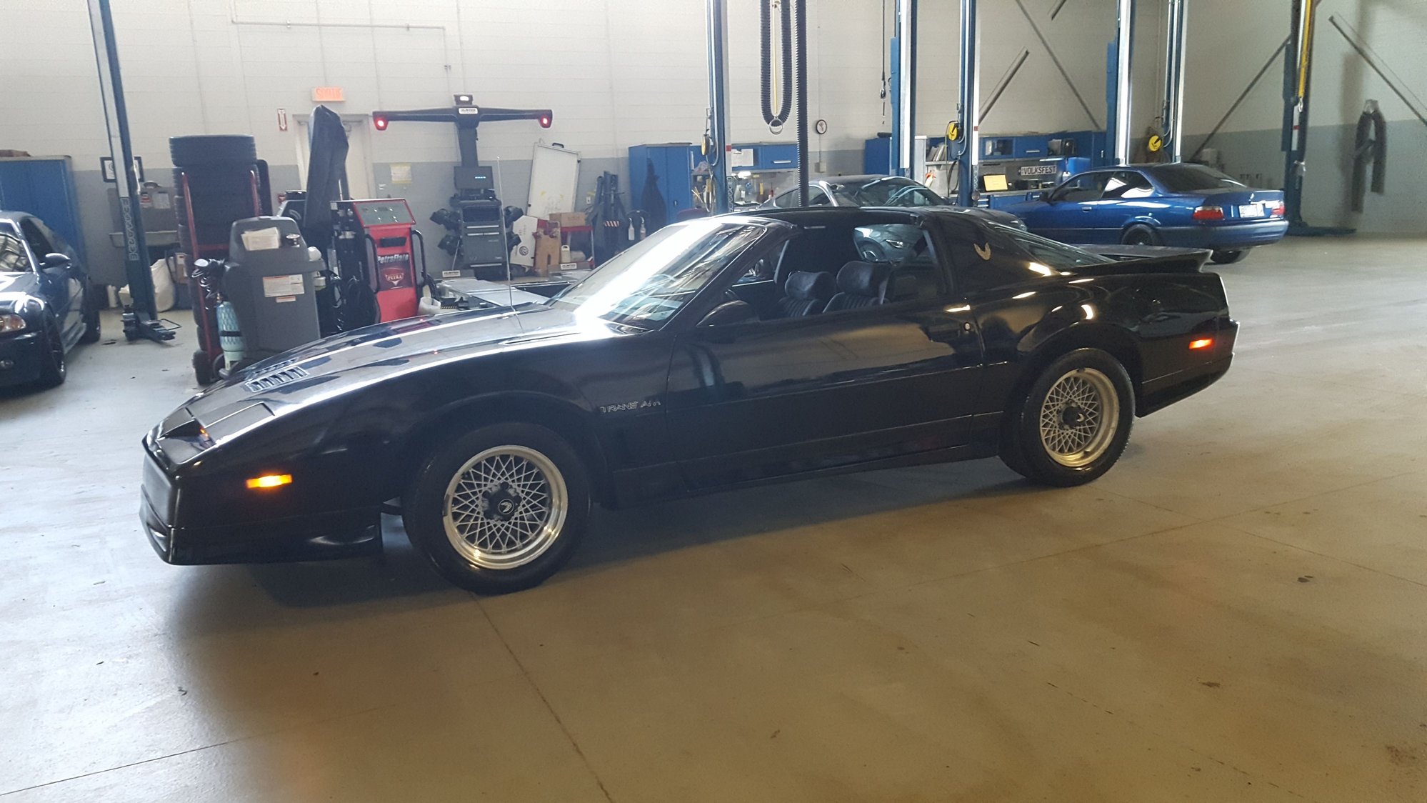

Brought her outside, let her warm for 10 minutes then took her down the street on her maiden voyage for some more gas. Everything felt ok. Drove her around the area (industrial) slowly to get everything circulating. Trans shifts fine, power steering feels ok. To conclude activities at the shop, brought her back in, did another oil change, cleaned up and drove her home!!!
I drove her to work on Saturday (day off) to use the wash bay and clean her up again. I did a quick fast interior shampoo on the front seats and front section of carpet. Then did a wash and back home. SO here are were the issues were starting.
She started getting very hot at idle, close to the red. While moving it was in the middle. Sunday morning I drained the rad, threw in some water and a little cooling system flush and ran her for 10 minutes. Drained the rad, filled with water again and went for a small drive. Seemed ok. Drained rad again and filled with some distilled water. The car seemed fine for the rest of the day. Gauge always in the middle.
The rotors feel warped but they cleaned up nice lolol. Will be doing the front brakes and hoses next weekend. Still rolling the original dried out tires. I'm doing very short trips around 35-40 MPH maxxxx. Against my judgement and good taste, I got some 17x7 and 17x8 Riddler 695 wheels for cheap to roll with temporarily until I can clean up the GTA wheels and get good rubber for them. I installed 1 wheel in the front, threw up and reinstalled the GTA wheel lolol.
Last night I was hearing some noise from the engine. It was coming from the air cleaner. Hmmm. I opened it and to my surprise found some leaves and nut shells!!! I could have sworn I cleaned intake piping/snorkel! fakk!! Vacummed eveything up and installed a new air filter. Went for a drive and she felt ok.
Pulled over to take some pictures and cruised down a small street. I gave it a little gas to get back on the main road she started hesitating. huh? COuldn't rev past 1500 RPM. WTF! Drove her home (close by) and while parking noticed the temp gauge right under the red! Shut her off and heard lots of air in the system.
Let her cool down key on with the fan running and hood open. After 20 minutes cooled down enough to open rad cap. Rad was full and so was overflow. At this point too dark to do anything. Put it back on, went up and down the street and could now go up to 2000 RPM until cutoff. Went home, put the T tops on, parked and that's it.
Took her out this morning and no issues at all. Felt like usual. CLicked it in first at a stop sign and brought her up to 4K. Kinda stumped here/
Cat converter?
ICM breaking up when hot?
Computer pulls timing when overheating?
Here are a bunch of pics for y'all. I have some videos as well if interested,
Bosch TBI fuel pump
Cat converter?

The car looks fantastic George. You'll get these little bugs worked out. How did that tank and filler neck fit?

Copy and paste for the tank situation lol
"The filler neck on the Spectra tank did not line up 100% but it's acceptable I guess. It sits lower than the stock one. The neck pretty much "sits" on the fuel door bezel. Fuel door closes no problem. I completely forgot to take a pic for you guys. "

Just bend the neck up a bit, it should handle that no problem.

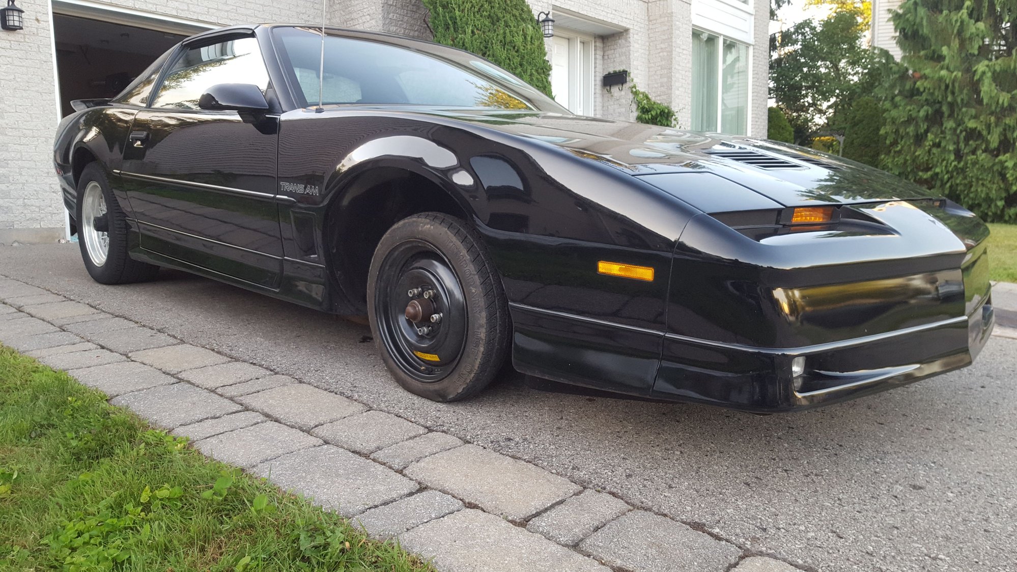

Hello! Thought I'd give you guys an update.
I've been cruising the car around here and there on nice days. I've put right around 250 miles on her. The WOT issue is still there most of the time -- Stops pulling past 3K. Stumbles and hesitates. I still haven't performed a tune up, that will be next week. The list includes
Champion spark plugs
Delphi wires
United Motor products cap and rotor -- They have brass terminals and were a good price!
Delco CV774C PCV valve
Delco 02 sensor
Delco 213928 CTS
Check timing
Change diff oil
Full coolant flush and new thermostat
Transmission oil........... So many opinions lol....... I have a WIX filter and gasket and some fresh oil. Some people tell me it'll self destruct with new oil, others say do it... IDK!
I've already changed the air filter (WIX) and that little "breather" on the side of the air box (delco).
Last time I had her out one of the original tires really started leaking thru the dry rot haha! I knew I was pushing my luck but no highway driving, just slow cruising. I wanted to change them out a while ago but was trying to find some clean used. Gave up on that and bought some new Falken ZE-950 in 245/50R16. They are a nice looking tire. Nothing crazy performance wise but I'm not really going anywhere with 170 hp.
I did a 3rd oil change last week (really want to flush everything out) and did a full check up on the front suspension. The outer tie rods are pretty loose everything else is tight. Front end list is:
MOOG ES2227RL inner tie rods
MOOG ES2226RL outer tie rods
MOOG ES2032S tie rod sleeves
MOOG K2K5 end links (did the rears already)
KYB Excel G struts and shocks
Also changing the front brakes and all 3 brake hoses along with a full flush.
Body wise I did a little more work by hand on the drivers side. Meguiars ultimate compund, some glaze and Ultimate paste wax. Some very nice stuff! I will be bringing the car to a detailer at my work to do some wetsanding and machine buff the drivers side. There are some scratches he will be able to hide well.

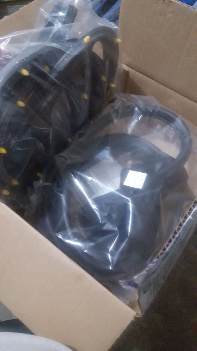

The window belt weatherstrip was virtually destroyed on the drivers side. I went with Fairchild and very happy with the fit and finish. I have read of people having issues with the holes. I only had one that didn't line up. I haven't done the passenger side yet because the door to body seals aren't in the best shape. No point in removing the panels twice. I did just receive some. Went with Fairchild for these as well. Maybe this weekend I can take care all of that.
When I first got the car the headlights worked fine. I guess the light usage I gave them was enough kill the bushings. I ordered a kit from Lon at TDS (super nice guy BTW).
The hatch pull down also started having issues. Upon inspection the housing was cracked and the nylon guides were falling apart. Got the guides from TDS as well. I was supposed to go see a buddy with a few spare motors and housings in good shape but because he's a little far I decided to try out the Dorman 747000 motor and housing. Technically I only need the housing but for just a little more might as get the motor as well. Really want to finish this up. The hatch looks closed but can be just pulled up. The lift supports are dead so it doesn't open while driving. I do have new ones to put on just gotta fix this silly issue. Everything is in the mail lol.
And that's about it. Thursday morning bringing her to work to replace the windshield and then the tires. Next Thursday everything else will be done. Can't wait!!

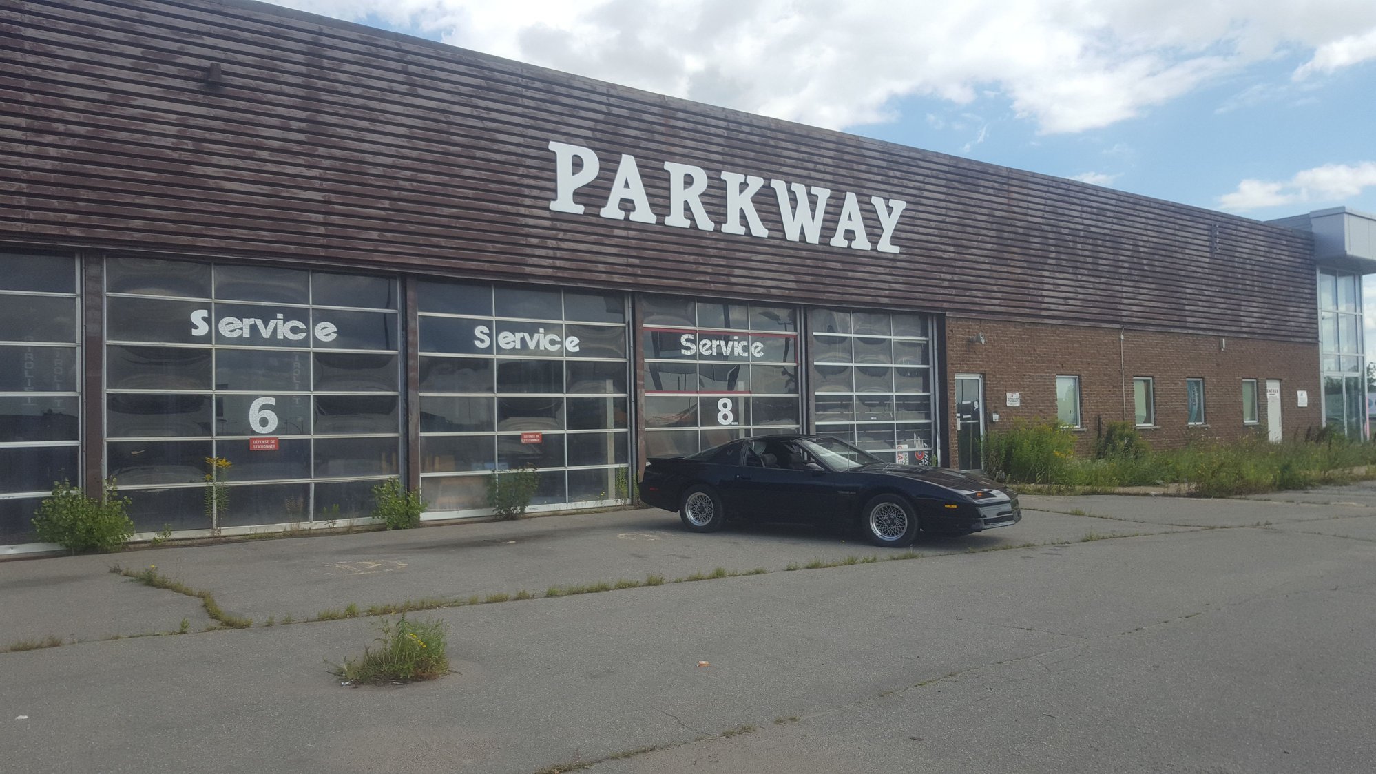

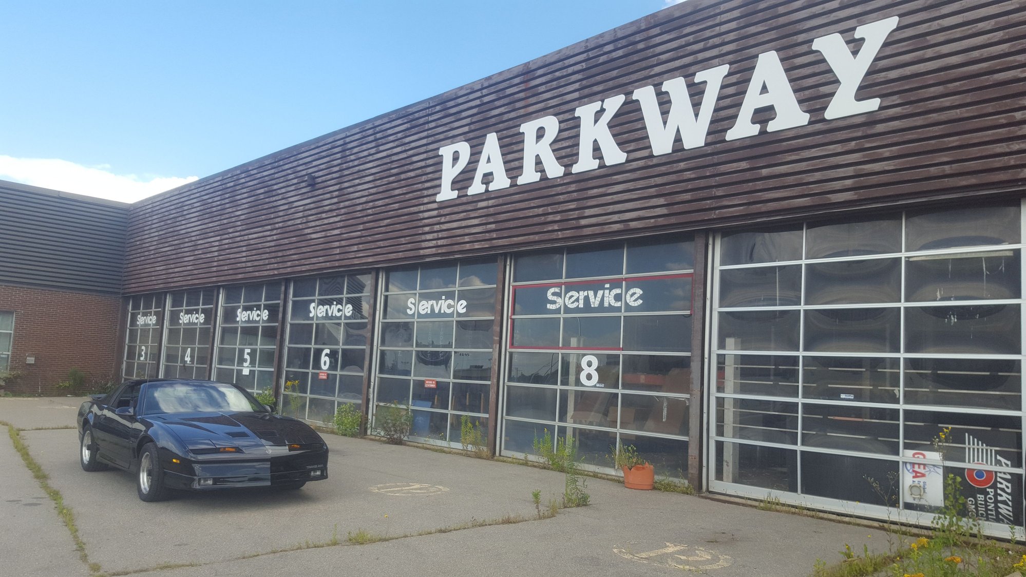

#99
Join Date: Mar 2017
Location: Montreal
Posts: 303
Received 41 Likes
on
31 Posts
Car: 1989 Trans Am
Re: "DRIVEWAY FIND" 1989 Trans AM
Here's some pics of her @ the now defunct dealer she originally came from. Parkway Pontiac Buick GMC
