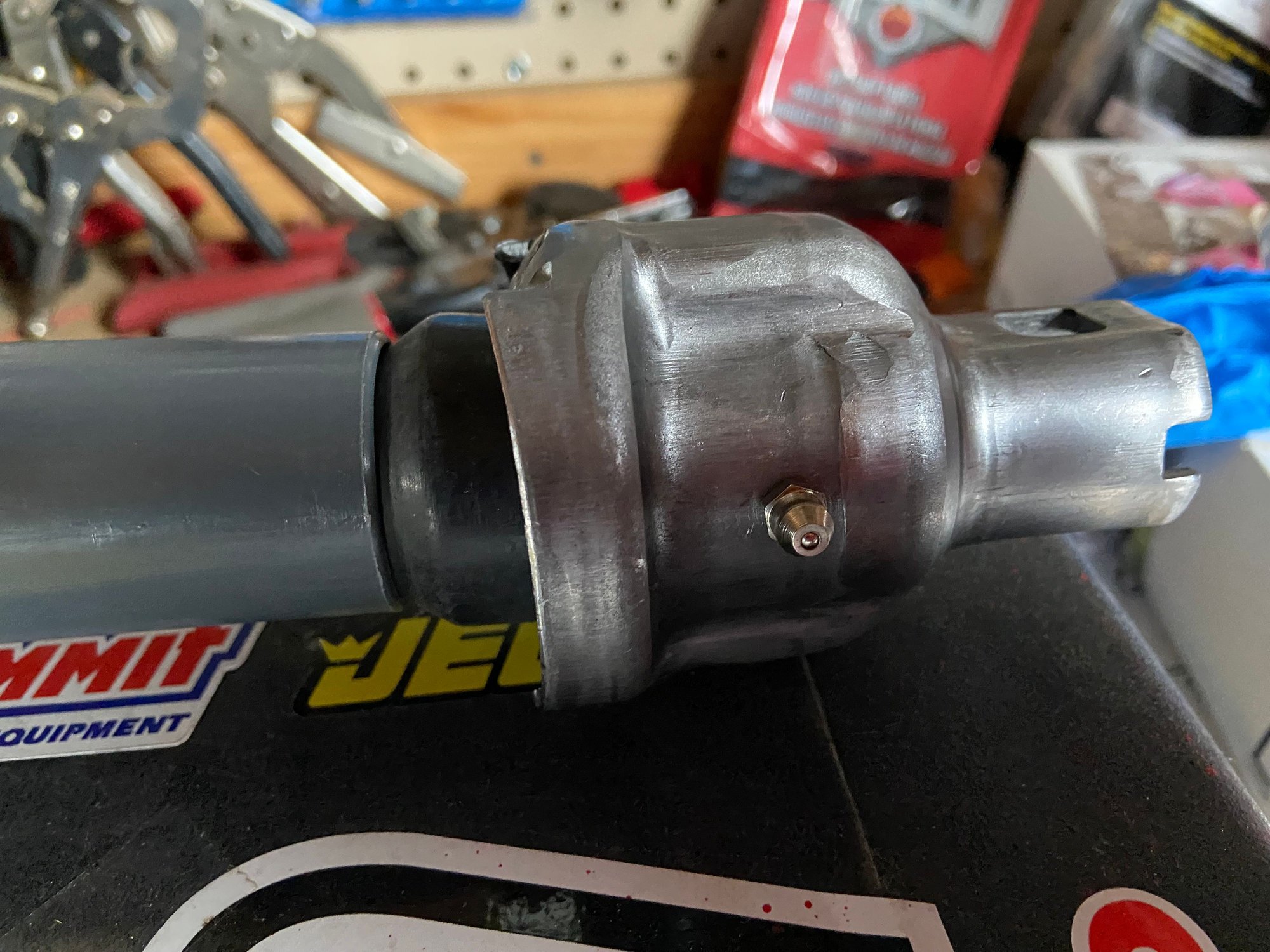

I took a good look when it was on the car for flex and handled mine when I pulled it and it seemed strong and tight so I kept it after swapping and good thing I did. Also going back from the DSE U joint shaft I lost really no steering feel and gained no play. The performance stayed largely the same only now with no binding, which was driving me nuts and did not feel safe. That DSE shaft felt really smooth when new but within 700 miles started binding coming off center as in the video I posted.
So now If the OE rag joint wears out I will simply replace with another one. After replacing most of the worn out steering parts I thought that upgraded shaft would be great, but that’s apparently only if your old rag joint is really shot which mine wasn’t.
This was an expensive lesson to learn that sometimes it’s not worth changing factory pieces but my alignment guy said he might be interested in buying the DSE shaft as he knows a lot of street rod ppl who may want it.

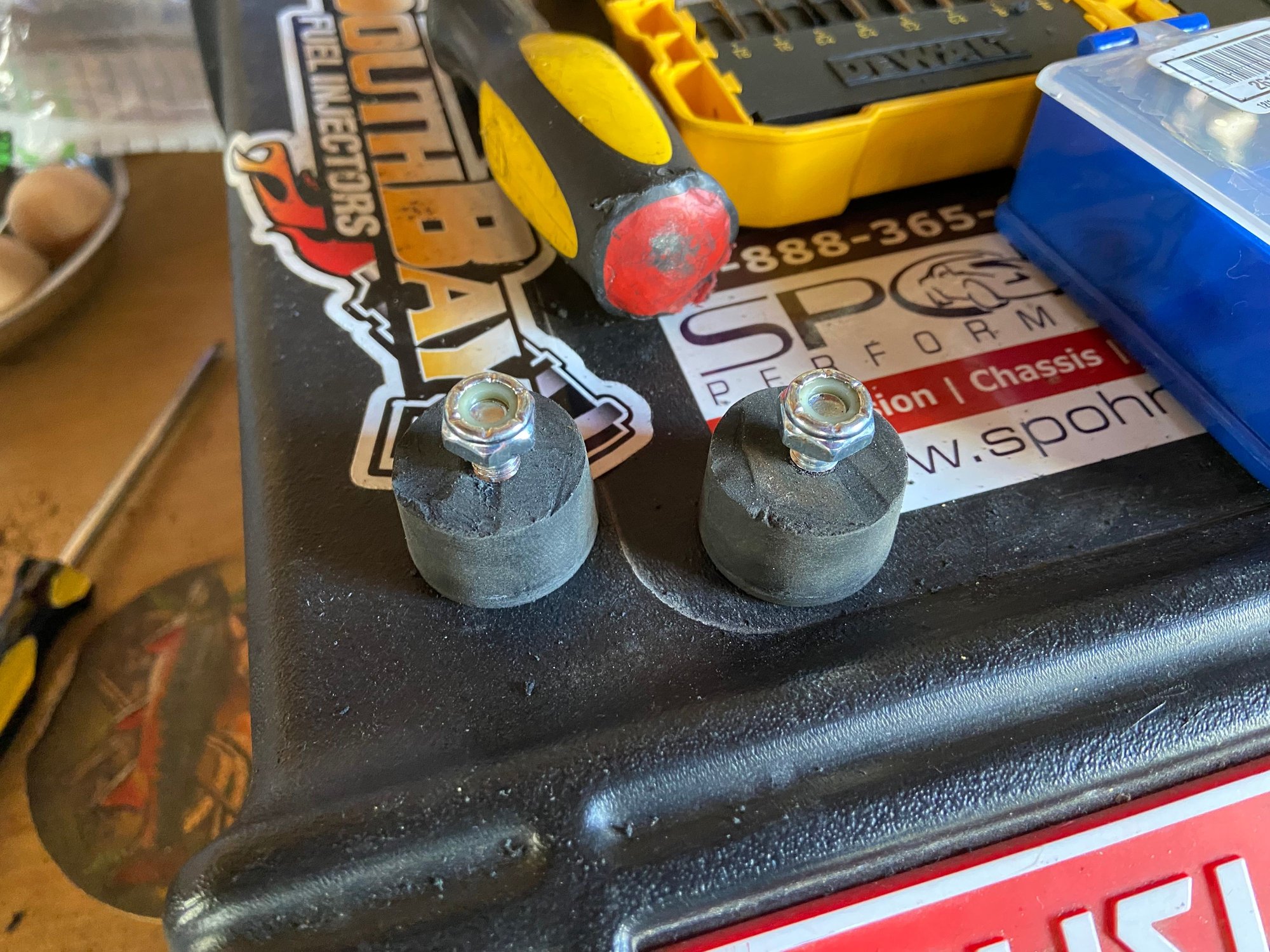

On a similar note after doing more research I did pull the factory nylon steering bushing and tried the Hawks Astro bearing upgrade when I was going back to the rag joint. I did not notice a big difference but decided to just keep it on there for now and stash the original just in case…I read a few posts where ppl felt the upgraded bearing made more of a difference than the U joint style steering shaft.

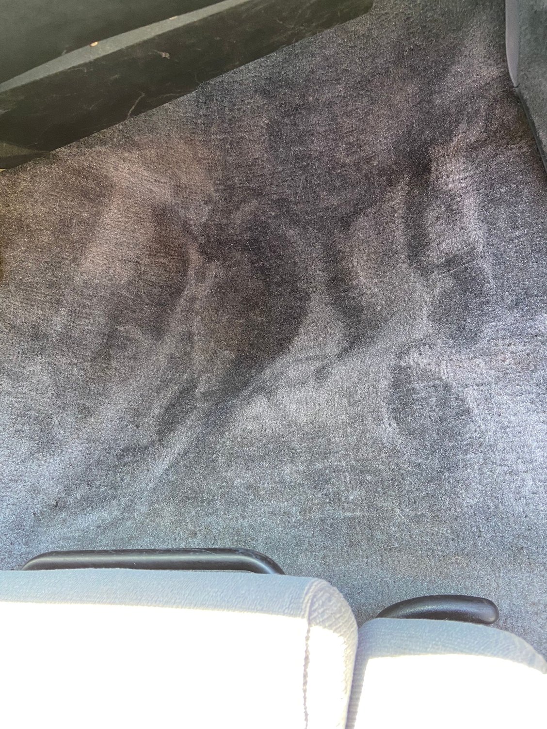

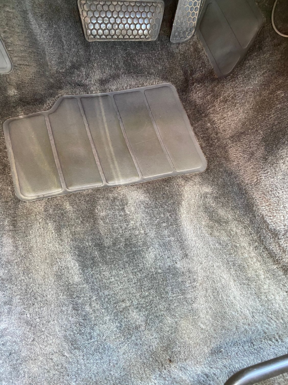

In anticipation of taking the GTA to its first car show this Friday, weather permitting, I busted out my bissell carpet shampoo/extractor to give the inside a good scrub. I have cleaned the inside of the car before with carpet cleaner and a shop vac but I was stunned how much gross water that thing pulled. I recommend this to anyone detailing cars as it makes the work much easier.
The carpet and seats looked really clean but now they are really there. I wish I took some before pics or what came out in the tanks but I didn’t, it was pretty gross though.
Passenger seat had some stains that finally came out with the extractor.
I pulled the rear seats for the first time and found an earring, screw bit, and a few pennies.
I have tried quite a few times but can’t get that stain out.
It’s not perfect but it seemed like time well spent as the interior smells fresh and looks great.

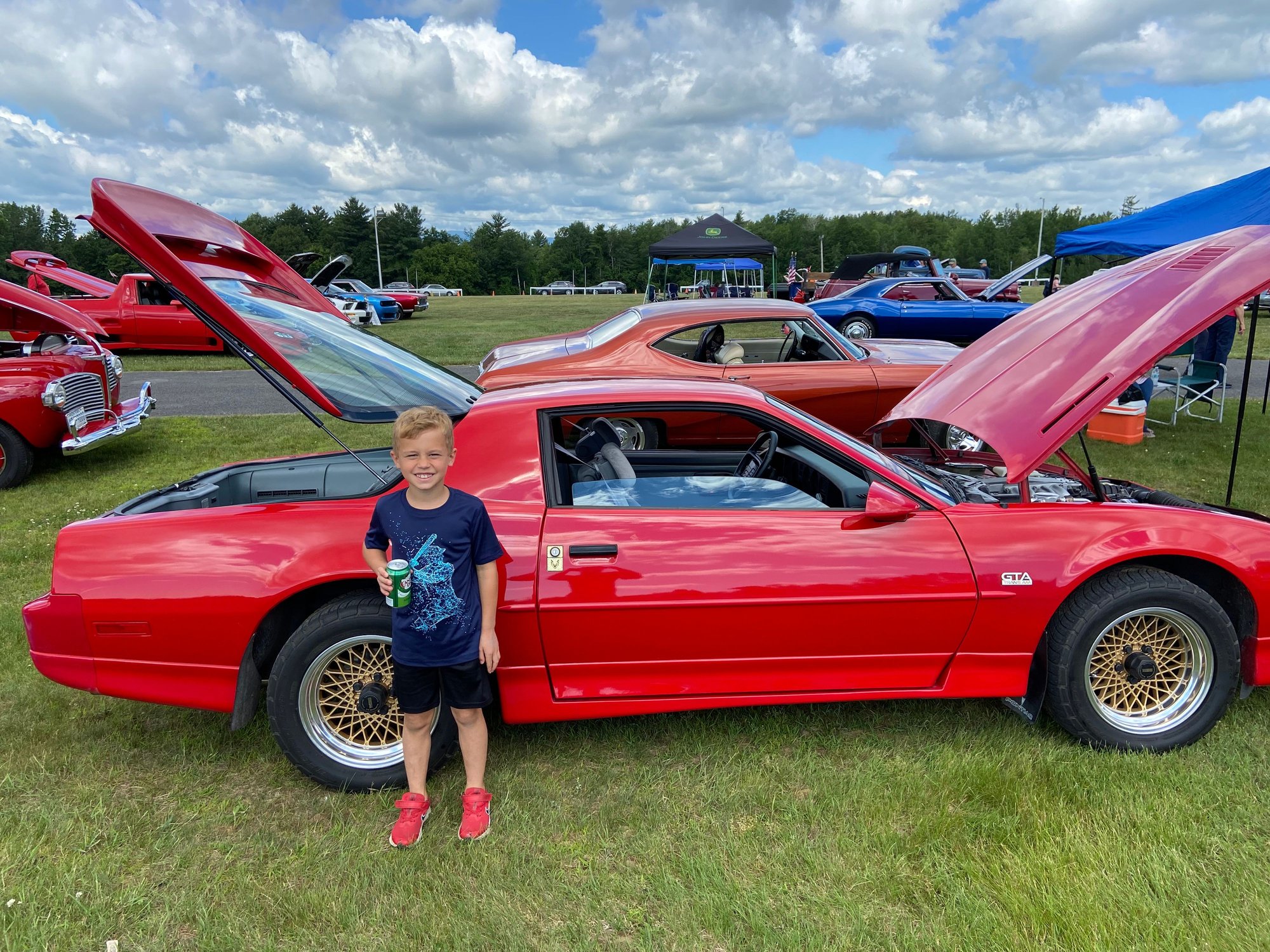

Finally made it to a local car show! Was a pretty good time but I was the only 3rd gen in attendance. I saw a lot of cool cars and talked to some good people. The swap meet even had a nice set of IROC wheels for $100!
My son with the GTA at the 2022 Clinton county fairgrounds car show.

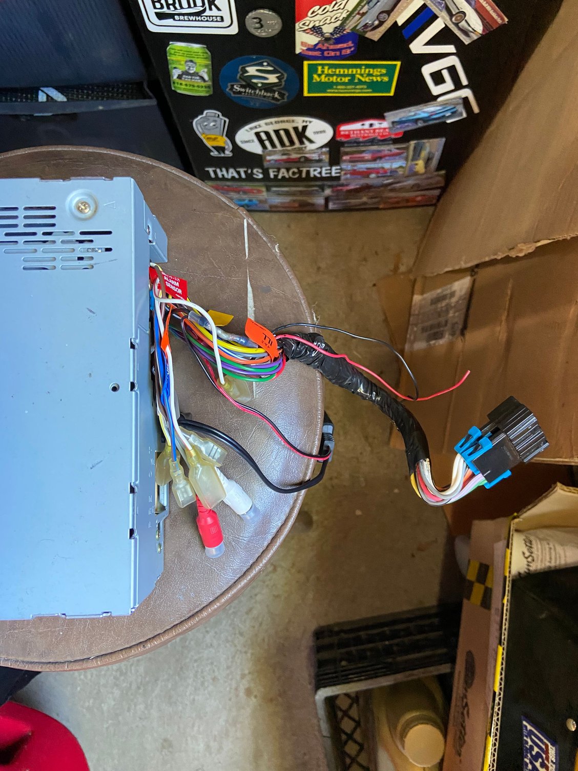

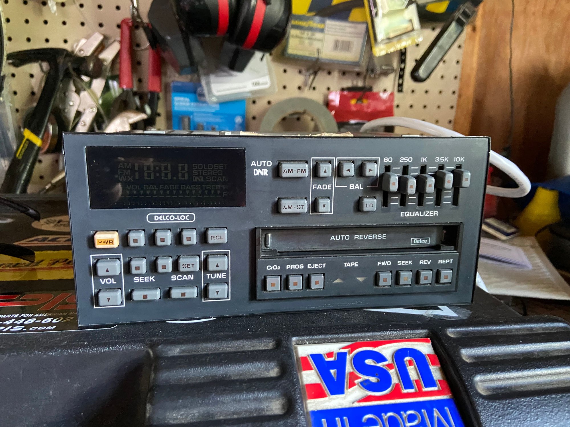

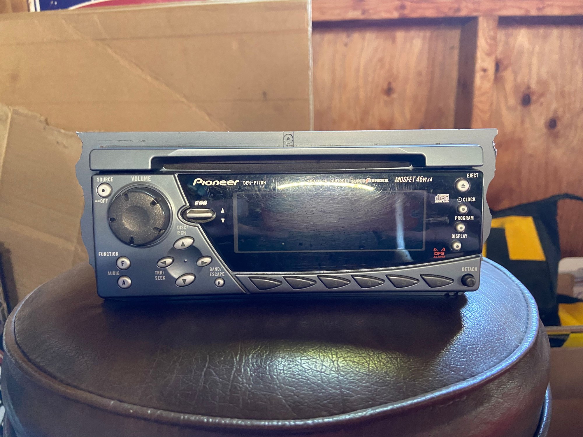

I finally scratched the itch of finding a correct OE radio for the car and Firebirddude had one that was in nice shape. I sent it out to M&R in Saginaw, MI to have it refurbished, repair the cassette deck and add an aux cable. The radio should be good to go for a long time now. Cost of the refurb all in was $315 in case anyone is curious, turnaround time was fast (1 day).
Here is the old Pioneer.
Pioneer CD player after removal.
Pioneer wiring and BT aux.
UT4 radio, pretty decent shape and added an aux.
I don’t know how many years it’s been since the car had an original radio but it does now.
I will miss the CD player as I still have a lot of CDs but I am trying to find a way to rip my cds onto my iPhone but the aux will allow me to stream XM, Spotify and Amazon music. My Chinese BT adapter was beginning to give me fits with connection so the AUX should cure that.

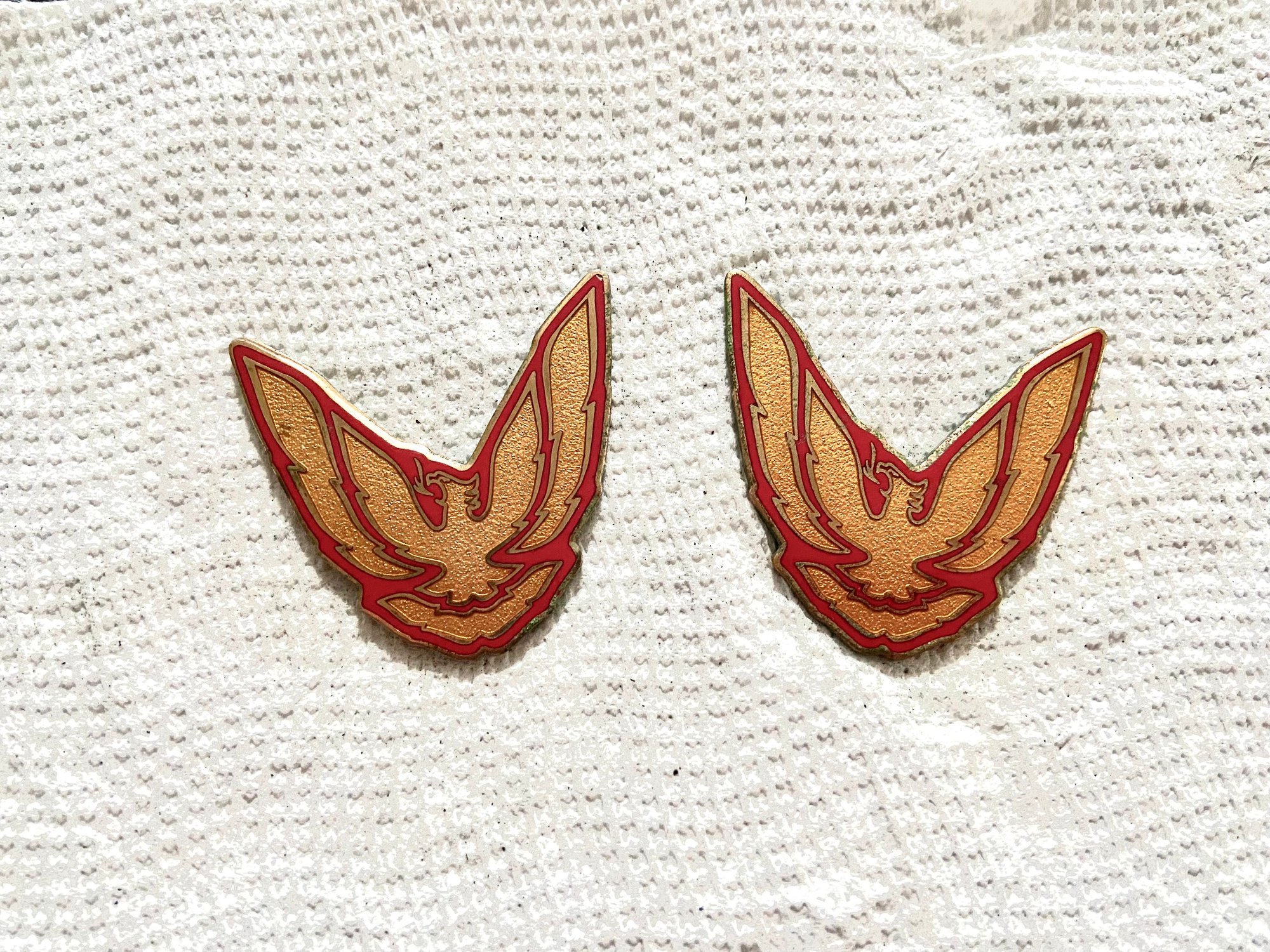

I am back on trying to find a good set of GTA badges and am happy to report that the quality of the fender badges are much better this time around.
I found a NOS set of sail panel emblems in great shape from another member and wanted the correct bright red fender badges.
NOS

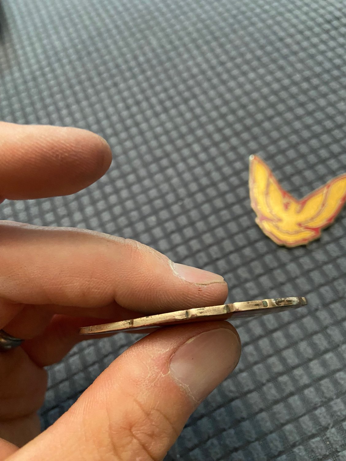

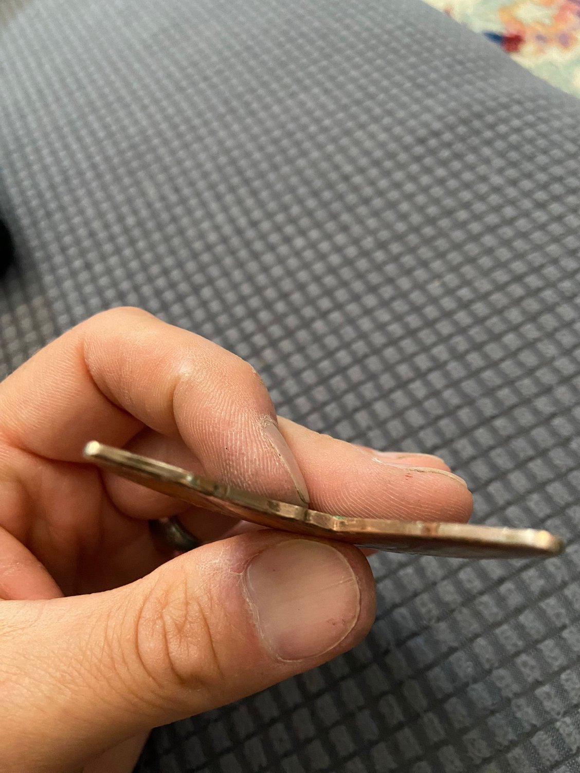

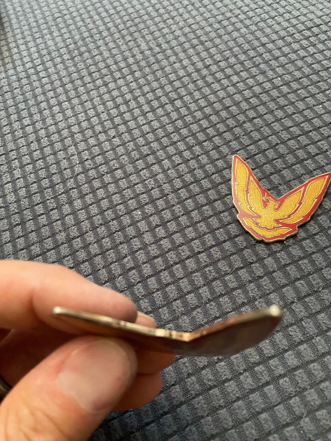

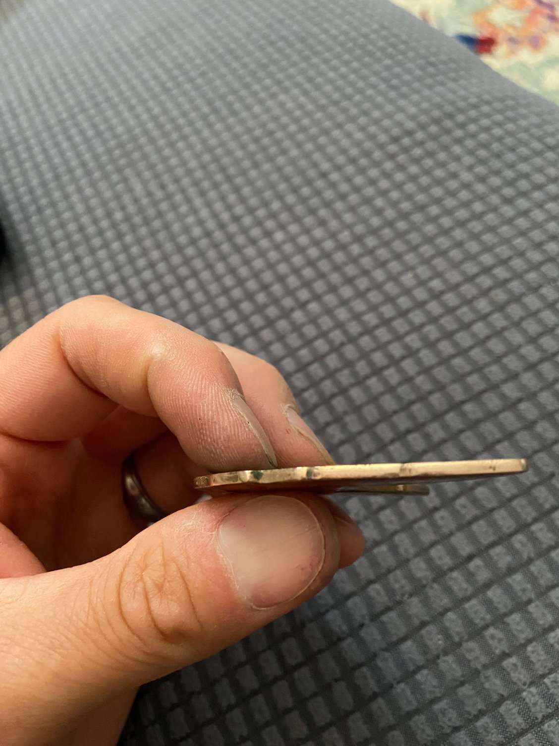

I tried Carmotorsports again and the quality was just as terrible as last time, the paint was flat and full of black specs…just lousy all over. Many ppl on FB raves about the quality but on the bright red it’s just not there.
Bad paint
Continued
Continued
So after returning those again I tried The Parts Place, I wasn’t expecting much but when the package came, super fast too, the quality in packaging and the actual product was much better than the other vendor. The paint is crisp and bright with no imperfections and the bright work looks outstanding too. I highly recommend the parts place. I am curious if they actually have the correct bend in the bumper emblem but when I go to paint the car I will give them a shot.
Wish the pic was better but these really look amazing.
t.
Have you thought of dying the carpet where it is stained?
If it wasn’t covered about completely by the mat I would likely get fabric paint or try dying it the old way. I’m lucky it is largely hidden. Do you have any recommendations on products? I have not researched it a lot.
If it is Coffee stain, White Vinegar is the solvent for coffee. (try in an inconspicuous place first).

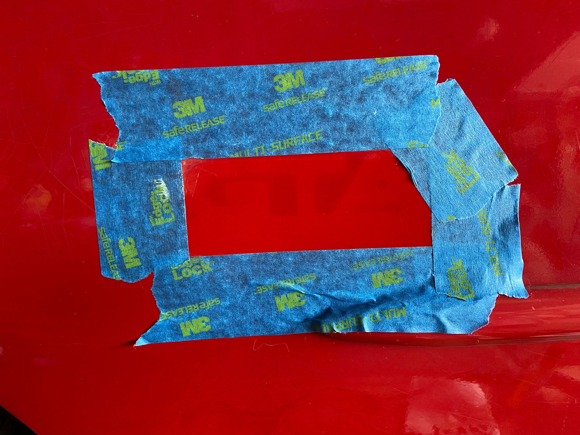

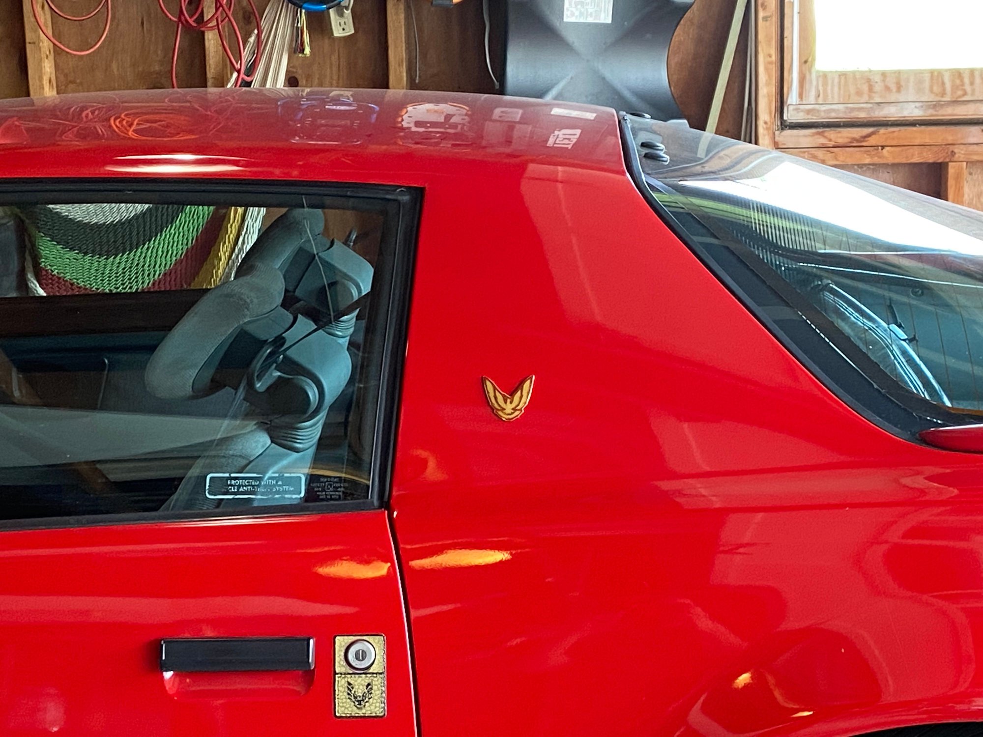

The GTA finally looks like it did when it rolled off the line with the addition of the correct color fender badges and adding the correct sail panel emblems.
Those small details have bugged me for awhile but with the help of my lovely assistant/wife we managed to get the emblems pretty close to where they should be according to the info on the GTA source page. I also found out the PO ,while close, had the fender badges in not quite the right location. I used a hair dryer and plastic putty knife to remove the old badges, removed the adhesive with goo gone and then hit the area a few times with rubbing compound to clean it up a bit. If you look real close you can see where the paint is slightly brighter where the old emblem was but shows now that the emblem is placed correctly.
Old emblem, found out after removal it was in the wrong spot so I didn’t need to tape it off
New emblem placed correctly.
The shadow of the old emblem before buffing a bit.
New sail panel where before there was nothing.
Finished product, will likely clean the car up and take more pictures later. Once again I would like to comment as to the quality of the parts place fender emblem quality, they really look great.

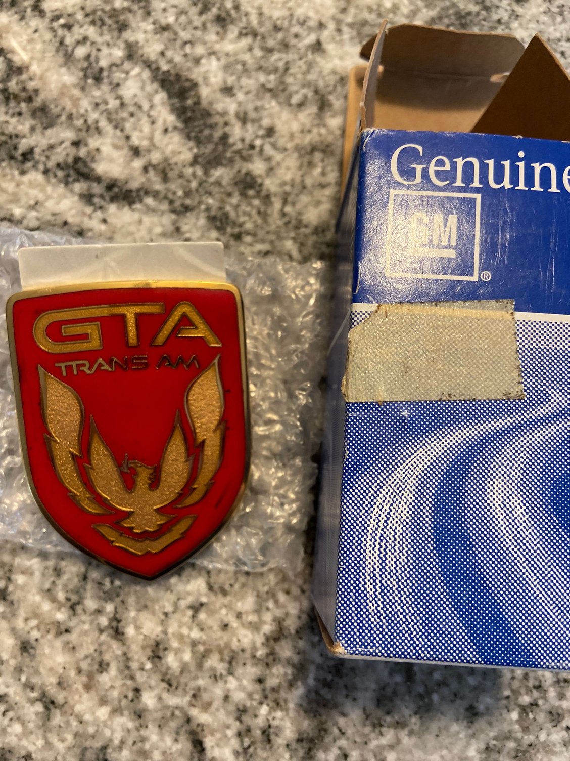

The eBay gods finally shined on me, I found a NOS bright red GTA front bumper emblem. Now I have all the correct emblems for when I get to the paint.
Now just trying to enjoy the car before the weather turns and it goes into storage.

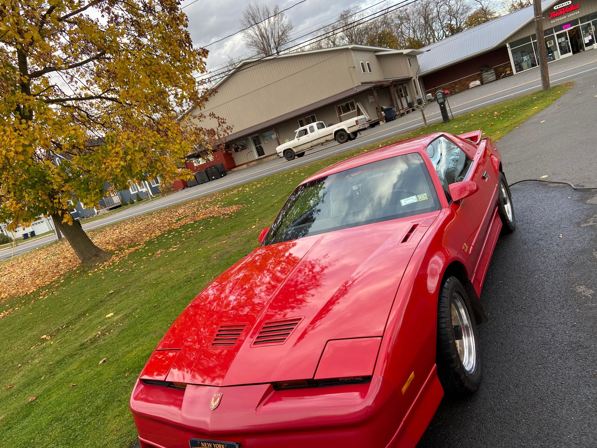

Finally had to put the car away as the weather looks it will turn fast after having an amazing Fall driving season. I went through my normal winterizing routine and now I am thinking of a possible winter project or two…I think it’s time I swapped out the brake hoses as they look old, not bloated or cracked, but man they look original especially the rear ones.

I recently saw an old YT video by member Klowny when he diagnosed a worn rag joint and I wanted to test it out on my car and found my OE rag joint had more than a little play based on his test of watching while someone wiggles the wheel back and forth with engine off. Mine wasn’t as bad as the worn out unit in his video but was close and not nearly as tight as the good one he showed.
So I did some research and found a site called Mike’s Montes that has the same replacement shaft as hawks for almost $30 less and decided to order one up and see if I get an improvement. The shaft is the same for our cars as the G body’s of that era and the new one even has a grease zerk at the column end.
I will report back once i get a chance to get it installed and see if it tightens steering up a bit as my car has a little slop at center and after replacing most of the front end and adjusting the box I hope this is the final piece.

Received the new steering shaft and got it installed, seems like a quality part. Only things I did was swap the steering wheel end of the shaft around so the grease zerk was on the top for easy access, cut the new plastic shroud to the same length as the one I had, and I needed a different bolt to clamp rag joint at the steering box ( I went with a hex head 3/8 standard bolt, the one on the original was metric and wound not work). It was a pretty straight forward install.
I have my doubts as to how much this will improve steering but we shall see, hopefully can take a drive tomorrow or next time the weather is decent.

That was an utter waste of time and $, had more slop with the new then old. I swapped back the original and gave the adjuster on the top of the steering box a very small adjustment and was happy with that. It’s lousy how bad aftermarket parts are and of course I can’t return it as I already modified it as earlier posted, sometimes it’s best just to leave OE parts on.

Sounds like the new unit was DEFECTIVE.

The difference seemed to be at the top of the where it mounts to the steering column, which makes no sense to me but I do know the original works better.
I would probly try to return it if I didn’t modify the plastic shroud.

I am done messing with it now, it seemed that there may be one other one out there besides that but OER makes it and I’ve never been impressed with their stuff.

Well one upshot to this was I at least got a full refund for the defective part so that helps. At this point I am really leaning towards getting a new quick ratio steering box from Redhead or having mine rebuilt if the adjustments don't work...the off center slop is getting old.

Found a nice score on eBay last week, these are bright red and in really nice used shape. I am going to try to remove the oxidation on the gold trim.
Old Jul 10, 2023 | 01:56 PM
  #246
mikeceli's Avatar
Joined: Jan 2005
Posts: 1,401
Likes: 200
From: S. UTAH
Engine: LB9 305
Transmission: AT
Re: 1988 GTA Project
It might be brass. Try "Brasso".

I just got done working them with lightly with 220 grit sand paper and then hit them with Simichrome Polish I had laying around. I wish I took more pictures of the before of the edges.
The end result turned out pretty good for an hour or so of work.
Before, it was like that around both of the sail panel emblems.
After
After
After
After
After

Looks good!

Thanks! For under $20 I couldn’t pass them up considering the condition they were in, they actually came off a second gen Trans Am from the sounds of it. Sometimes scouring eBay for parts is worth it.
