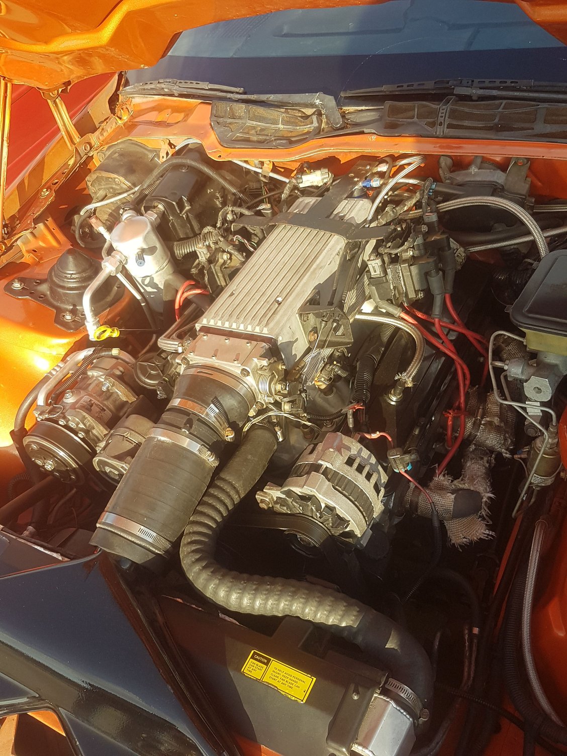

Will I did some under hood assembly - air cleaner install - very tight with STB on there wish I could find new flex ducts for this or some way to reskin them somehow, 80's GM quality!

If you need a tad more clearance to those snorkels, I've seen folks add a plate of aluminum under the STB mounts near the struts, to space it up just a touch. Watch your hood clearance, but you should be able to buy yourself a touch more room there if you need it.
Old Oct 1, 2020 | 07:51 AM
zman1969's Avatar
Joined: Jul 2003
Posts: 582
Likes: 205
From: DFW
Car: 90 Formula 350
Axle/Gears: Dana 44 3.54
Re: The Prodigal son returns home, what to do with this now?
Thanks Dave for the suggestion, but if you look close on drivers side the brace has been in contact with hood bracing and wore powder coat through, that started rust and it grew like a disease all over the bar under the powder coat, short of re-powder coating not much can be done. The passengers side is where clearance is tight! the back or air cleaner hits STB and that snorkel doesn't tilt down either years ago I bent the bar going to cowl for little clearance which has gone away over time. If it didn't tighten the front end up so much I would remove it. guess its time do some Twerking - er I mean tweaking

Ugh, sorry to hear that, as I have the same hood, STB, and have (but am not yet running) the same air cleaner.

Dave, I guess I would look at it real close and "adjust" the hood bracing to eliminate the contact or it may be contacts only when engine moving under accel-decel. I went out and drove it around some more yesterday found fast idle solenoid was my cause of staying on high idle unplugged it and was acting better but will need to see why it was on with AC off. replaced driver side mirror class as it was cracked. OK can we talk hood insulation? who makes a decent repro for this car? the original is starting to let go. I don't want universal fiberglass rag - anyone have pics of nice original or replacement that's molded right?

No properly molded replacements that I know of. Just flat stock cut to the proper perimeter shape. There are some aftermarket options of plastic and other materials, but they too are made of flat materials.
