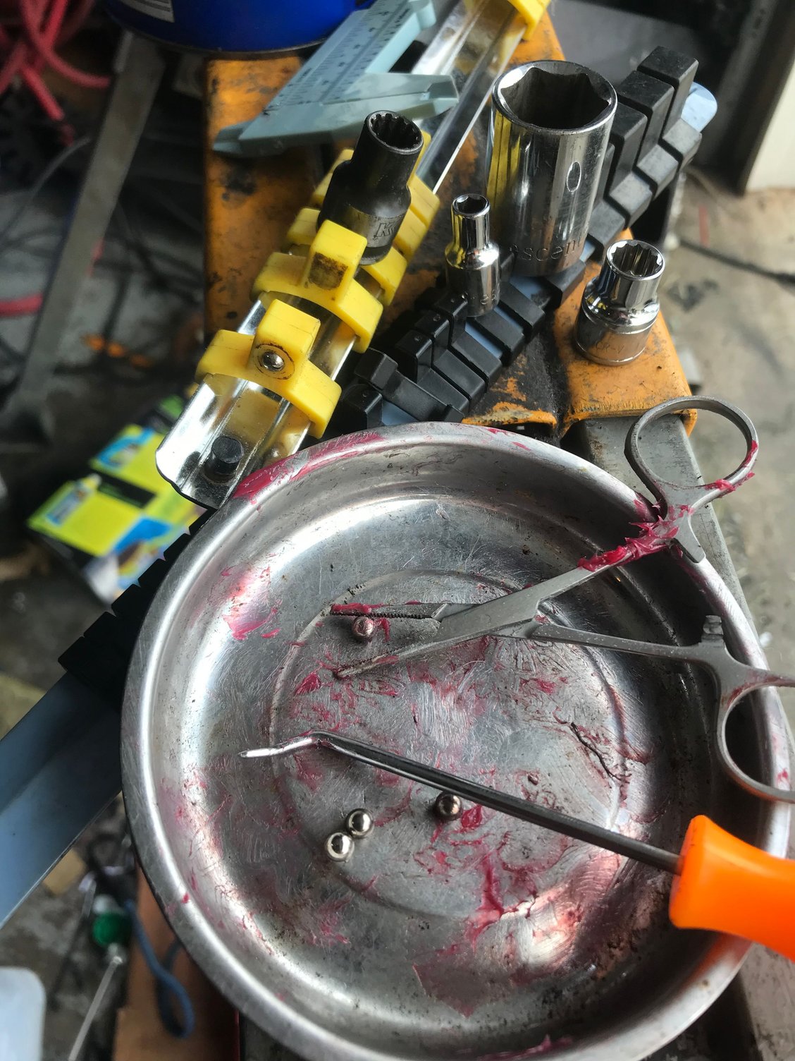

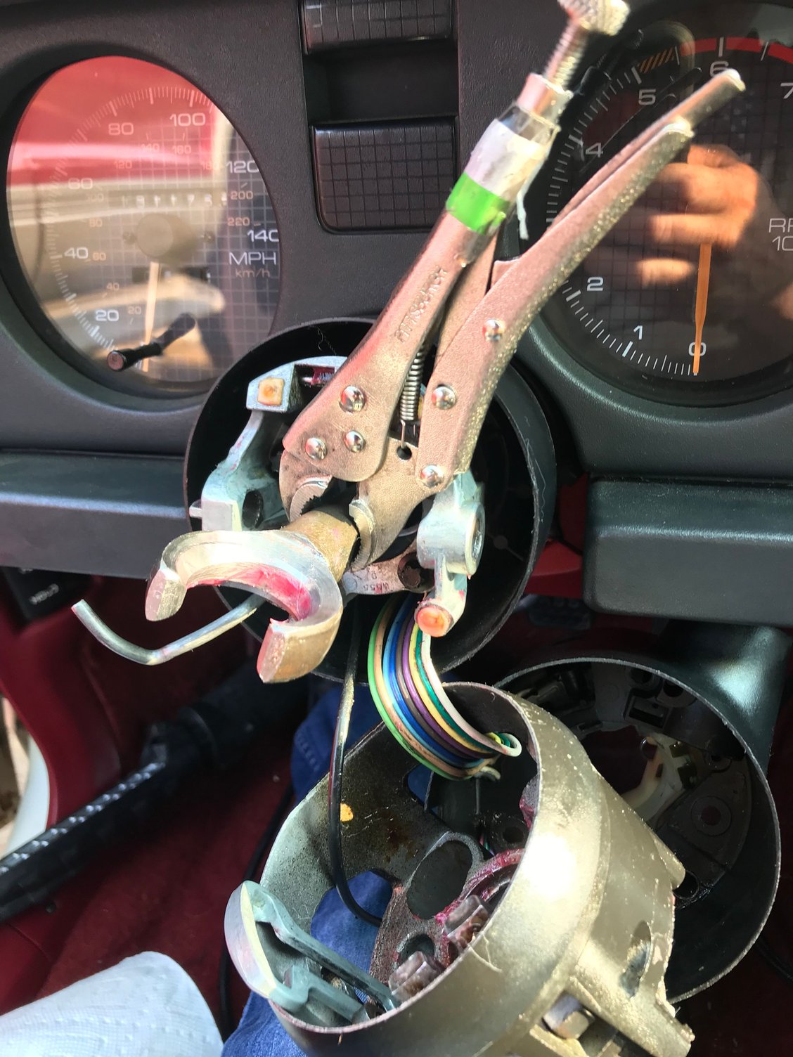

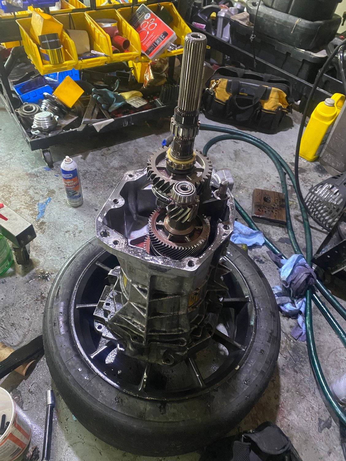

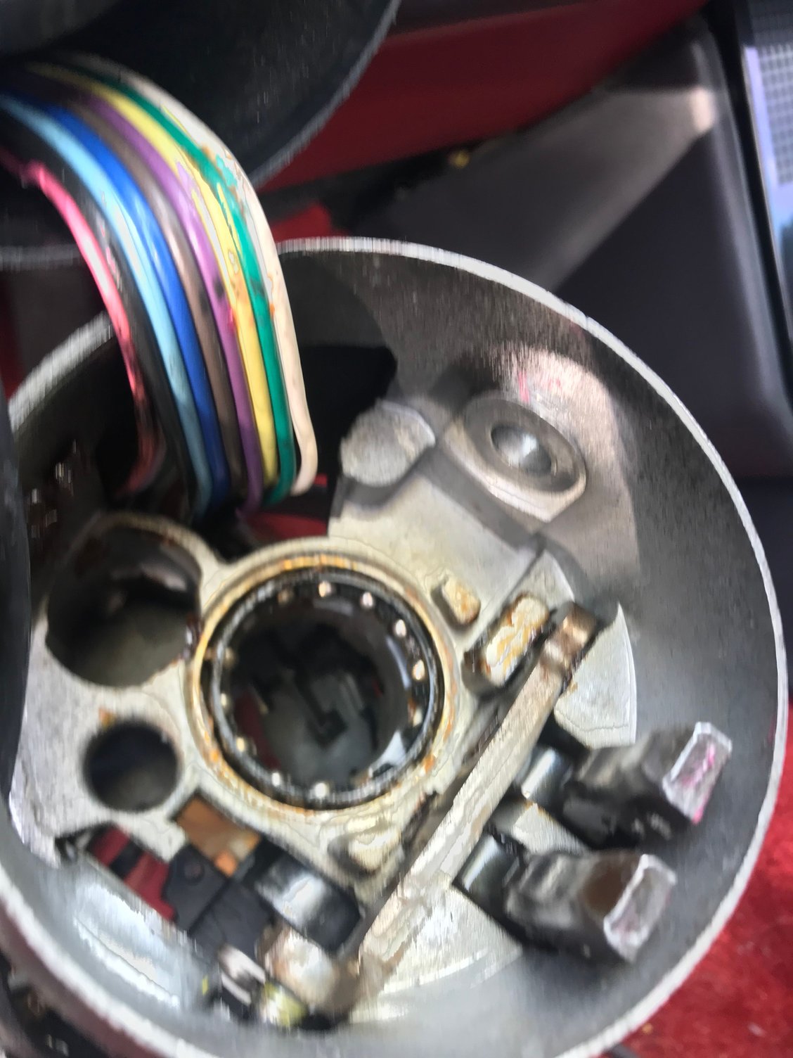

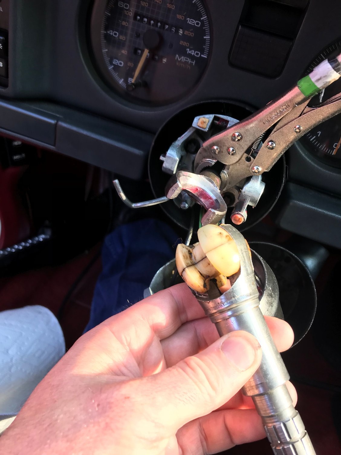

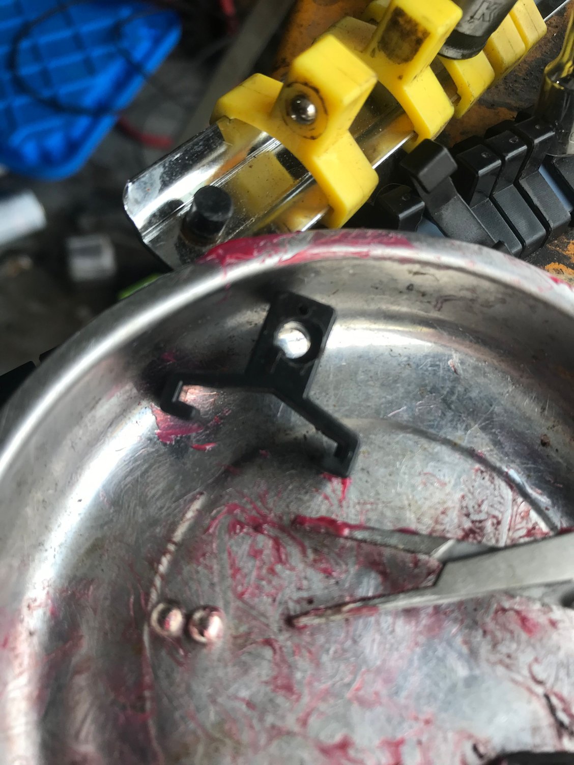

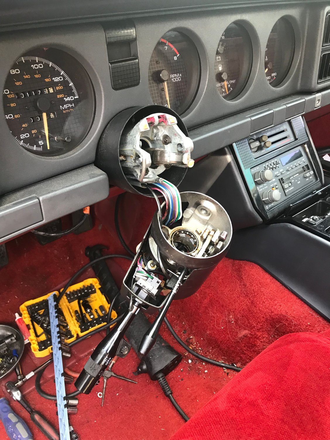

When I started the reassembly process I noticed a couple ball bearings on the floor of the car. Uh Oh…
it turned out that some of the bearings have fallen out of the inside bearing race. This required pulling off the front part of the steering shaft. This required pulling the shaft as far as possible towards you and then hard to the right until the plastic ball joint holding the unit disassembled.
and for good measure, a couple ball bearings fell out of the front race while I was disassembling everything.
I ended up misplacing a ball bearing. As I sat they’re cursing myself I noticed the plastic socket holder next to my magnetic dish. Guess what? That ball bearing is the same size!

Glad you finally got your bearing on this! Your dish looks like buckshot that the surgeon fished out of a wound.

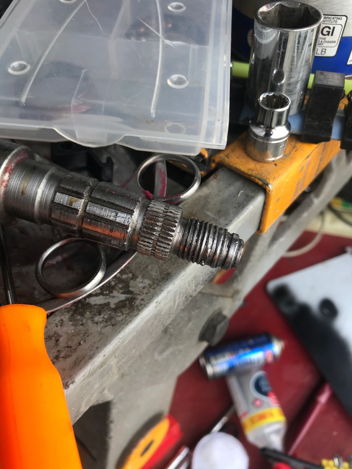

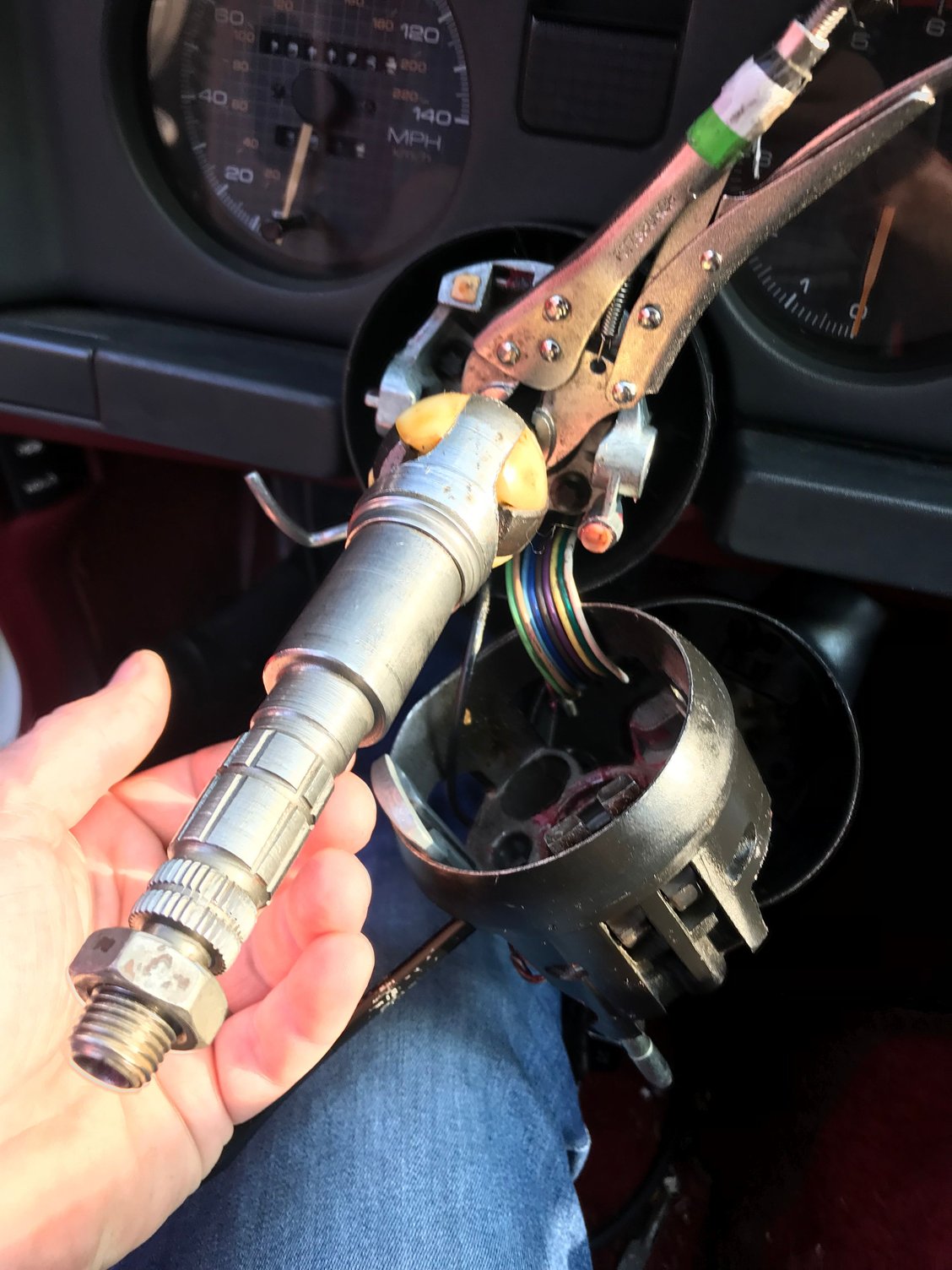

Couple things. The upper steering shaft is keyed so make sure you install it the right side up. Otherwise, your steering wheel will be 180 degrees off center (aka upside down). In hindsight, there’s a little notch on the end of the shaft for which side to put up. But hindsight is not 20/20 and I had to take everything apart to remove the shaft to flip it.
And of course, all the ball bearings fell out again.

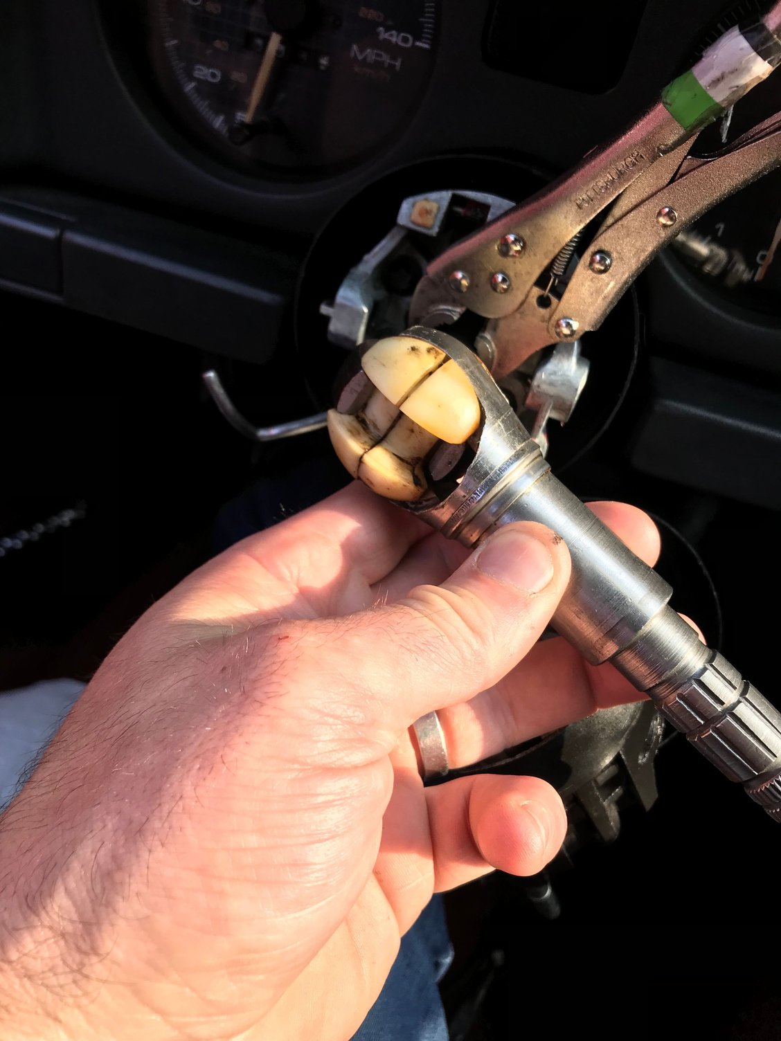

As I was figuring that out I noticed another problem. When I removed the steering wheel nut the shaft threads were damaged pretty badly. I’m still not sure if I did this somehow or if it had been done previously. And with the top half of the threads completely damaged it became apparent that getting the U-shaped tool to the press the horn plate was going to be pretty much impossible.
Rather than mess with it anymore I decided to order another one off eBay. ETA is July 26th.
With so much metal gone from the end of the shaft and the amount of damage on the nut (although the nut was the least of my problems because could I always find a replacement) using a tap and die was out of the question.

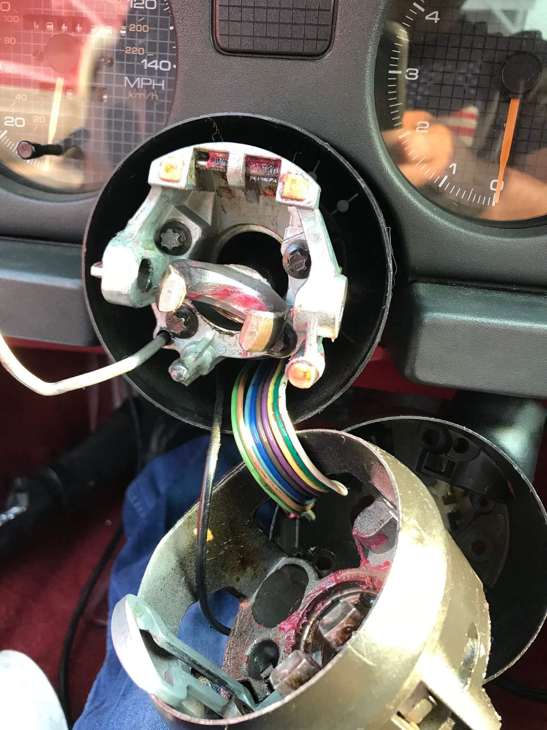

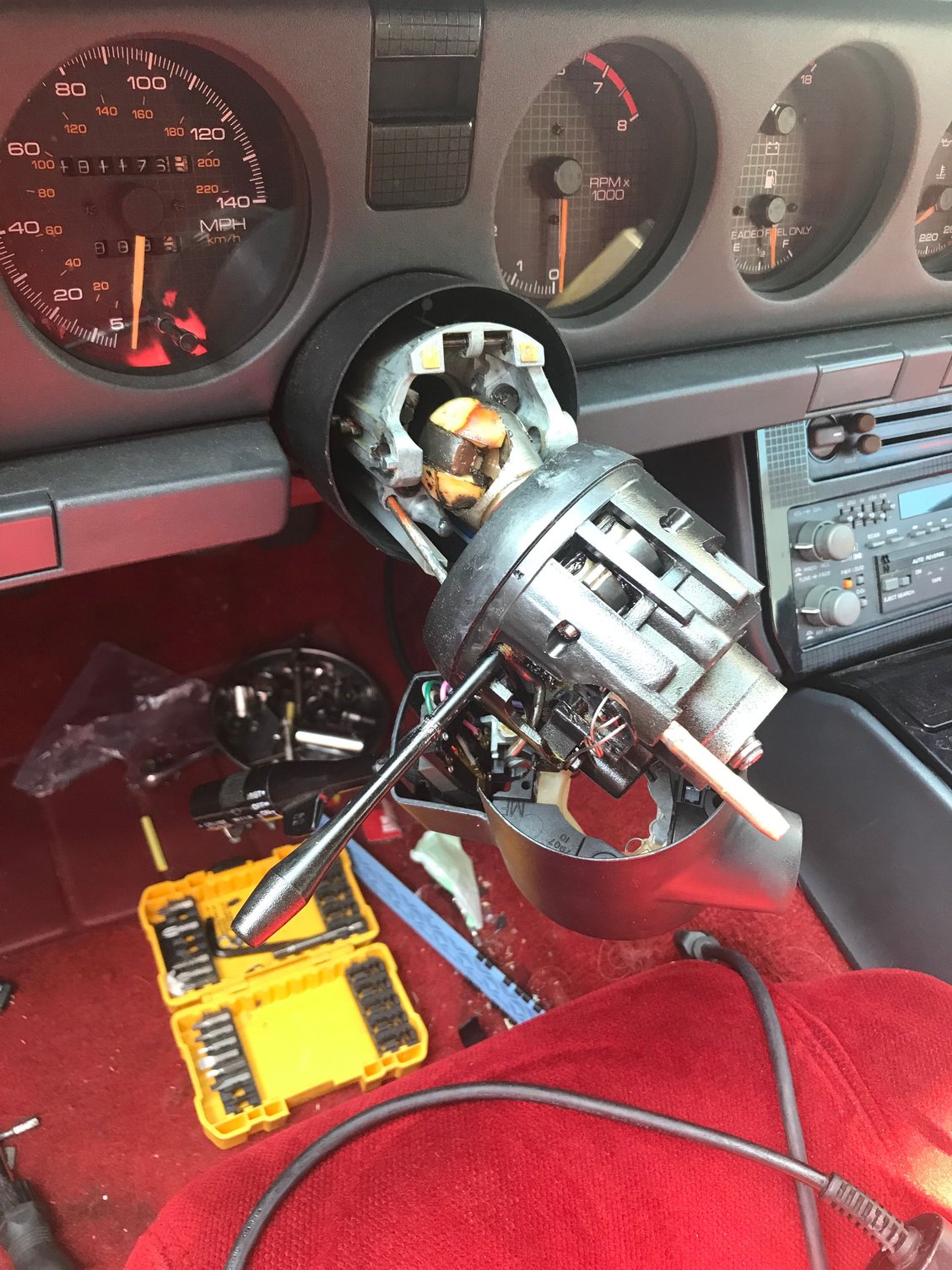

here’s a close-up for the process of attaching the upper steering shaft ball joint. However, if you look at the last picture you may be wondering how is it possible to get the column lock plate and column cover over that shaft. The answer is you can’t.
everything Hass to be done at once. That means The lock plate, column plate, little metal key switch, upper steering shaft, and ball bearings all need to be inserted as a single unit.

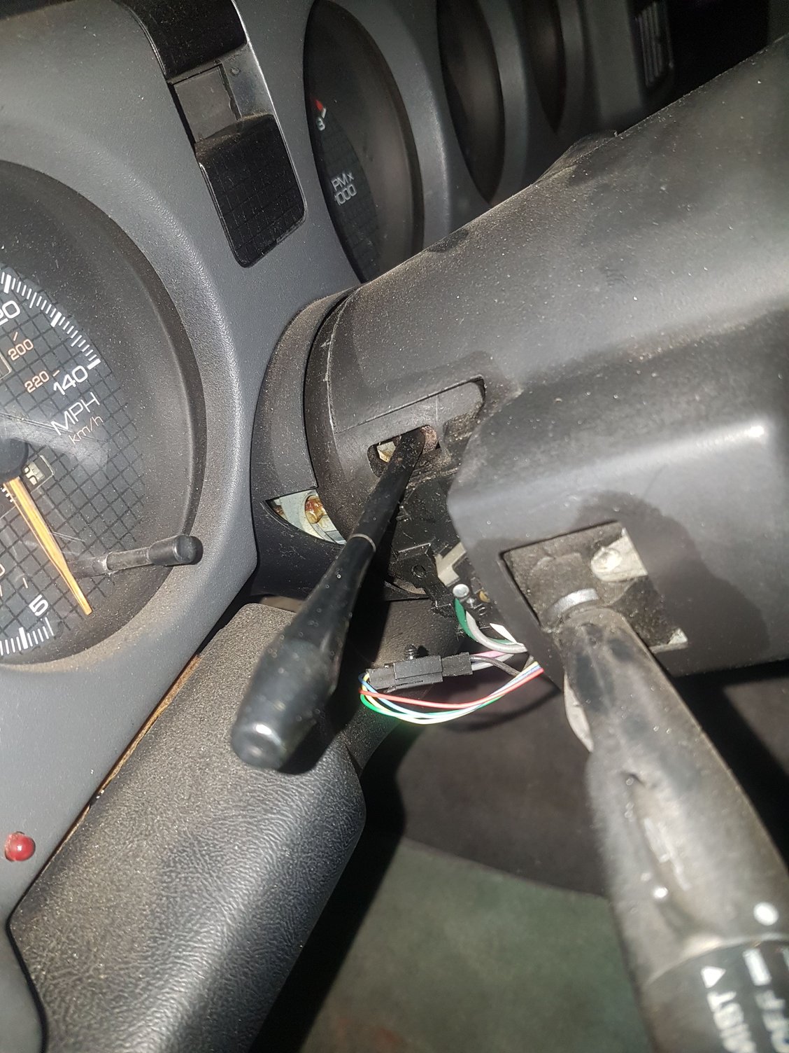

Forgive what may be a stupid question, (and yes there really are stupid questions) but which were the tilt steering fasteners that needed tightening? I really enjoyed your trip up and down the summit. Thanks
the 4 reverse Torx circled are what loosens

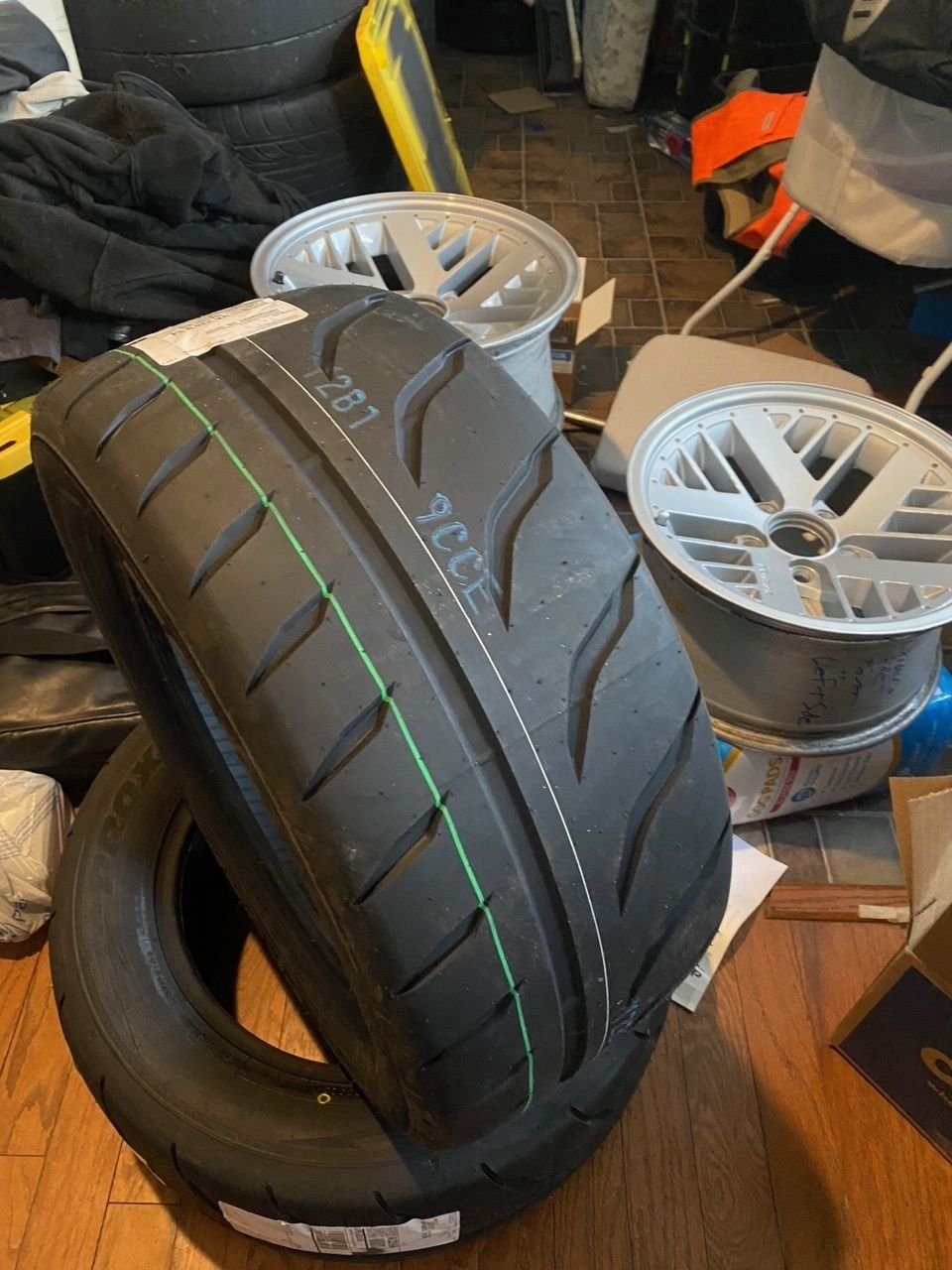

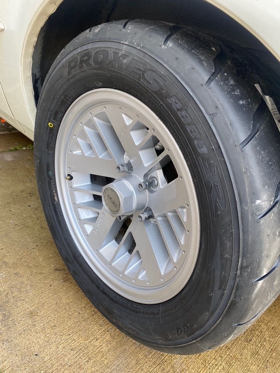

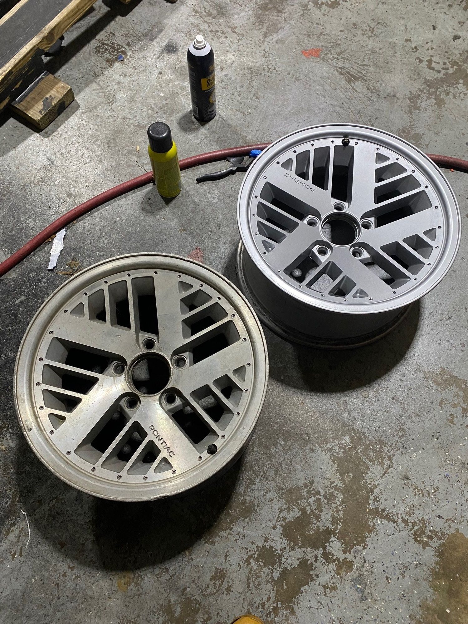

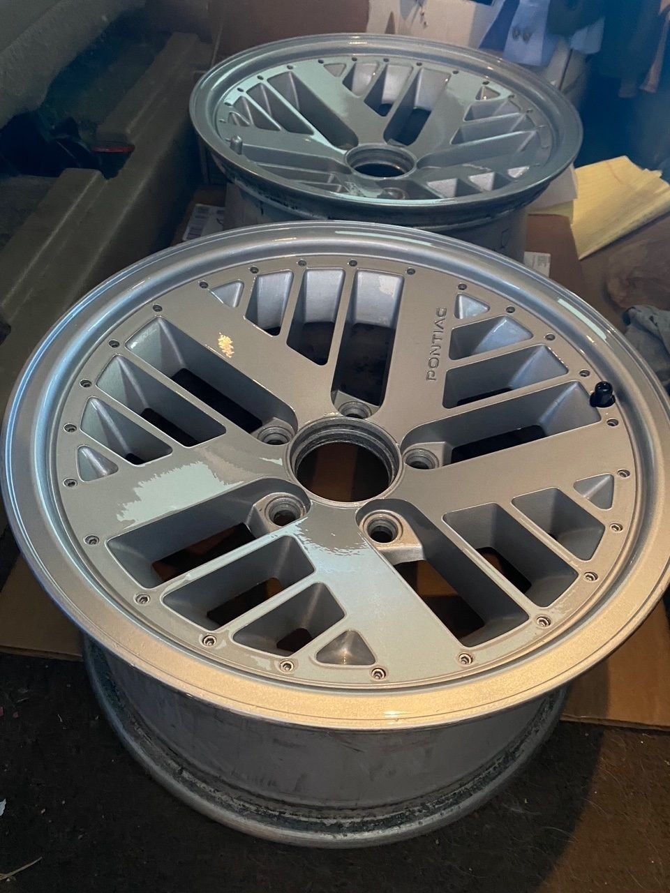

It has been a while since I checked in so I thought I would post.
Lethal Weapon has been running great and is still sharing double duty with the Excursion. She is a little worse for wear in the paint but at least it’s from being used as God intended.
​​​​​​​I needed some rear tires so I took the opportunity to clean up the wheels and add some seriously sticky rubber. And when I discovered that R888R’s were available in 16’s I could not resist.

And TTOP350 please ignore the handwriting on the inside of the rim in the third picture as that was from a while ago.
"Driver side front or left side"
well ? we're waiting! (Ted Knight from Caddyshack)

Rims came up nice!! Those are a badass tire too.
