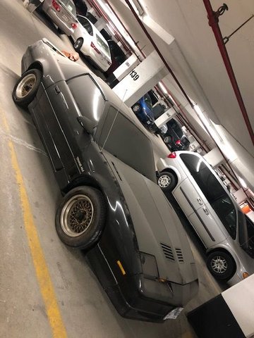

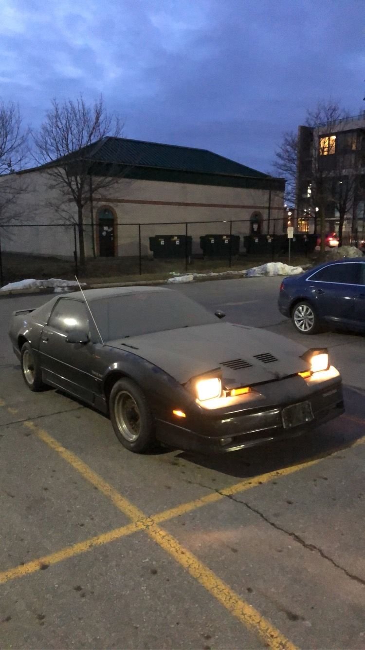

After selling the IROC, and mourning the loss of my GTA, I finally added another third gen to the stable - an 86' Trans Am.
Story goes that a previous owner bought the car as a project for him and his son. Son didn't care, dad got sick with cancer, and the car ended up sitting idle until about a year ago. Person I bought it from purchased the car as a parts car for his 88', but ended up basically abandoning it in his parent's underground parking before ever laying a finger on it. Then I came across it listed as a parts car for $1200, and figured I might as well make the 20 minute drive to see it for kicks. I had almost 0 faith in it being decent, but for those of you who are familiar with my IROC story, you'll understand the thought I had buried in the back of my mind. Sure enough I get there and see a car so covered in dust that you'd barely know it's black, but behind that dust is no important rust, a set of GTA wheels wrapped in brand new tires, a perfect dash, and a full immaculate black cloth GTA interior. Shebang. Then I open up the hood and see a carb'd something that very well could be an LG4 that originally came in the car, but without seeing the SPID anywhere, and not remembering what the vin digit stood for, I really don't know. I've only had TPI's so my visual inspection skills with anything other than such, well, suck. Anyways, the battery was stone dead so I went and scooped a cheap battery from CT, and sure enough that mystery motor blazed right up and ran better than any TPI I've ever had. Put it in gear and it lurched violently like most 700R4's do, so I can only assume that's what was attached to the other end of the shifter. So as of right now, I'm $1200 deep in to a running, driving, solid, excellent looking T/A. I've been battling a hell of a flu so the car is still in the underground until tonight, which is when I plan on sticking plates on and driving this 35 year old abandoned car across 2 cities in a good ol' Canadian blizzard to get it home. What could go wrong?

These are the only pictures I have so far, but I'll take some more tonight. It looks like hell inside right now but it's actually in good shape, just dismantled. Sketchy radio wiring needs to go, I need to find a new map pocket, shifter plate surround needs to get replaced with an original, but otherwise we're good. Wrong steering wheel but I like it and it's in good shape so it'll stay around for now. All of the trim and stuff is in the back seat and trunk, and I'll be putting it back together as soon as I have some free time. First order of business is get it home, then give it a BATH, then start the check list of third gen issues and see what this ol' girl needs.

It looks like a great starting point and for $1,200, it was a great buy! You might want to find a friend with a trailer.......old gas, old fuel pump, what could go wrong on the drive home😜

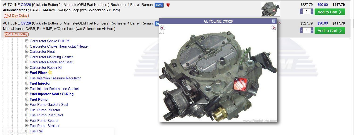

Do you have a pic of what stock valve covers look like on an LG4? I remember the ones on this car looking like they came off a 74 Caprice. This motor doesn't excite me regardless of what it is, but I am a fan of originality, so I'm sort of hoping that it is.
Not handy, but an LG4 would probably have the typical basic steel valve covers with all the welded brackets for wire looms, etc. They'd have been painted black by then. Blue would be 82 and earlier, they were Orange until 75 or 76. 85-86 TPI engines had the nicer silver valve covers. Can't remember at the moment if the CFI or L69 cars had anything other than the standard black steel covers.

So we've uncovered a few small demons. Not really too concerned considering I can re-coupe my money in the wheels and interior alone IF I decide to sell it. Went to pick up the car last night and this time it decided to run like absolute garbage. Super rich with a heavy smell of gas and dark exhaust. I thought that maybe I flooded it while trying to start it, but it never really seemed to level back out. With the idle so low and choppy, I didn't want to harm anything by keeping it running so I just had it towed back to my shop. Anyone have any ideas? I know they're fairly simple but I have very little experience with carb'd motors, so any guidance is helpful!

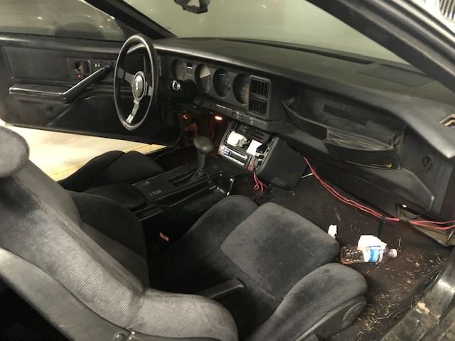

Another thing that I uncovered is that well, the floors are gone. Or at least the front sections. When the car was up on the flat bad, I took a better look underneath and sure enough, a square foot has been cut out on both sides, with a patch of sorts covering it up. I was so damn sick when I first looked at the car that I didn't really crawl around underneath, so it's my own fault. I don't really care though honestly as the part that was cut out should be a cheap and straight forward repair, and the rest of the underside looks really good! I'm going to lift up to carpet when this snow stops and see how the patch looks, and who knows, it might be usable.
#3, which is the only thing that I'm genuinely nervous about, is that it looks like someone has done a lot of poor touching up of the paint. The car still has 3 inches of dust on it, but when it was up on the flat bed, the lights were exposing a few mysteries under the dirt. As soon as the car get's a good bath, we'll see how the paint looks and decide whether or not to cash out on a quick flip, or spend some money on a good paint correction.

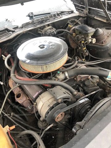

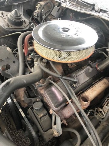

Anyone able to help identify this motor?

Bet its an LG4 but who knows on a 35 yr old car. Id pop a valve cover and see what # is on the cylinder head. Maybe you will get a surprise and see that its been swapped to a 350. Will still be a cheap and pretty straight forward swap to a 350 down the road that's the good thing about these LG4 cars. Very cool car I think you got a good deal for sure!

does the motor have a number on it?

I don't see a MAP sensor on the cowl flange. So it's non-comp controlled or wasn't a carbed car from the factory... LOL
Check the VIN, 8th digit is an H for the LG4.
To figure out what it is now, you'll want to find the casting number behind the head on top the bellhousing. Pull a VC and get the casting numbers off the head. Finally check the stamped pad in front of the passengers head under the alternator. If the partial VIN behind the alternator matches the VIN on the car, it's the original engine. You'll want to check all three numbers and potentially both heads since it's not terribly uncommon to find a previous owner mismatched the heads, or changed the short block, but not the heads, and some rebuilds remove the stamps.

Looks like you have some turbo manifolds missing turbos

Does seem odd to see heat stoves on both manifolds. From what I can see the car is well worth some time and money to get decent.

Did the dual snorkel air cleaner have stoves on both sides ?

Were LG4's available from factory without ECM's? If so, assuming this IS the original 305, then score. I tried to pull the car inside to give it a bath on Friday and it didn't even make it up the little ramp to our bay door before shutting off and refusing to stay running again, so I've got a tech taking a peek at it to see if anything comes to mind. I'd really like for this idiot to at least run well enough to drive around again like it was before. Poor thing is just stuck outside with the ttops leaking like a faucet
Old Mar 2, 2020 | 11:02 AM
Drew's Avatar
iTrader: (58)
Posts: 20,310
Likes: 1,067
From: Salina, KS
Re: New Addition - 86' Trans Am
In Canada, yes.
Magic 8-ball points to a carb problem. In some ways a carb is simple, in other ways it's a massive mechanical Rube Goldberg device, and any part that doesn't work exactly right can cause major problems. The beauty of it is it's self contained. The trouble is new cars haven't used them for nearly 40 years. Most of them are old, worn out, and no one knows how to work on them. Best running Q-jet I ever had was a brand new replacement. Ran beautiful, pump the gas once, bump the key and it was running. Last one I had, must have had three different used Qjets, made one 'good one'. It ran pretty good, but I never did get the choke to work exactly right. Pretty sure it was a combination of wear and lack of experience. Took the rest of the parts and had a local carb guru build another 'good one'. Put that one on a buddy's car. Ran perfect right out of the box. I presume it'd still work perfectly if he ever drove the car, but it spent too much time in storage and began having starting problems after a couple years. Ethanol gas doesn't help.
Old Mar 2, 2020 | 11:40 AM
RKeats's Avatar
Joined: Feb 2017
Posts: 608
Likes: 147
From: Oakville, Ontario
Engine: 5L TPI
Transmission: WCT5
Originally Posted by Drew
In Canada, yes.
What about how the car ran perfectly when I first saw it, then starting running like garbage when I came to pick it up? It wasn't touched by anyone in between, so what do you think could be happening? Could it literally just be the fact that it's been freezing cold every time I've tried to run it?
Old Mar 2, 2020 | 01:18 PM
WildCard600's Avatar
In my experience with 25+ years of carbed motorcycles, If they have been sitting for a while starting them up (and it runs fine) can break junk loose in the carb and when you go back to run them again later it's a struggle. Like Drew said, old worn out carbs aren't going to do you any favors either. Sometimes the stars align and the worn dirty parts work perfectly, other times they will fight you every step of the way.
I'm not sure what your plan is for the car, but it might be worthwhile to either get a new replacement carb or have the current carb rebuilt before taking any additional steps forward.
Old Mar 2, 2020 | 01:59 PM
  #42
Drew's Avatar
iTrader: (58)
Posts: 20,310
Likes: 1,067
From: Salina, KS
Ethanol gas has a habit of turning into gelatinous goo that attacks surfaces. It's possible you sucked something nasty out of the tank or fuel lines into the carb, or from the fuel bowl of the carb into the metering passages. You can try fresh gas, cleaners like Sea Foam, spray a few cans of carb cleaner all over inside and out the carb, try to knock any crud off and out. It could work, or it might not. You could also have flexible rubber bits like the accelerator pump seal that could have dried out and gotten hard from age and exposure, that could theoretically have worked fine the first dozen times you hit the gas, but now the lip may have torn or cracked. Or the float could have decided to sink, or the needle and seat could be blocked by some flotsam and jetsam. There are just so many ways to make a carb not work properly and only one way to make it work perfectly. But look at the bright side, there aren't 8 injectors, or a dozen sensors, or a computer with less tech than an Atari 2600 under the dash, so there's that.
If you do replace the carb, you may want to make sure the tank is cleaned out, the fuel lines too, replace any and all filters, etc so that you don't accidentally just pump more trash into a new carb.
Old Mar 2, 2020 | 02:31 PM
  #43
RKeats's Avatar
Joined: Feb 2017
You guys are awesome. When the weather breaks, I'll go out and identify exactly what carb is on there now, and price out a few options. Can't imagine a basic replacement or rebuilt would hit the wallet too hard. Any suggestions as to a good replacement for general driving? Assuming this is an LG4 of course. I see a lot of Holley suggestions, but I'm not familiar with specifics
looks like LG4 my 87 had when I bought in 91
Drew you did it again good thing I didn't have just taken a drink- It woulda been spat out LOL! I was thinking wash it off
Nice score Keats I wanna see what you do with this one
A stock replacement Qjet for a Canadian LG4 would hit the spot. Or back up to about a 1980-ish car application. Go too early and the fuel inlet changes, trucks have the vacuum secondary can on the back, get too far off and the earlier carbs don't have the fuel bowl vents for the charcoal can, etc. Assuming the car is a 700R4, the canadian spec carb would match up best with regards to the TV cable linkage.
Holley made a bolt on replacement for the Qjet. They're not terribly common. The typical 4150/4160 Holley 4bbl is a square bore, like an Edelbrock, and usually requires an adapter/spacer, which then requires a funny air cleaner to fit under the hood. Not to mention the spreadbore Qjet will get better gas mileage. Holley made a spreadbore 4bbl that's styled like the 4150, but aside from matching a spreadbore intake, everything else still hooks up differently. Having been down the Holley to 80s sbc adaptation road, it's much easier to stick with a Qjet.
Carburetors really don't like to be left sitting without being run. Probably crud in the float bowl got knocked loose when you started the engine, and is clogging things up.
Trying to find a stock replacement carb is going to be difficult; with all the production changes that occurred through the model years, there were many variations in those old Qjets. And replacing one with an aftermarket carb is also an issue, especially regarding the linkage/TV hookup/vacuum lines. The old Holley 'spread bore' replacement, while it would actually directly bolt onto the intake, left the linkage hookup (they supplied a bag of all kinds of hardware to "adapt" the linkage of many GM cars) up to the fabrication skills of the car owner. Adapting the factory air cleaner was also another hurdle.
IMO, the best carb for that engine is the one on it now; find a rebuild kit (I know; it's gonna be tough), and go through it. If the carb has never been previously disassembled, there should be a metal tag with the specific part number of the carb attached to the carb top plate by one of the screws. As has already been mentioned, you'll also need to deal with the rest of the fuel system before you run the engine on the rebuilt carb.
GL with your parts search; that car is definitely worth the effort.
I would have thought so too, but pulling up an 85 Camaro with a 305 on Rock Auto and scrolling through the carb options, right there in the options is a Qjet for an auto trans without a solenoid which would be non-computer controlled. Not exactly cheap, but given everything not exactly expensive either.
Old Mar 3, 2020 | 11:30 AM
The beauty of paying $1200 for the car means $400 doesn't really do any harm! That's a reman though, so I can likely have mine rebuilt for significantly less. I've already come across a few places that are knowledgeable with the qjet's, it's more a matter of figuring out what's actually in my car. It's pounding rain today but clear and fairly warm tomorrow, so when my passenger seat is done getting a nature bath from the ttop faucets, I'm going to dive in to the car and figure a couple things out.
