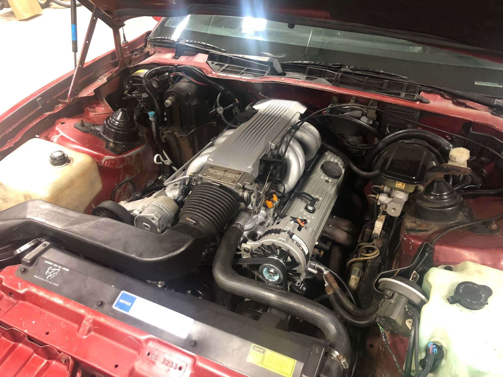

Fast forward 5 hours and I'm back home and I am getting curious why this thing is idling all over the place so I decide to pop the hood and get a look see. I knew what I should see but when I open it up I was greeted with what appeared to be an 85-87 setup. As I looked it over I noticed a MAF sensor and was thinking it was interesting they put that MAF sensor in and the connector still in it. Looking closer I notice its not a cut off connector in it and is connected and now I'm baffled. Well further inspection finds a 1987 5.7 swapped in with everything, literally everything from the older car. Engine, intake, engine harness, ecm, everything. I had to think about this since I'm not sure of what I was going to do with it. I found a harness from a '90 and picked that up thinking I may need it later.

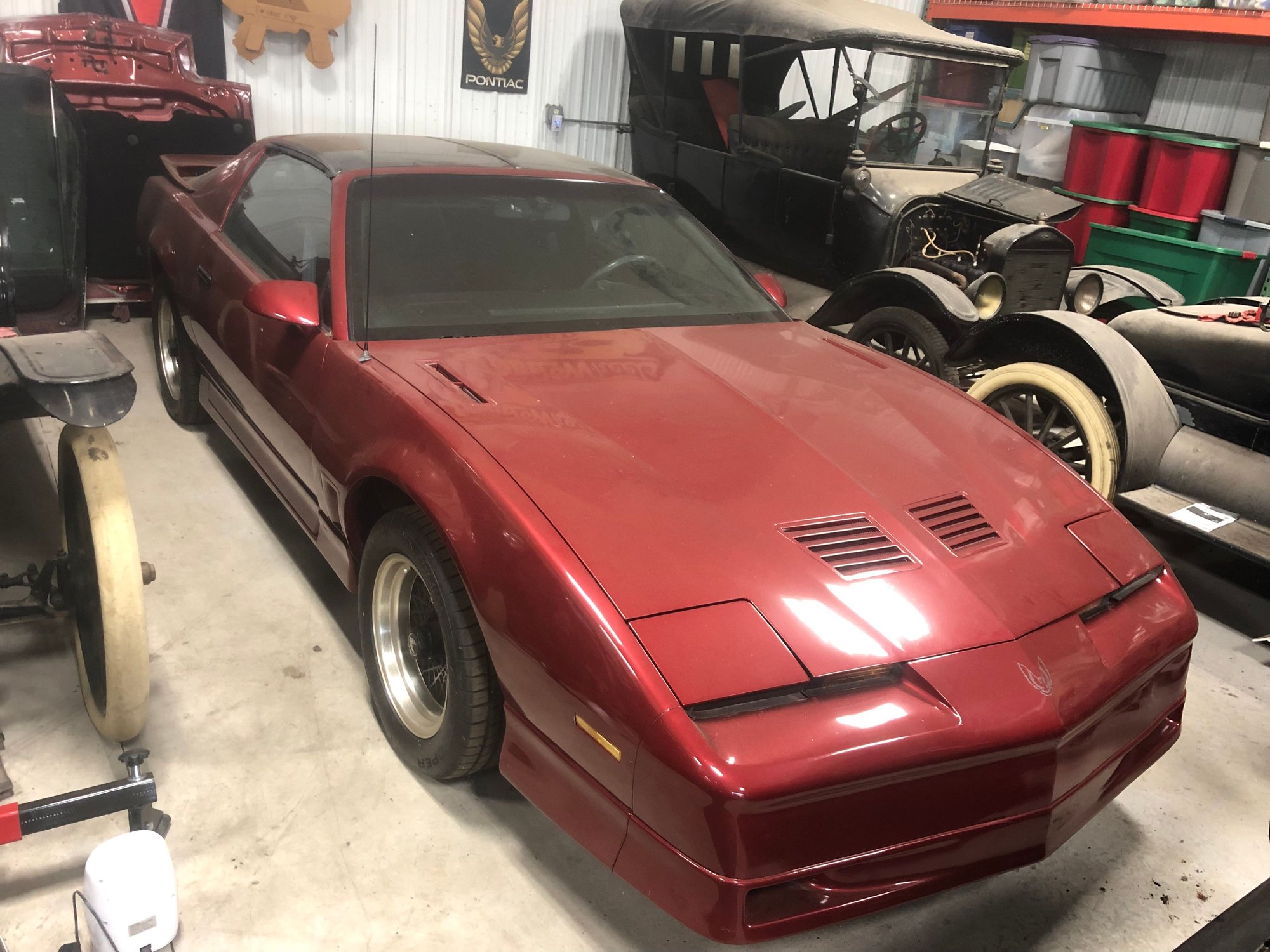

I drove it into the shed and there it sat for the better part of the last three years.

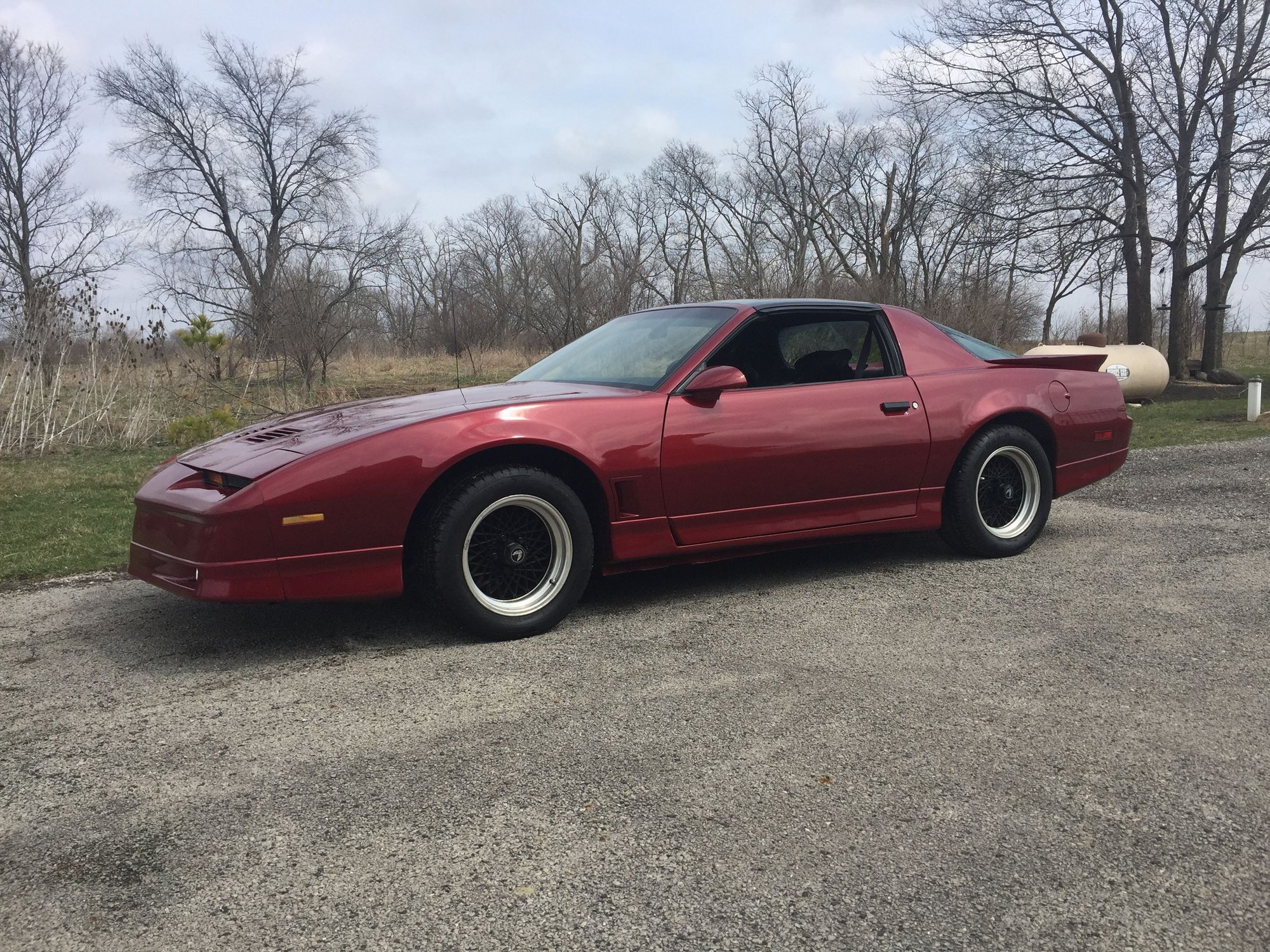

Fast forward to this summer, I commit to make a decision if I will keep or sell so out it comes for a wash and a look (I finally looked at it). The paint is shoddy at best but its not horrible for a daily driver and it takes decent pictures.
The idle was the least of the issues when I dug into it. The fact that it was running at all is impressive when you see what condition the wiring is in. I **** you not, there were wire nuts in there. So I try to get the existing harness cleaned up but the more I find the worse it got. The fans were spliced in the ignition wire and overheating the ignition switch, there was some random phone wire going under the seat not connected to anything. There were things spliced all over and I think it took me 20 minutes to throw in the towel and swap in the harness I had purchased a few years earlier. Once I started I decided to get this thing back as close to its former glory as I could within reason. I went on a shopping spree to get all of the '90 underhood pieces that were missing and was surprised on the prices people are getting for brackets pulleys etc. but I managed to get everything I needed. I wasn't going to get a 305 to put in though, I figure Ill run the 350 until the trans gives up. I spent a few weekends getting everything corrected and running, last thing being the tune since I deleted the AIR and EGR. Once running, it was purring like a kitten. Whatever the idle issue was it was gone now so that was good.

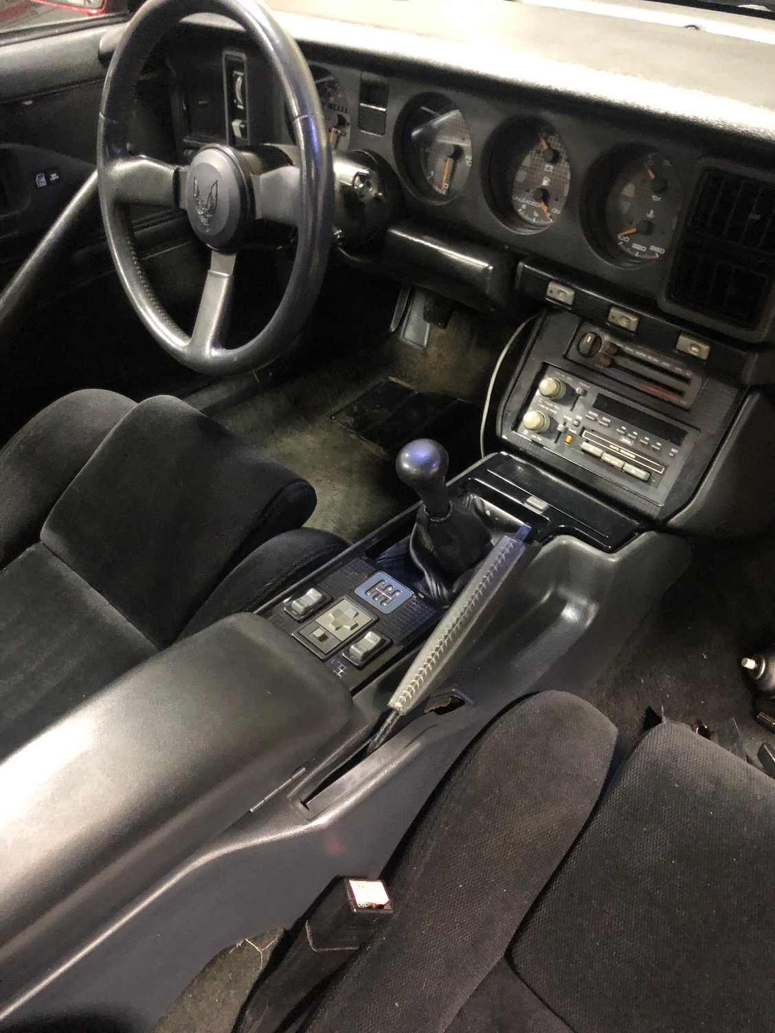

I had some seats from a GTA i parted a few years back sitting on the shelf so I got rid of those Procar seats. The airbag was all warped and hanging out so I got the wheel from the same car as well as a standard Firebird horn button. The console was pulling away as they all do so I got some gorilla glue and got that looking decent. The shift plate was actually an automatic shift plate that was modified to fit a shift boot. Now I don't think this was an auto to begin with, it seems the PO had a donor car since it had a SPID in the console that was not matching.
The paint is marginal at best. There looks to be very poor prep done, you can see sanding marks and dust. The clear seems to be hazy and only gets so much gloss but it's good from afar but far from good.
While I don't have AC installed yet, it will be before next summer and the verdict? I have put quite a few miles on it in the last few weeks and it has been a blast. I don't have to worry about paint or finding 100 octane gas. It is a 5 speed so that makes it fun as well and it fires up every time and just works. I think I'm going to keep it. Its a great driver now and actually runs very good. I believe there is a rear main leak but that's not a big deal and would give me an excuse to detail the engine compartment a bit. It will probably get shocks and struts this winter and I definitely need to get some 30% on the rear window but for the most part I'm going to leave it basically stock and enjoy it as is. Is it a show car? Double hell no, not even close. But it is a great driver and that's a great thing.
