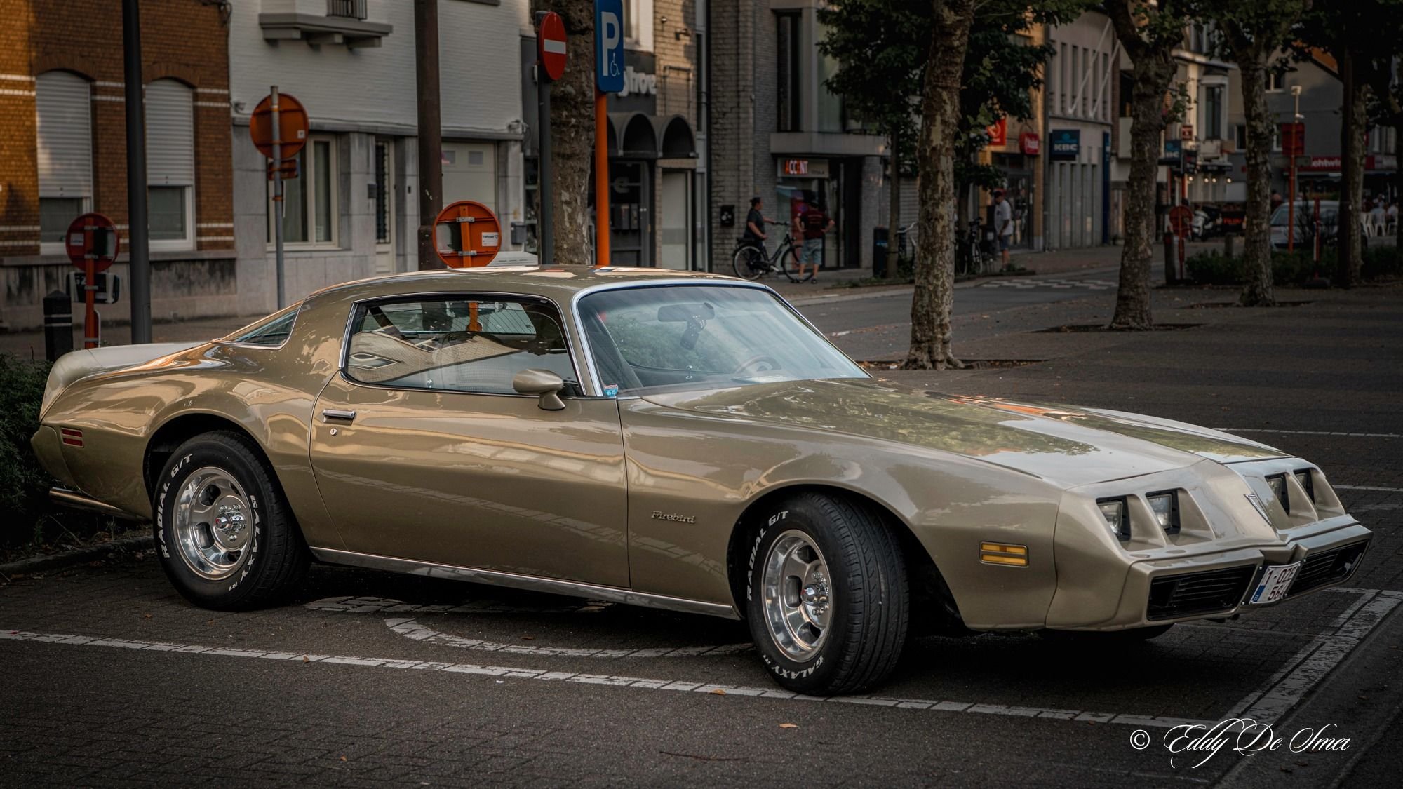

My 1980 Firebird 'floats' over the asphalt when I'm going just 56 mph. The engine was replaced by a reconditioned 1965 Corvette 327 (350 hp), new headers, naft pump, oil pump, carburator, power steering pump, I have new rims and tires (255-60-15), thicker saybars front and rear, new shock absorbers and leaf springs, 2500 stall converter, basically everything is new, neatly aligned and all. Yet the car starts to 'float' at the front at 56 mph. It becomes dangerous to steer because the steering wheel feels much too 'light', just like the power steering is working too hard... Now the 327 is about 3,14 inch shorter and 30pounds lighter than the 301, but that would normally not be a problem. So what can it be?? Help!
