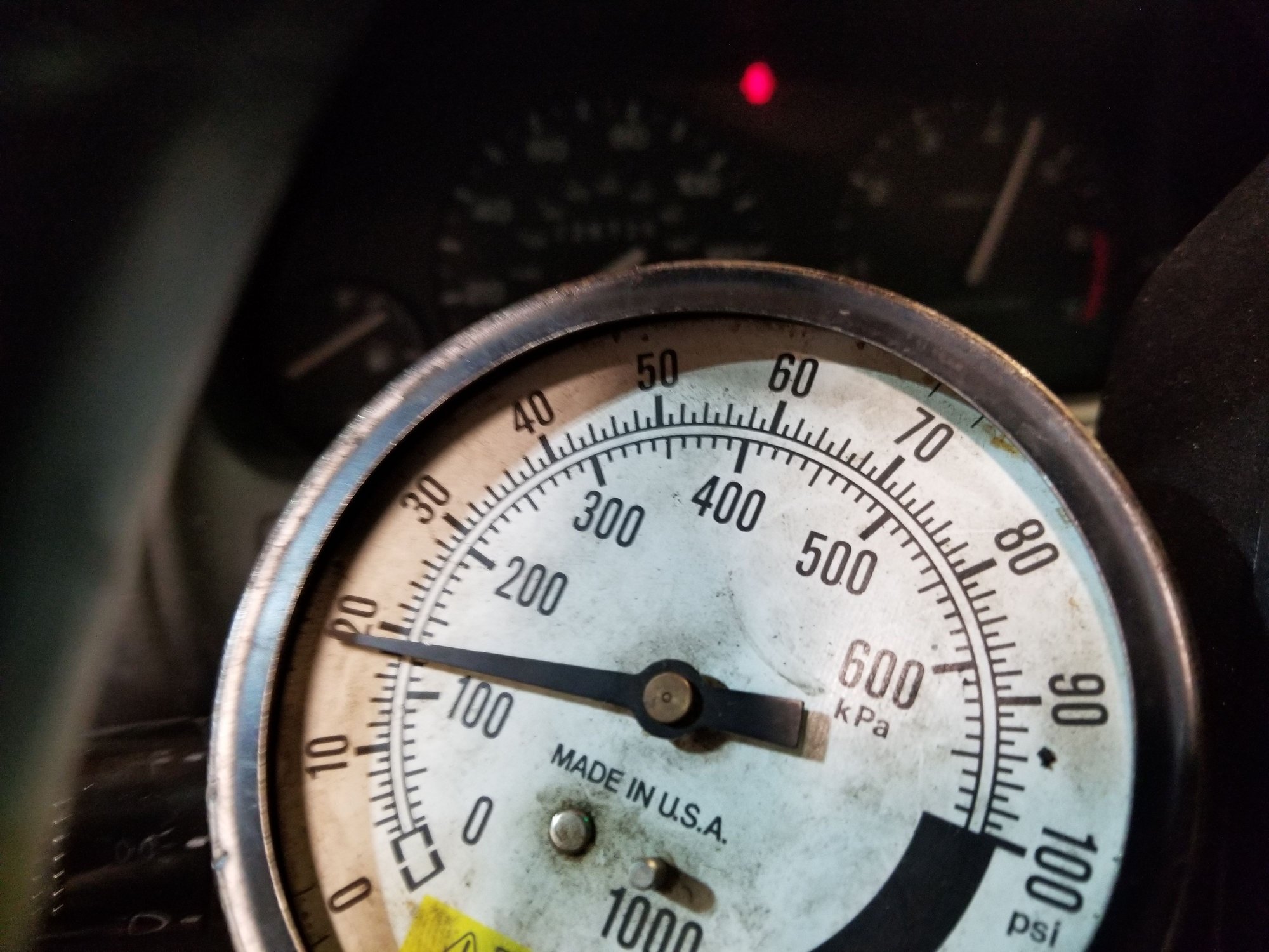

I had a hunch, so I ran a quick test; one that I've done before with conclusive results. I pulled the front O2 sensor, and screwed a compression tester hose into the bung, then slipped a long rubber hose over the end of that hose, and ran it into the car....and I hooked a fuel pressure gauge to it. Fired it up, matted the throttle in neutral....
....saw a peak of 22 PSI. BAM. THAT is the problem, and it was pure coincidence that the symptom started at the same time that I did the timing belt! Sonova!

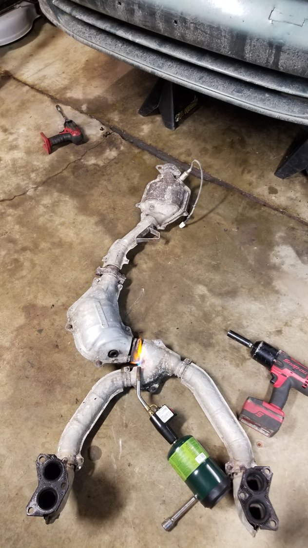

I dropped the exhaust and separated the cats. Now, if @Fast355 sees this thread, he's going to be devistated that I didn't use goat **** on the rusted, 30 year old exhaust flange bolts! Nope, I committed a master tech faux pas and just used boring old HEAT to get those rusted, stuck nuts off...and....it worked!! Whaaaa??.....
Got that front cat apart and found this on the inlet side....
DOH!! ^That^ don't look right! Here is the outlet side....
...and there was my "timing belt problem".
Rodded that out, slapped it back together and got my ~40hp back. Hope this was an interesting read for other Rocky Mtn area members. Remember, when diag isn't making sense, think to yourself: "Something is going on here..." Start looking for other likely possibilities.
