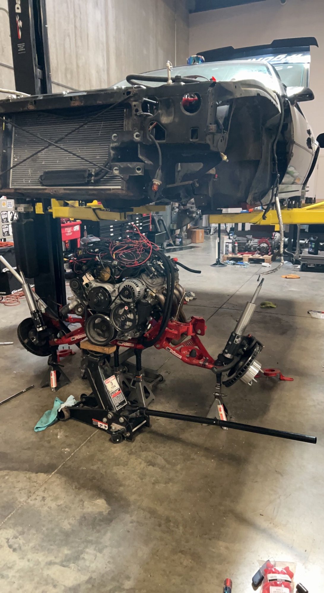

Hey everyone. Just wanted to start a thread to document my Pro-Touring ‘84 Z/28 build/ re-build. I originally bought this car at just 15 years old and spent that winter rebuilding it. A list of some of the mods I did the first time I did the build:
  • Full UMI suspension/Viking struts and shocks
  • LQ9 block LS3 heads with comp valve train making 470 whp
  • T56 magnum transmission
  • stock 10 bolt with upgraded internals
  • C5 corvette brakes
  • Forgeline wheels
  • Turn one 10:1 steering box
  • 6 point roll bar
  • Many other mods
I brought the car out to Goodguy’s Iowa and did decent considering I didn’t have time to setup anything suspension wise, and made the rookie mistake of having my brake calipers mounted upside down leading to a very spongey pedal. Just a few weeks ago the stock 10 bolt finally gave after one too many burnouts. I’ve since decided to tear down the car once again and start the second rebuild. I have a very tight time goal for getting the car done which is about April-May. A list of the planned mods for this winter:
  • Lower weight/better distribution
Set motor back all the way
I already purchased a front tube chassis for the car and that will drop about 50ish pounds.
I’m also planning on doing a one piece fiberglass front end for the car along with a fiberglass hood too.
Lexan window in the rear too.
  • motor
408 CID LQ4 block with LS7 RHS heads. About 660 hp NA
An accusump will be installed as well to help with oil starvation oils on the road course
  • fuel
Fuel cell in the rear of the car and all new braided lines
  • Interior
kirkey seats
custom aluminum dash
10 point cage that will tie into strut towers
all new wiring
firewall behind driver/passenger since most of the sheet metal will be cutout in the rear of the car
  • rear end setup
Most likely 9 inch rear with stock torque arm geometry
This is just a basic list of many more mods to come. I’m planning on running events like OPTIMA USCA, LS Fest, UMI Motorsports Park, Gridlife, Goodguy’s, Motorstate Challenge, etc. I’ll try to post on here as regularly as I can with every change I make to the car. I’m a 17 year old senior in high school so time and money is valuable for this build. Currently, I’ve gotten some basic things for the build ordered and I’ve just been working on stripping the car back down once again. I’ll leave some pics below of the car in its current state.

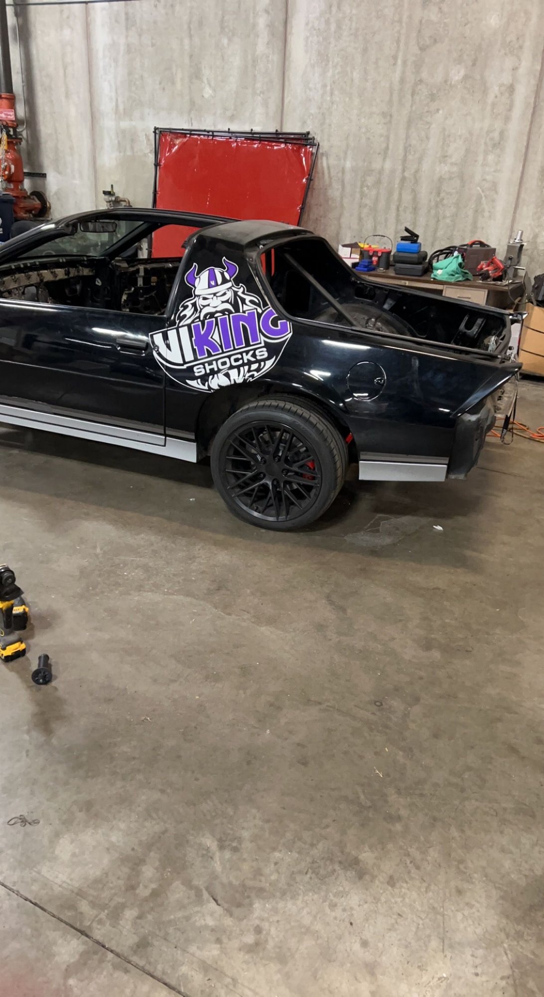

So glad you kept the original look. Rear spoiler still there, tail lights (I'm guessing), hood, ground effects. Gorgeous car.

But I guess if you go fiberglass that will not be the stock gfx style anymore. So be it. Beautiful car either way.

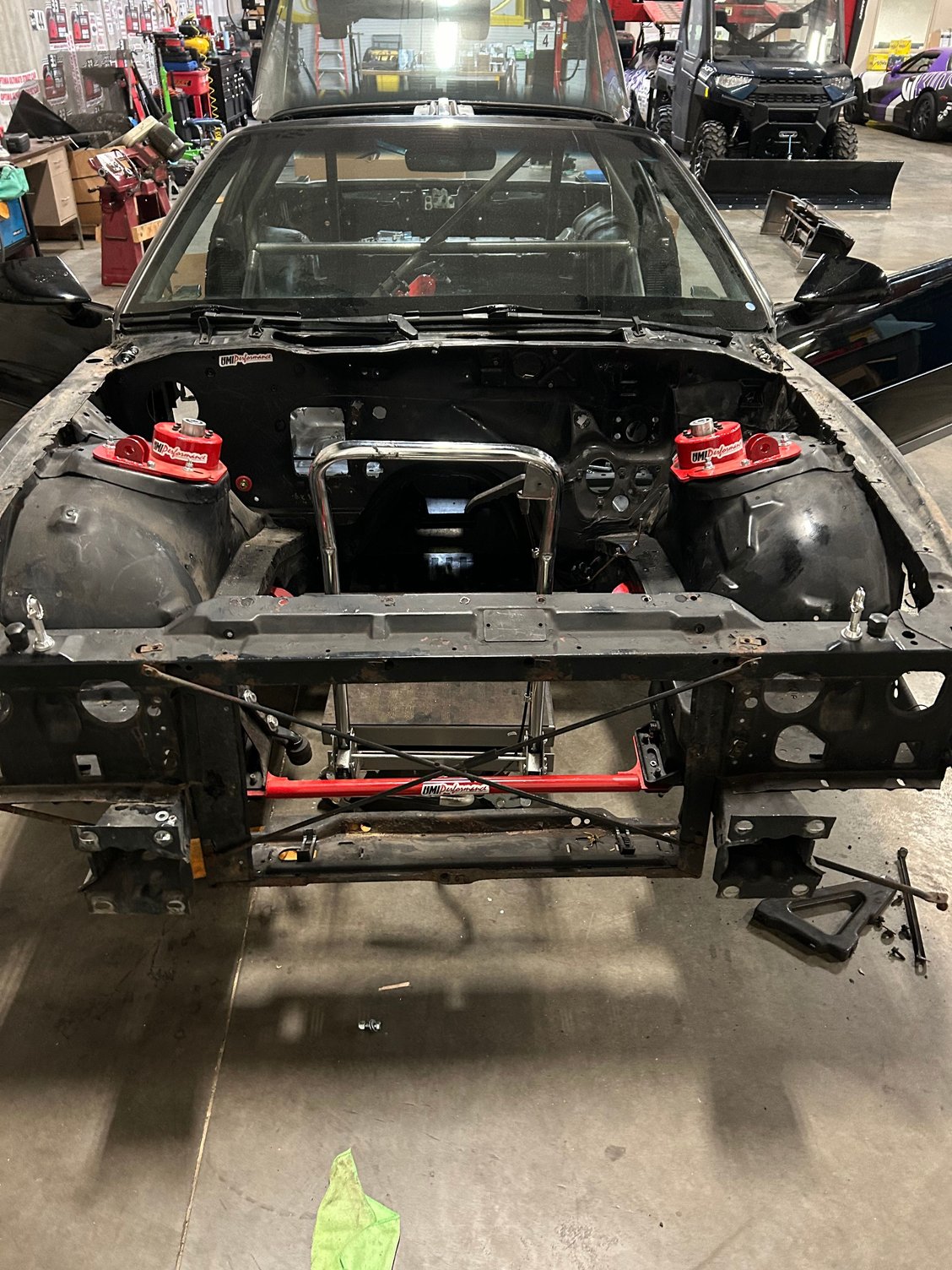

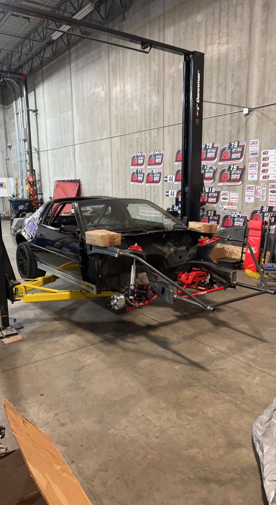

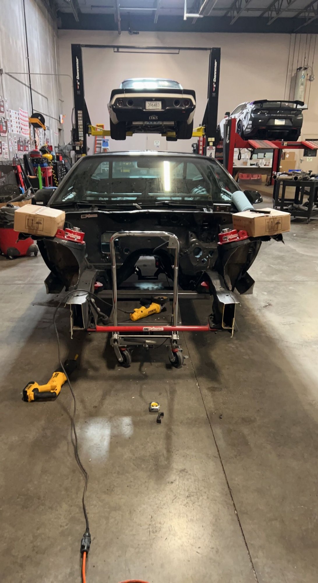

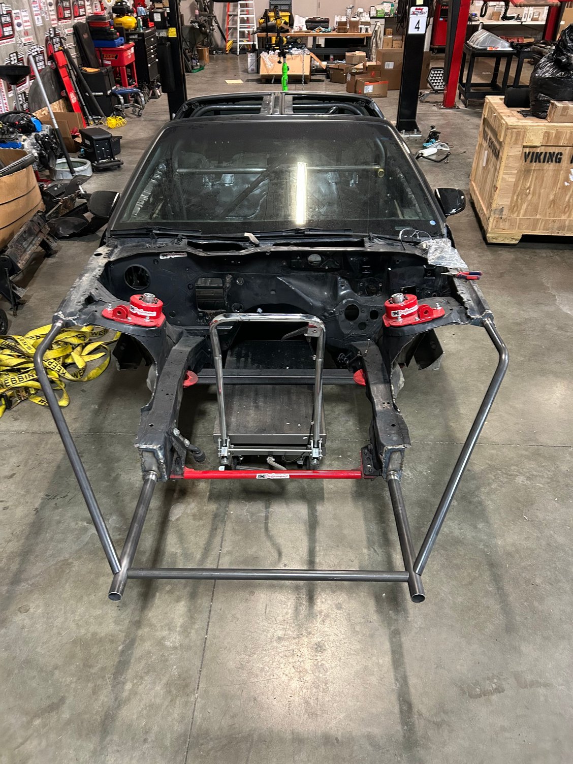

Front tube end is now mostly complete. Just need to final weld all the tubes once I get the bumper and radiator fitted. Got the crash bars cut out of the doors as well which came to 22 lbs of weight savings. Also got my T56 Magnum back from Bowler Performance for their carbon edition upgrade. Currently working on getting a fuel cell ordered ordered for the car. Hoping to have the roll cage completely done around New Years. More updates to come.

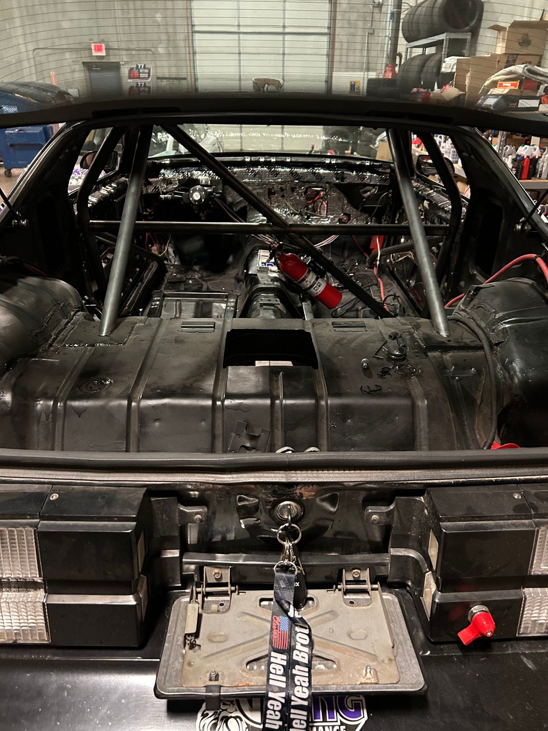

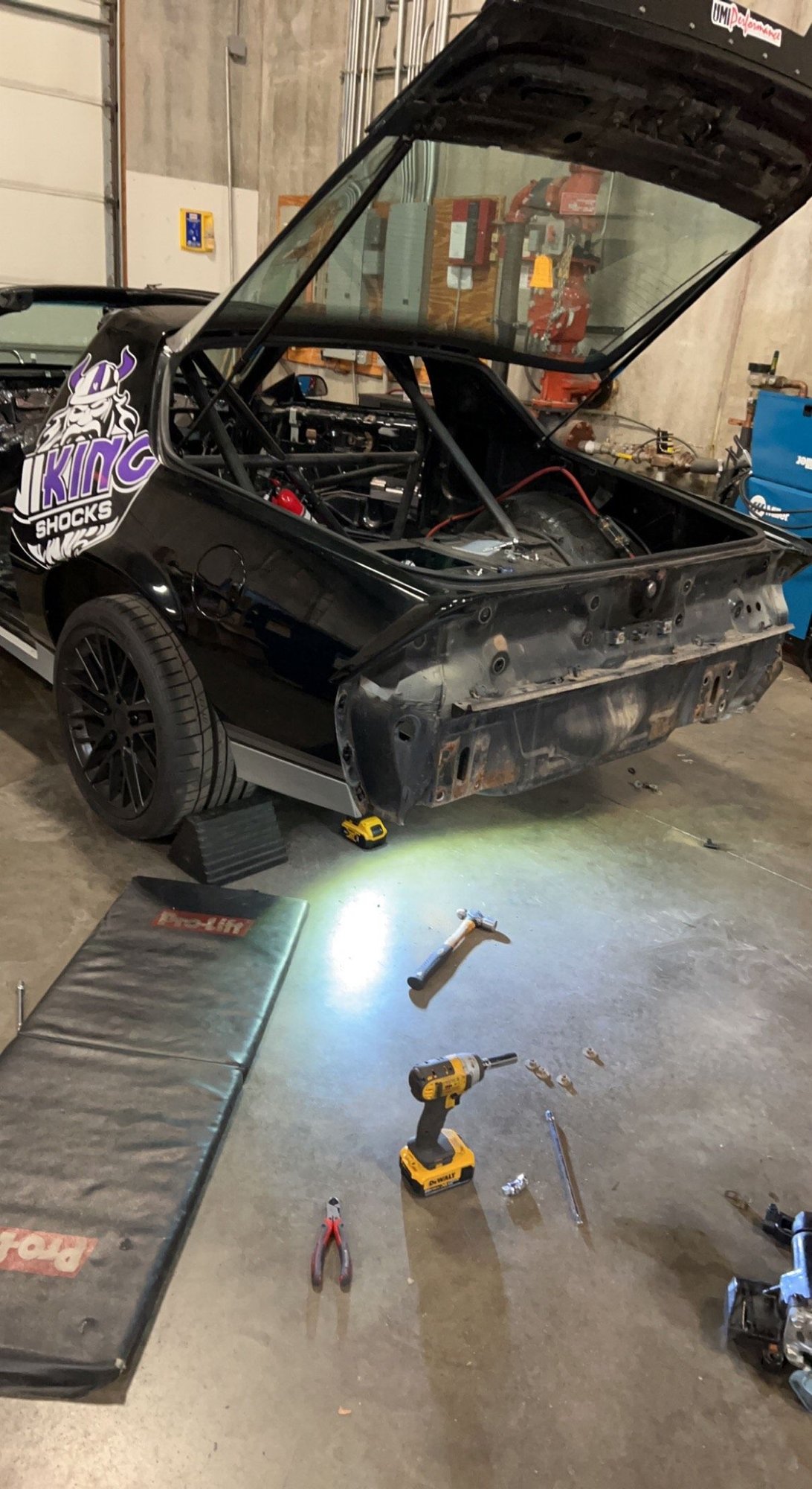

Just got done cutting some of the rear sheet metal out. Im going to be tubing the rear frame rails from the pan hard bar mount back, kind of like the front of the car. This will make fuel cell mounting easier and eventually a rear diffuser. Im not sure yet if I’ll put the bumper back on the car depending on what it looks like with the exposed tubular crash bars/ fuel cell. I’m currently working on making a cross bar out of roll cage tubing that will go across the factory shock mount location.
I’m going to weld some tabs to this cross bar and the shocks will now mount to this since once I tie into the cage it’ll be a lot stiffer than the stock upper shock mounts. Focusing on getting all the fab work done first, then painting, then assembling the rest of the car. Hope everyone has a Merry Christmas

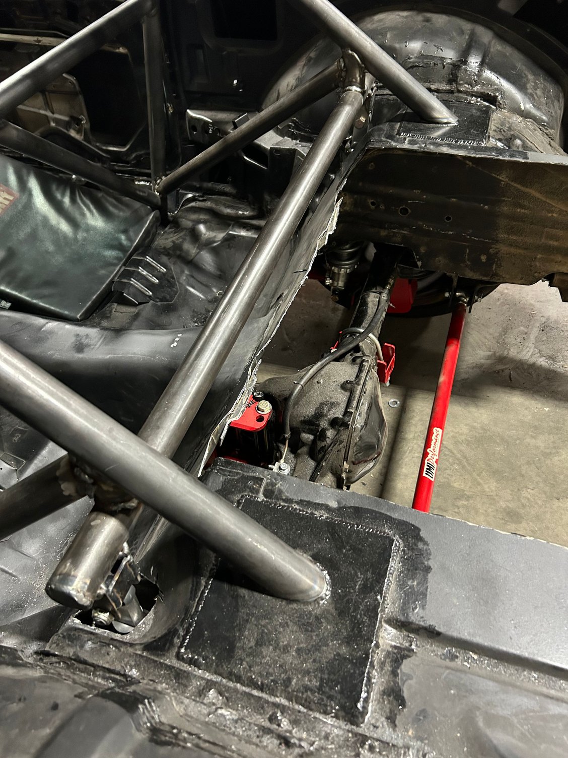

Rear shock mounts are now complete. Since the roll bar was already in the car, and I didn’t want to remove the rear bars, I decided to just put in a cross bar going across to hold the upper shock mounts. Also added in two reinforcement bars to the main hoop. Don’t mind the hideous welds, I definitely need some more practice before welding in any more of the cage. Also got one of my kirkey seats delivered. I’ll be figuring out how to mount that soon.
