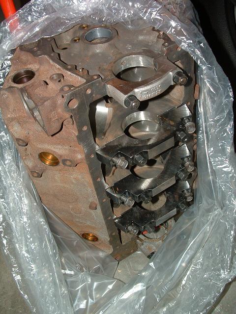

400 block:
.030 over (4.155")
1/4 fill block filler
splayed caps

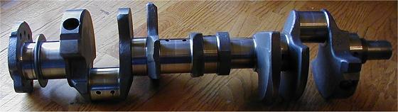

327 crank:
3.25" stroker
rarer large journal
factory forged steel
std/std journals
cut with double keyways for the blower

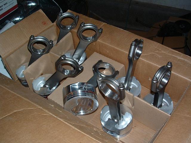

Rods:
6.00 inch
H-beam
4340
bushed for floating pins
Pistons:
forged
JE
Standard large ring pack
approx 21cc dish (too many years building I forgot)

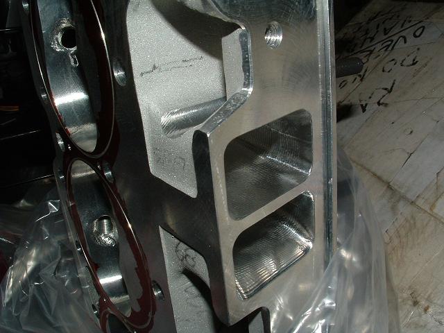

Heads:
AFR
195cc
Loc-wire machined

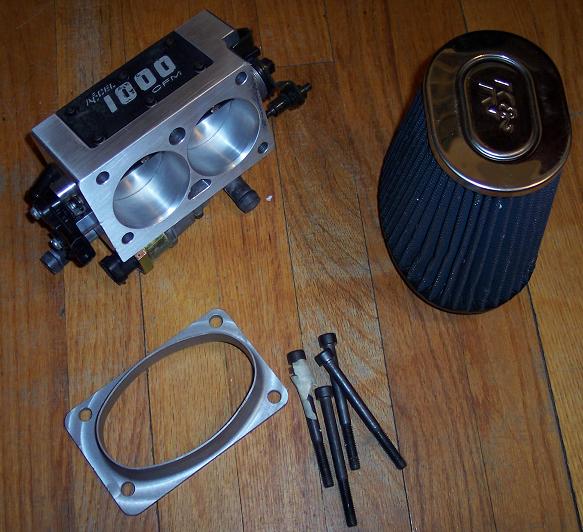

the HSR
Accel 58mm throttle body

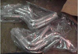

coated super comp full length and 4 inch mufflex exhaust with off road y-pipe:

Looking good B4Ctom1! When are you planning on fitting the engine? Do you have any dyno numbers, or are you waiting until it's fitted for some rear-wheel figures?
Regarding your AFR 195 cylinder heads:- What does Loc-wire machined refer to? A type of porting/polishing process?
It means that they have been machined for Fel-Pro Loc Wire gaskets.

The AFR 195's were cut with a reciever groove to take a special part # of head gasket from felpro made with a protruding oversized support wire built into the fire ring. This is done to help blow up the motor by not allowing the head gaskets to blow as a safety (just kidding) on high cylinder pressure cars. The AFR heads are fully ported with a CNC machine from the factory.

I went with the 327 crank and 6" rods because they fit the set of stroker pistons I got a long time ago and the light at the end of the tunnel (huge oddball stroker forged crang I couldnt afford) never seemed to come on. In desperation I decided to just get this thing going. I got tired of being an arm chair quarter back since I sold the JYD. My friends saying, "you should just put this thing together..." Instead of putting it together with the cast crank and stock rods I just got some cheap H-beams and a forged 327 crank. besides this compression is better for a blower motor anyhow.

In case any of you were curious these pistons do not use an abbreviated ring pack of any sort. regular sized 400 rings fit here because of the short stroke.

Tom, Any work been done to that crank or is it pure stock? Can't see it perfectly, but it seems the throws were knifed, they look pretty thin. Don't know if that is a product of GM engineering to offset the weight since the mains are larger than every other factory sbc crank made.
What kinda intake will be on it. With that small of a stroke and enough head to injest the air it needs you may want to look into a mid length/long runner intake to help build tourqe down low before the sc starts spinning to it's efficiency range.
Can't remember what mag built it(maybe hot rod or one of those), but they had a blown 302 motor that made 600 hp.
May wanna do a search for small CI chevy's with SC's, if I'm not mistaken it was a very mild cam around 220 on 110*. What about a noisy gear drive for that revver, that would turn some heads. Good luck!

the crank is as stockas they get

Hey tom, why did you choose the 660gram Hbeams over the lighter cheaper I-beam eagles if you knew you were going to want to rev the thing out?
I noticed yesterday how light my dad's I-beam were compared to my heavy crap H-beam eagles... what a difference.

mainly because I like to do big no-no's but mostly because at the machine shop we have a cheap H-beam like mine that is tied in a knot from a broken cam but the rod never brokse and never windowed the block. yet hot rod or car craft for example (not that mags are the best example) they had the MIDDLE! of a I beam fly out. If I was goinh to go I beam it would be a "detroit billet I beam" and they are heavy too. you may have recognized the rod I speak of summit sold them as the prolines a few years back (beefy). Also the pistons (although JE) arent that light. the name of this game wasnt filet minion, it was london broil, good beef without breaking the bank. the low stroke will reduce internal speeds therefore internal inertias as well my gears will be the 4.10's in the currie 9" and tires will be sized according to what feels the best. the converter is only a 10" 3800 or so that stalled on my friends near stock but cammed up 468 at 4500
