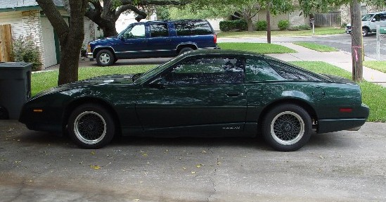

I have a 91 350 tpi trans am (pic below), stock except for sfcs, 3 chamber flowmaster (stock dual cats), new tires (225/50/16 front, 245/50/16 rear yoko's) and newly rebuilt 700r4. I want to mod it, but i want to run the bottom end until it dies, so id like to either supercharge or turbo it.
