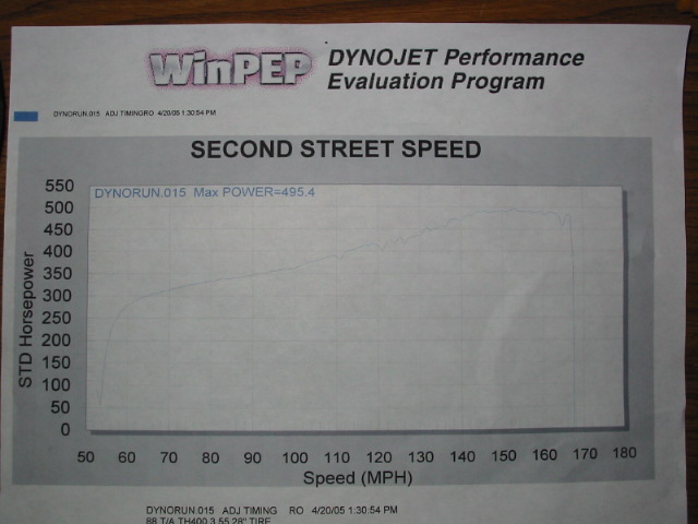

I'll make an attempt to post dyno sheet........

That was on the motor. Notice the mph!

wow, looks like 1000+rwhp is easily attainable once you get the belt issues figured out!
