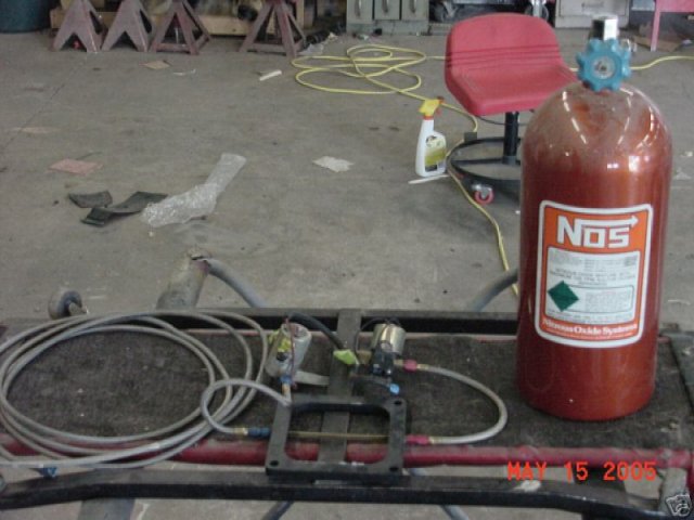

i might be getting this for setup for cheap and i wanted to know what else would be needed for this to work with my tpi. I know this setup is for a carb.

Could probably change it to a dry kit, like my zex kit.
You would need a
1.tps
2. management system to use some of the nitrous pressure to ramp up the fuel pressure
3. AFPR
4. Dry nitrous nozzle
5. wouldn't hurt to get another bigger fuel pump
Probably more, but you could make it work.
Not sure about making into a wet kit, maybe somebody else can help with that.

Here is what you will need.
NX shark nozzle.
Nozzle adapter
Jets
Bottle brackets
toggle switch
micro switch
wiring harness and relay
That should put the basic system together.
Then you will need accessories such as heater,purge,fuel pressure safety switch.
Most important for saftey.... a window switch.
If you need part numbers let me know.
