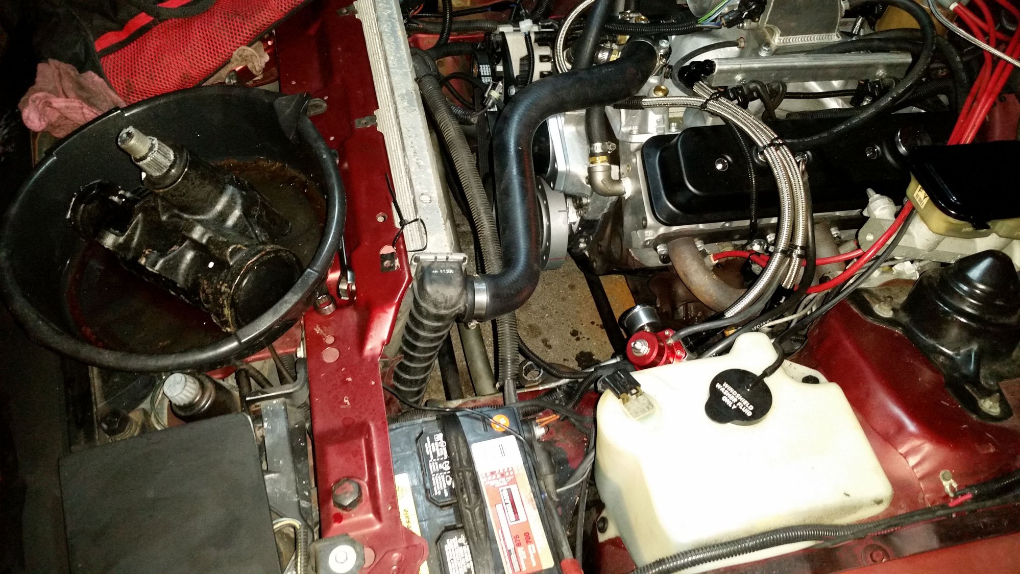

Got the intake on the 350 off, nothings bent or looks bad. Pulled out newish looking lifters(no wear on them at all) and elgin 7.8 push rods that im cleaning up now, part number pr34b can still be seen on the sides. Im guessing when I pull the cam its a mild one, at this point I could slap together another 350 if I wanted too lol.
