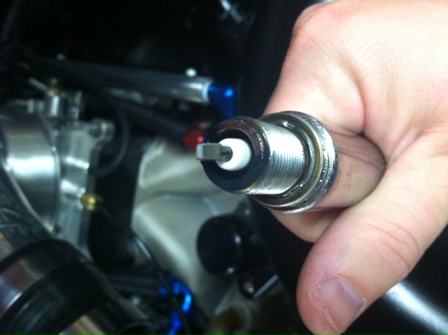

-Gone to a 8 degree plug at .026. Heat Range looks perfect. Half of the plug is clean and the other half is rich on the fuel ring.

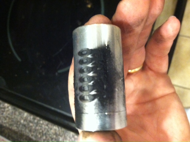

Also, I have belt slip now when I didn't the first time and the belt is tighter than it was the first time as well. Belt is a Goodyear Gatorback. Could boost be stacking in the engine from an over sized throttle body? Doing the math, I should be flowing around 1100 cfm at 6300 rpms but I haven't been able to push it past 5500rpm at WOT as the truck doesn't feel good and is slower than at 57% TPS. I didn't have any belt slip issues when it was loosing boost so it seems like there is some sort of build up of pressure causing the Procharger to work harder and slip the belt.

Well, I was tearing into the truck today and noticed the engine belt was hitting the spacer just under the alt. So, going to go some work on that. I posted a picture of that as well as put a spring tensioner on the supercharger belt to solve any slippage issue that I could possibly have. I also posted a pic of the spark plug.
Attached Thumbnails Procharger issues (part 2)-image.jpeg   Procharger issues (part 2)-image-2-.jpeg
