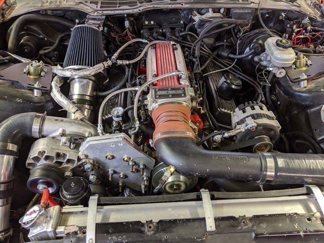

SBC carbed bracket with my own joe dirt style bracket with a serpentine tensioner on it like the procharger tensioner. 10 rib 7.8 crank with 2.75 blower pulley that has been sandblasted for more traction.

So I came up with this:
-- Joe
