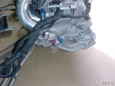

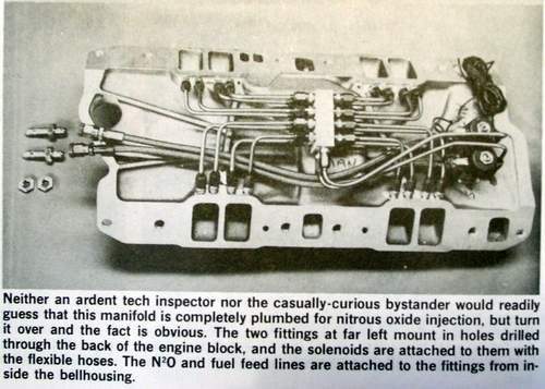

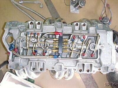

True I just thought I would share some interesting pics from my collection
