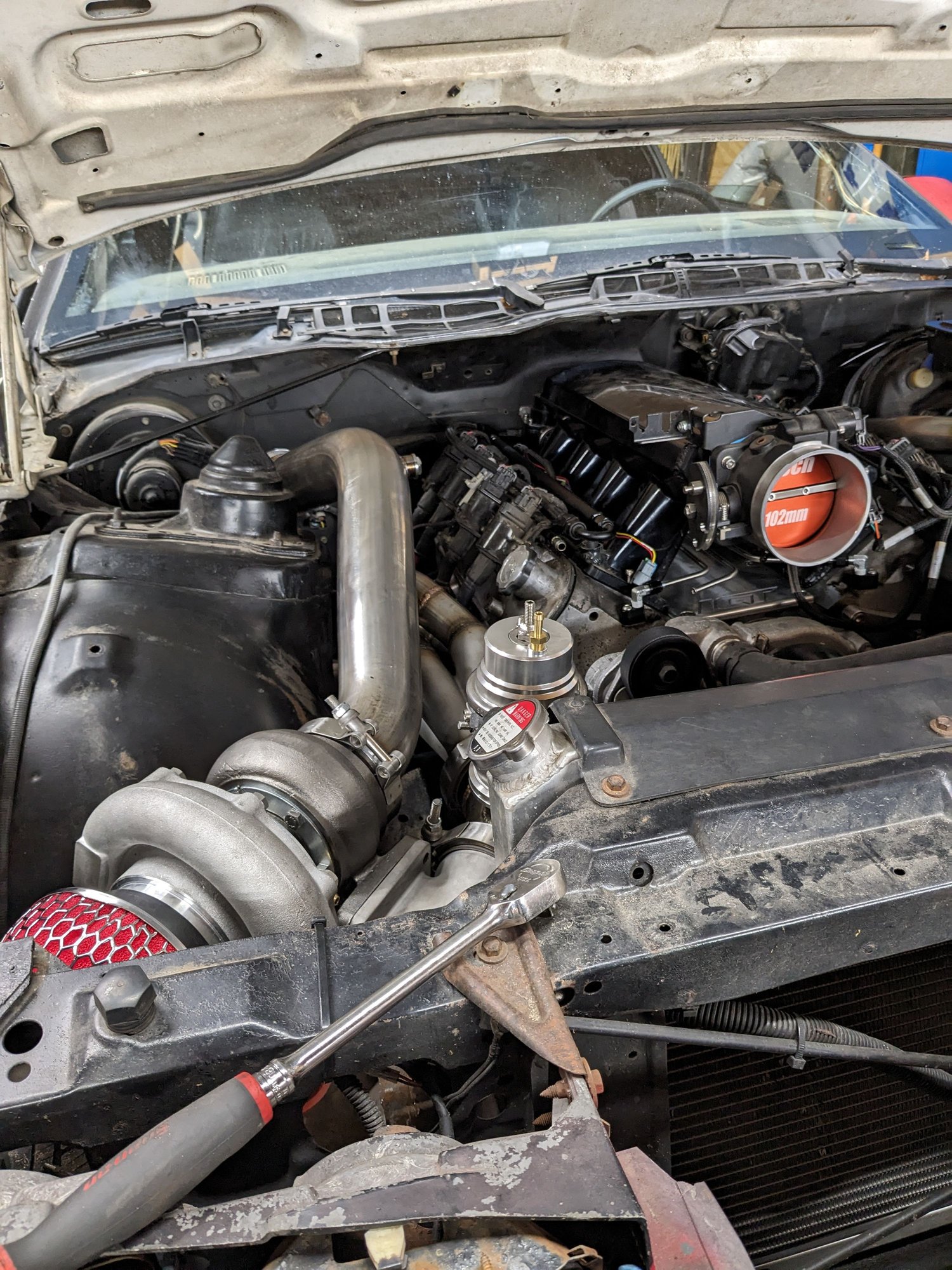

I am in the process of getting mine put together, can anyone tell me how to hook up the wastegate & bov, if I run intake vacuum to bov it stays open.

Re: Installation of CXRacing's LS based third-gen turbo kit
Wrong Port, gotta hook it up to the bottom/side ports... just one of them. The vacuum will help keep it close and boost will help it open.
PS: Depending on your boost I hope you don't blow up that sheet metal intake...
The BOV should be open under vacuum. And on the wastegate, the reference line should be connected to the bottom port. The top port will be used by an electric boosy controller, should you decide to use one. Hooked up the way you have it now, boost will go out of control and hurt the engine.
The vacuum block is coming from the bottom of the intake. Even when I had it hooked directly to the intake it did the same thing. I hope it don’t blow it 😂 I have no plans of it going over 20psi
Take the line off of the top of the wastegate and hook it to the OTHER port on the wastegate. Everything else looks fine.
I must be missing something, I don’t recall seeing another port on it anywhere.
Hmmmm, I dont see one in that pic either. Can you take a closer pic?
not true, on a turbo application the BOV should be closed at idle and part throttle, only on closing at WOT where vacuum is higher than idle does it open.
sorry on BOV it’s only a top port, spring pressure should be 1-2” higher than idle vacuum. On a supercharged application the BOV is suppose to be open at idle due to the amount of air a supercharger produces at idle.
on the WG it’s the bottom port to intake vacuum, top port is for a boost controller.
WG will have small 1/8” npt plugs on the sides below the vband clamp that holds the top hat on the WG. Remove the plug and install a nipple and hook that to the intake vacuum.
BOV only had top hat port, if it’s open at idle you need more spring pressure to close it. You don’t want it open at idle bc turbos don’t produce air pressure at idle and it would be an open vacuum sucking in anything that it can. On a supercharger so much air is being generated at idle air is being pushed out of the BOV at idle so nothing has the chance to get sucked in. Also with superchargers you don’t want to build boost till your heavy ont he throttle which makes it easier on the impeller and less drivetrain loss through the supercharger. My supercharger as making a lot of air pressure at idle and I didn’t realize it until I removed spring pressure from the BOV for it to be open at idle.
a good idea is to unbolt the WG dump and spin the WG around so u can see the valve. Put a compressor with a pressure gauge and adjust the regulator till it starts to open and then fully open. Record those numbers as that’s the bench pressure so you know what springs are in it without removing the hat which is a PITA. Your actual boost numbers will be lower than the bench readings bc you will have boost and exhaust pressure forcing the valve open earlier.
same goes to the BOV, use a vacuum gun like a mittyvac and see at what vacuum it starts to open, then add spring or washers to increase rate till it’s 1-2” opening higher than vacuum idle. You could theoretically set the boost WG and BOV without even running the combo lol. My WG had a 12psi spring and netted 12psi on bench test, real world was 6psi through full 3” mandrel exhaust, 8 psi through 7ft of 3” to a electric cutout under the pass seat. So it lost 4-6psi vs bench test due to back pressure and boost forcing the valve open. I now recirculate my WG and run a EBC and make 13psi on the same 6psi spring with 30% on the EBC. I also run the same 3” cutout and 4” catback.

Made some minor adjustments with my setup. I investigated the smoke at the turbo feed. Looks like the paper gasket was seeping a little. There’s a tiny bit of oil on the blanket but not enough for me to worry about replacing it. The feed hole on this CX turbo is threaded but I’m gonna try a better gasket first. Matched up the paper gasket to Felpro 73112 at the parts store. This one is made for heat and has like a metal coating on it.
Swapped out the melting plastic wire separators with some aluminum ones I found on Amazon. They actually look nicer than the old ones which is cool.
Ordered a new Mighty Mouse Gen 5+ catch can setup. This will work with the hoses I already ran and the mounting bracket I made. Should be here next week.
sounds good. Your turbo cartridge won’t see temps high enough to require a metal gasket but if it works then run it.
mightymax can is a good one and will work well.
looking at your pics… can you flip the coils upside down? Would keep your plug wires away from the headers and clean things up a bit.
I also knoticed that your vband on the driver header collector isn’t centered and looks like it’s way off. This could be causing a leak and small leaks preturbo make a big difference in performance. Attached is a pic I circled.

Good idea about flipping the coils. I’ll have to check that out to see if that’s possible.
My DS header to crossover was a b!t$h to line up & it is slightly off. The best solution may be to fabricate a new crossover pipe that’s a little smaller diameter like you did.
I also forgot to mention that I bought a belt 1” shorter than the factory length 4th gen LS1 belt and now I have a lot more room between my tensioner and crossover pipe.
Old Apr 17, 2023 | 01:33 PM
Yea the crossover flex joint is Tight AS F! Maybe try putting one end attached or in a vice and yank on the other end to try and stretch it out a bit.It will be near impossible due to the flex SS outer braid but it might give you enough. If I remember mine was tight (short) and I had to pull it out as I tried to install. I welded in 3" OD pipe less than 1/2" wide into the crossover to help with sealing and aligning the Vbands. Just a few Tac welds on the inside to keep it locked and and then the friction of the inner sleeve will align it and reduce leaks. If your getting any leaks (you won't see till you take the Vband clamp off) black carbon you could try a remflex Vband gasket which are great for sealing up warped flanges as well. They are thick and can make assembly a PITA till you can crush them enough to allow the clamp to start squeezing and self center.
Nice fix on the LS1 belt. I run a dirty dingo small PS pump pulley so my belt is quite a bit shorter than any LS style belt.
Figured I would add to this with my experience with the kit, just got half way installed this last weekend. Running the updated version from cx, and I'm running into clearance issues on the driver's side header, runs right into the brake booster. Has anyone else had this issue? Other than that, everything seems to bolt on pretty nicely.
​​​​​​My setup is a 4.8 ls with texas speed valvetrain, 4l80, and a fabricated 9in rear end.
Man oh man that cx racing kit just screams insane under hood heat
